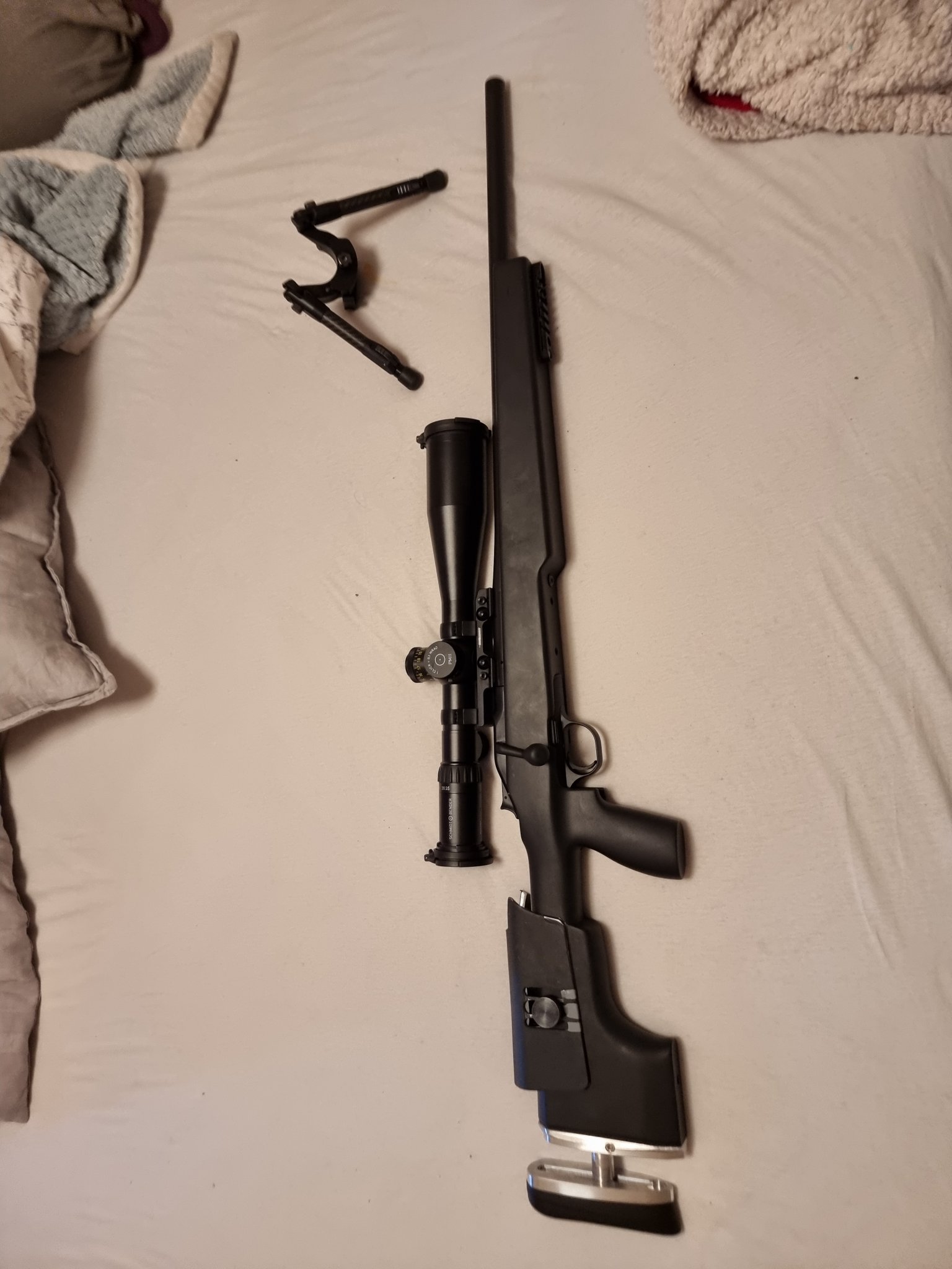

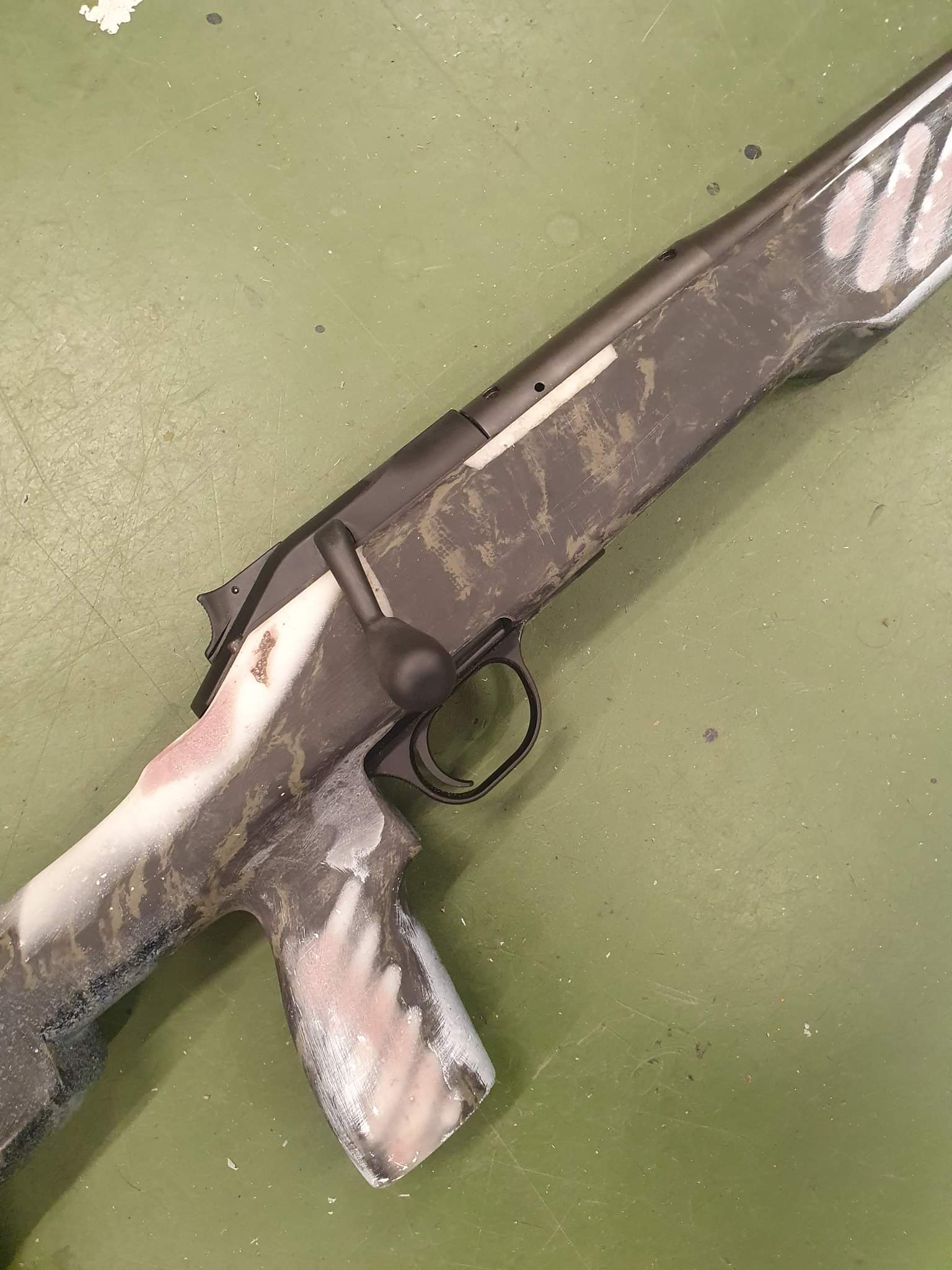

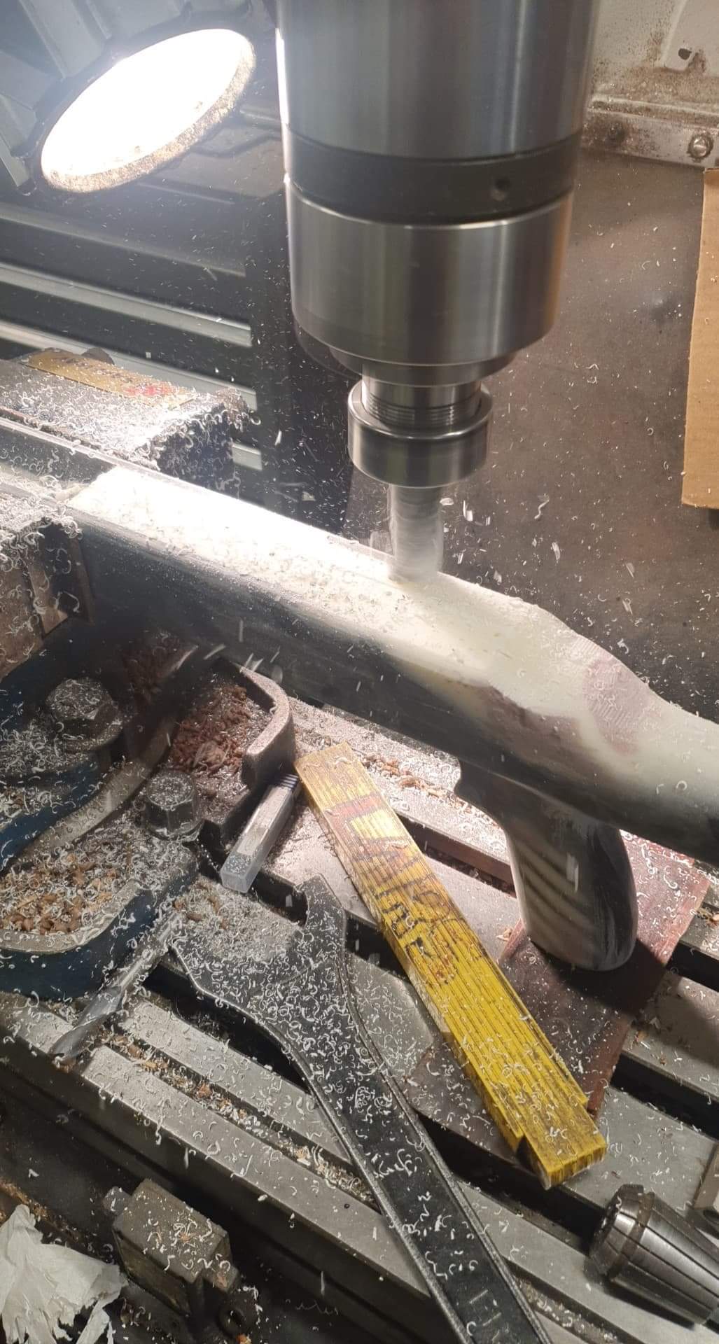

I have a r8 in a grs sporter stock, pried out the reciever block and modified a mcmillan tpr stock i had laying around. The biggest problem i encountered was, width the reciver block i 42mm wide. And the rear action screw. Would love to modify a mcmillan a3 or a5 type but the amount of epoxy you need to add to the rear of the tang to get the reciver far enough to the rear, is making it difficult to look good.
