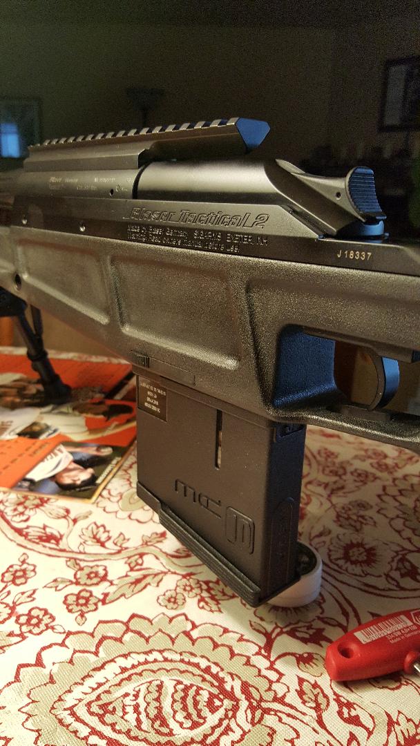

Here is what the first gen looks like:
That's Los Altos r&g, that is my home spot. I would love to see that rifle up close!
