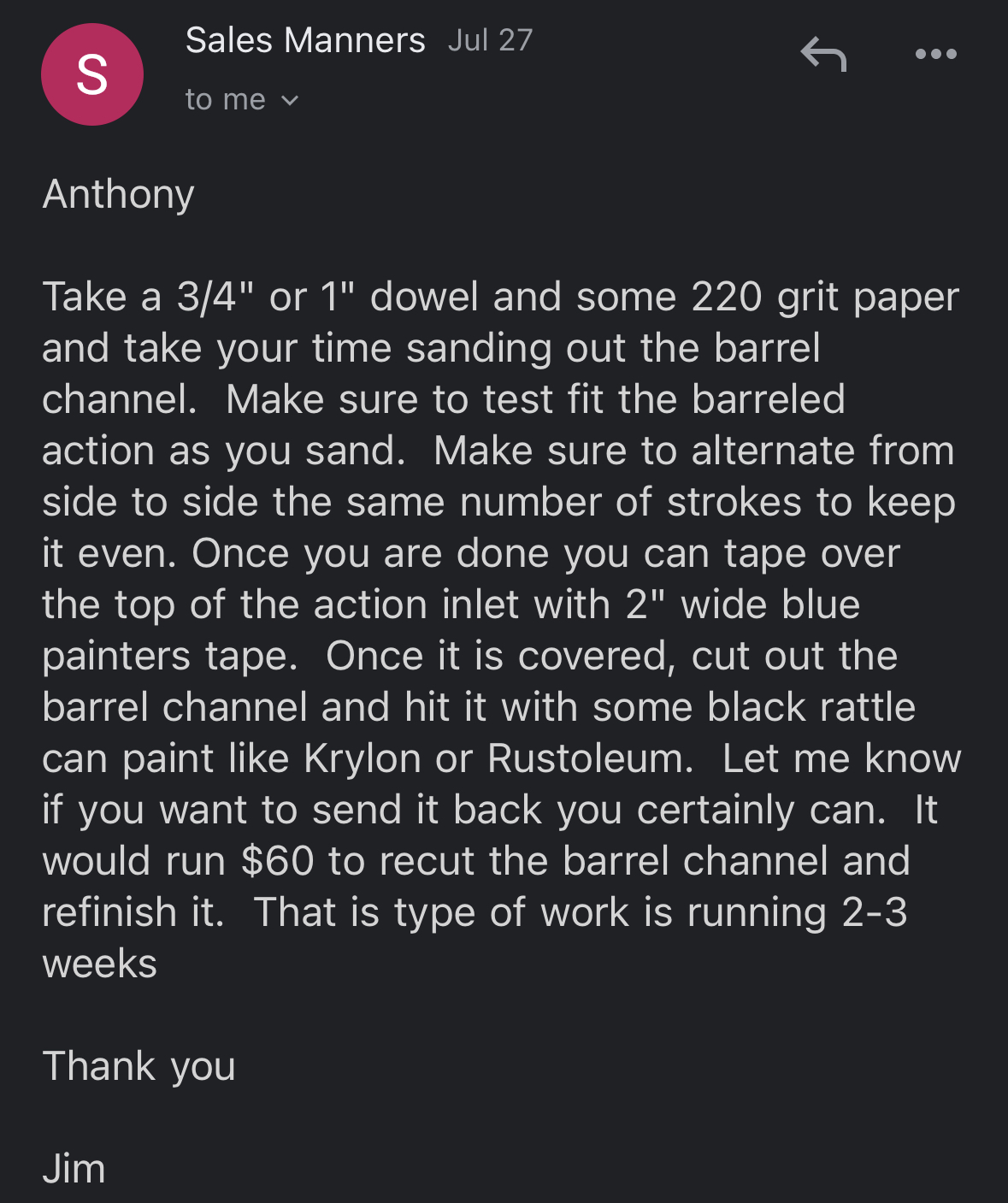

    So if one were to have a McMillan CF stock which needs a little work to get the barrel channel to fit better, is there a best/better tool to use? I feel like I got the best fit at the recoil lug seat, I just don't want to have to remove/install the BA 100x to get the stock barrel channel opened up. I figured I'd get some sort of high/medium/low grit sanding block or form (or whatever) to work the stock till the fit is best. Is the $20 bill fit check still a good way to know the fit/channel along the barrel is good to go??

    Dowel and sandpaper. I use 60-100 grit. Barrel channel doesn;t need to be super smooth. Just not touching. Have done many stocks like that and it's very easy. I spray with a clear sealant when done. Usually takes 10-15 min max.

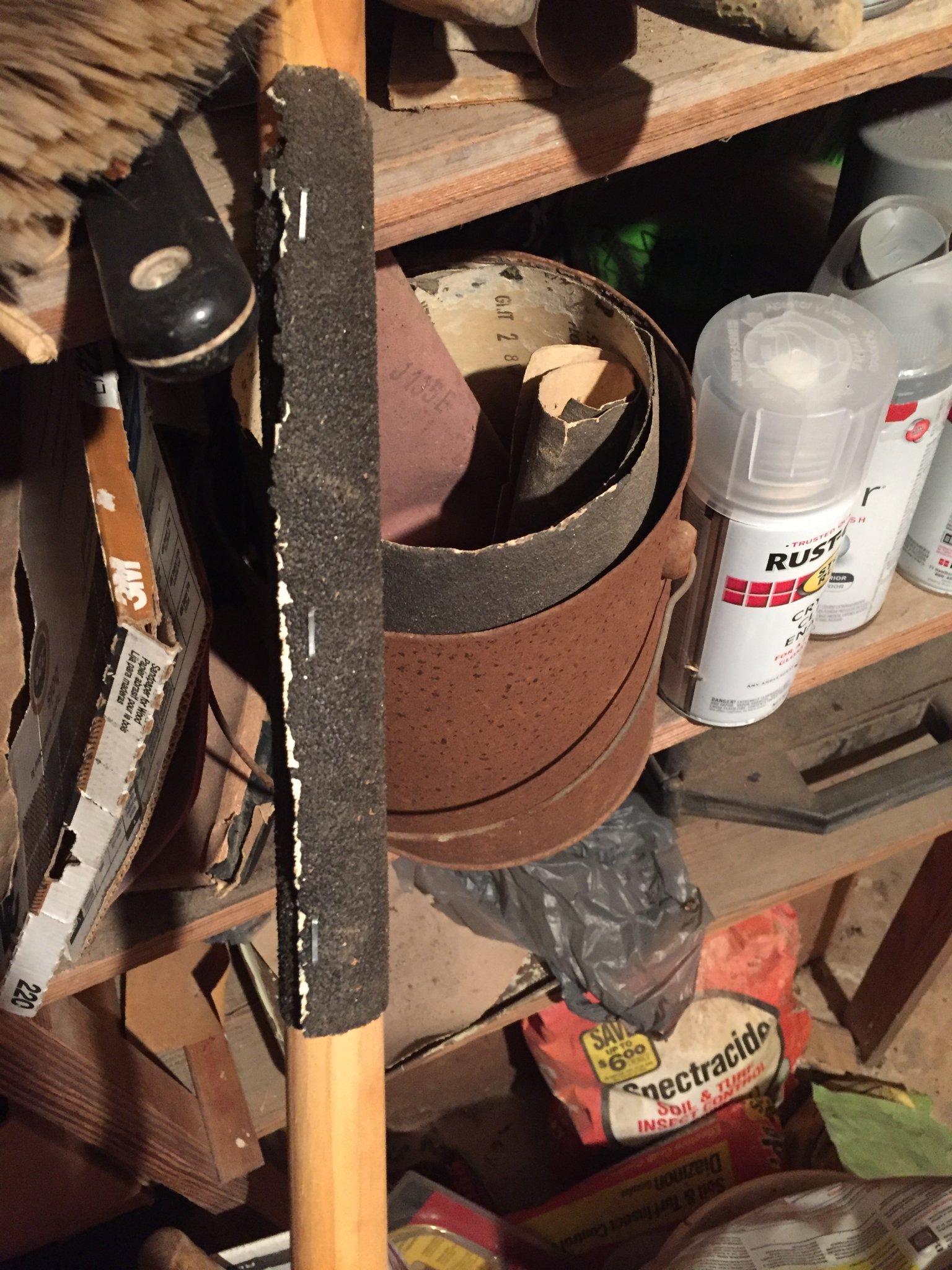

    Got the dowel rods over the weekend, picked up an assortment of sandpaper (80/150/220). Took the action off, went at the channel for 30-45 mins (give or take), two test fittings to do the $20 bill check, final clean up of the stock, attached the BA to the stock with full torque value on the DBM. $20 says it's good to go. (inflation sucks :LOL: :LOL: )
    Lessons learned:
    > I found my barrel specs online as to better fit the dowel rod tool. Since the barrel was .02" over the 1" dowel rod that's what I ended up using for my stock channel. ( At least I was damn close given all the variation in specs. ) I'm glad I didn't go with the 7/8" dowel rod.
    > As pictured above I found my staple gun finally, the staples hold the sandpaper in place.....worked great.
    > IF you are starting with a stock where you need minor fitting 220 grit worked just fine. IF your stock needs a lot of work then 80 grit would be a good starting point.
    I'll add here that if you are really needing to open up a tight stock barrel channel then a 7/8" dowel with 80 grit would be a good starting point.
    > I wore gloves as the sanded fine powder of the stock fill and carbon/epoxy will get on you.
    > Go slow and smooth with your action. I rolled the dowel a little bit as it helped get a few sticky areas worked out. The staples holding the sandpaper may cause issues, but you don't need to roll the dowel 360*. Just a 1/4 turn either way was all I needed to do.
    > I would stop and clean up the barrel channel every so often as to not allow the dust to build up inside the channel or on the sandpaper.
