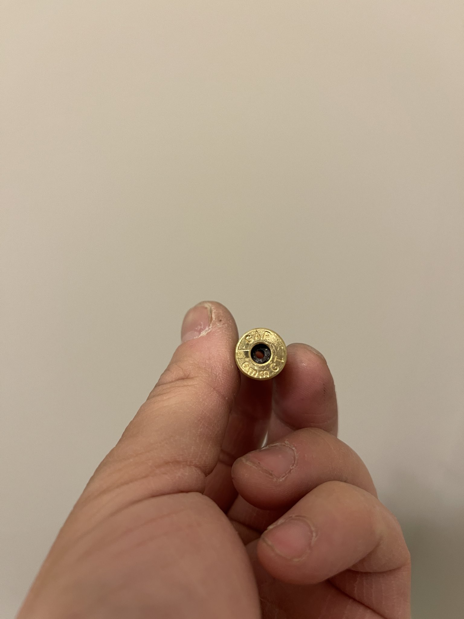

    Ok Ok,
    At my latest match, I had about 30-40% blown primers. Primers that got blown out of their pocket causing all kinds of jams... totally messed up my day!
    This is a fairly new build and I only have about 400ish round down the pipe.
    Build/Load:
    Big Horn TL3
    26.5" Bartlein Barrel
    34.2gr of Precision Rifle from the same 8# Jar
    CCI Small Rifle Primer
    109gr Berger
    COAL: 2.578" +/- 5 Thou. This I accounting to my builder 20 Thou off the lands.
    Load the load I am getting 0.3MOA Grouping.
    I have loaded 500 rounds the same way this blown primer issue only showed up at my latest match. I shot about 80 rounds and 30-40% blew the primer, I didn't change the recipe.
    When I first got the gun a few months back I was around 2950-2960 FPS, short the gun for about 200ish rounds (I am in GA).
    No sign of pressure, I did occasionally get the typical ejector mark due to the Big Horn Action geometry. I was told it was normal.
    My Smith in AZ was getting 3050ish, same load (He is in AZ)
    I didn't change the load since I was getting 2950 consistently.
    Recently I installed the ATS tuner, during my tuning session, my velocity started to go up. 2990-3000, again this is the same lot of ammo I made.
    I am using the ATS and an Area 419 comp in front of it. While I was tuning, 60 or so rounds only one round felt/shot funny, this is the first time me seeing this. That shot felt off, sounded off, smelled off. There was a black ring around the primer pocket the primer was still there. Since it was only one, I didn't care much...
    The following day was a competition day... well fuck.
    In the first stage, I got a blown primer! Causing all kind of malfunction throughout the day.
    What gives?!

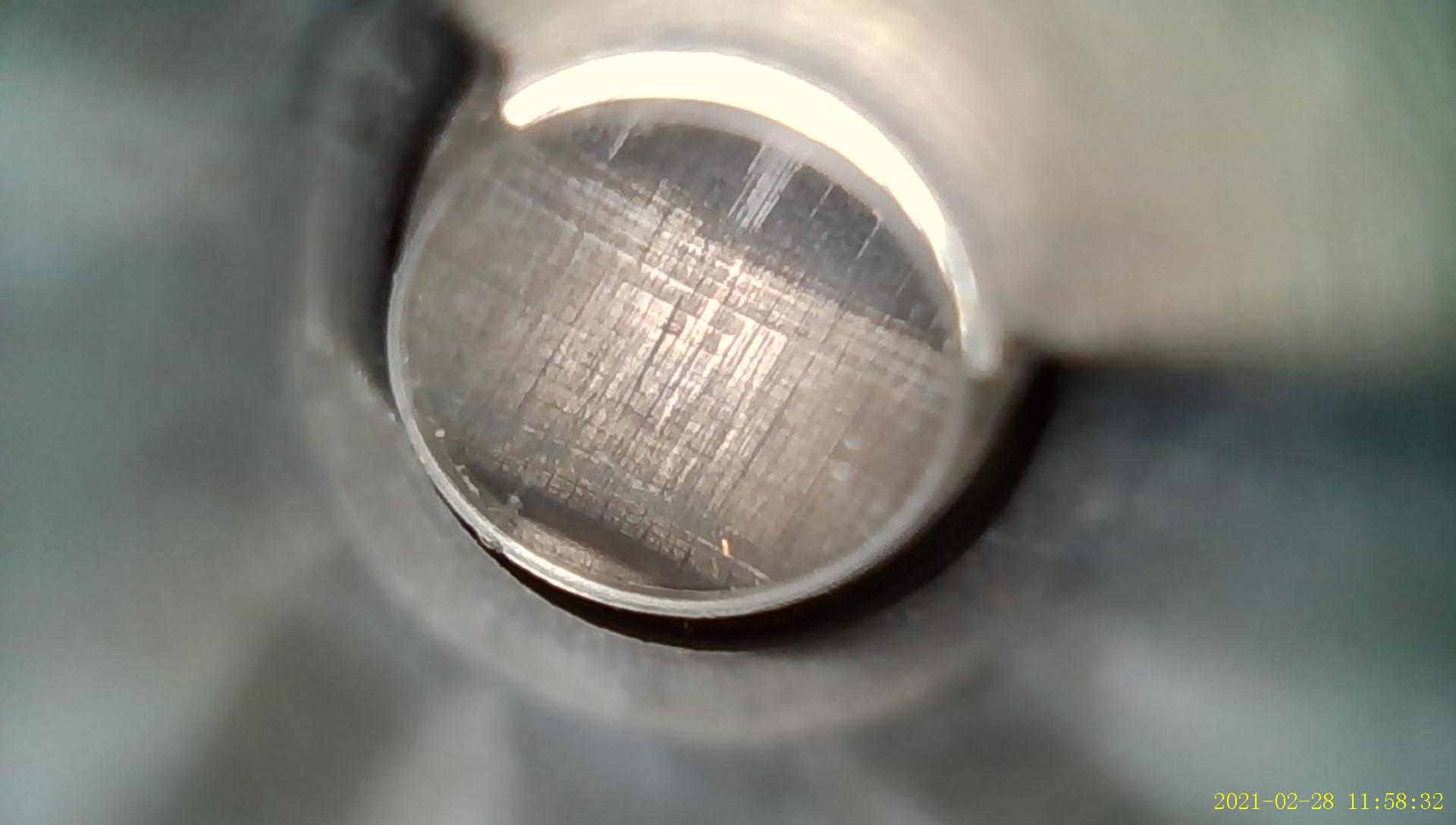

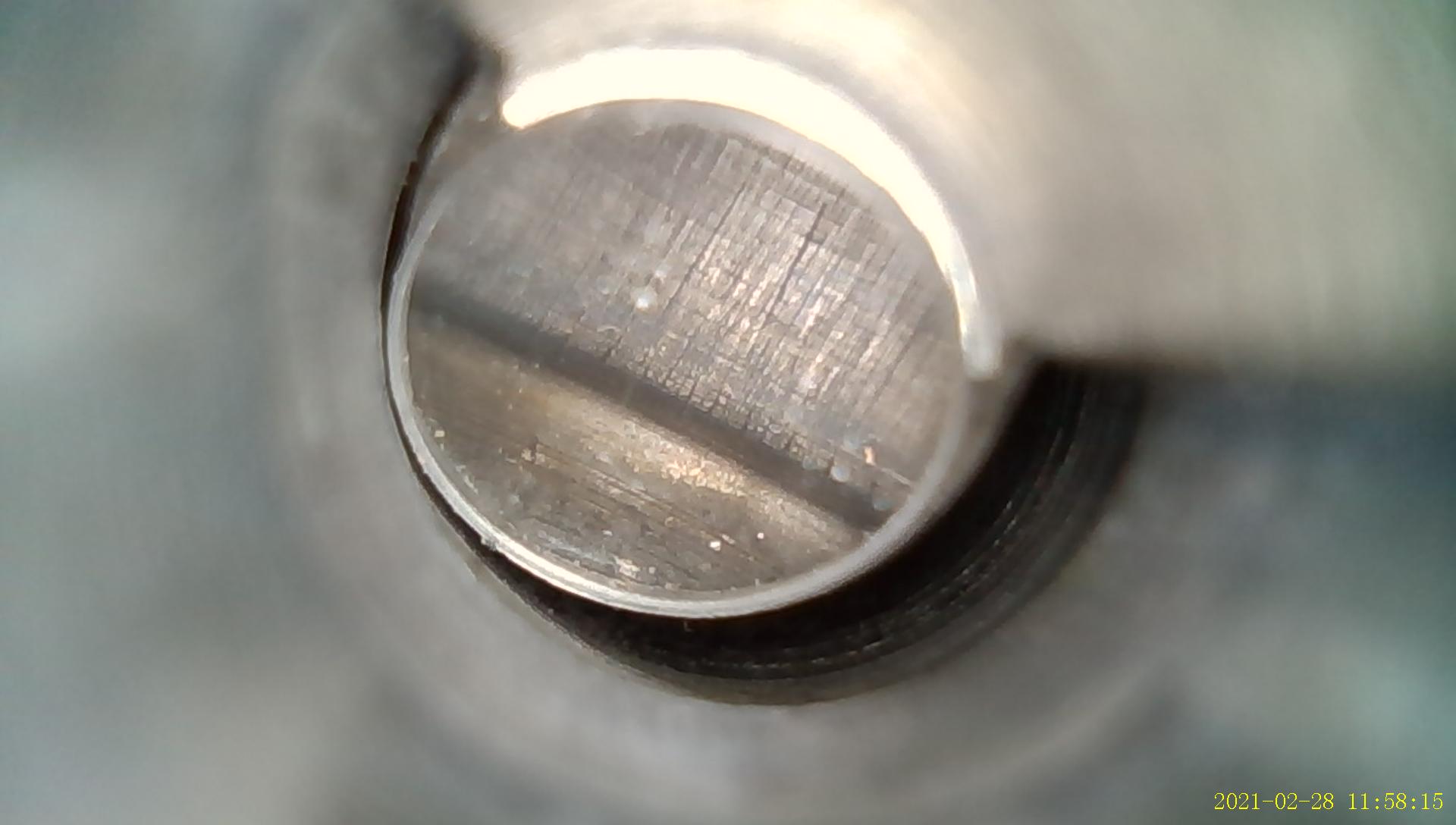

    I bet you haven't cleaned the carbon COMPLETELY out of it in those 500 rounds. There's excess carbon buildup causing the pressure increase.
    I clean it at 150 rounds. Used Wipeout and I have a bore cam BUT I will clean again.
    Here is a picture of the suspected carbon ring and one showing the relationship to the lands

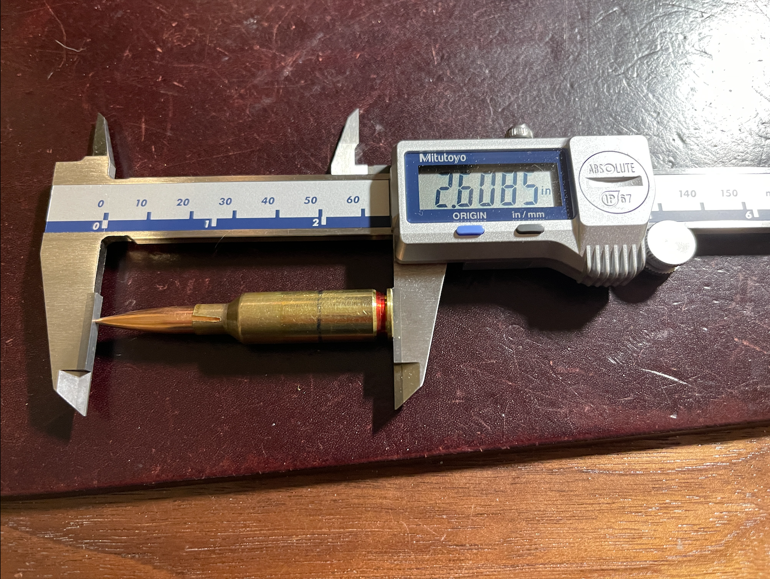

    400 rounds doesn't seem like enough to get a significant amount of carbon to cause this issue. I haven't seen this in any of my comp rifles, not even close, but they are not 6GT's.
    How many reloads do you have through the cases you used? Any chance they are running too long?
    You need to measure distance to lands in YOUR RIFLE with your bullets....get the CBTO measurement where you contact lands with said bullet... do your own load work up and load your length using that CBTO measurement to ensure you aren't on the lands....you have a hot load or in the lands or both. Without putting the work in you won't have an answer.
    And I have 5 TL3... been shooting them since they first came out. I don't get ejector swipe on any brass when I've properly worked up a load. Who told you it's normal and just how the action is designed because they are wrong??
    That last picture we when the primer hasn’t blown yet.
    The one with a blown primer are way more apparent.
    When I just got the rifle and shooting around 2950 there was only a very faint mark.

    Ok, while I am waiting on my modified case (Thanks, Padom)
    I used a fired case, full-length resized, and cut some slits on the neck. This should get me pretty close to get my "to the land" value. I will check this against using a modified case.
    The value I got for Jam/To The Land is COAL: 2.6085"
    If we subtract 20thou from this, it gets us 2.5885"
    My current load's COAL is 2.5780"
    I am at 30thou off the land/jam.
    I have also pulled 15 bullets yesterday and used a separate scale to measure the charge.
    They all read 34.2gr
    I am at a loss...
