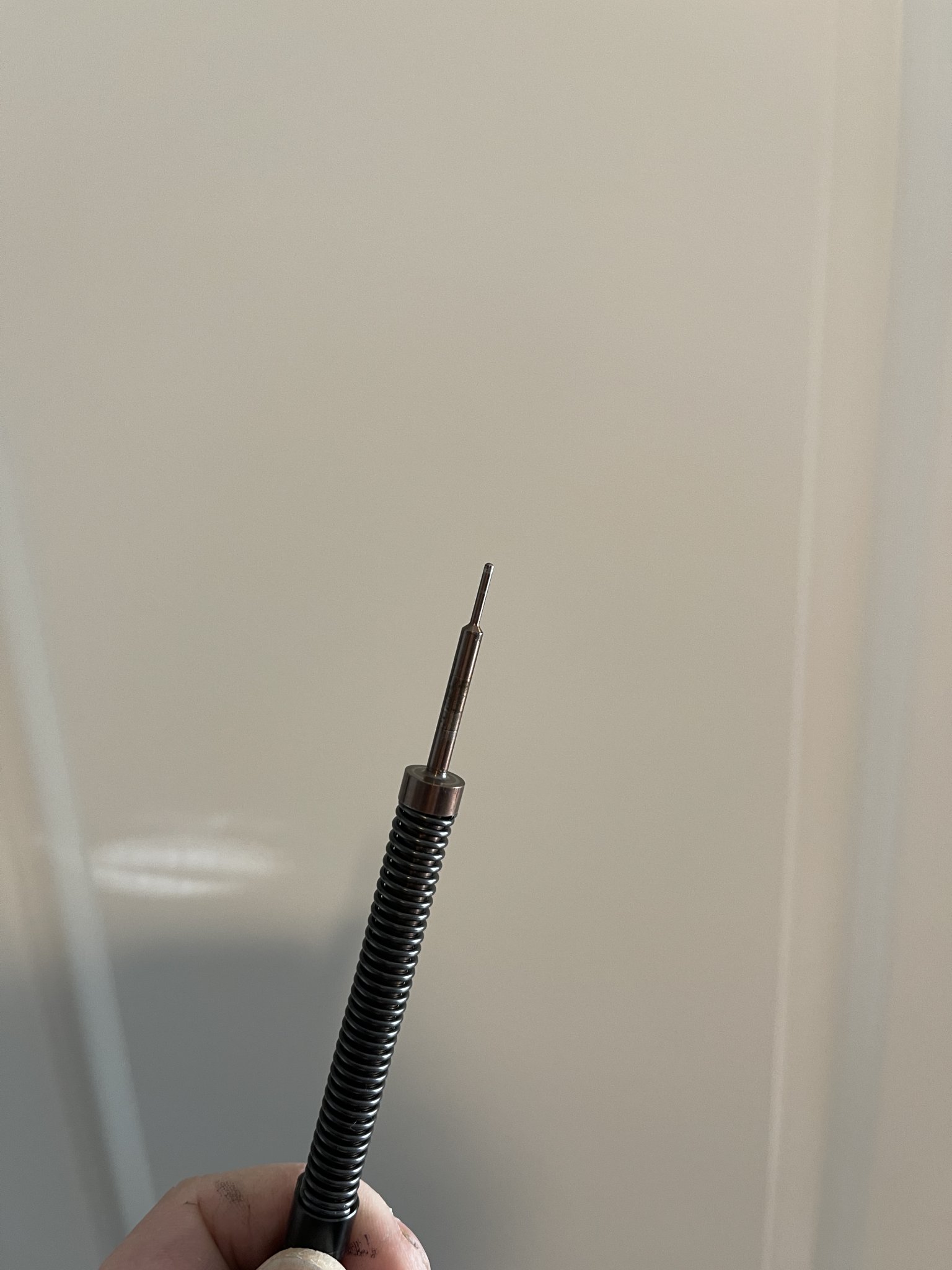

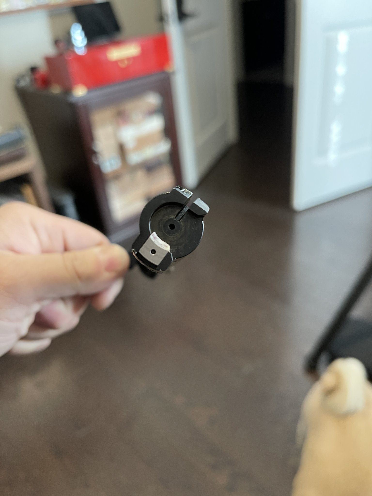

After gassing 40 primers you might want to look at your bolt face to see how fucked up it is?
Maybe firing pin tip too?
What do you think?
To much pressure, possible cause brass to long, may be seating bullets to long , powder charge excessive. make up test loads with case trimmed to minimum length , minimum powder charge and charge 1/2way between max and minimum seat bullets to recommended COL not to lands . if no issues only change one thing at a time to determine what caused high pressure .
