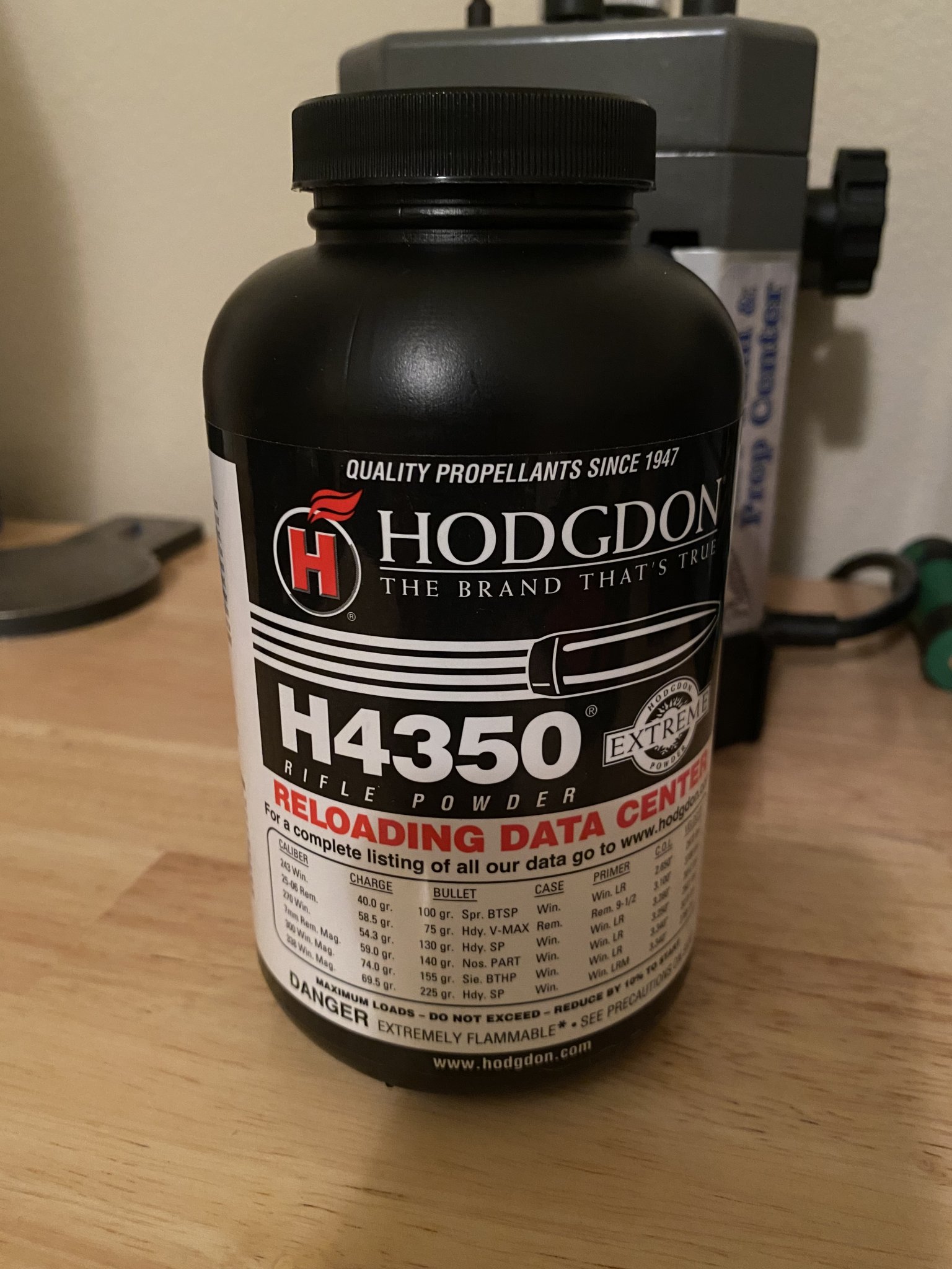

The powder came from Brownells and while I certainly won’t rule out incorrect powder at this point, it was either mislabeled at the factory or by someone at Brownells. I also pulled apart a factory round and it’s case was very noticeably more full of powder than what my reloads were. As far as the scale, the only known weight items I have are bullets. I weighed several 109, 108, and 107 grain bullets and every one weighed within an acceptable range-within a tenth of a grain.
