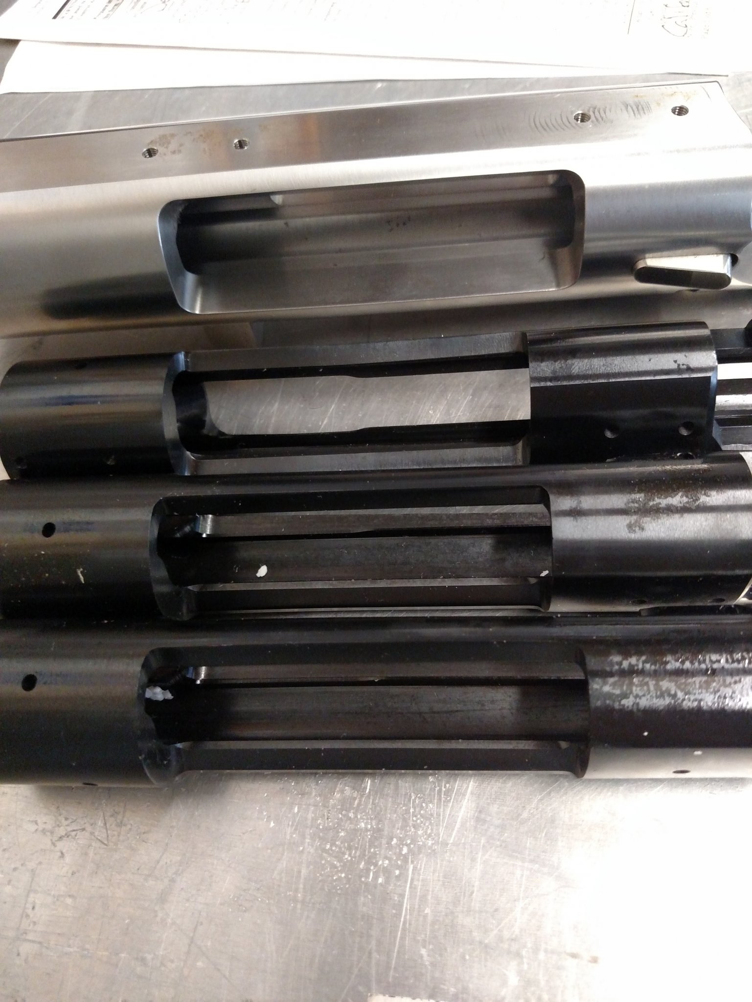

Stupid Question: Are Custom actions (Defiance, Surgeon, Impact Precision and so on) blueprinted by default? What I'm trying to ask is, aren't they build as precise as what a blueprint would do?

The way I understand it is that the “blueprint” is to get things square and flat. Things like bolt faces and lugs etc. Remington, as I understand it, is NOT producing actions right now that are particularly good at being square or flat where they sre supposed to be. Things like threads being cut off square etc.
as I also understand, the newer, custom actions are, from the factory, very, very good. That’s the big draw. Builders can start with an action that’s as close to perfection as machines can do, and that’s DAMN good nowadays. Modern CNC machines can carry accuracy out to the fourth decimal, or to ten thousands of an inch. Having to make a factory Remington that good, can take a significant amount of time and labor, this making the difference worth it to just go custom from the start. Also, a “blueprinted” Remington action, at the end of the day is still just a Remington. It’ll NEVER be a Mausingfield, Tempest, Surgeon, etc.
Hope I make sense?
Your question makes perfect sense.
The custom actions offer you more features not found on a factory action.
The tolerances used is a sport issue. You don't use the same tolerances for a tactical rifle as you would a Benchrest rifle.
Blueprinting makes sure the tolerances you choose are uniform throughout the action and that everything is as perfect as it can be given that level of tolerances..
A tactical bolt might have 0.004 - 0.006 of clearance so dirt and debris don't cause it to bind up.
A Benchrest action might have 0.001 clearance so the firing pin springs force doesn't lift the lugs off of there abutments as much.
When you go to a manufacturer's website some of them will tell you what the clearances will be or they will categorize the actions.
Stiller actions will call them a Diamondback for Benchrest or a Tac series for what most do here.
The Tac series is machined true and straight but has more tolerance on bolt fit than a Diamondback.
When a Remington 700 is blueprinted all the surfaces are trued and corrected then your intended use for the action dictates what tolerance you will use on the bolts fit into the action.
You can tighten the fit up over that of a lot of the customs because the end use determines what that tolerance should actually be.
In the video you can hear the tolerance on a factory bolt slopping around in the action.
The second bolt has 0.001 clearance and it doesn't slip around much.
The 3rd bolt will be sized for what some call a fitted bolt or as little tolerance as is possible and still get the bolt into and out of the action.

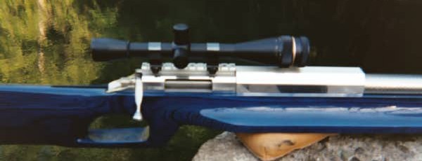

I use Remington's and a pile of customs depending on what the guns purpose is.
Many of the customs in my humble opinion are not all that Custom.

The more important is the positional tolerance and run outs to datums. At work (aerospace) lots of parts are positional +/-.001 or less for lots of holes (I don't run those parts) . Alot of the parts I run are concentric .001 (cnc crush form grinder).
That's an example of what we're talking about. Websites don't talk about stuff like this.
You're absolutely correct and this is stuff that most people outside the industry have no idea about or a very incomplete/incorrect understanding.
It's easy for guys like me and you to tell right away who knows what they're talking about and who's making shit up to sound like they do.
No, after a 25 year career in precision manufacturing I bet I don't
BTW, what kind of diametral tolerances is Borden holding? Numbers please, not website bullshit. You know, something like this: +/- .0002"..........
