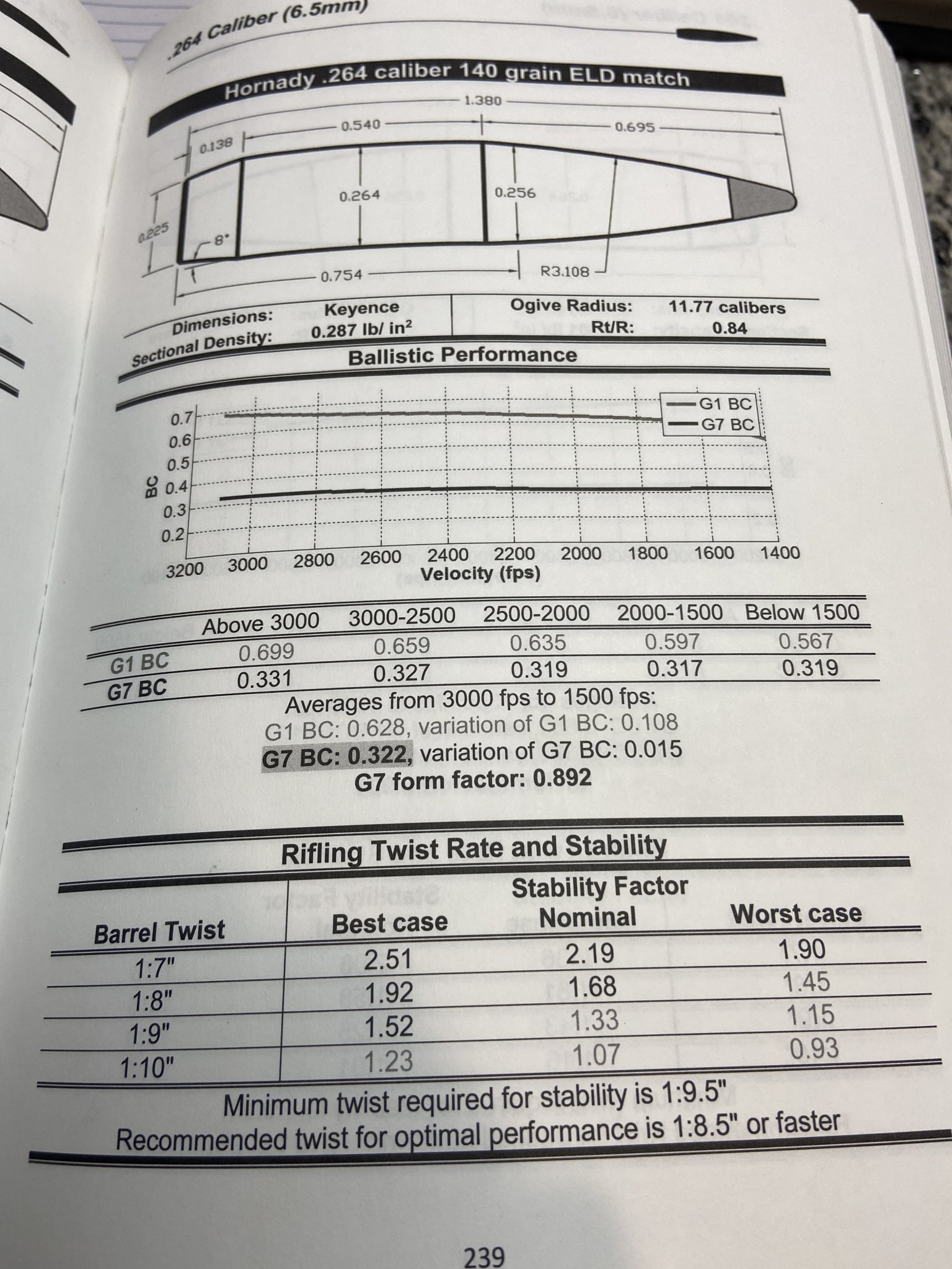

To get a better understanding of the effect the boat tail angle has on stability during transsonic.
Is that something you can help with or were you just questioning the question?

So the only thing I can offer is the comparision of the 168gr TMK and SMK. The two boat angle differ quiet a bit I believe it was 13deg for the SMK and 8deg for the TMK or something like that. It was a conversation I had with Phillip from sierra bullets.
Anyways long story short. Steeper boat tail angle doest do well in transition. The really good example of this is the 190gr SMK that bullet is just super stable.
*Bryan Litz also talk boats tail angle as a solid rule was 7-9 deg for stability. But that just off the top of my dome piece

for the 147 eldm the others you can look up online it's free

Also, my understanding of aero / physics says "11deg and things get interesting". So I agree with Bryan and 7 to 9 deg, makes sense.
Thank you!
My google-fu must be broken this is what I was looking for. Thank you very much.
