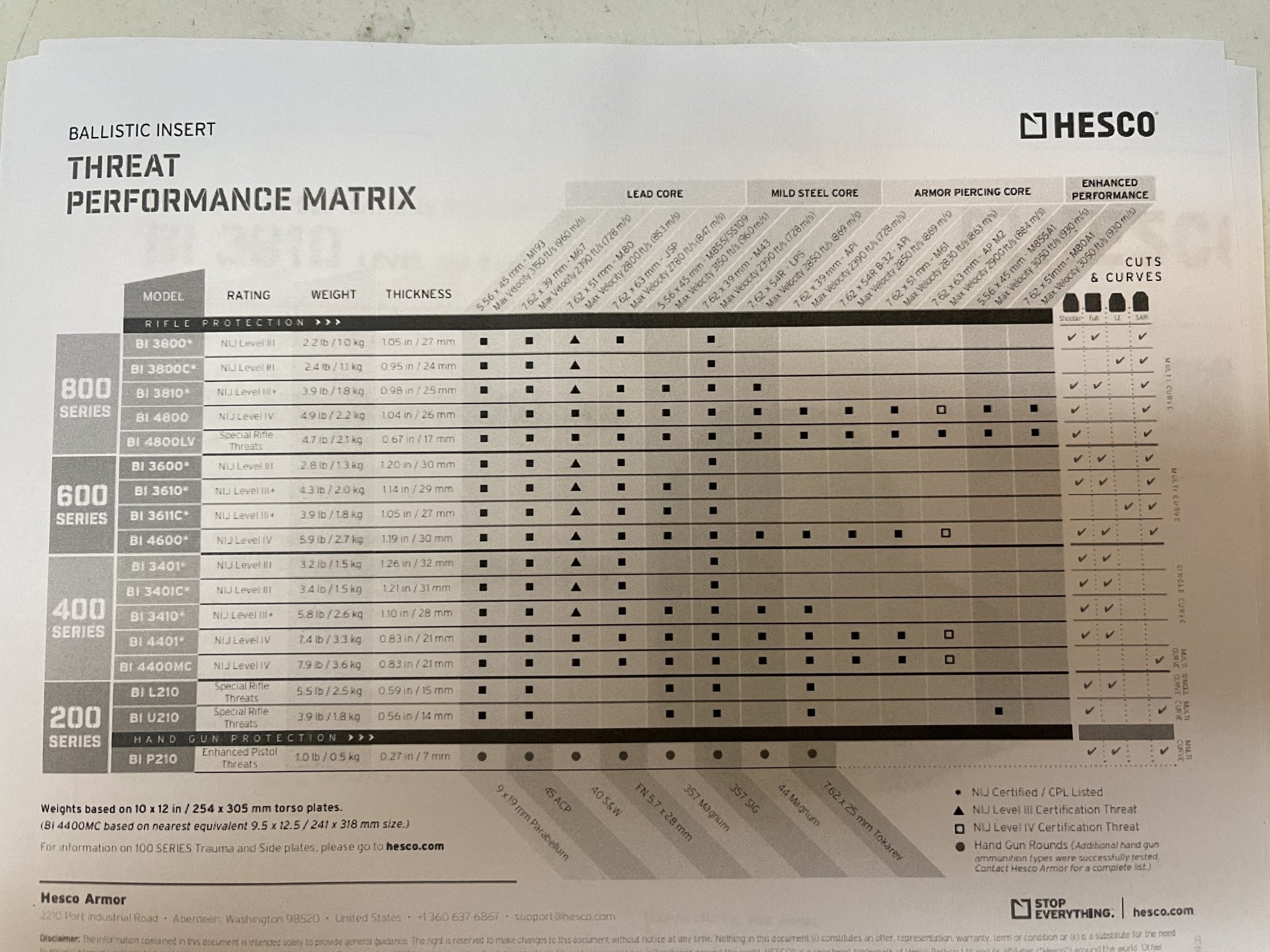

Another thread recommended the Point Blank Paraclete plates linked below. They’re fairly comparable to the L210’s but you get multi-curve, and they’re less than half the price of U210’s (looks like you do give up M855A1 protection though).
L210’s - .59” thick, 5.5lb/ea, single curve, $185/ea
Paraclete - .55” thick, 4.8lb/ea, multi-curve, $342.14/ea
U210’s - .56” thick, 3.9lb/ea, multi-curve, $700/ea
I bought some closeout (LAPG had them at $75/ea) Paraclete Lvl III ICW plates a few years back for search warrant services, and have been very happy with them. I’m already mandated to wear my soft armor when I’m on the clock, so it made sense to save myself some cash (and weight) and go with ICW plates. Now I’m looking for a standalone set to keep in my truck, and thinking these Paracletes are my choice.
I have the 4401s. When I compare my minimal carrier (First Spear SST) to my son-in-Laws mayflower w/medium esapi plates , his kit is likely 6# lighter and he has a shit load of pouches, etc. His plates are about 4.3# and the 4401s are 7.3. Doesn’t sound like much but that’s more than a full mag shingle and a small radio. Over time, weight hurts so if you’re going to spend any time in this thing buy the lightest high level plates you can afford.
My next carrier will be more like his. A “full service” carrier with some more padding, likely for a large sapi. I will say that I am finding that with my chest size I like the shooter cut plates up top. When I press the pistol forward my chest pushed the plate and I “pinch” it. A wider plate seems like it would be too inhibiting, but that’s speculation on my part as I haven’t had an opportunity to shoot in a large or XL sapi.
Reactions: SilentStalkr
My next carrier will be more like his. A “full service” carrier with some more padding, likely for a large sapi. I will say that I am finding that with my chest size I like the shooter cut plates up top. When I press the pistol forward my chest pushed the plate and I “pinch” it. A wider plate seems like it wood be too inhibiting, but that’s speculation on my part as aI haven’t had an opportunity to try a large or XL sapi.
Yep. That’s why I was curious as to why one of the guys was recommending the 4401’s over the other. It’s 4 pounds difference! That’s quite a bit, all for some .30 ball protection. I mean it could happen but not as likely as the others, imo. Regardless, you don’t want to get hit by any of them. For most of them you might survive the shot, but the trauma is a different story.
The difference between L210's and a true level IV like 4401's is:
- Every long-action hunting round is going to check your shit in L210's
- That 7.62x54R round in some Antifa's $100 Mosin is going to check your shit
- M855A1 AP is going to check your shit
Or.... run level IV like 4401
I hate to break it to you, but any of those rounds is going to check yo shit on 4401’s Also. In fact, you may rather it pass on through than deal with the trauma you likely to get regardless of what plate you running. Haha.
Reactions: Anb618
I don’t need to try again. The goal is to not get hit. There is absolutely nothing wrong with the Hesco 4400’s if that’s what your are looking for and don’t care about the extra weight. Everything has tradeoffs. They are 4lbs heavier than the L210’s. If you need the extra protection and don’t care about the weight and the addition of more weight with a backer and so forth then they are a hell of a deal. Hell for the price it’s worth having an extra set laying around. Most of these plates will do what they are advertised to do to some degree or another. So,if you are just trying to get in the game you can’t really go wrong with either one. I’d say buy both but then you just should have got some 3810’s. Regardless, I don’t want to be hit by anything with any of them.
Gonna need to step up to the 4800 at about $1250/plate for all the protection. We can go down this road all day long. From what I've read from people who seem to know and actually use and wear plates advise maneuverability > protection. Give a little to gain a lot.
I have both 4401s and 3810s. I'm rolling w/ the 3810s. It's night and day.
Reactions: plong and ndaholic
What % is almost-99%?
The avg joe blow who would actually engage in a gun fight with you is not walking around with m855a1. 99% are using regular m855 m193 of any other fmj. 3810s are rated a to stop that. Add a trauma pad and you get some added protection behind the plate.
Yes sir. Being light and nimble with most of the protection is where it’s at imo. But to each their own.

U210's are the best plate out there IMO for combination of likely threats, size, weight and they can be had in SAPI sizes like L and XL.
Stryker laid out alot of really great points. However I want soft armor coverage (BACLS/Mayflower/MBAV) and armored cummerbund.
You will most likely not have a combat medic or paramedic with you. May not even be able to get to advanced care. Plan accordingly.
For the most part, the generalized difference between 4 standalones and 3+ is you are trading out some AP protections versus weight reduction. You could get your cake and eat it too with Hesco 4800s as they are a lvl4 that weight about what most 3+ weigh, but they're also something like 1200$ a plate.
Your main threats short of being up against weird oddball calibers or the guy with the fucking 50 hanging around are M193, M855, M855A1, 7.62x39 (think Golden Tiger), 7.62x51 (non AP) and surplus 30.06, 7.62x54R and 8mm.
The most realistic threats to focus on are all of the flavors of 5.56 and import non AP 7.62x39. Most regular guys will be shooting whatever shit they had at Walmart. The reason the shooting to death ratio in Chicago is so low is because most of the shootings are done with handguns as well as using Winchester White Box 9mm or whatever. Other food for thought is - what are your local police issued/allowed to use in their carbines and what ammo did all of the new gun owners who don't know shit about anything go out and buy?
I have 2 carriers for 2 different purposes; mounted/dismounted.
Dismount I use a Crye SPC with a swimmer cut 3+ in it that weighs 4.2lbs a plate that I barely notice. Mounted I use a Velocity Systems SCARAB with Ceradyne lvl 4s in it that are 6.9lbs a piece (I think). Why? because dismounted I want to drag as little weight as possible while stopping what I'm likely to be up against. Mounted you are generally trapped in a vehicle if ambushed/attacked and they usually don't shoot at vehicles with low caliber weapons (usually), so the added weight makes sense as I'm not planning on being outside of the vehicle long enough to where the extra weight matters, or if I am, its not the end of the world.
