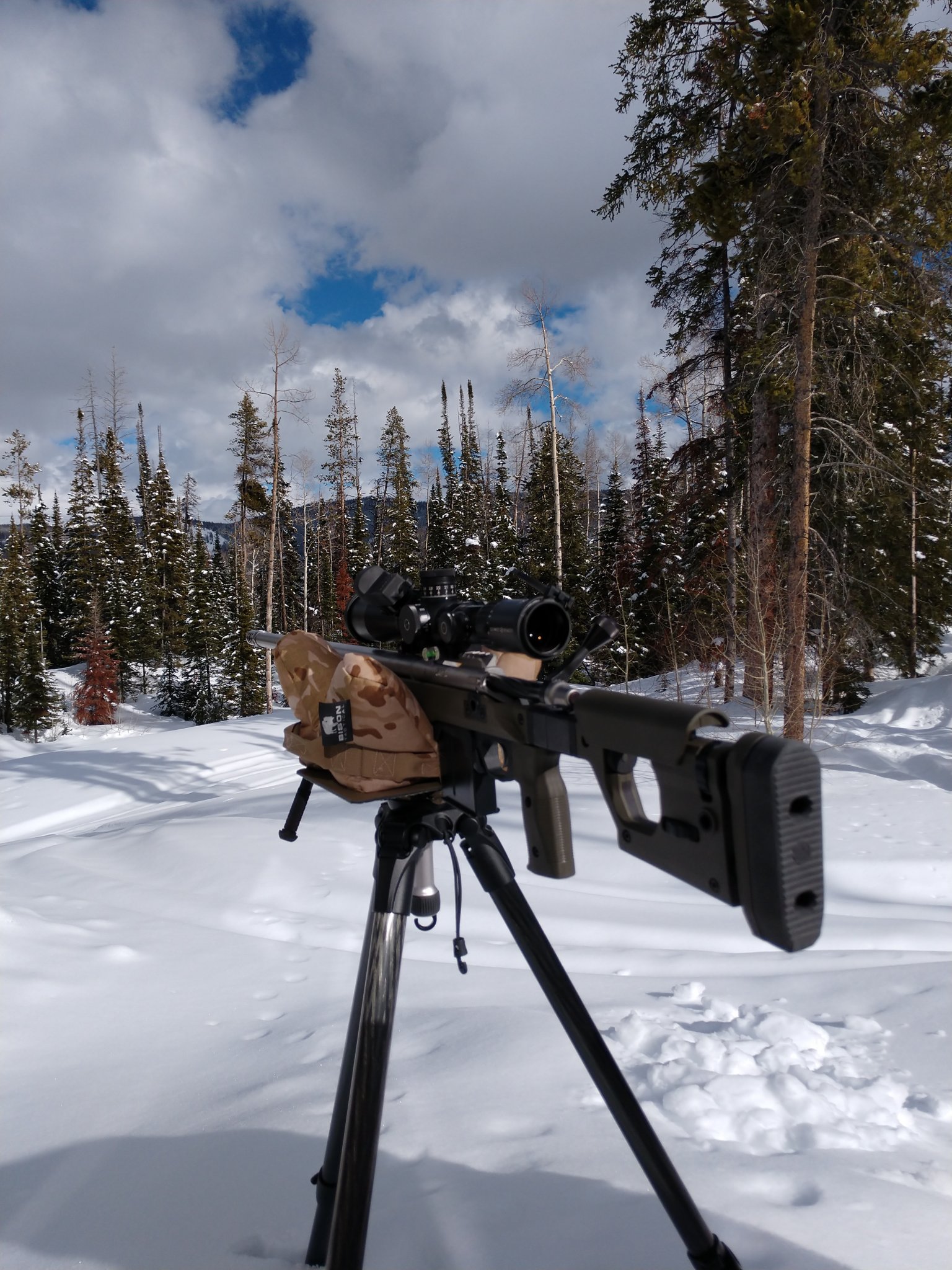

My experiences with the Bog tripods are they are not very stable. Looking at the specs for the Death Grip, they are also very heavy. The Carbon Fiber model is 7.5-lbs. The Aluminium model is nearing 10-lbs. I have a Manfrotto CF tripod with Hog Saddle which is 3.9-lbs, and under 3-lbs with the Precision Shooting Platform.
Suggest you go to a used camera store, or look on eBay, where you will find a quality tripod for a low entry price.
Get one with a 3/8-16 stud on top, and you will have quite a few options without breaking the bank.
You can go with a simple saddle, that is inexpensive, like the one Precision Rifle Solutions offers for (SSP-2) $58
The Precision Shooting Platform (PSP) from A-D Precision offers a product that is very versatile, where you place a bag on top. It's $160
www.alphadogprecision.com
I have a lot of experience with clamping type set ups, and there are various problems like needing to have the tripod leveled, if not you will induce cant to the rifle. Also, clamping the rifle into the tripod doesn't dampen the recoil, and causes the tripod to move or shift, and often requires adjustments for a follow-up shot.
