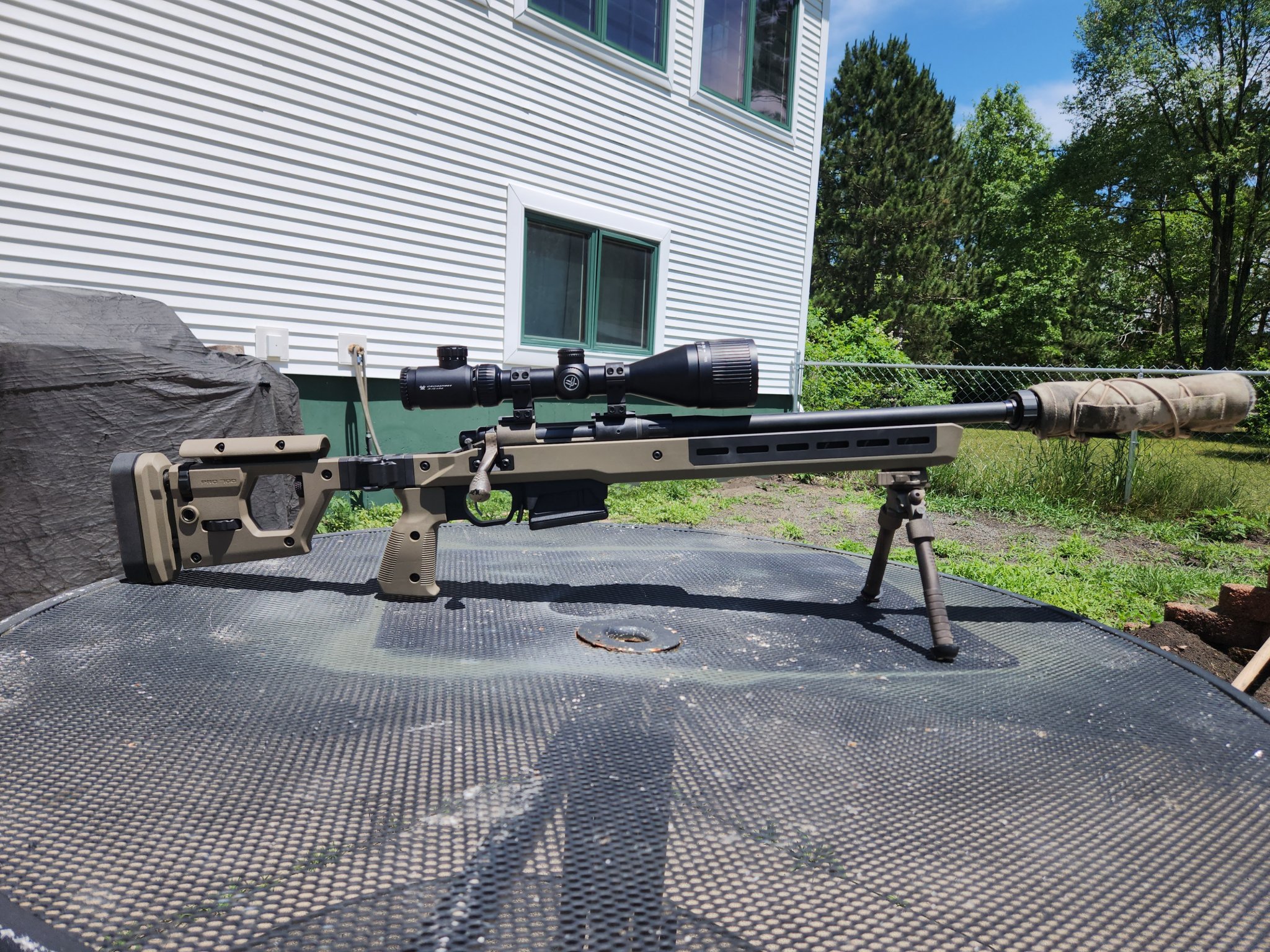

Well, here is my finished "cheaper" Fix.
A Rem 700 with a 16" Faxon barrel, a Hybrid 46 suppressor with a 30 cal endcap, a Magpul Pro stock, and a Vortex 3-12x56 Hog Hunter scope.
Yes, it weighs a bit more than the Fix, but I put it together out of an existing 700 and a $350 barrel. So saved a bundle.
It shoots sub moa and the last trip out I shot 10 rounds of super sonic Hornady 225gr CX @ 75 yds and had 5 shots in one ragged hole.
Next is to start working up sub sonic loads.
