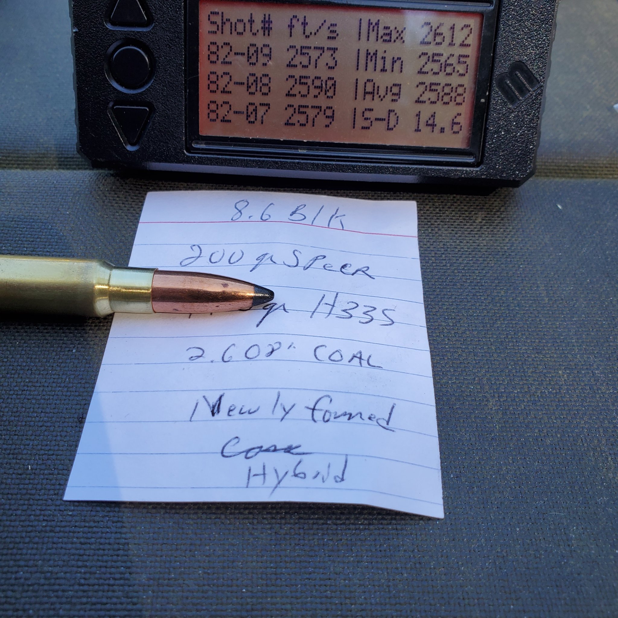

This is what I run ....
8.6 Blackout ...200 gr Speer to 2600 fps.
225 gr Speer 2400 fps, 250 Speer GS 2200 fps, 300 gr SMK 1970 fps....for supers.
The Speer bullets are short in OAL so they allow more powder capacity.

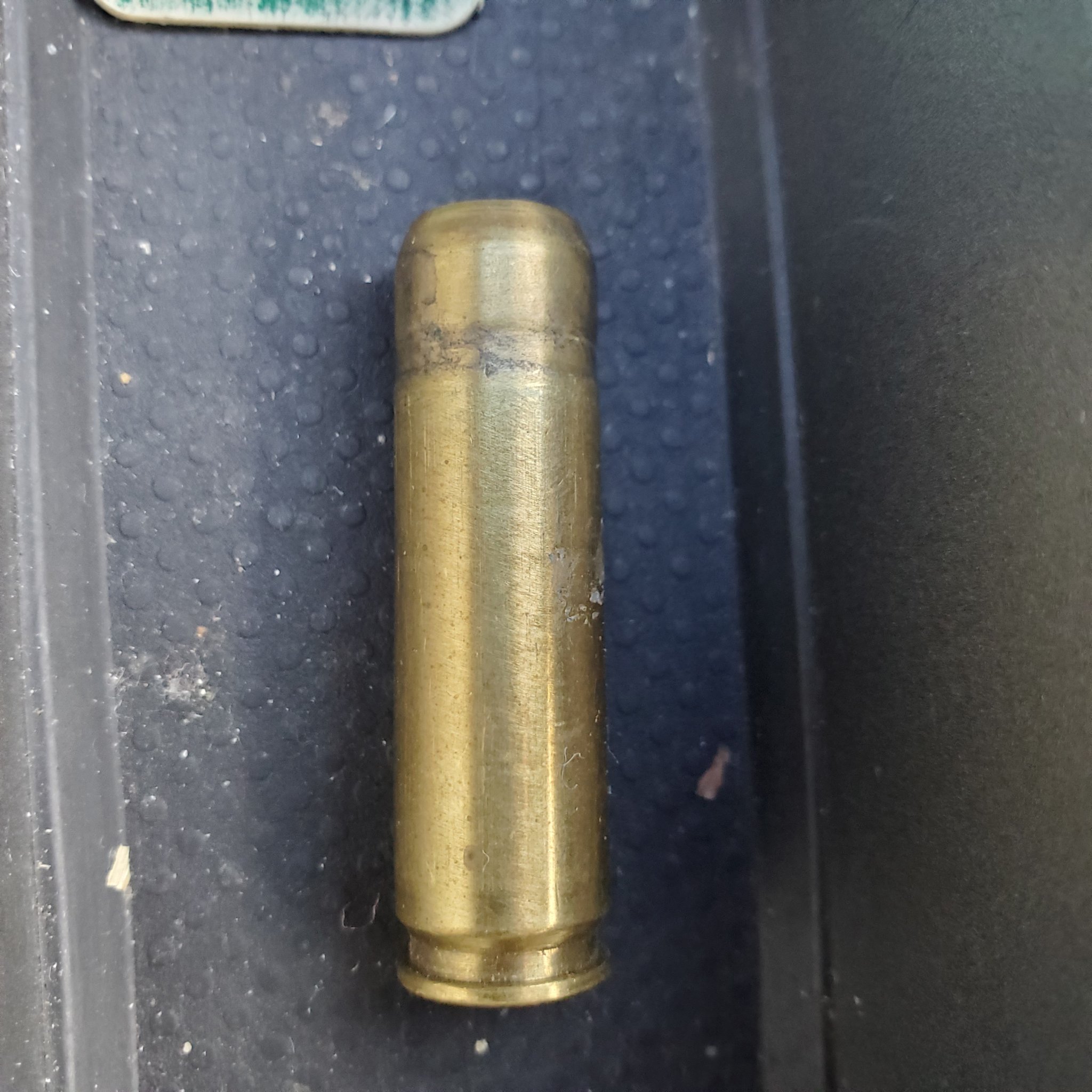

I also utilize hybrid cases and run to 65,000 psi loads in QL...they have a bit mire capacity.
You can not duplicate these velocities in a 3 twist, it Max's out around 2.5 to 3 grs less powder, as I ownd both 3 and 6.5 twists.
And those lead cup & core bullets can Not be shot past 1200 fps in a 3 twist barrel, full copper only for supers... even the 350 copper expanding Maker can Not be shot over 1050 fps according to Maker...I shoot them to 1670 fps in the 6.5 twist with accuracy.

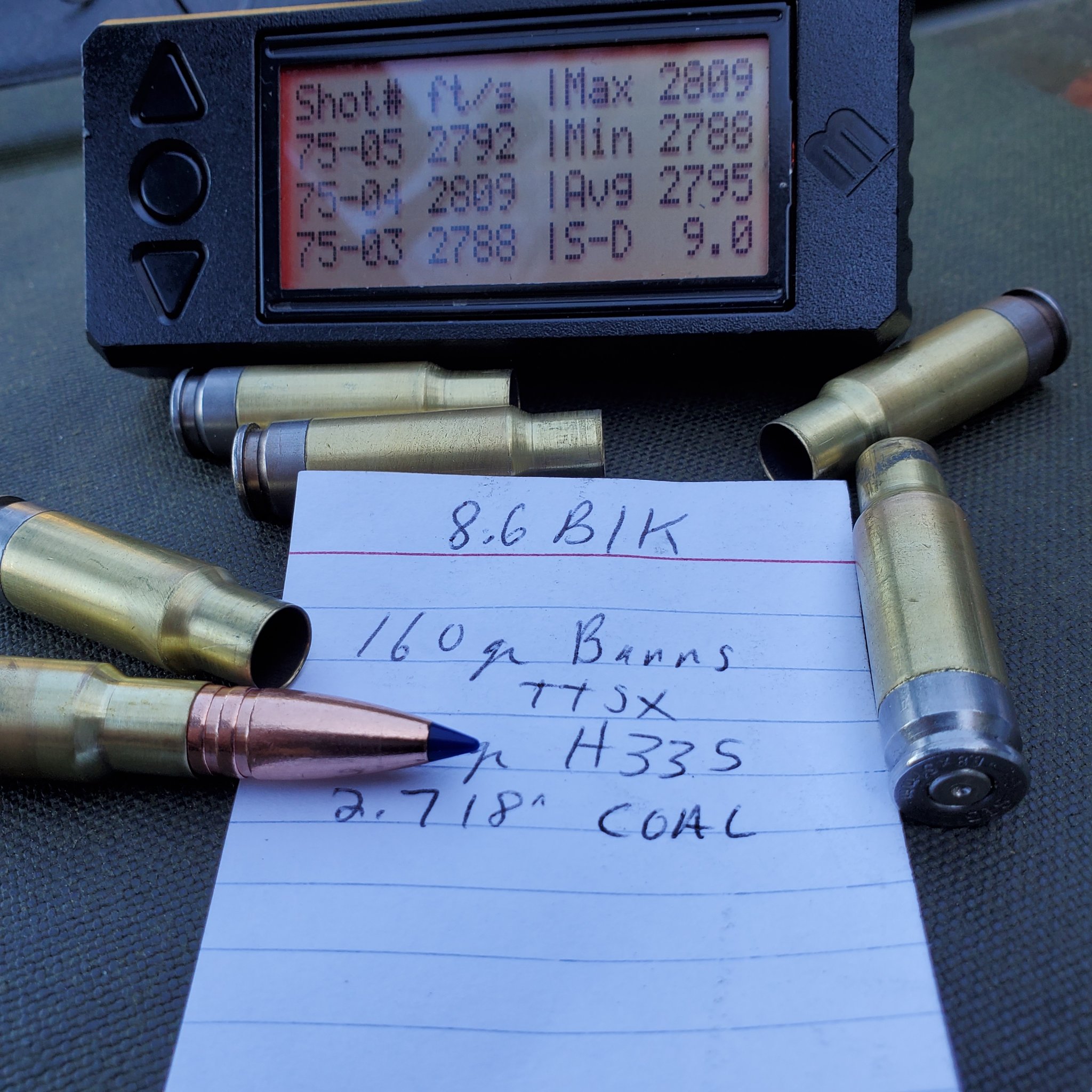

Can't see the charge weight but here is the 8.6 Blk with 160 gr Barnes at 2800 fps and the 200 gr Speer at 2600 fps.
Do not even try in a 3 twist barrel the bullets will explode as soon as they leave the confines of the barrel.
One can improve things for the 8.6 Blk, but it's still not as good as the 338 Spectre or possibly the new 338 ARC with subs..

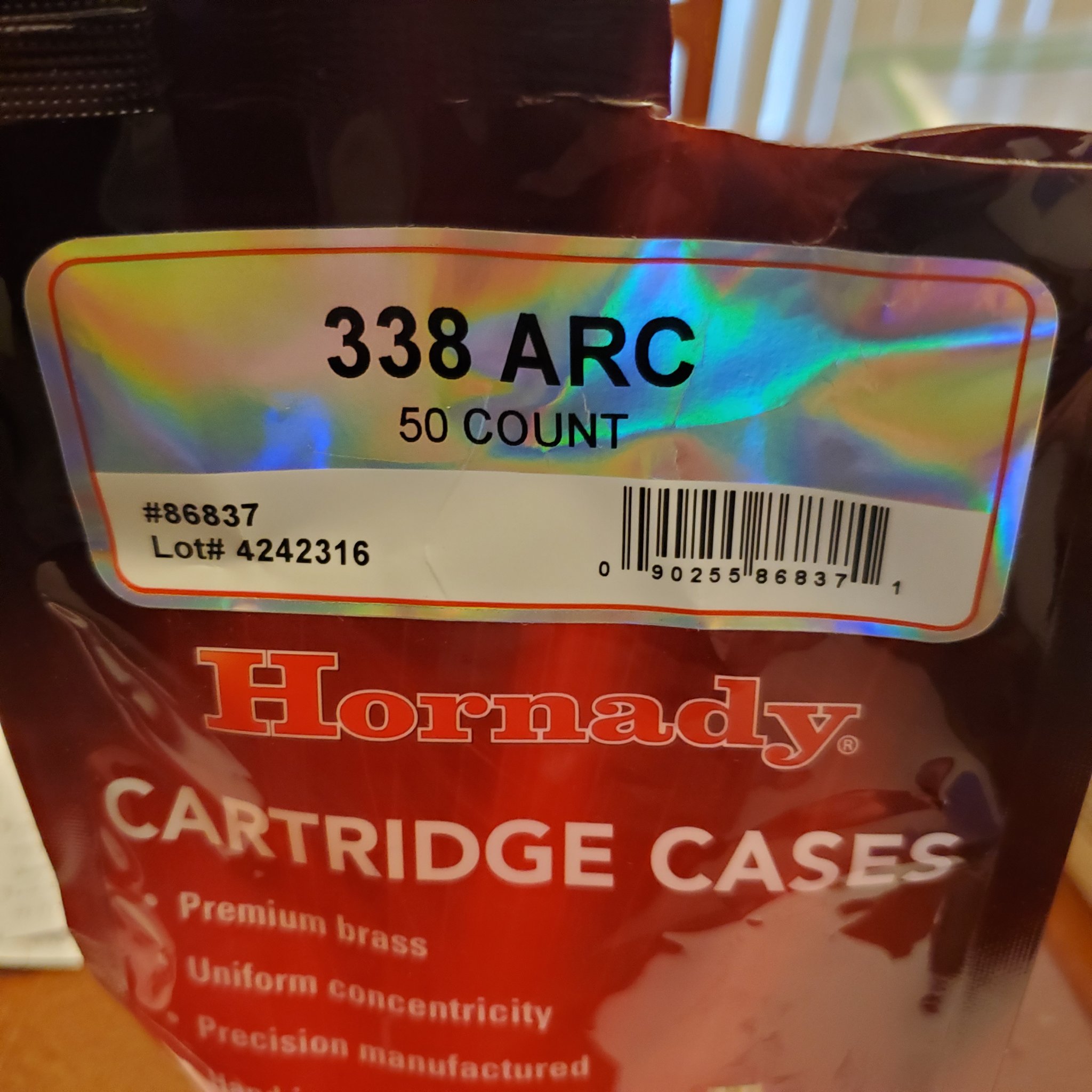

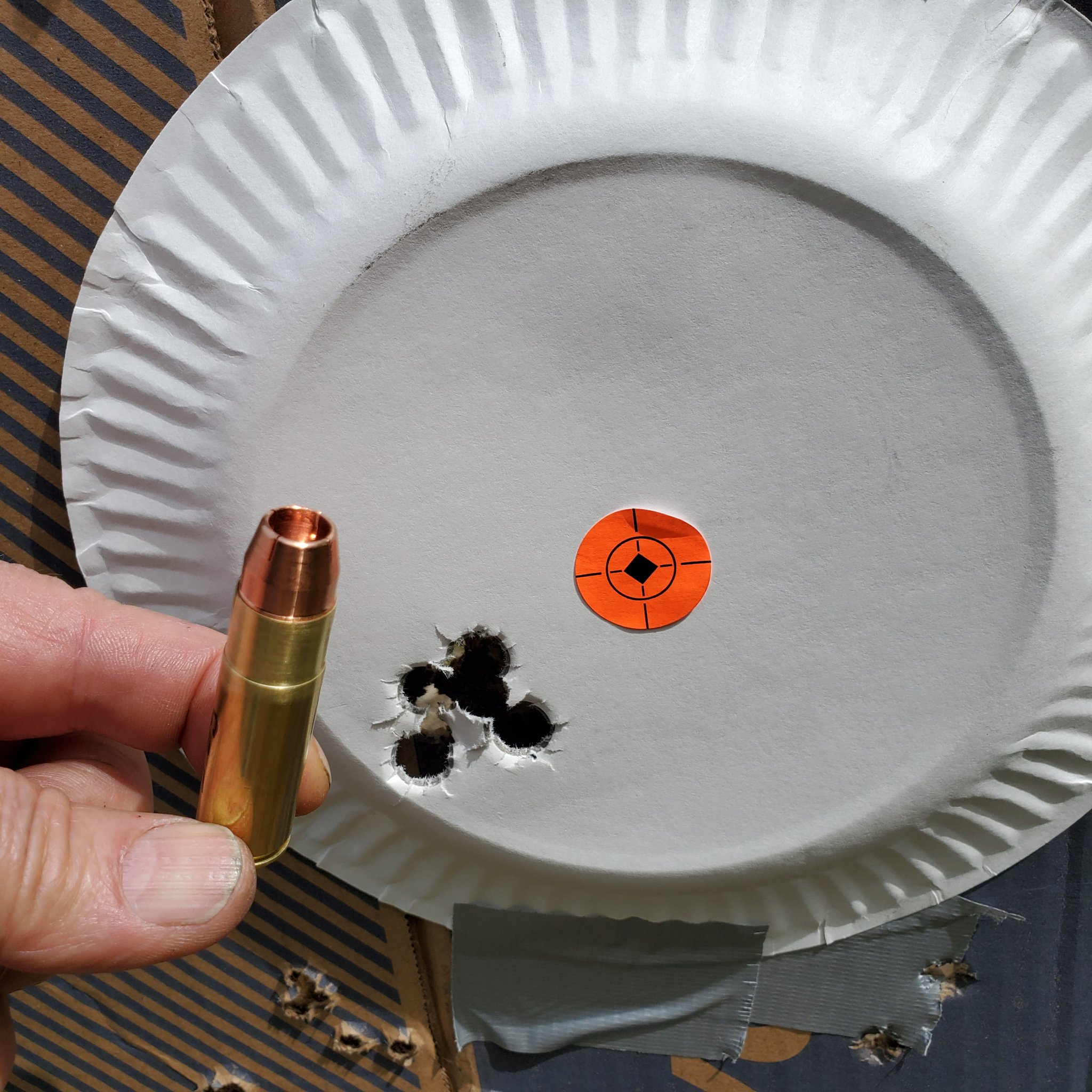

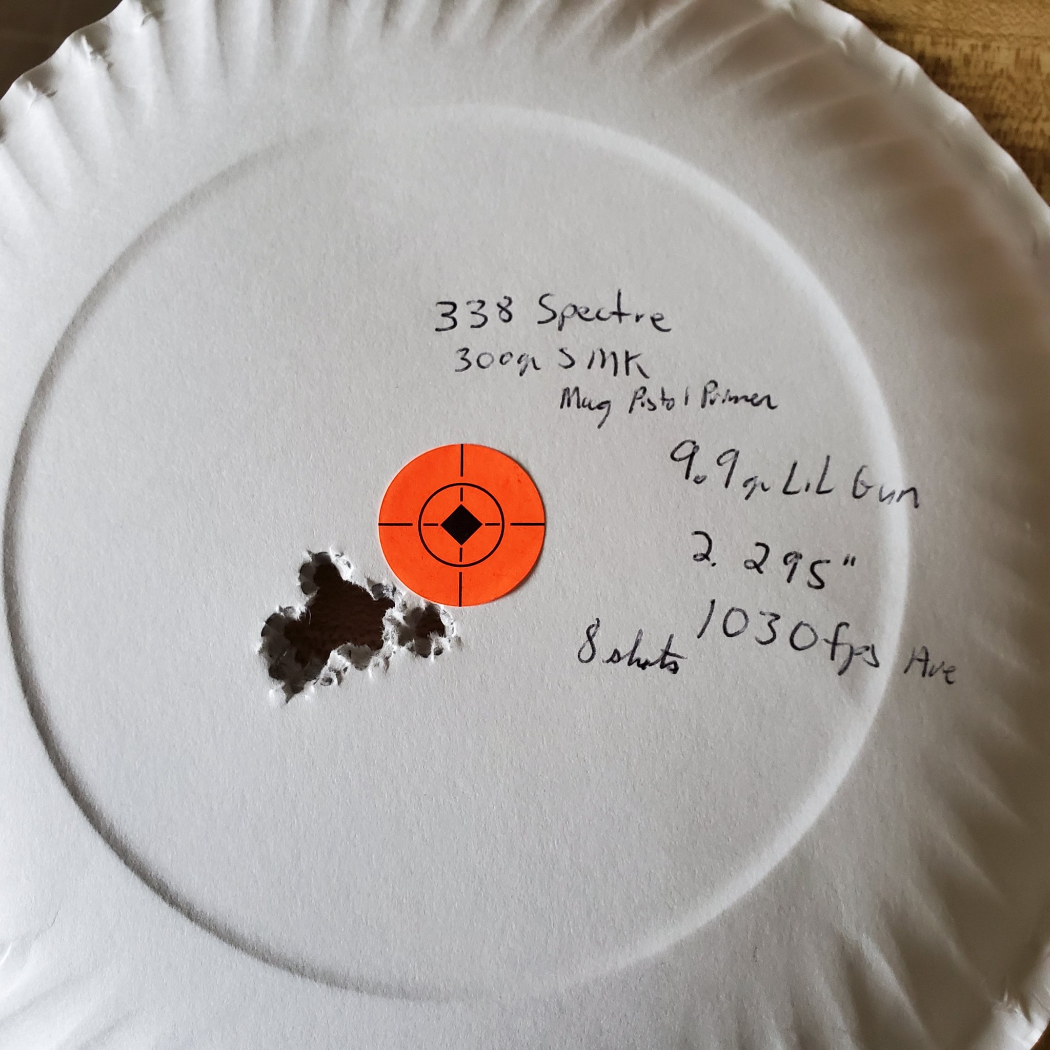

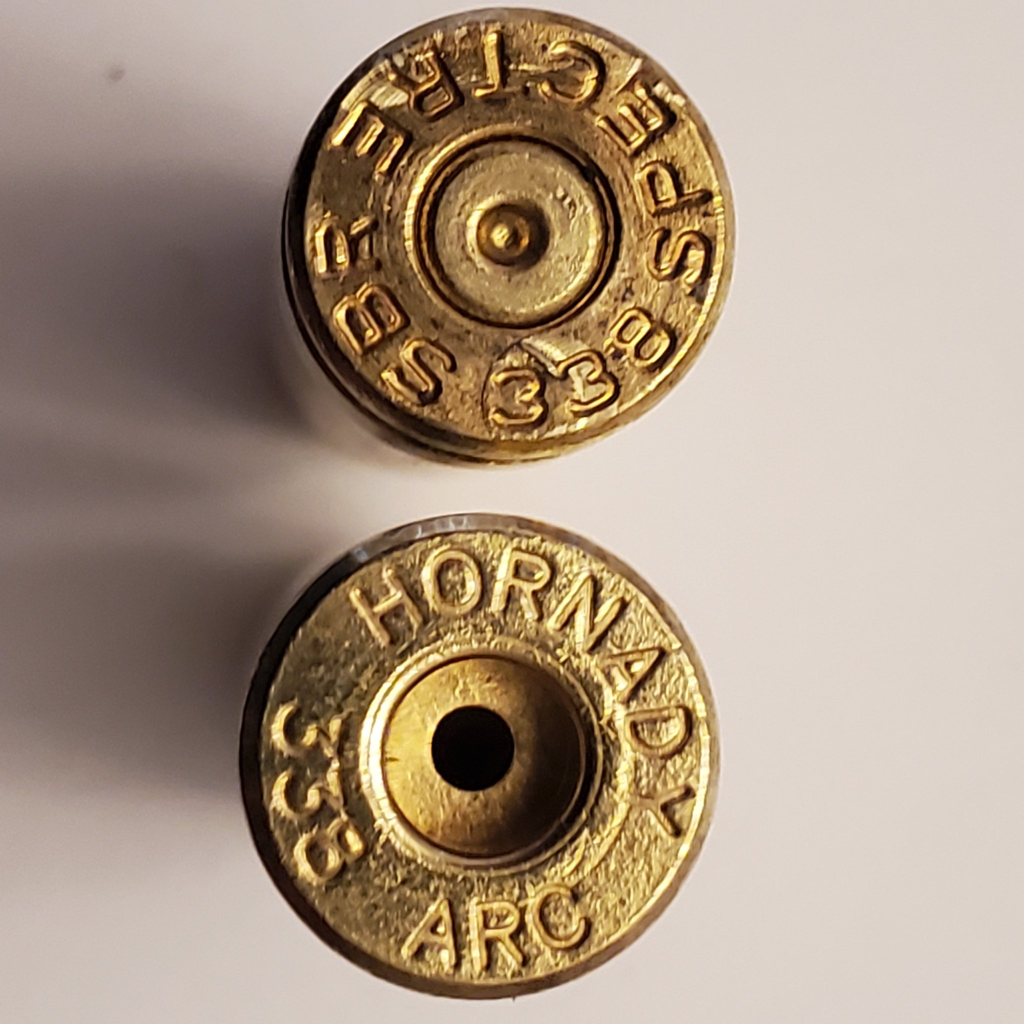

The 8.6 Blackout in 6.5 Twist will fit your needs, especially for supers.
The 338 Spectre is available in AR 15 it's light handy a 16" or 10.5" barrel readily available along with cheap dies and brass.
It has Maker bullets available for it the 165 gr super expansion bullet at 2100 fps down to 900 fps should get you 200 yds max.
But they also have 300 gr expanding subs on the shelf I have some, good for most of your work and one guy claimed to have killed his deer at 200 yds with this tiny cartridge.

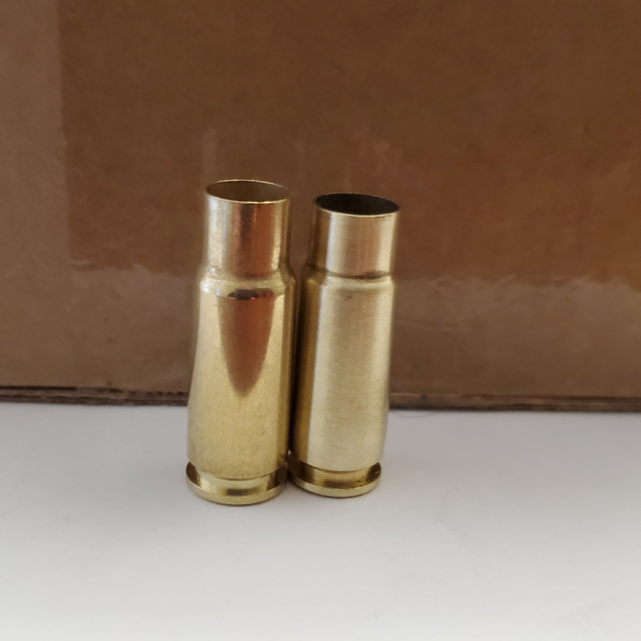

The new 338 ARC is very similar with 30.5 gr H20 compared to 29 4 gr H20 for the Spectre, but Hornady brass is $104 per hundred and Spectre brass oils $46 per hundred, with SR primers.
Just got the ARC brass today, they are very similar.
So its your choice, but for best accuracy, low powder consumption, good case fill, good velocity spreads, with subs, these tiny cases make the most sense, the 338 Spectre is already available, the 338 ARC is on the way. These are AR 15 platform, much lighter than AR 10 for the 8.6 blackout and do the same job with 300 gr subs, and are so much more accurate than my 8.6 AR 10 with its rough Faxon 3 twist.

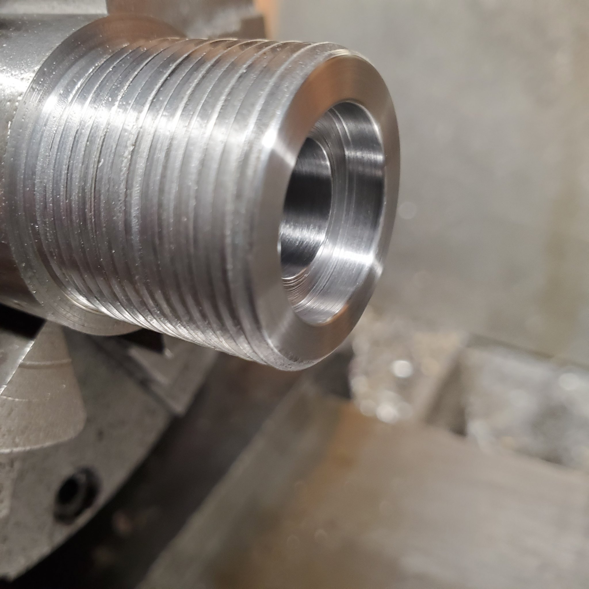

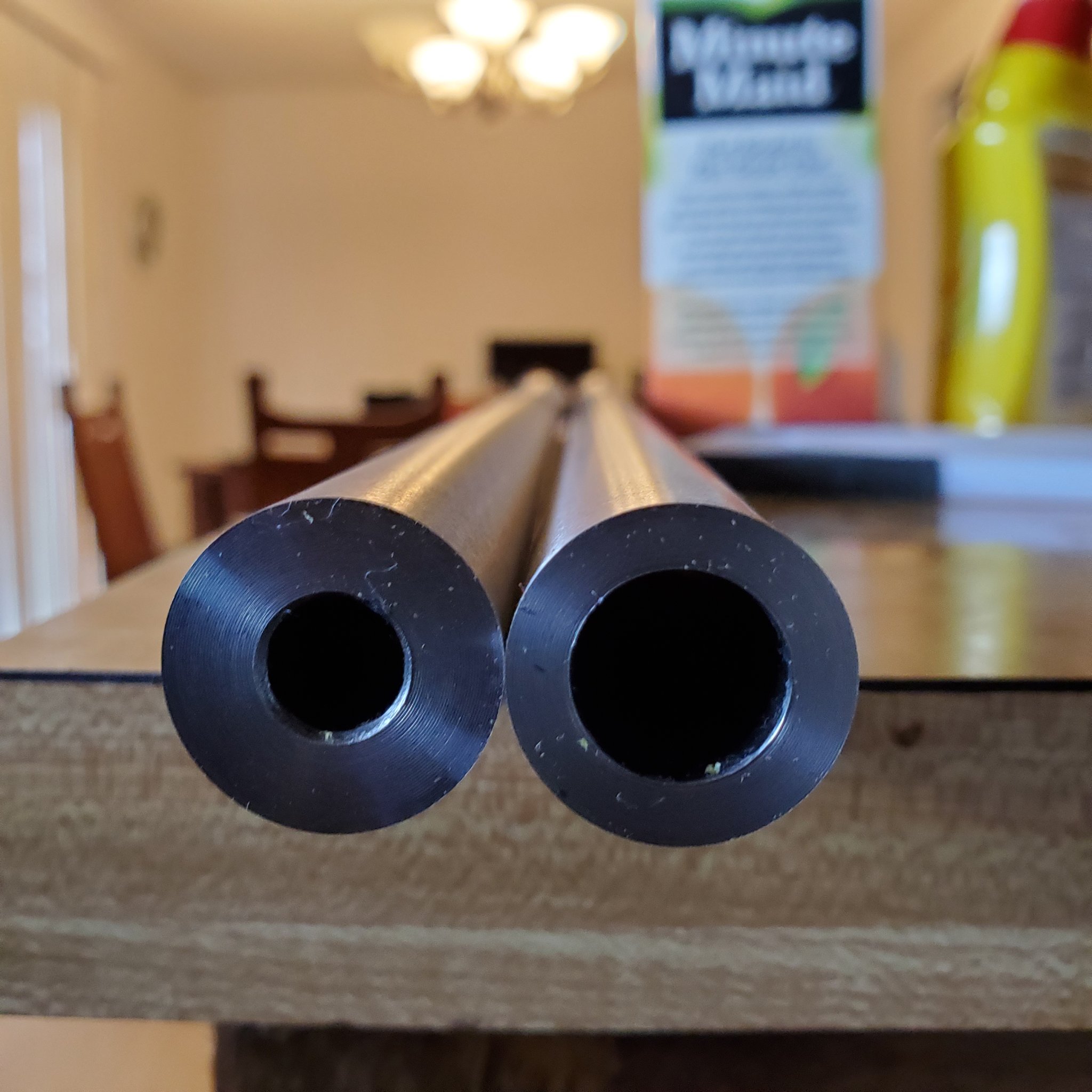

I build my own rifles and buy chamber reamers so I have the 8.6 Blackout finish chamber reamer.
Here are 2 subsonic barrel blanks one 6.5 twist for the 8.6 Blackout and one 10 twist for tbe .510 Whisper.
The 8.6 chambered.

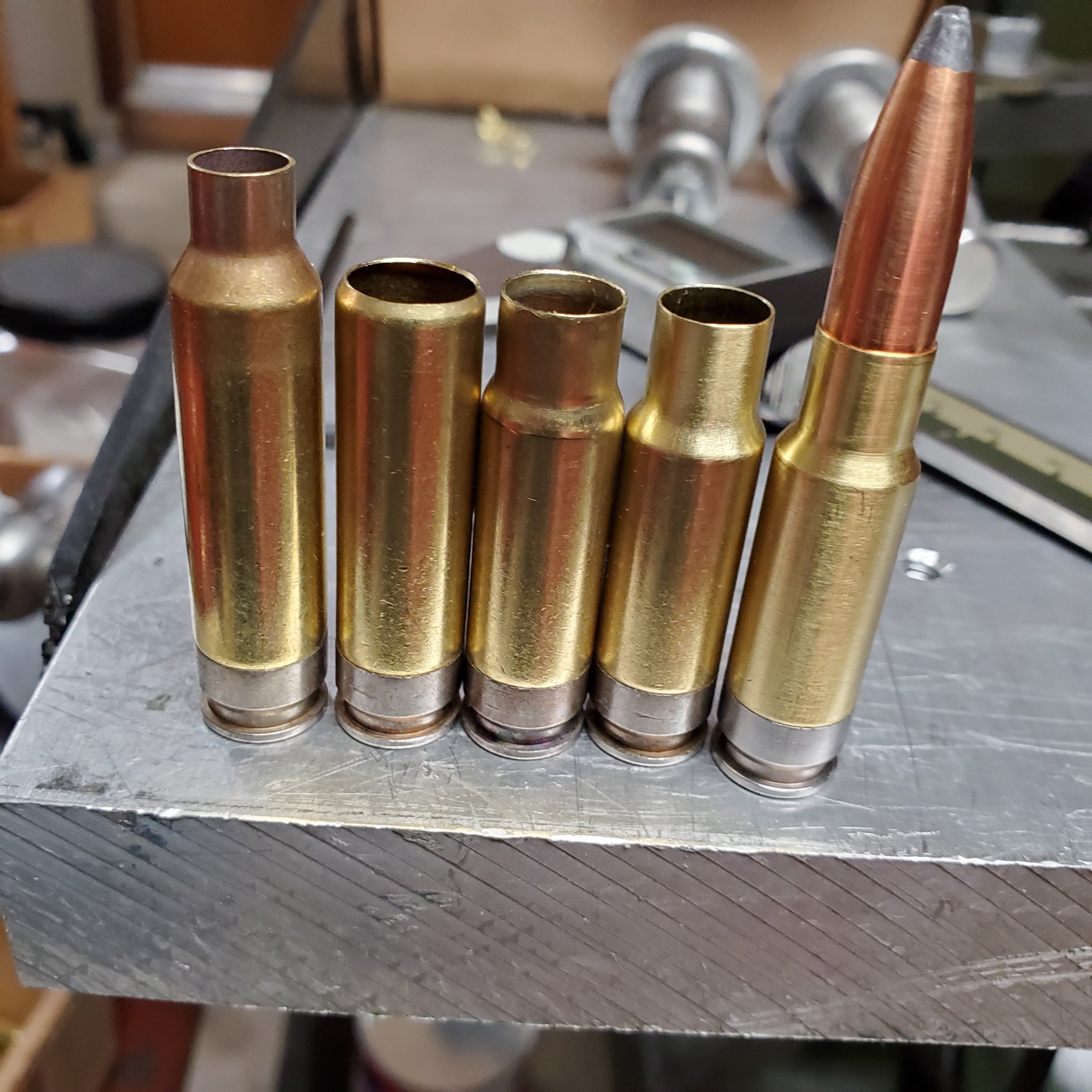

I also use hybrid cases with SS case heads for my 8.6 supers.
But you won't be doing any of that instead get Alpha Munitions 8.6 Blackoit cases they have good brass, on sale now.

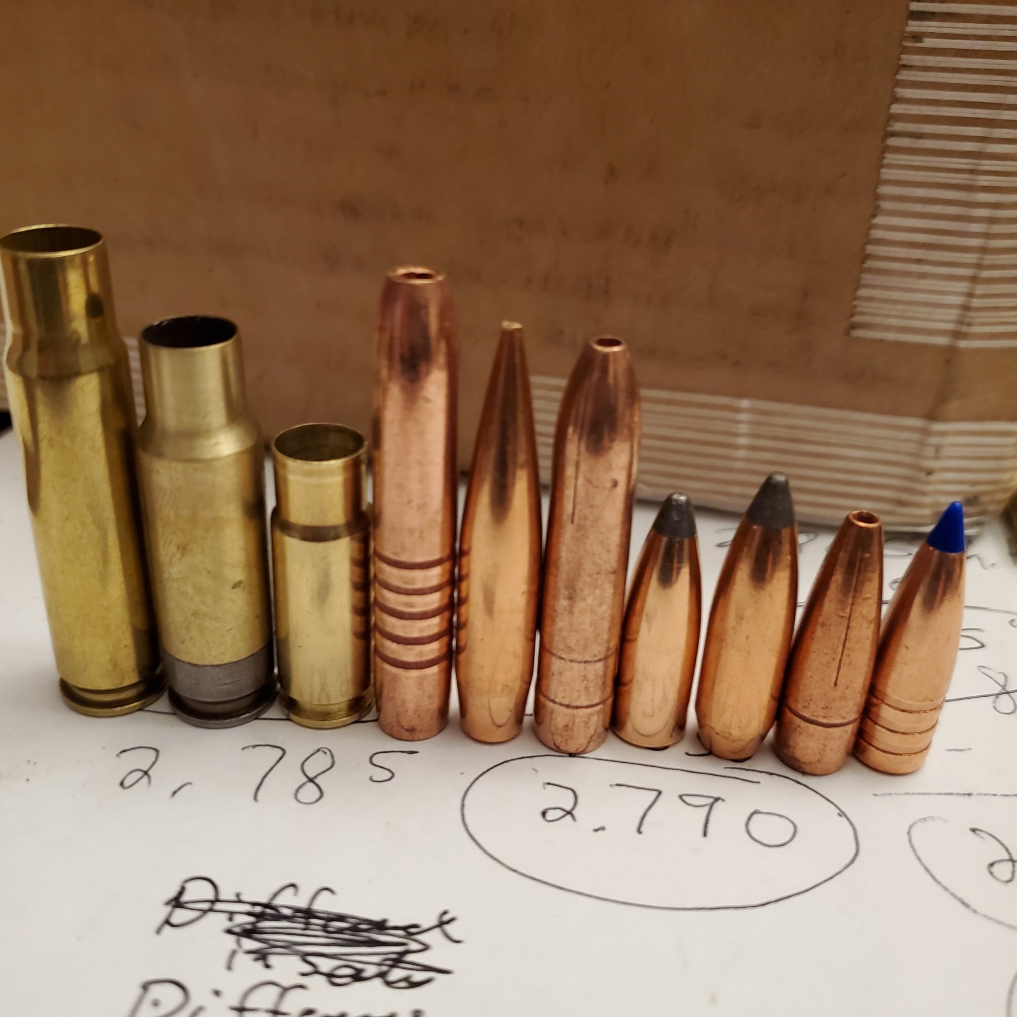

These are the cases represented 338 Federal, 8.6 Blackout, 338 ARC( or 338 spectre almost identical).
The more case capacity the faster the supersonic velocity will be.
But harder to get good consistent subsonic ballistics as case volume increases, with bullets of the same length.
It's just physics of smokless powders.
The short bullets up to 225 grains are suitable for supers in the standard 338 Federal.
But they will not expand at subsonic velocities, having very little killing power.
Like an arrow without the broadhead attached.
Most of the bullets that expand in the subsonic arena are heavy like the 300 gr and 350 gr (long ones pictured)...and they require a 6.5 twist. Twice as fast as the 12 twist 338 Federal.
These bullets would require a COAL too long to fit in the 338 Federal Mag well over 3" and you're into the ogive with no way to secure the bullet in place...not practical.
So here's where the short cases come in to play allowing the bullets to be seated on full diameter of the shank, with most of the bullet sticking out of the case, and still fit the magazine, plus reduced case capacity helping the small powder charge be more efficient.

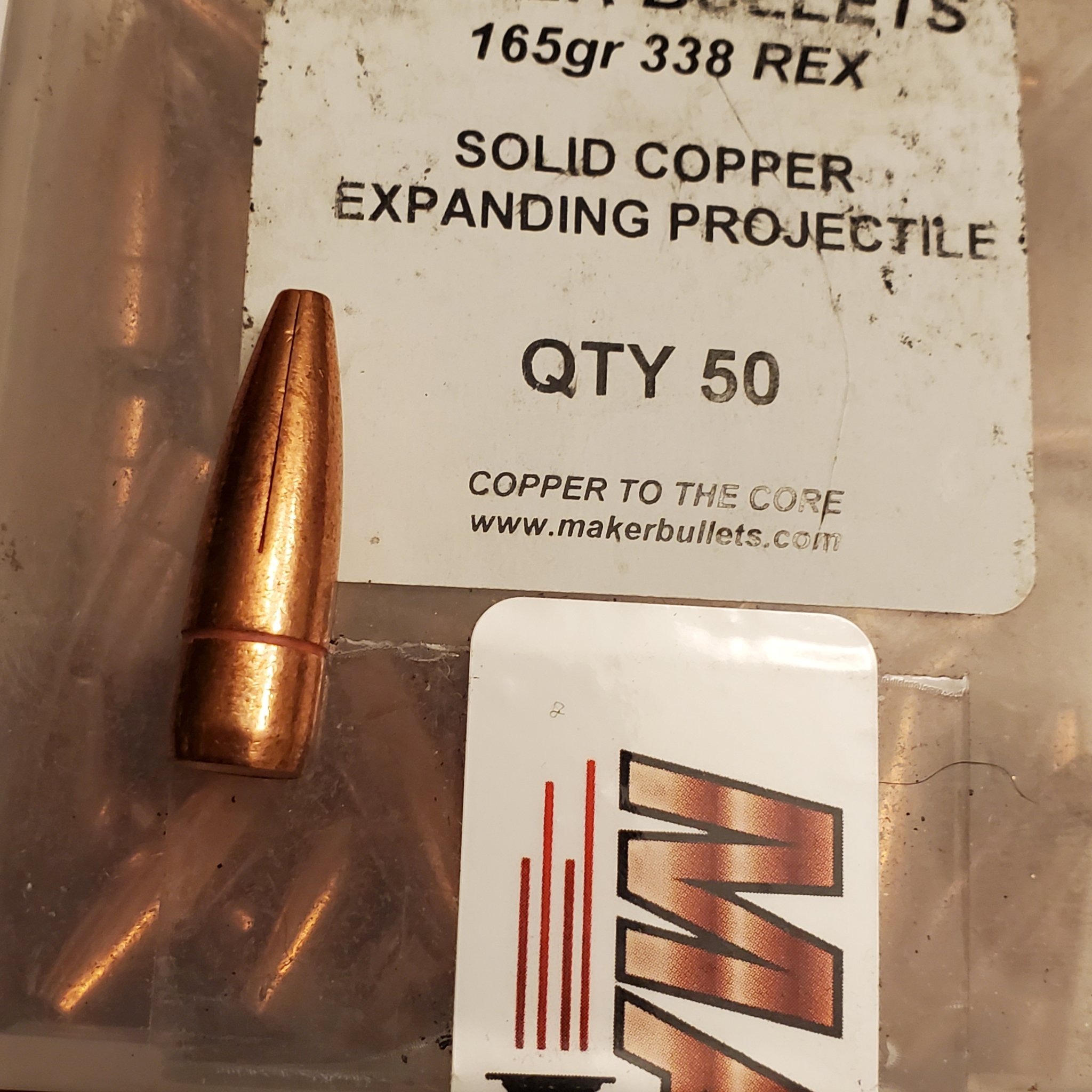

The last picture is a 165 gr Maker, short enough maybe, to work in a 338 Federal 12 twist with its side slits and expand inside 100 yds at max muzzle velocity of 1100 fps...but it's pretty hard to get consistent velocities with all that air space, and no TrailBoss powder available.
But it would be the best bet for any sucess, with much less energy then the 300 blackout hitting the target, by quite a bit with its 220 gr bullet.
It's just how it is ...the physics of bullets, powders, and barrel twists.

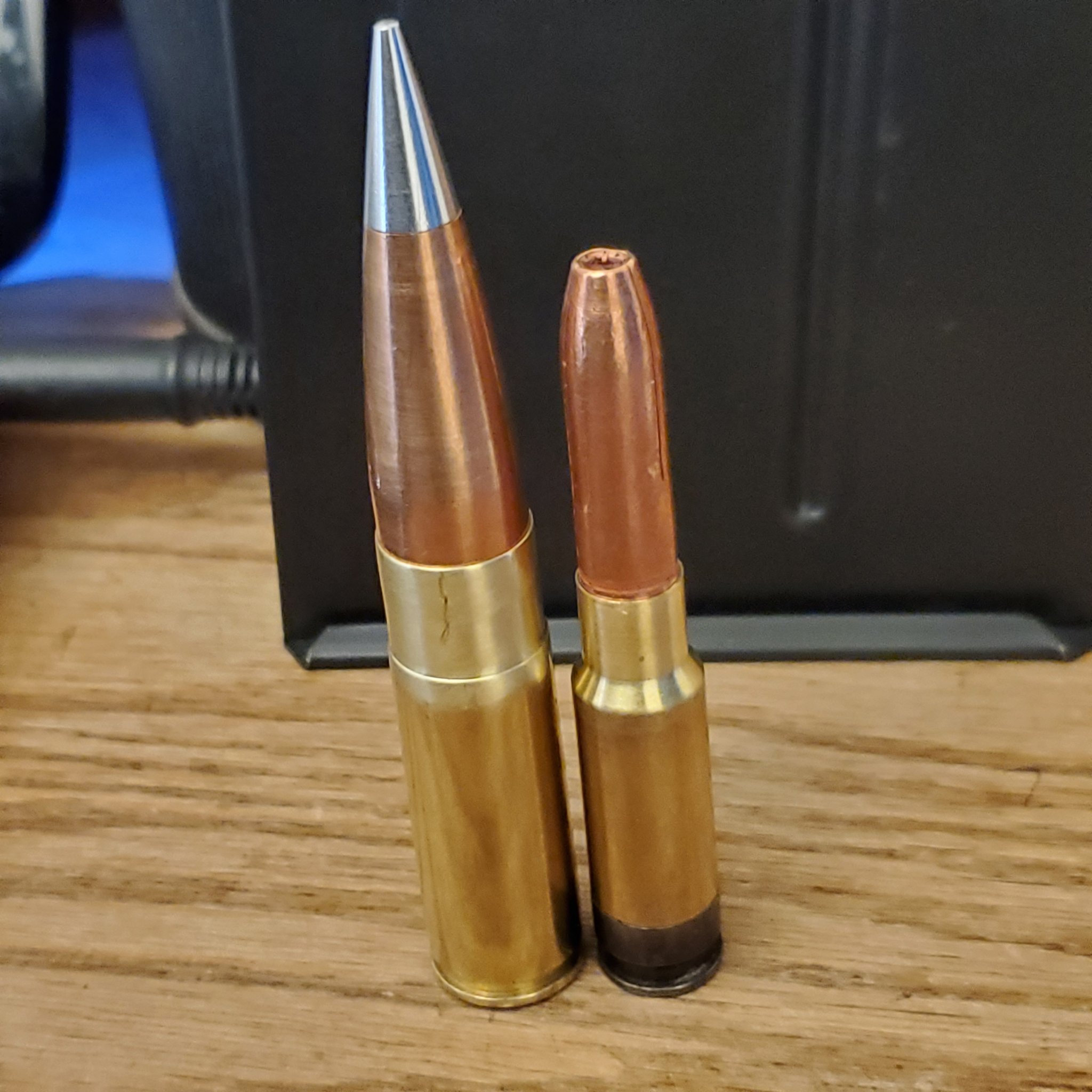

None is perfect for both...it's a compromise. May get the 510 Whisper, 900 gr expanding sub bullets at 1100 fps. Or 350 gr expanding at 2450 fps for 4700 ft/lbs of energy. It will get to 200 yds and even elephant capable with 750 gr solids.
Here is a 350 gr Maker in 8.6 vs a 750 gr 510 Whisper with 750 Atip.
Last pic the 350 gr expansion copper bullet down to 900 fps, but here running at 2450 fps with 4700 ft/ bs... is accurate.
Probably overkill for deer but it's available.

Even Maker who makes subsonic bullets for hunting limits the max speed of the 8.6, 350 gr sub to 1000 to 1050 fps.
The 338 ARC has an 8 twist, no bullets are released yet for the 8 twist ARC in subsonic for handloading not even Hornday, but loaded ammo will.
I use a 6.5 twist and have Maker specific bullets for it plus it will shoot any 338 diameter bullet available copper or lead core.....totally versatile.

Something I just heard is that an 8.6 will chamber in a 308. That 1st shot could get interesting, the 2nd exciting!
Well the 8.6 will chamber and fire in the 358 Win...2 AR 10s same build components, different calibers... one needs to be more careful...pay attention.
It did give a bit of a clue and chambered a bit hard...but I pressed on.
It went bang and ejected this strange case, I instantly got smacked with reality.
It was a dumb mistake, but nothing happened but missing the target.
The 338 bullet just rattles down the 358 bore. Loaded it with the correct 358Win ammo and continued on with range day.
A 308 has a smaller bullet and that could be a more significant problem....if it will chamber....the larger 338 bullet should keep it from chambering in a 308.
I have an AR 308 to try at home...it's something to watch for.
