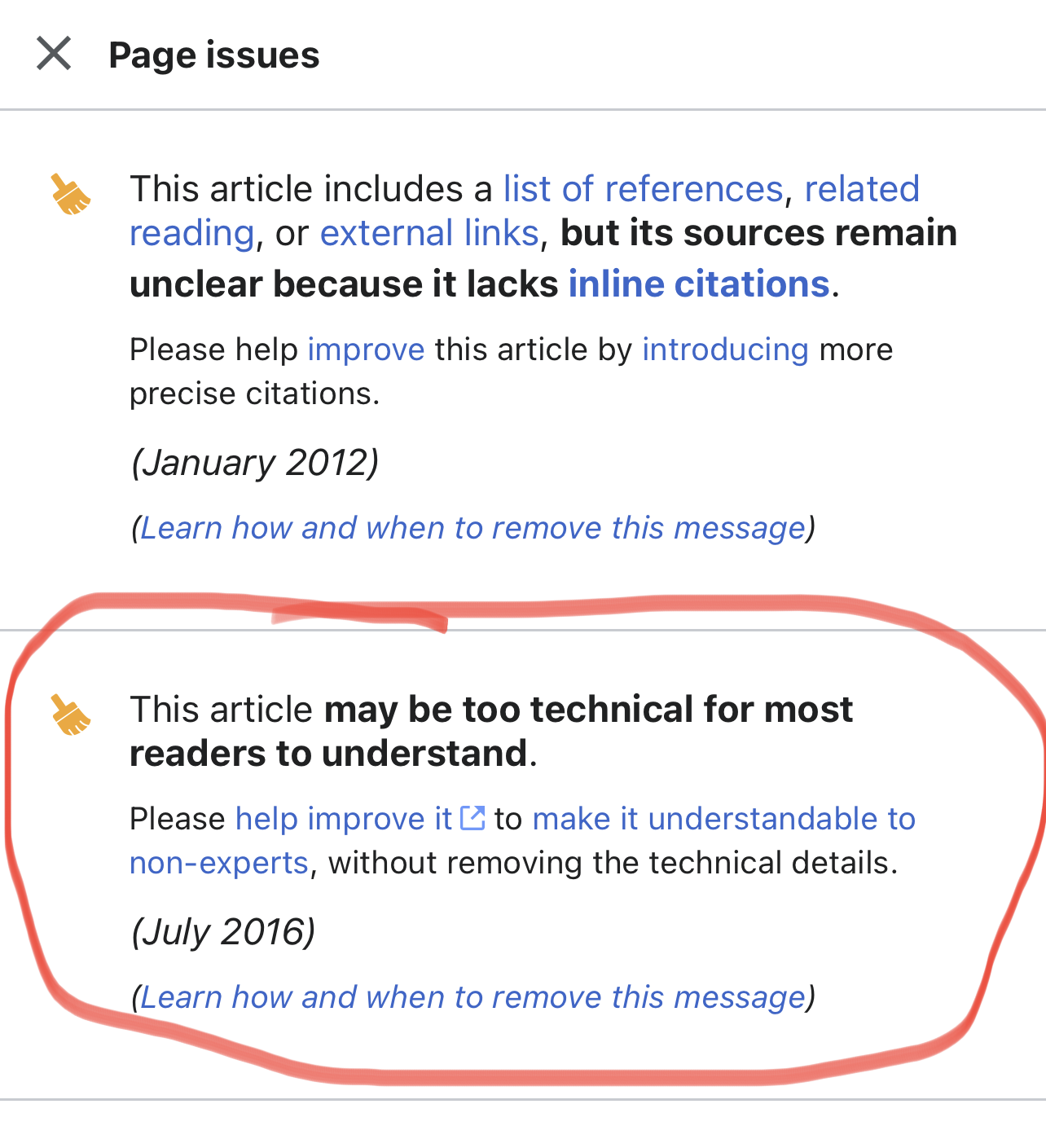

P.S. @PappyM3 , when you are talking to humans outside of your very niche work environment (and believe me, it is niche), you might want to refrain from using the phrase “trade space” and “trade space ideation”?
Unless you either a) want to confuse a regular person, or b) sound dorky af.
I read a lot, and that’s a new term for me.
Apparently the term is popular in NASA and defense industries? It sounds achingly close to corporate buzzword bullshit (even if it is not).
Even the author of this Wikipedia article failed to cut to the chase and use plain language:
Fair. Within nerdy firearms communities like long range precision or ballistics talk, I tend to revert.

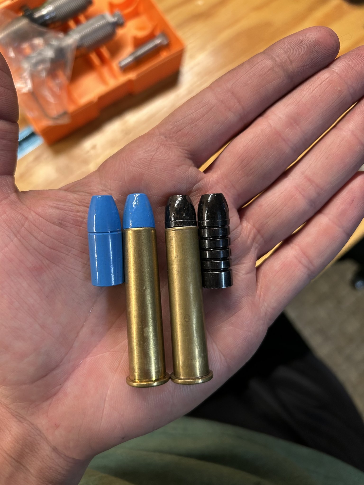

I have only shot 1 doe so far with the 500 gr on the left. 70 yard shot. She went maybe 20 yards. Lung shot, but I didn’t study the damage inside
The 500 gr has a .25” meplat. I have another mold on the way to try. 540 gr with a .368” meplat. Should be even more effective.
