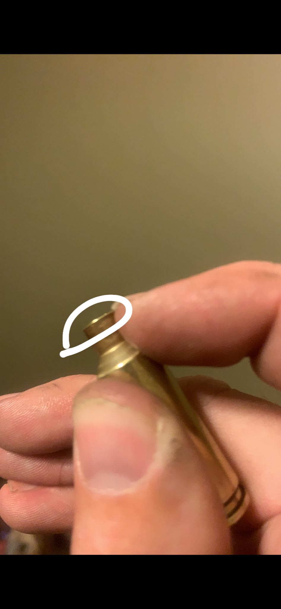

Seating die is likely too low. It’s causing a lip to form at the end of brass and not allowing the round to chamber.
Bet if you pulled the barrel off and drop the round in, it would be sticking out the chamber about as far as the length of the neck.
Reactions: supercorndogs
Here is an example of what happens when seating die is too low:

I’m with the seating die on this one. Bet you it’s set too deep and your buckling the shoulder slightly, just enough to create a bugle and not allowing the round to chamber.
