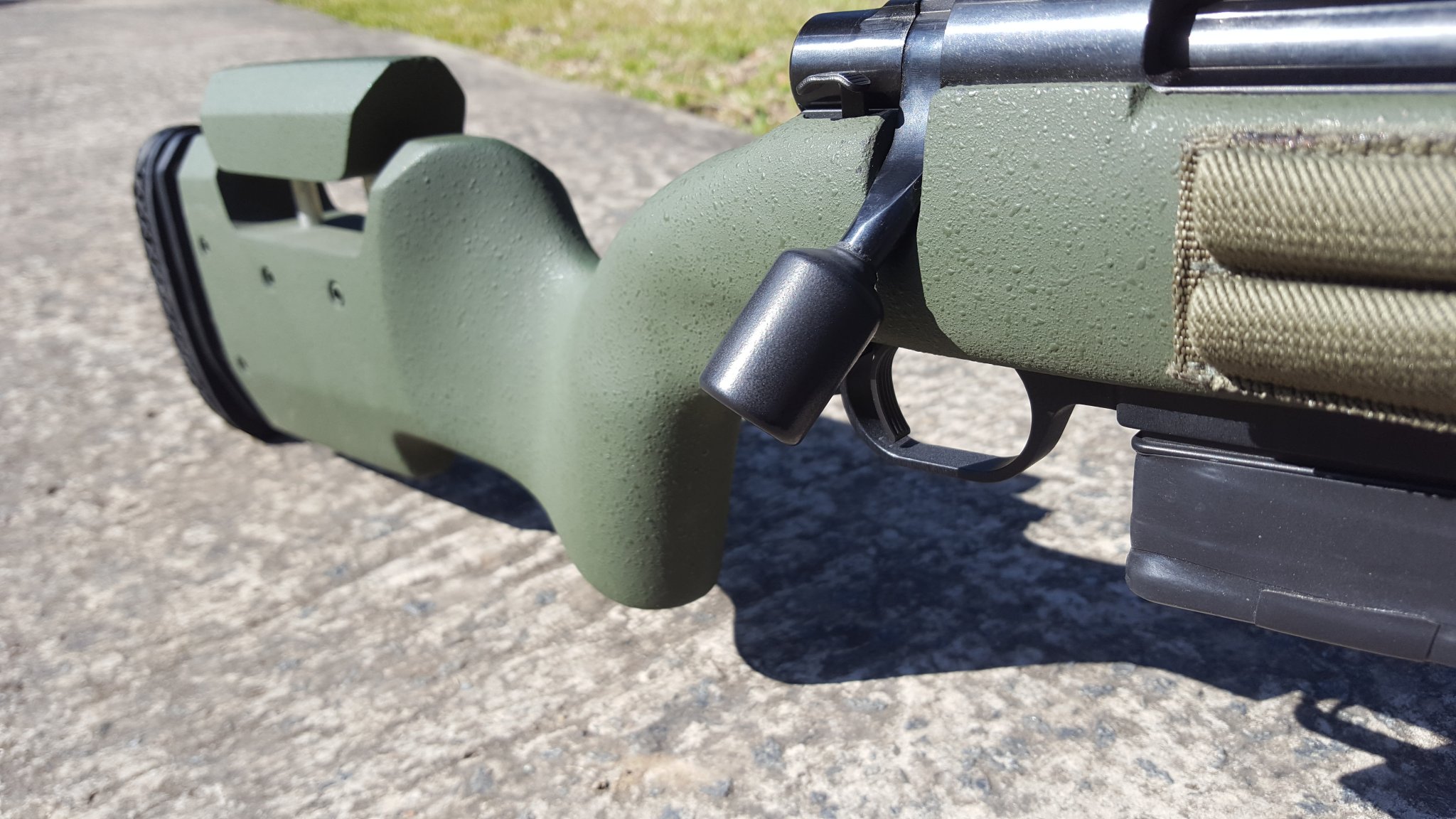

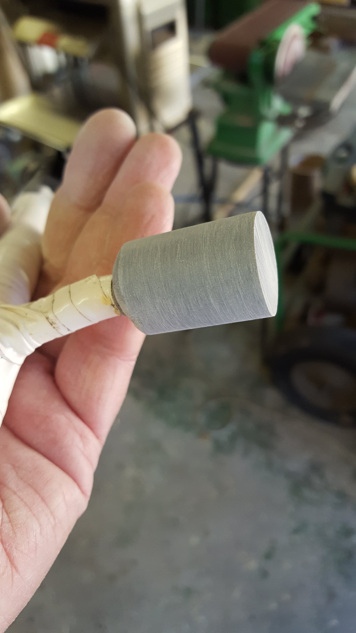

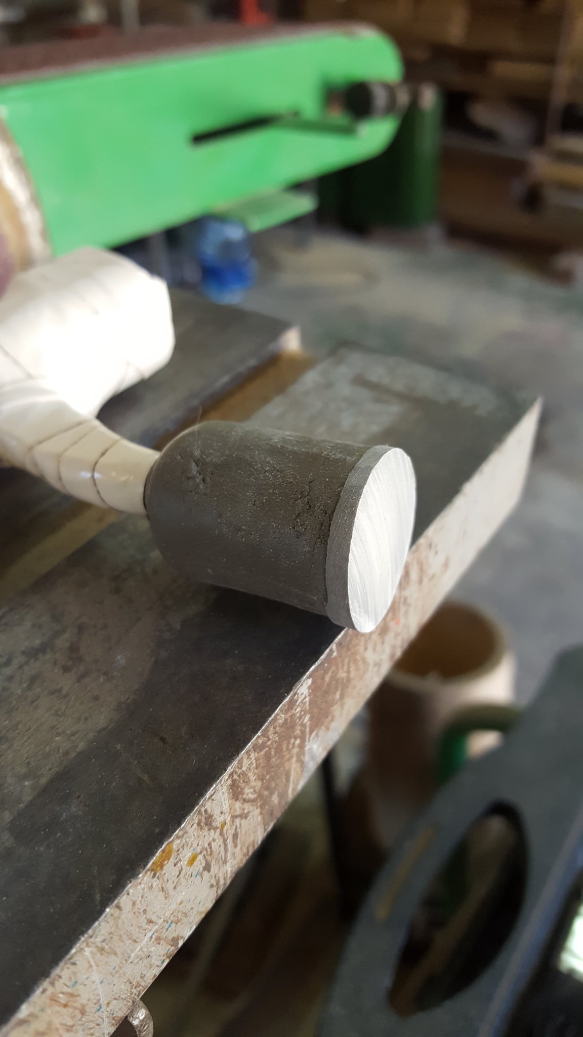

Hi guys

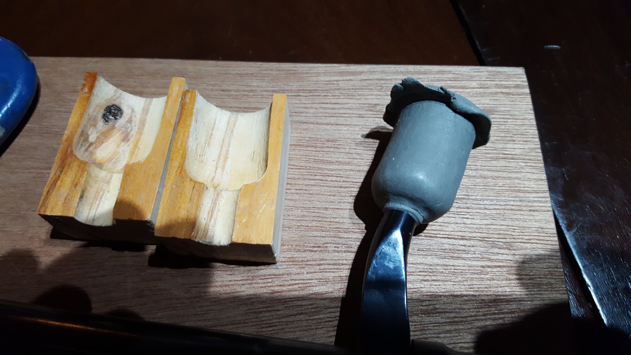

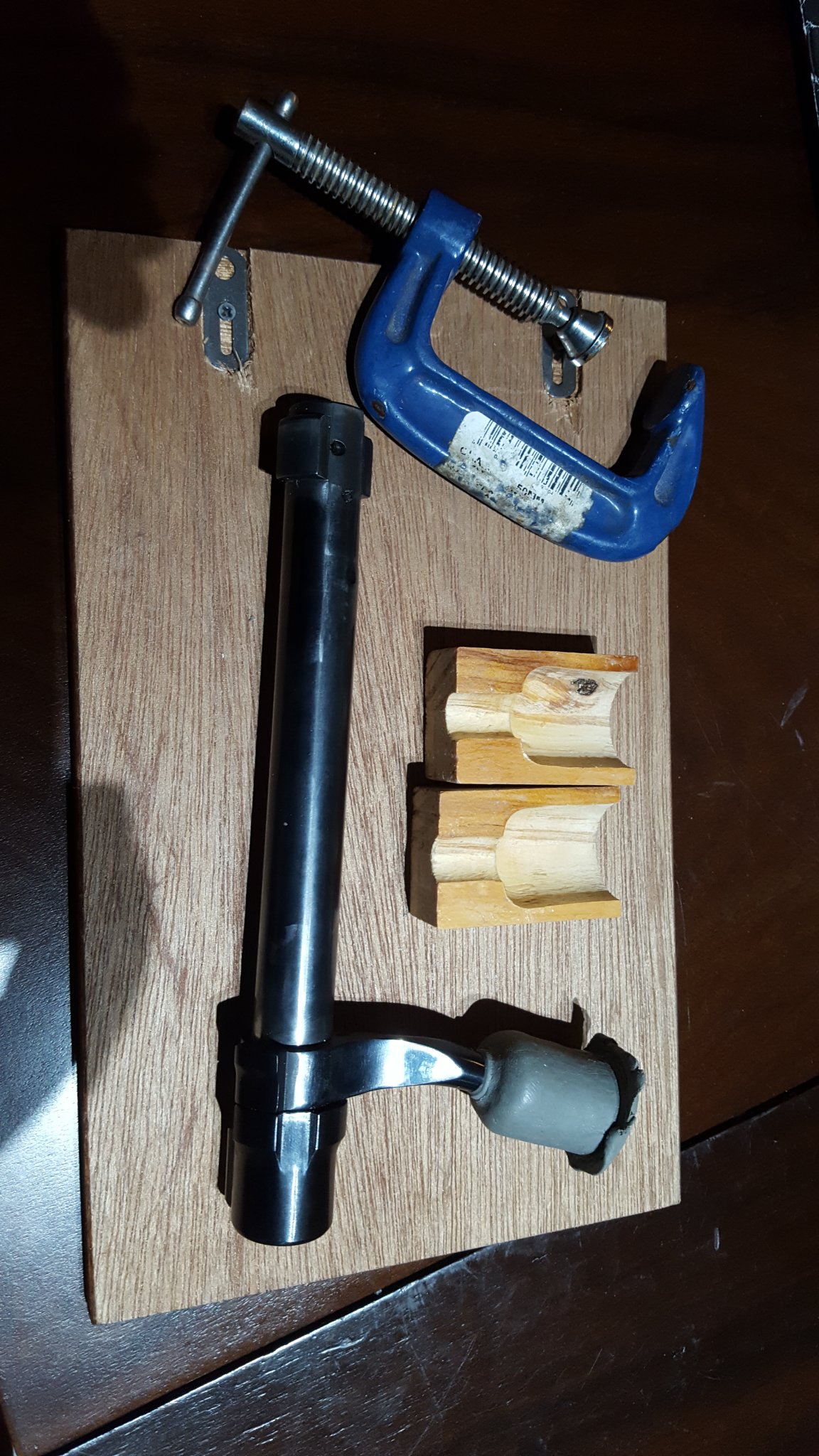

So I figured I have nothing to loose by trying to enlarge my bolt knob without smithing it
Used Pratleys steel putty, what you would know as JB Weld state side which I've seen it
done before but wanted to minimize the freehand input as much possible. So I made a little mould first much like one would a fishing sinker mould. Instead of casting liquid in I lined it with the putty (after treating it thick with natural shoe polish as release agent) and clamped it on using a small g-clamp. Trimmed away the excess on the bolt side and what you see here is the result thus far. Will finish off tomorrow and post progress
Thanks for reading. Let me know what you think

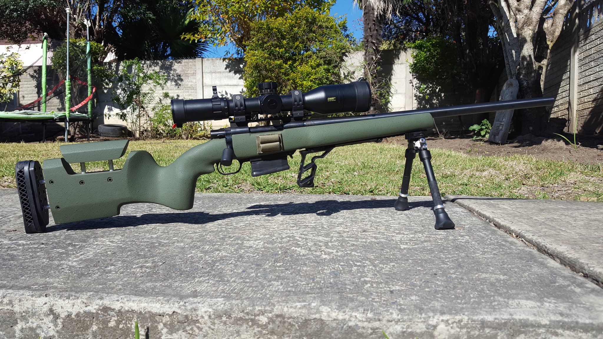

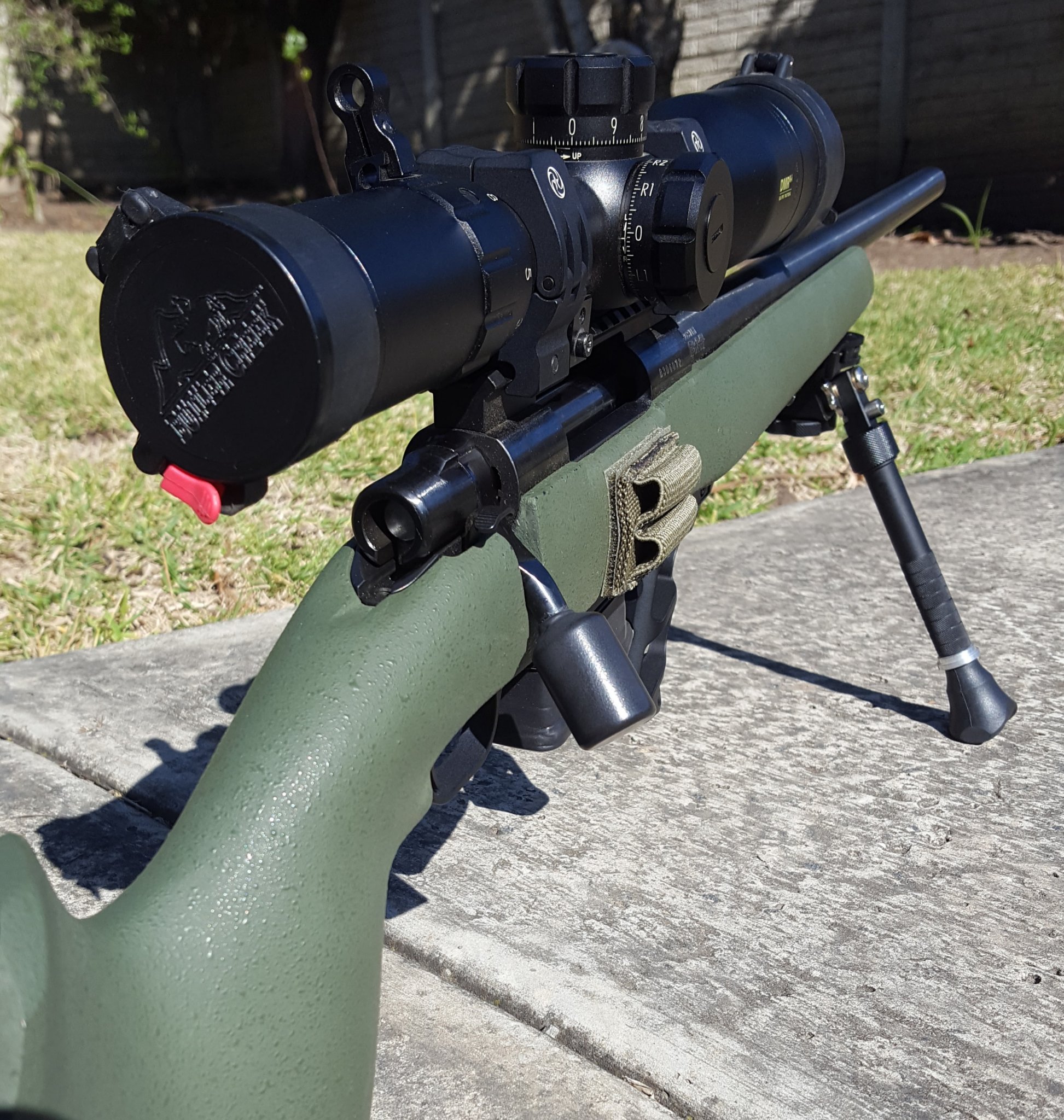

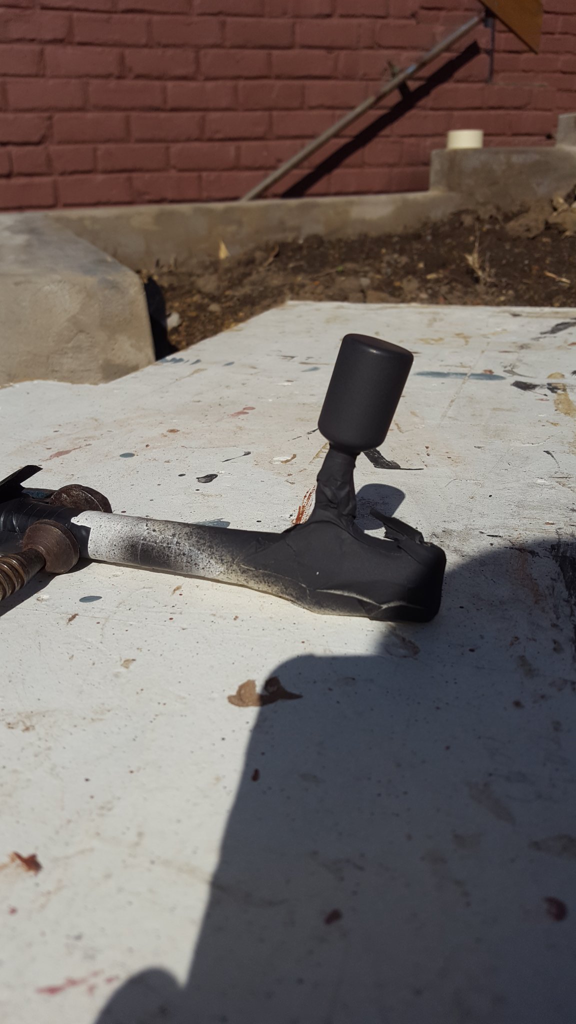

Thanks gents. Appreciate the feedback. I'm not sure of the weight as I didn't weigh the bolt before. Will weigh a friends when I get a opportunity to and compare
Thanks!
No I looked at those but none local. Shipping from State side for just that wasn't justifiable. I tried a different version of similar concept but it didn't work for me and moved or came loose a few times. Figured nothing to loose in trying this. If it failed I would have had it threaded and fit a knob that way but so far so good.

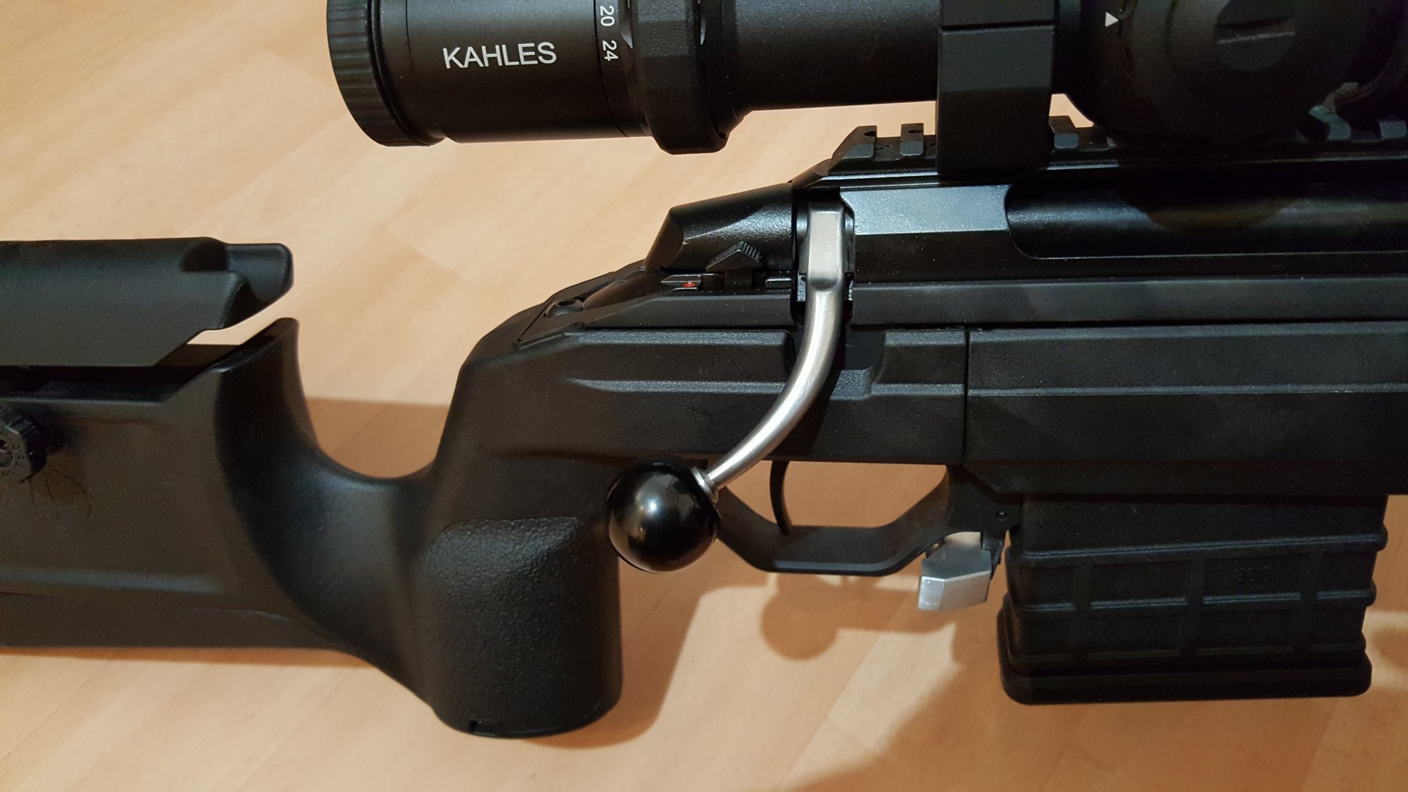

Hi Guys,
Latest project was made half on a lathe half with a lot of filing by hand...
My Tikka got a bolthandle in the style of my Anschuetz 22.
