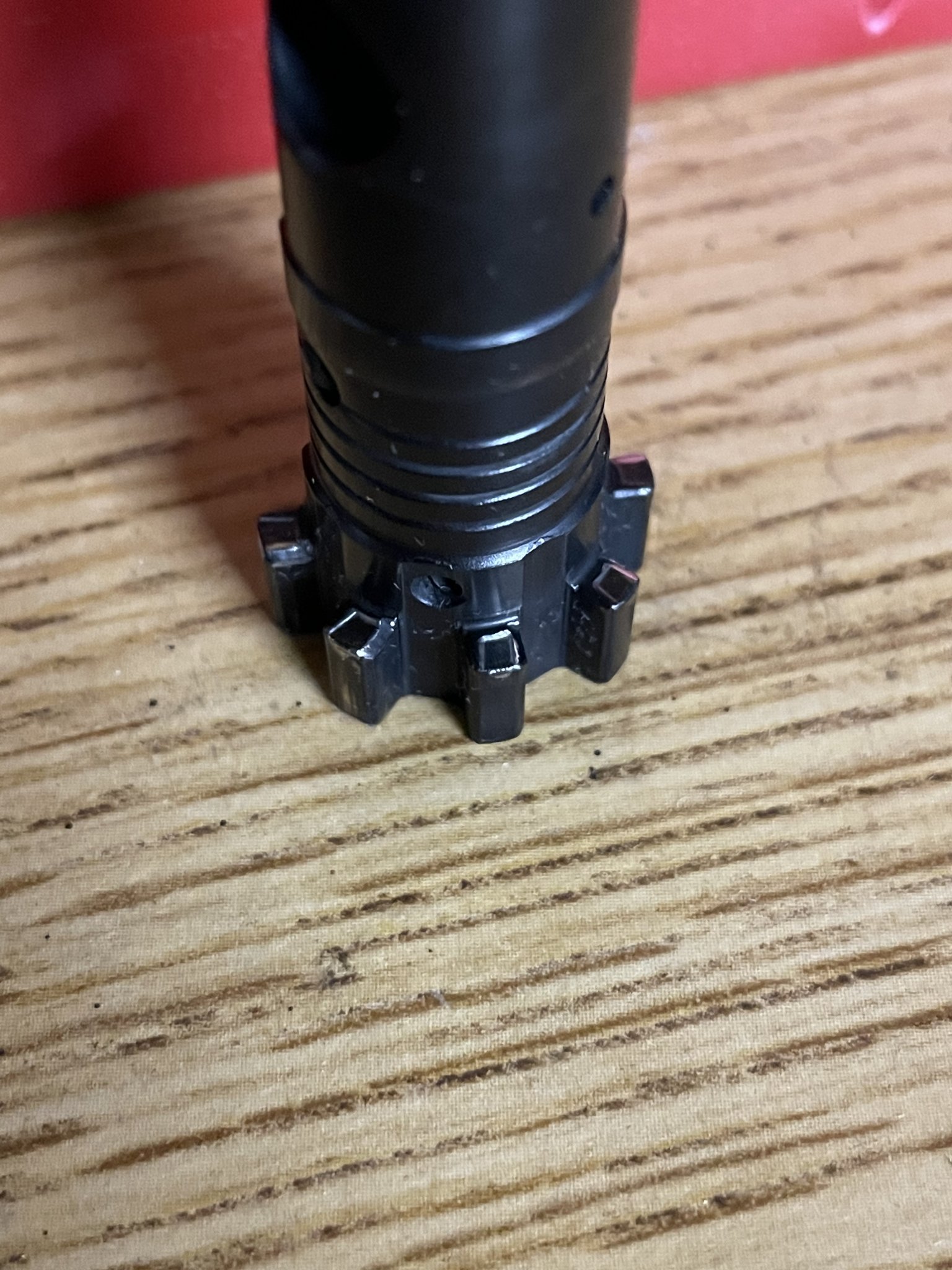

Bolt Lug Deformation - Proof SS 6ARC Barrel
AMwood
Oct 5, 2018
66
30
Boise, Idaho

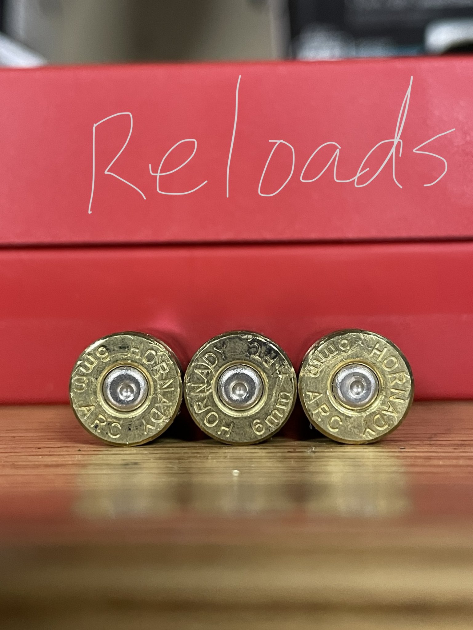

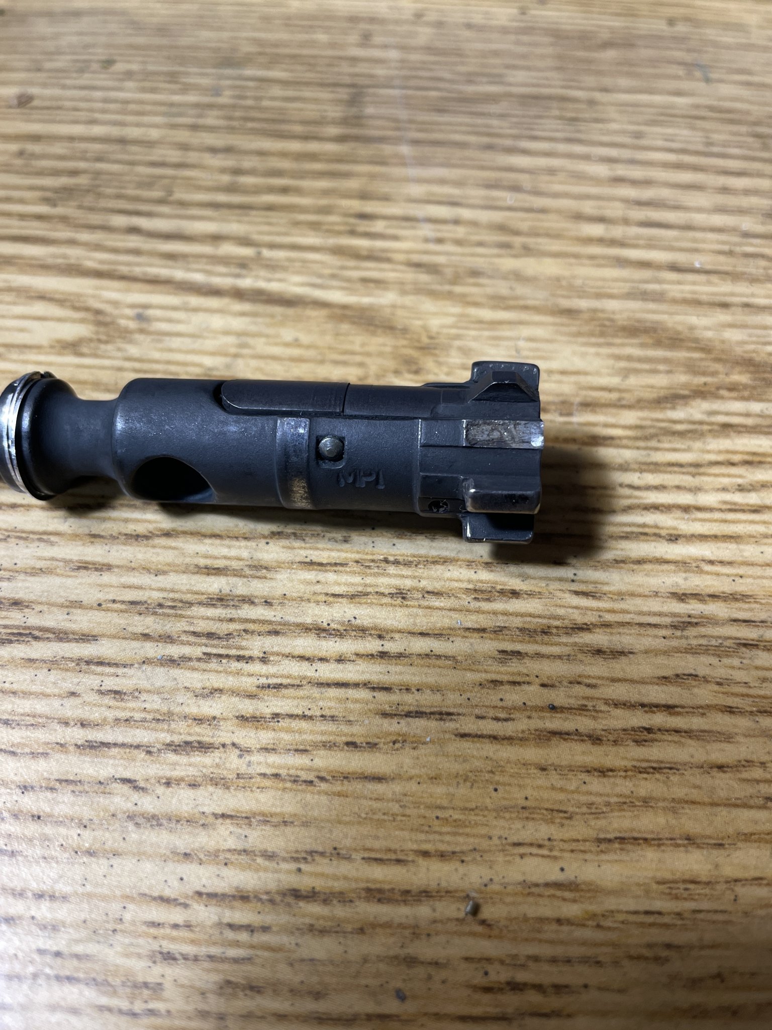

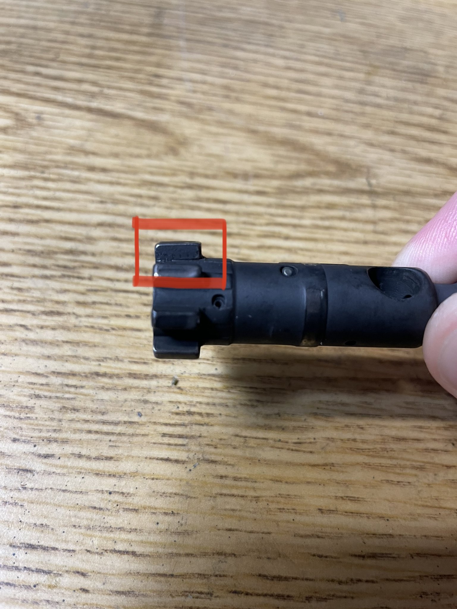

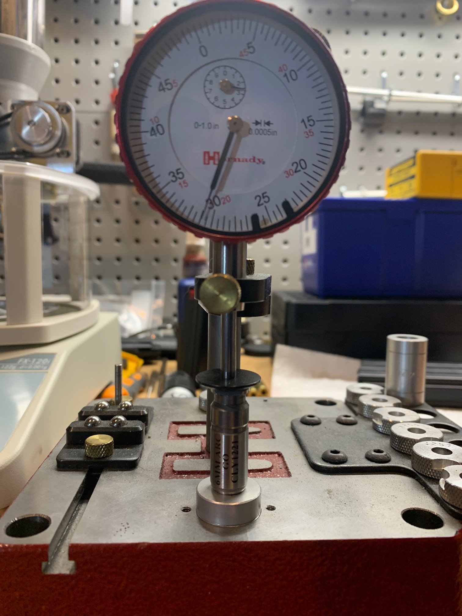

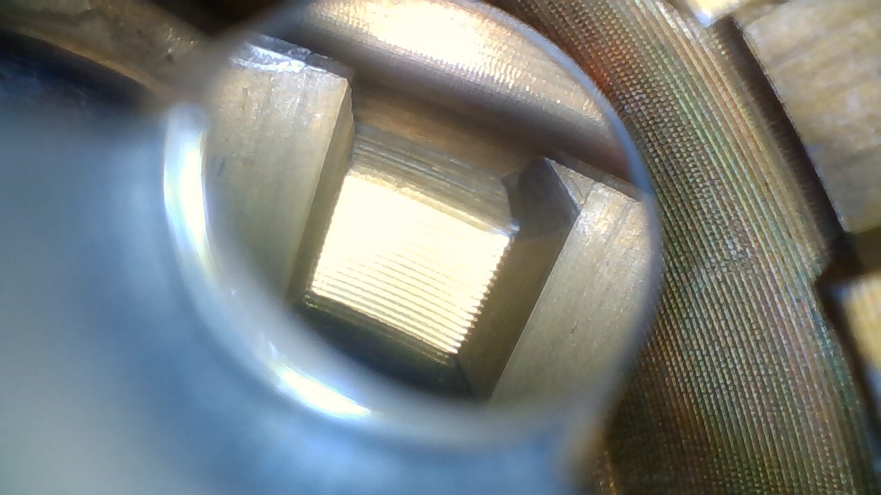

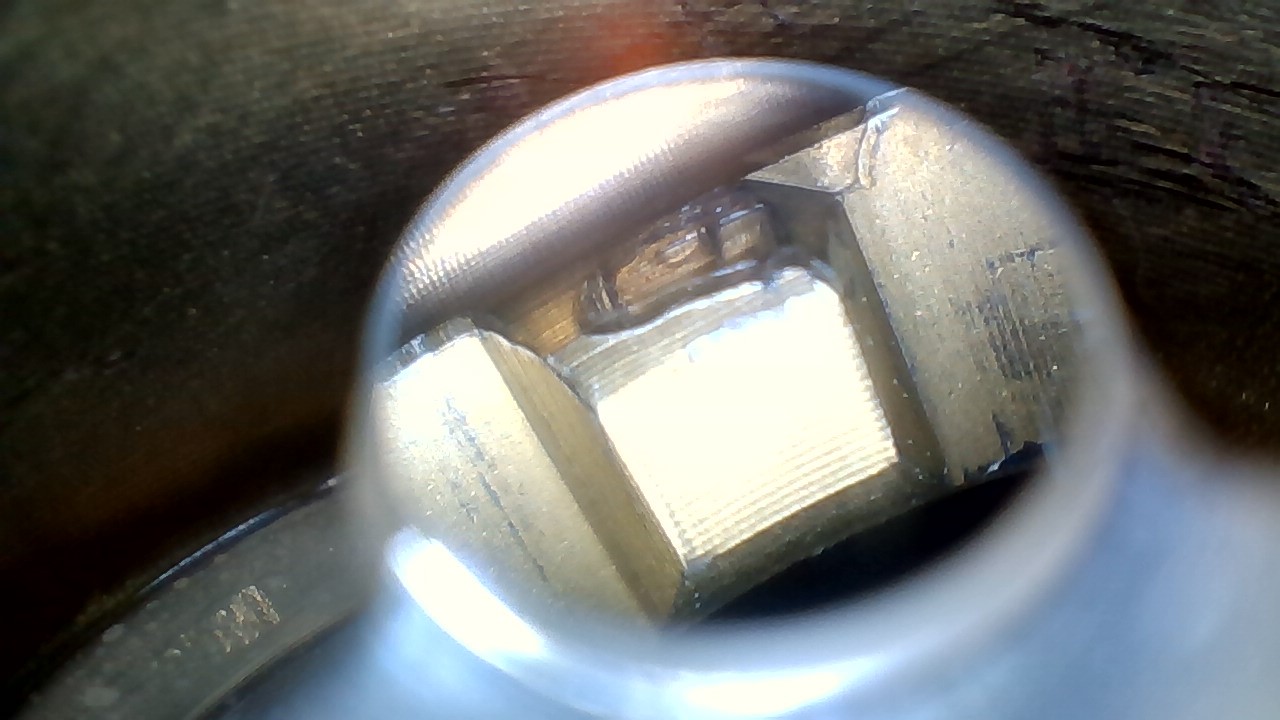

Recently put together a 6 ARC gasser using a 22” SS Proof barrel in a Seekins IRMT upper with a new Maxim bolt. It shoots great however, after running a mix of factory 108 Hornady Match and running a load work up with 26.6 gr of 8208 XBR under an 87 gr vmax I found the deformation on the back of the bolt lugs:

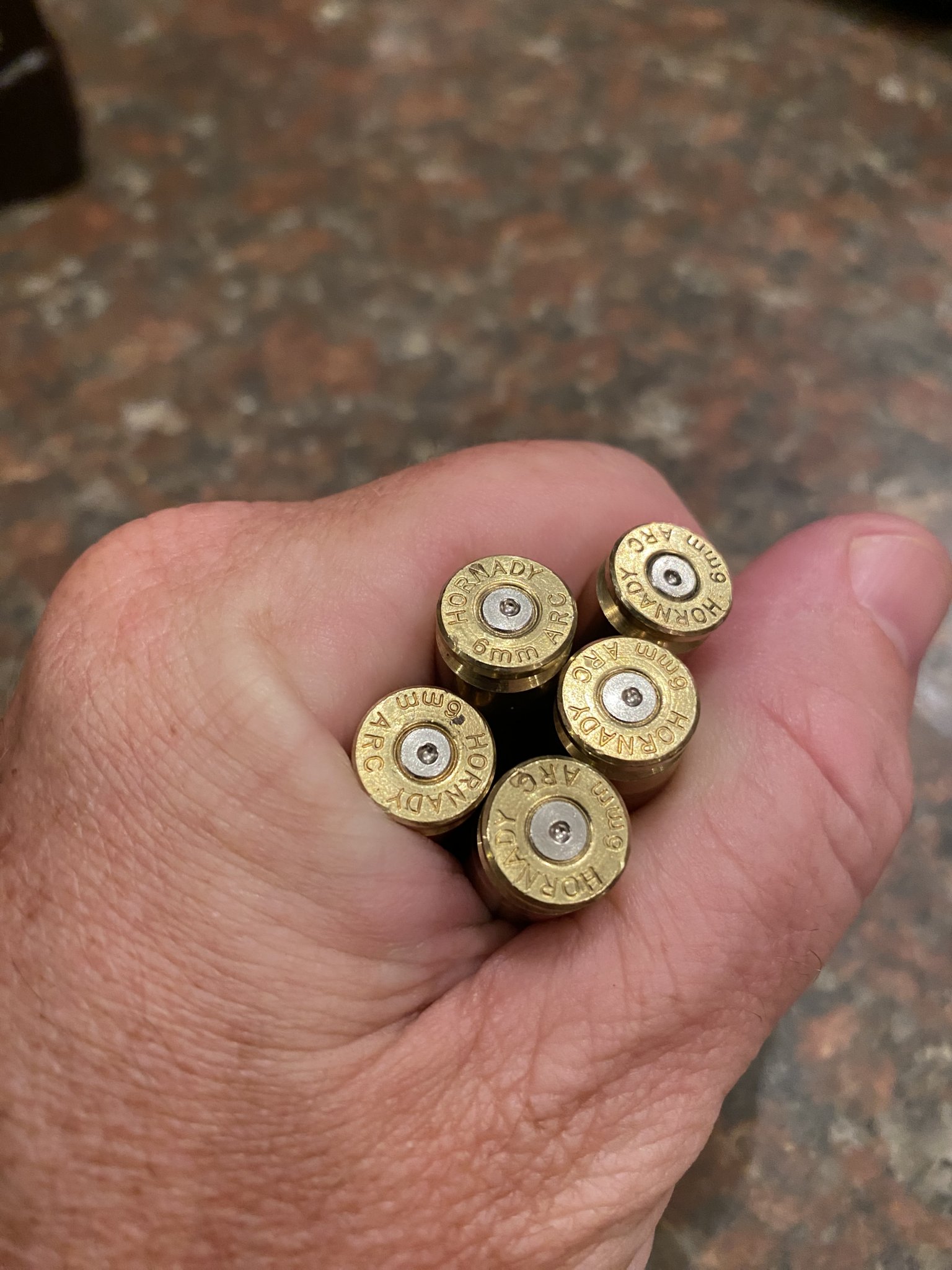

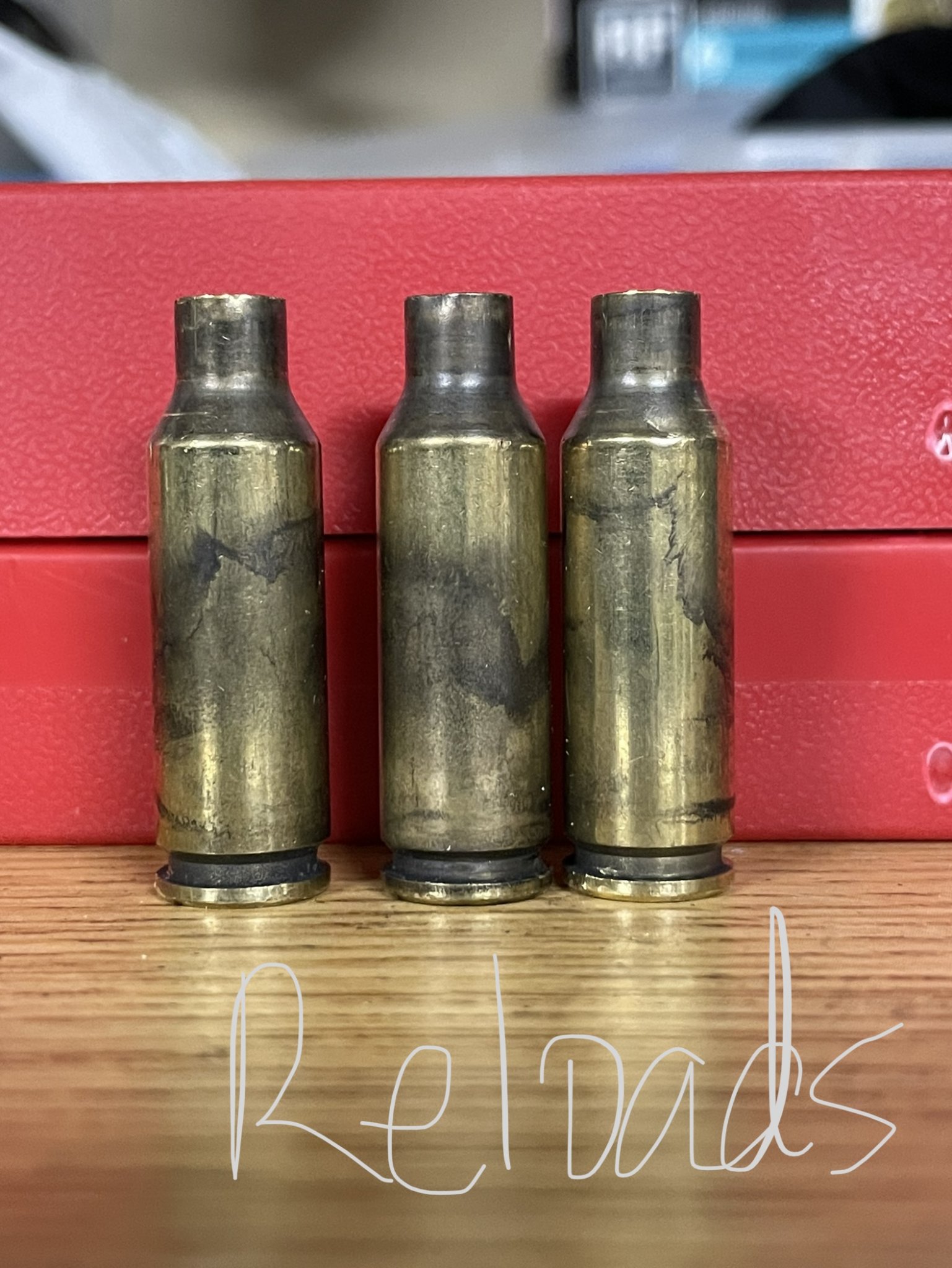

This is after approximately 100 rounds. I’m not seeing pressure signs on the brass. Ejection using a suppressor with adjustable gas block, rifle buffer and JP polished/tuned spring is at 3 o’clock. Velocity gave an average of 2823 fps with an sd of 5 so it’s been very consistent. I double checked I wasn’t seating in the lands causing a pressure spike.
Any ideas what could be causing this? Should I run it as is? I also tried a different used no name MPI bolt to see if I got a lemon but came back with almost identical deformation on it after only 30 rounds.

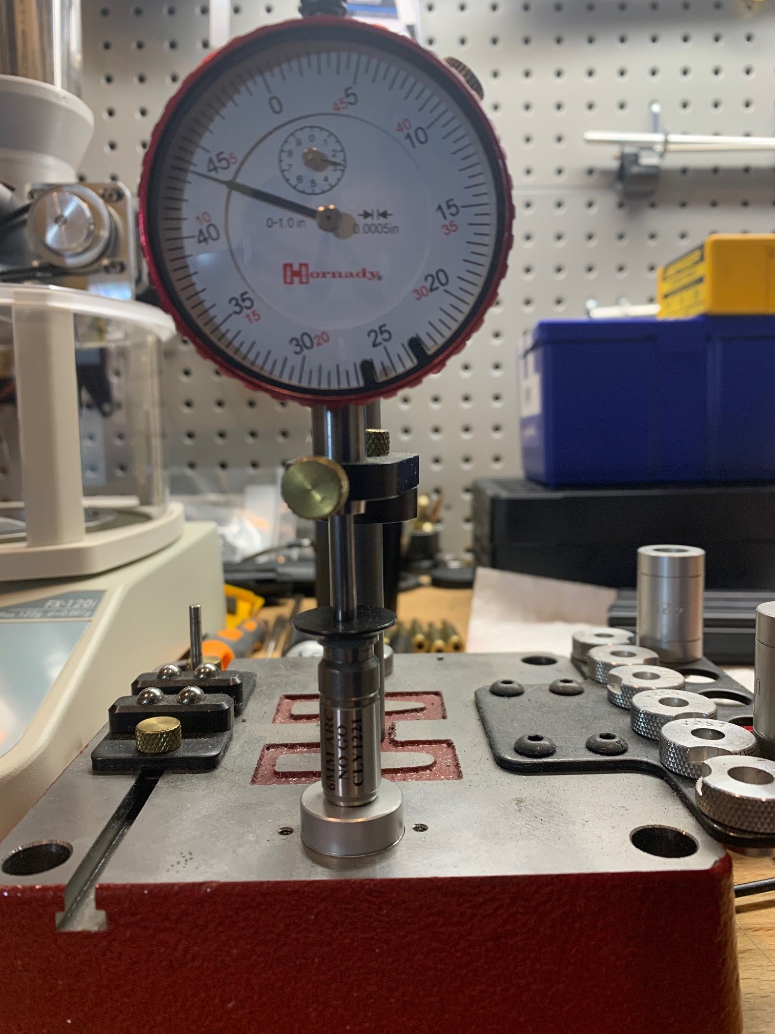

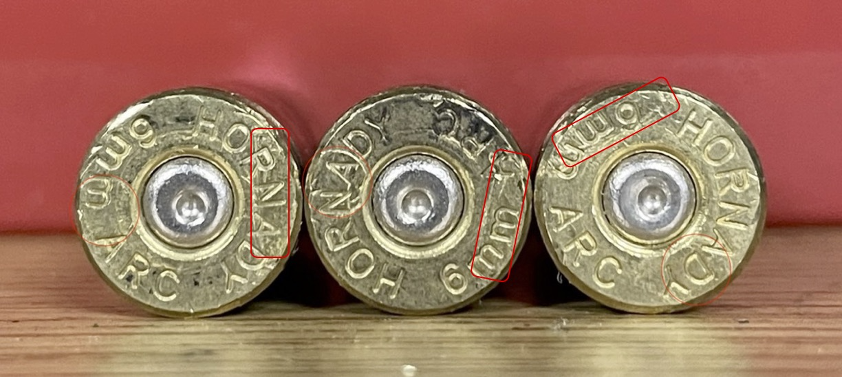

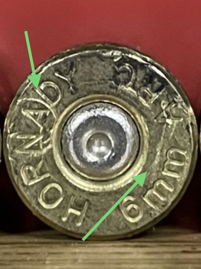

The brass below is dirty from my can and shows some light marks from the extractor. In my experience this isn’t out of the norm for a gas gun though. The once fired factory brass appears nearly identical.

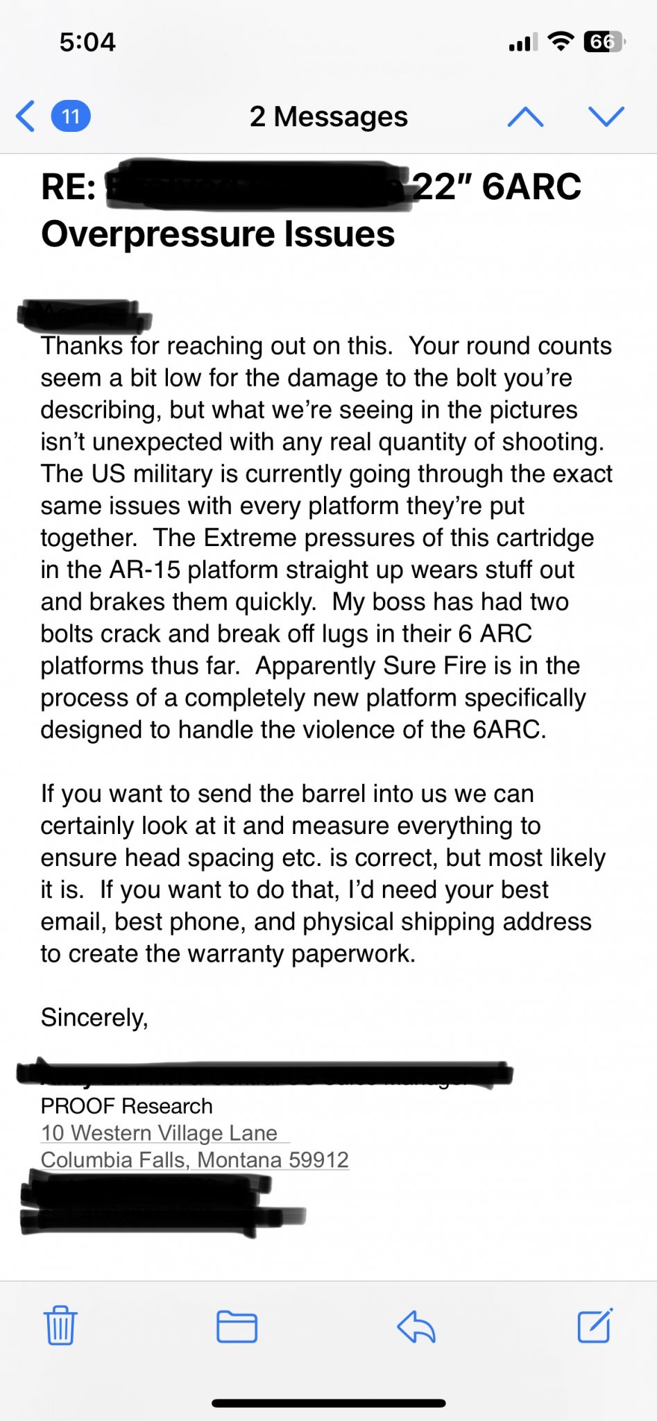

The issue is bolt thrust. The larger case head on the grendel case means more bolt thrust for the same chamber pressure as say 5.56. That’s why grendel and arc loads list a lower “max” pressure for gas guns. Pressure that overloads the bolt in the grendel case isn’t enough to show typical signs on the brass.

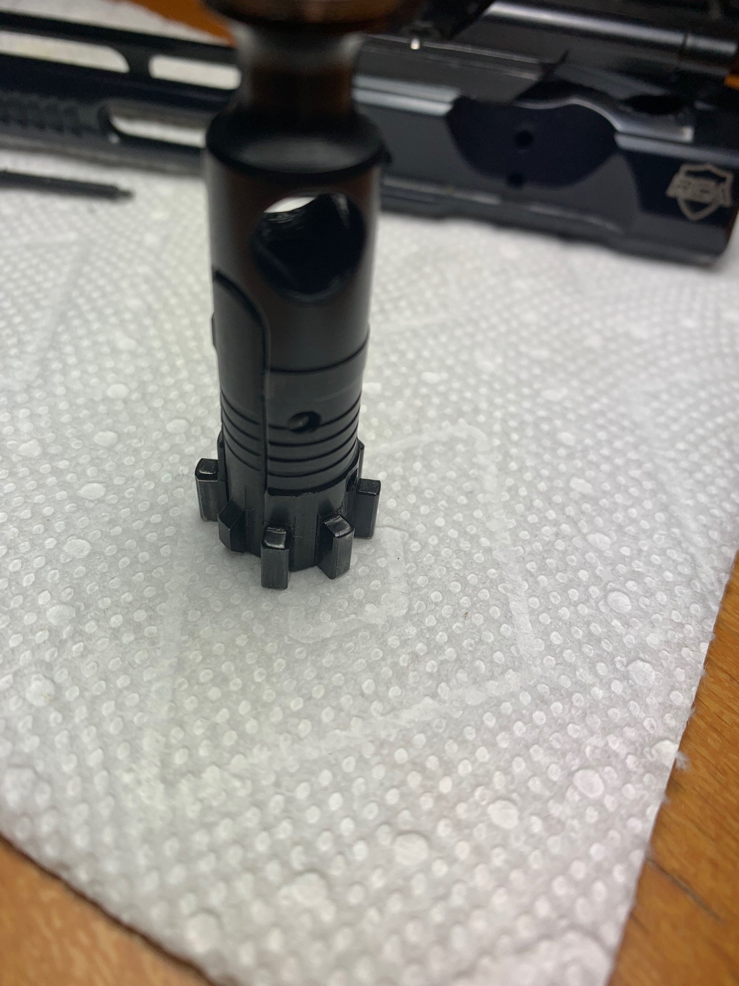

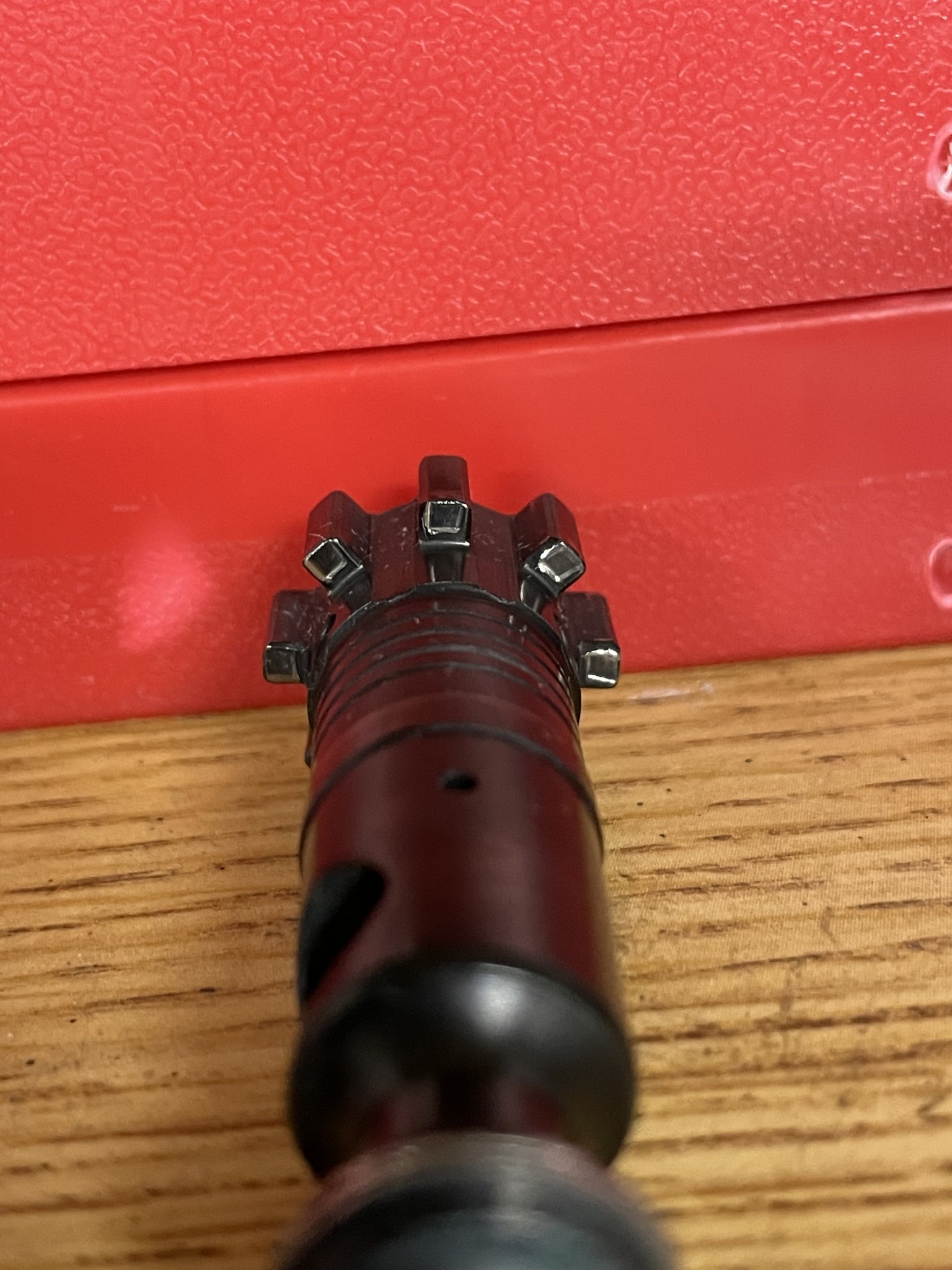

Even though port ejection placment seems ok, id still try turning the gas down. For what its worth, my 6 arc bolt got eaten up pretty fast also, and i had the gas set so that itd barely hold the bolt open. It was a 24in rifle gas length ballistic advantage barrel. If i had to do it all over again, id get at least a plus 2 system for the same length.
When i finally ditched that bolt and barrel, it was at 1500rds or so and my fired brass was like .020in over the no go gauge. I had to size the brass to the chamber basically every 200rds or so otherwise the headspace would be to much. The bolt looked like shit, but never quit working.

I hope you misplaced a decimal on your dimension. 6ARC chamber 1.1901 min - 1.2001 max.

What length is your gas system? It would also be a good idea to inspect the inside of the barrel extension lugs.
Quick GRT puts it at +/-47K PSI.

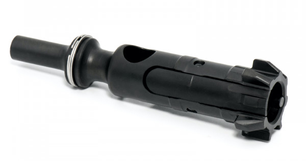

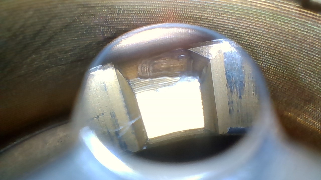

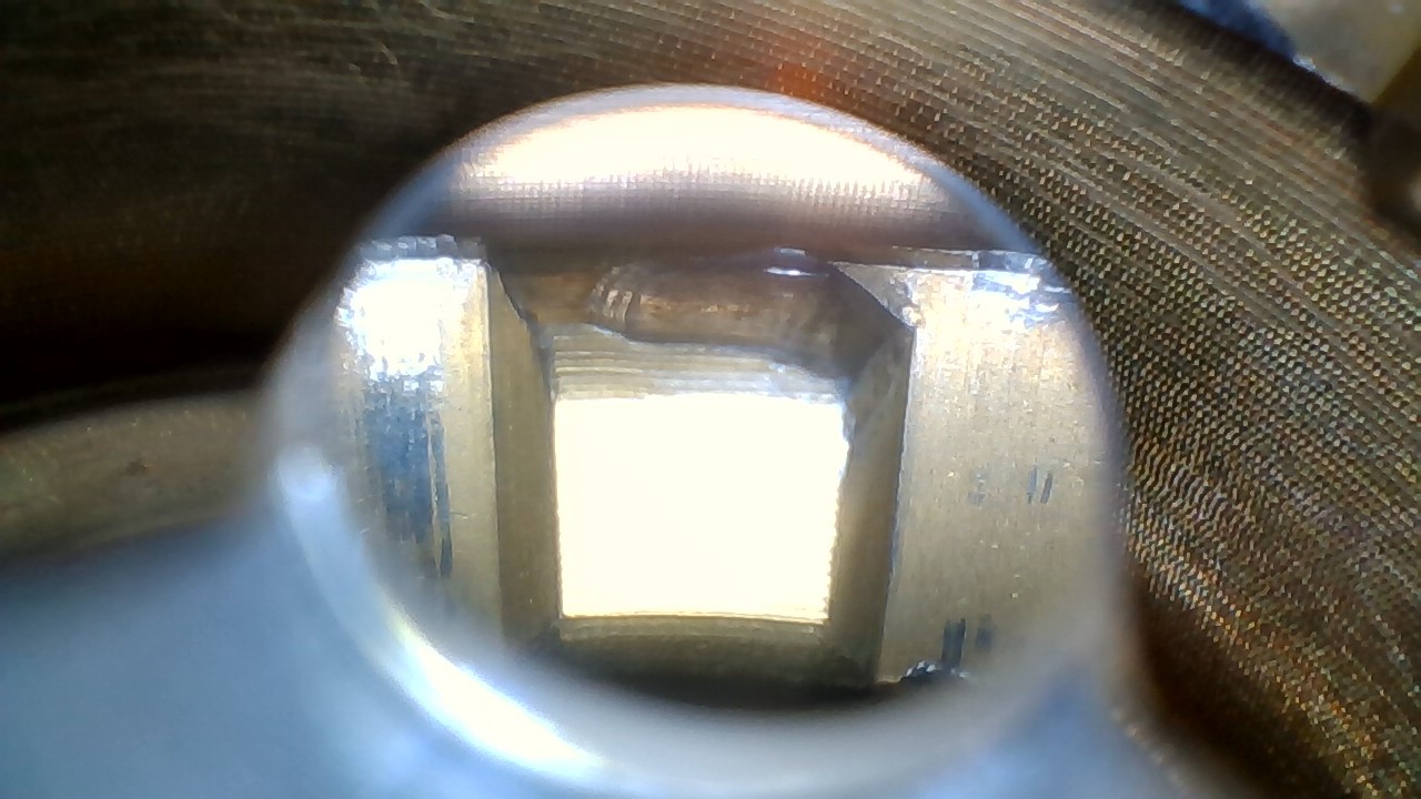

Hows the lockup of the bolt (and the new bolt) in the extension? Is the bolt getting a 'running start' at the lugs?

Nitride bolt or Black Oxide? I've been telling people for several years that nitride treating bolts or barrel extensions is not a good idea. It softens the bolt and extension lugs and over a period of time they will compress leading to excessive headspace.
Maxim description does not say if they are Nitride treated or Black Oxide.

Haven’t received the new bolt yet. The lock up was good on the old one though. I did have some issues with alignment between the bolt and extension but solved that by locking the barrel in my barrel vice when torquing the receiver nut down. Once aligned it went into battery like any other AR I own.
I honestly don’t know. The shot peening gives the bolt an almost smooth phosphate appearance.
That’s pretty wild. Am I seeing it right that there are like .01-.02 deep indentions in the bolt? I would think if you’re over pressure so much that it stamps the lugs, you’d see other signs. What brand bolt is it?
Could there be slop between the extension and the lugs so it’s getting a running start when it’s fired? I feel like it would take an incredible amount of pressure to stamp the lugs like that if they were seated properly. @Constructor may have some ideas.
Cant tell from the picture but it may not be what you think, I have seen the boltlugs get shaved
from the barrel extension when there is too much slop between the barrel locating pin and the alignment slot
in the upper causing a barrel misalignment combined with sharp edges on the extension.
Clean inside the barrel extension with a qtip and look for steel shavings and check when the bolt
is traveling past the extension if the bolt lugs are centered between the extension lugs.
I would contact the barrel mfg and the bolt mfg and pick their brains.

Can you please elaborate about the alignment ? Was this during the test fit/ build?
They are indentations. I don’t have a great way to measure the depth of the indent but a caliper was giving me anywhere from .007-.009. It’s a Maxim bolt (not trying to put them on trial by any means here since I think there are other issues at play and it occurred with two completely different bolts).
There is a bit of wiggle between the back of the bolt lugs and the extension but it’s small. No idea what the clearance should be for parts that lock and unlock in an action like that so it might be in spec for all I know.
During the build. I’m using a Seekins IRMT upper which has a degree of of clearance in the index pin channel. When torquing the barrel nut on, the receiver would rotate very slightly causing the lugs of the extension to be off by maybe a degree or two. This would cause the bolt lugs to contact the extension lugs during cycling. Not enough to bind or completely stop the action but to the point that wear light marks were evident. Locking everything down prior to torquing fixed that problem.

Head space when new & after about 260 rounds. The No Go guage in second pic has several pc's of scotch tape on it.
Here is the bolt. It does show a little wear, but no displaced metal and can't feel anything with fingernail or a pick. It's still trash!
I didn't catch this issue till head space had grown +.015 My reloading process is measure fired brass on guage pictured above & then bump shoulders back .002. I had no idea it was growing until I tried a piece of brass prepped for this barrel in a new Craddock with JP bolt. Wouldn't close WTF, so I started checking. The reason I explained this last part was so it would be clear that ammo fired never had more than .002 headspace, or in other words even when it started growing it wasn't like the case was getting a .005 or .010 running start. Always had .002 brass head space despite the growth.
Here is what I found in the Tin extension. First the lug the sits behind the extractor i.e. as new.
I'm assuming they missed the hardness spec on the extension. Rainier agreed, but I have doubts they actually tested it.

Interestingly, when I first test fired the barrel the very first round was a Hornady match round that I fired with the gas block completely closed so I could get an accurate measurement from for sizing. I used this piece to get a rough BTO measurement on the 87 grain vmax and found that the fired neck holds the round with a decent amount of tension. It’s not enough that you can’t push or pull the round with your fingers but it also doesn’t fall through like I’ve encountered with others. My hypothesis is that maybe the chamber is on the tight side and once everything is carboned up from the can, it’s that much tighter and causing the over pressure. I’ve sent Proof an email and am waiting to hear back. The customer service rep said they’re at a trade show so they’d be slow to respond.
Could very well be warm, but in my Hornady experience with 6.5 Grendel, 6mm Grendel, 5.56 and 9mm, all their brass gets beat up by even light loads. I've got a 223 load, 55gr around 2600fps and it still chews up the Hornady a little while any other headstamp comes out looking new.
Definitely on the soft side. Thats one of the reasons its good to use as a gauge for pressure. IMO
Also I just wanted to say there was some talk about sizing .002 to .003 off of a fired case. Thing is, with a semi sometimes the headspace will stretch on extraction, exasperated if the system is over gassed, not giving you an accurate measurement of the chamber.
Either turn the gas completely off and measure off that case or pull the ejector, pull the bolt out of the bolt carrier and manually see what headspace works and what doesn’t.
Not stating that is what’s causing the sever wear here, just things I have noticed in my progress that helped get to reliable reloads.
My faith in the ARC has been shaken. Response from Proof below.
Disclaimer: I’m not pointing fingers. Appears the current bolts aren’t ready for prime time.
If I have to replace a bolt every few hundred rounds and potentially wade through replacing a barrel extension down the road then I might just cut my losses and go with a different caliber. It’s too bad, there’s an awesome range of projectile types and weights in .243 that really made this a tempting idea.
Seems fishy. Why aren't the 6mm fat rats breaking bolts. The 6.5 Gredel runs the same bolt face and pressure. Its broken bolts have long been sorted. If its the smaller the bullet, are people using 22 Gredels breaking bolts even faster? I understand the bolts for this size cartridge in the AR are marginal, but breaking every 200 rounds, i feel there is certainly something else wrong, same goes for breaking in a couple thousand.

I received my Clymer go/no go gauges and with a new bolt it passes with the go and fails the no go. Two layers of scotch tape on the back of the go gauge (approx + .004) was enough to make the new bolt fail. Not sure if this makes the chamber fall on the tight side.
Extreme pressures? 52,000psi isn’t extreme pressure. 5.56 NATO is loaded way hotter than that.
