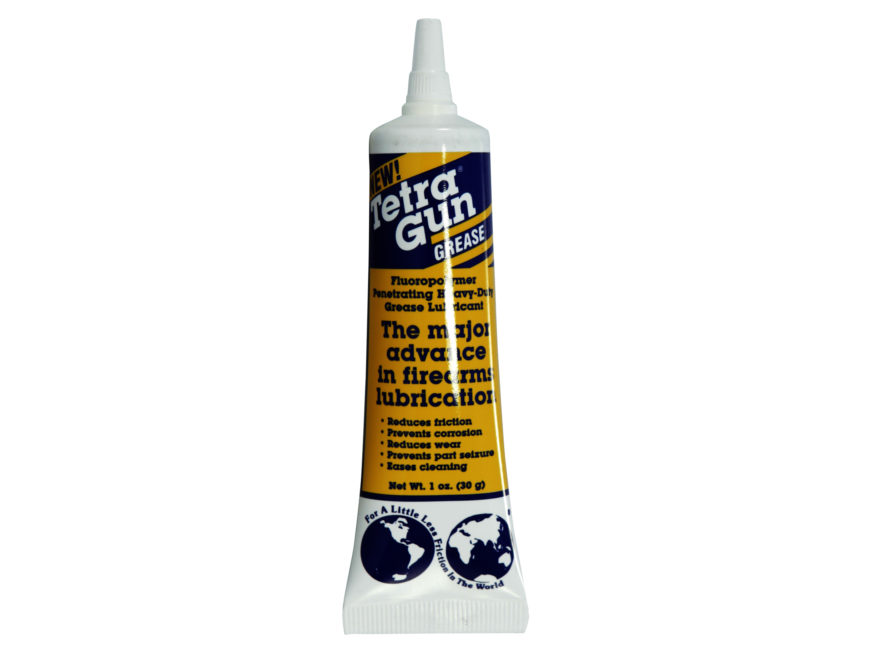

Been using this for a while. Does a pretty good job on any metal to metal contact.
Reactions: Greg Langelius *
I tried Tetra several years ago, but found that it didn't store very well; if I lubed up a gun and tossed it in the safe for a year or so, the Tetra would end up with the appearance and consistency of peanut butter. Have you had better luck with it in that regard?
Reactions: Gil P.
Interesting. I haven't had it get thick like that, but it does separate which can be annoying. I just knead the tube well before using it to get everything mixed up again.
