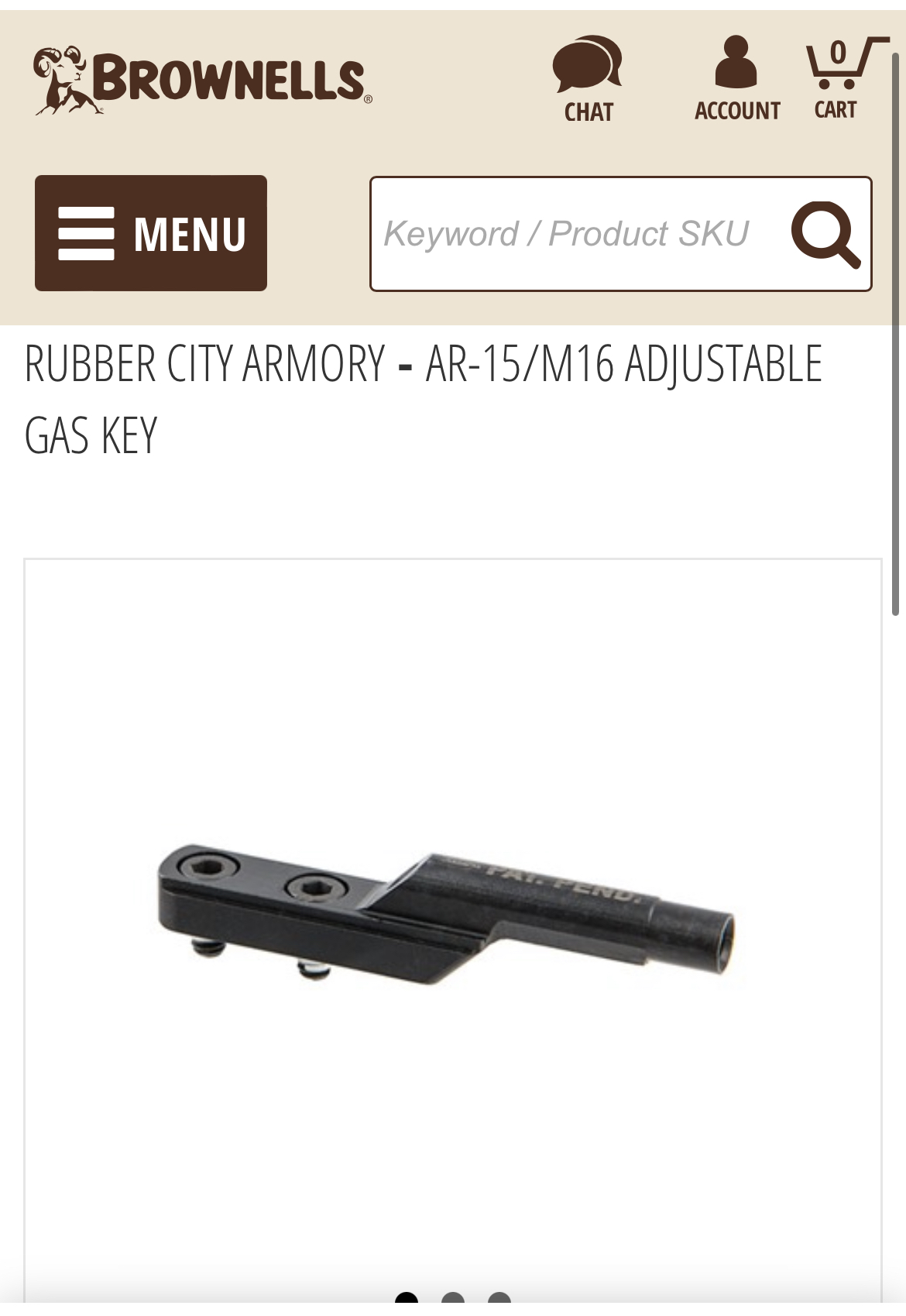

I’ve used these with good results. If you already have a carrier it’s the way to go for $57.
