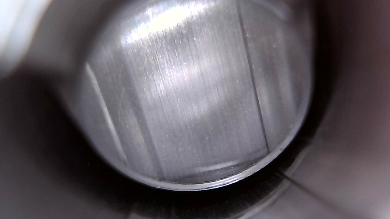

Here's my gravel road, not a Tikka but still shows the same wear pattern. It's caused from the grit in the priming compound.
New unfired hand lapped barrel.

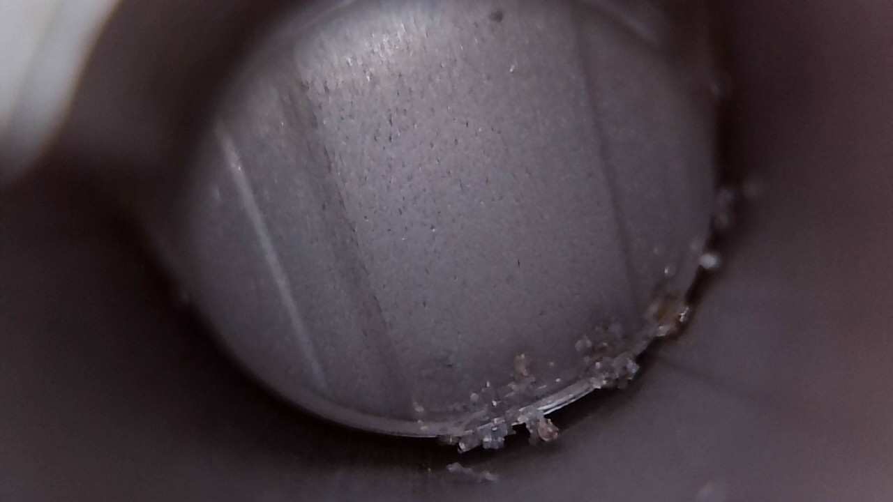

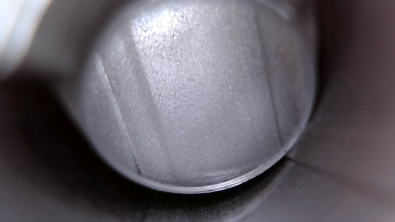

Same barrel 10,000 rounds later.

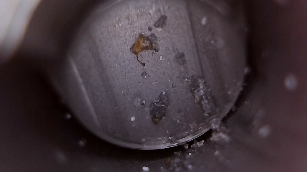

These two pics show the culprit that causes this wear, silica left in the bore after firing a round.
