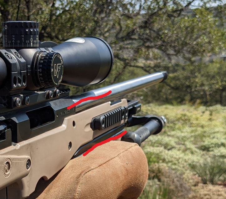

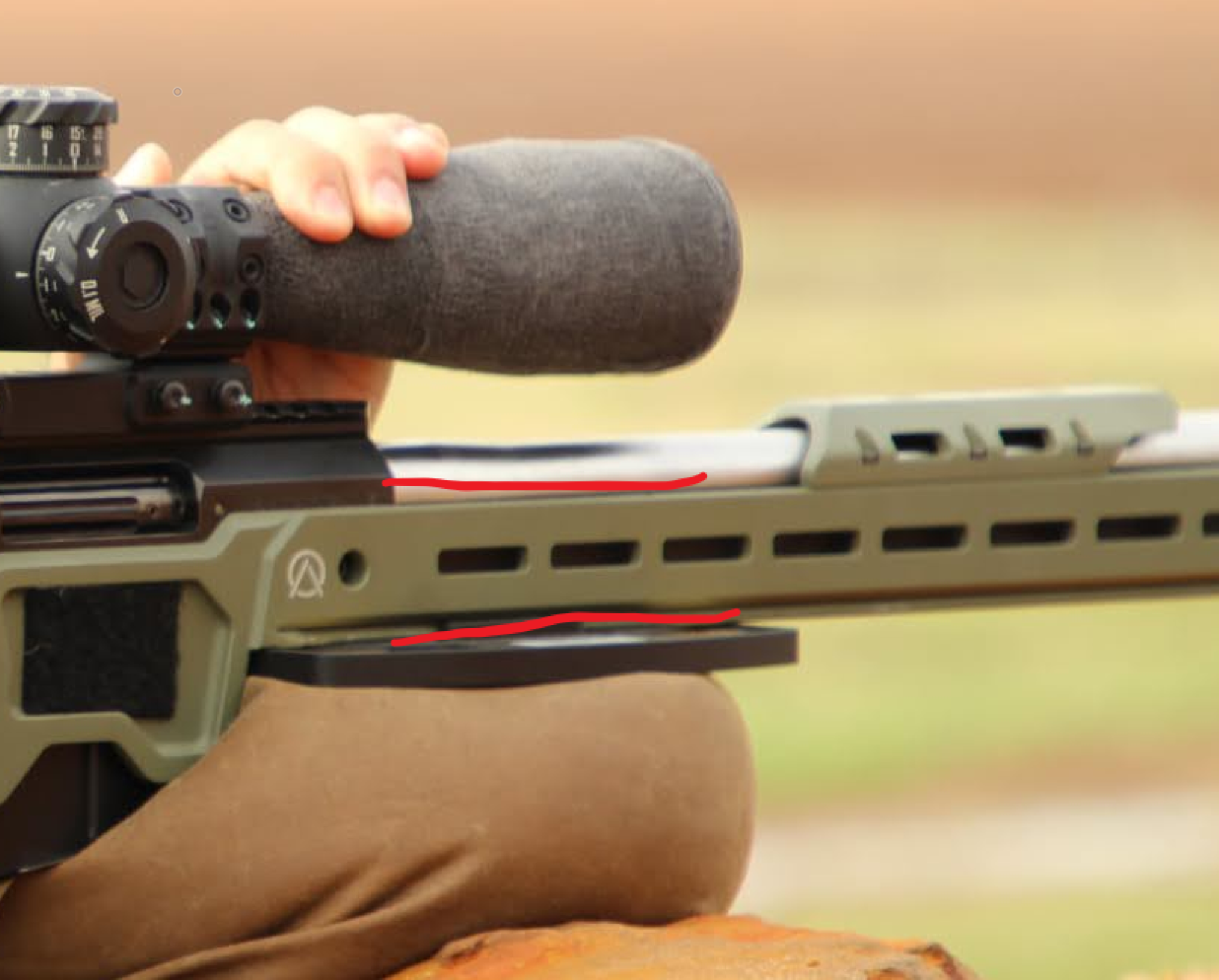

I've been thinking a lot about the distance from the center of the bore to the bottom of arca as i transitioned from an AT to an AT with obsession chassis.
Between these two I've definitely noticed it matters for roll/cant control but it seems that it might be more of a center of gravity thing too, as well as moving the recoil impulse to a more favorable position in the buttpad. I know the new AT-X also emphasized a lowness in the chassis.
I'm looking to build an impact action and theres quite a bit of variation in options--is this something you guys look for? It seems the MDT ACC might be the lowest, and everyone a fair bit higher.

There are a couple things at play. The forend to bore axis distance definitely helps with stability on props, as it reduces cant and lowers the COG of the rifle closer to what it's sitting on. That makes vertical and cant wobble less. But the balance of the rifle matters a lot too; anything that is rear heavy will magnify the "up" reticle movement during recoil.
R700 chassis' are limited to how close the bottom of the forend can be to the bore axis by the height of the recoil lug. I'm sure the ACC, MPA, Vision, XLR, etc are all pretty close to the same assuming they can all accept an "x" height recoil lug. If the atx-R700 chassis ends up being significantly closer to the bore axis than those, I'm not sure how they'll have done it to accept a wide variety of recoil lugs and maintain forend stiffness.
