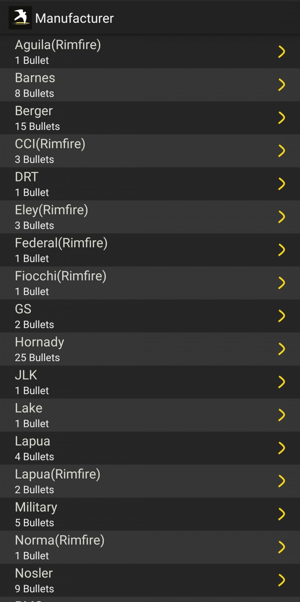

Just go check the AB bullet library in the phone app under .224 caliber. I use the cdm but G1 goes quite well with 22LR for quite long distance, if I remember correctly, roughly 0.1mil off from cdm until it spreads a bit after 300ish.
Oh my dear, I had no glue, thanks a lot.
