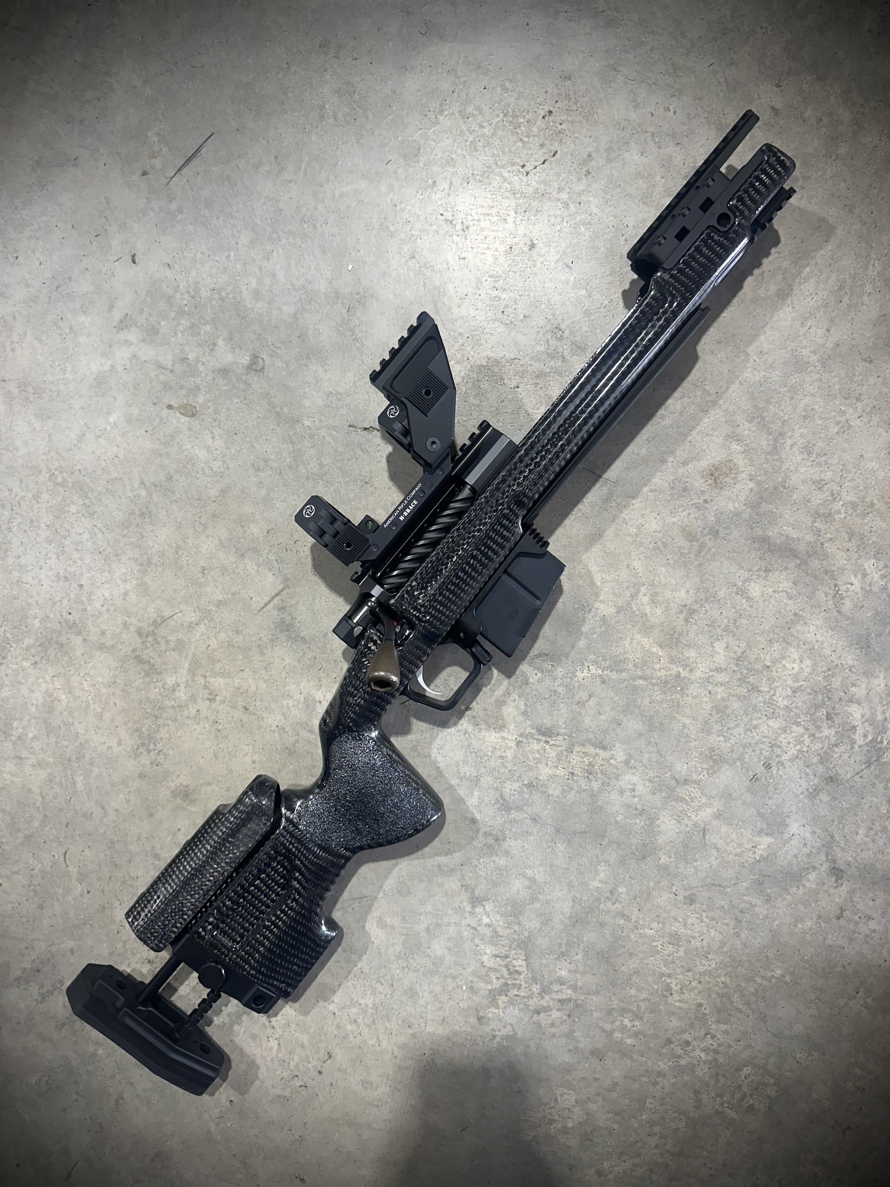

I use the hawkins mag and aiaw mags with my CDG and Mack Bros bottom metal.
Aics mags need a shorter mag latch for me. I would try the flush MDT poly 3 round but my guess is they would need the shorter latch too.

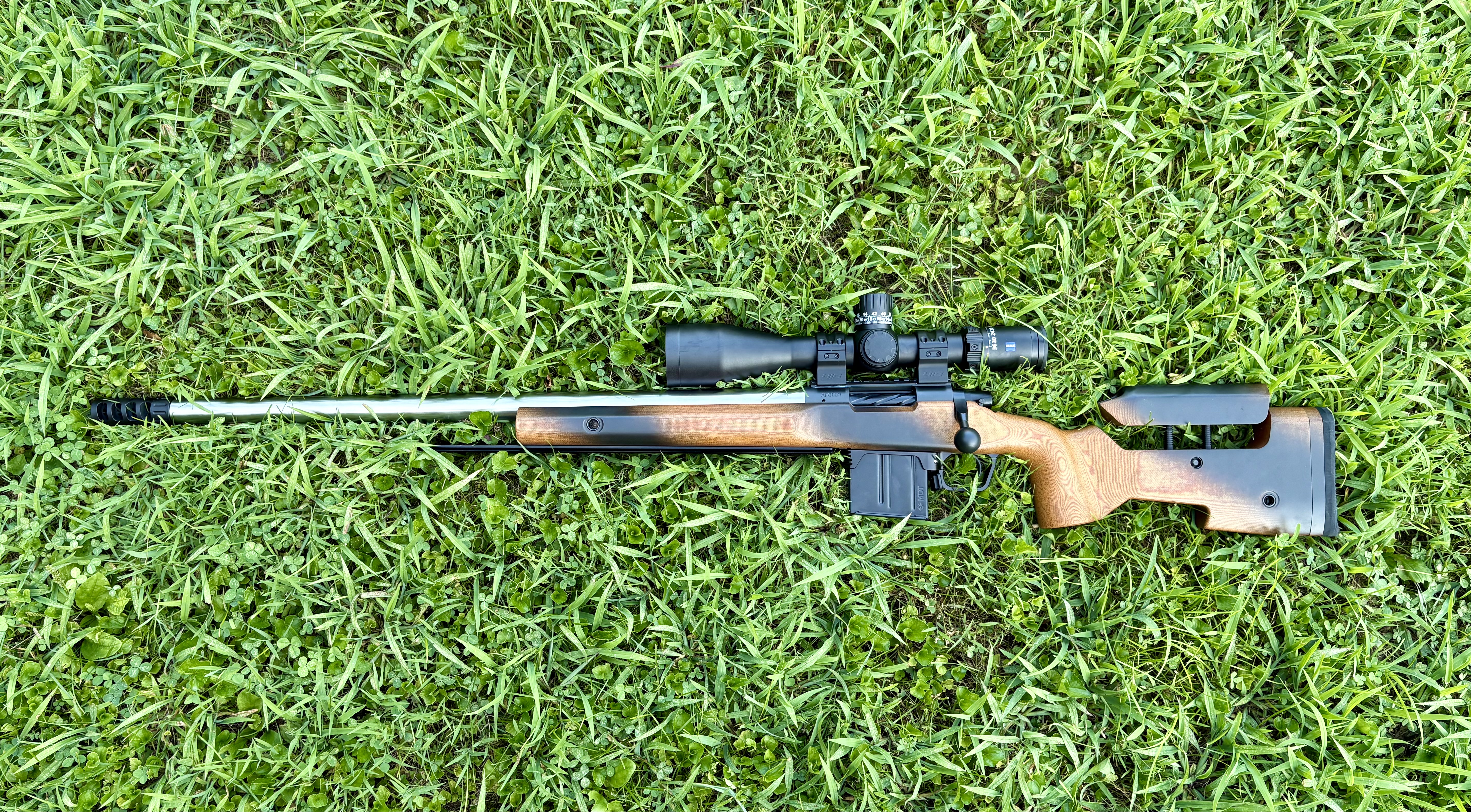

Bottom metal dropped right in on a manners.
The Hawkins hunter mag was really tight to seat fully so I did file the mag catch on back of mag for more positive and reliable mag seating.
I am running 6.5prc right now in my SA CDG. Feeds reliably for me.
