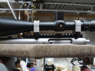

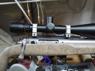

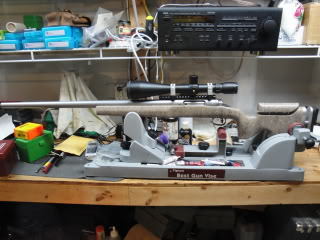

Op as a guy just getting into this I bought a savage Model 10 I don't see how you have a problem here savage makes a great gun it will get you shooting if nothing else.
I wouldn't worry about accuracy potential of what you've listed. More important........is the shooter 0.5 moa or better?? I think that accuracy comes with practice. And the money you would be saving by going with the Savage....... would pay for a lot of ammo......and thus potential for practice. I've got several Savages.....mostly BVSS based rifles....all with custom barrels and recoil lug. But I also have a dual port target action with a Krieger barrel and custom stock in 6mm Dasher. That little rifle has more accuracy potential than I do as a shooter. Also, when I shoot this barrel out......I really like having the ability to easily swap barrels myself....I think others appreciate that feature as well.
As was stated.....the Savage action isn't butter smooth and isn't as purdy as a full custom action. But IMHO, they have just as much potential for accuracy as any of my blue printed Remington actions.
What's posted on the internet should be taken with a grain of salt........not everybody can afford full on custom rigs.....so if the Savage fits your budget better......build it and get shooting! You can always upgrade down the road.
