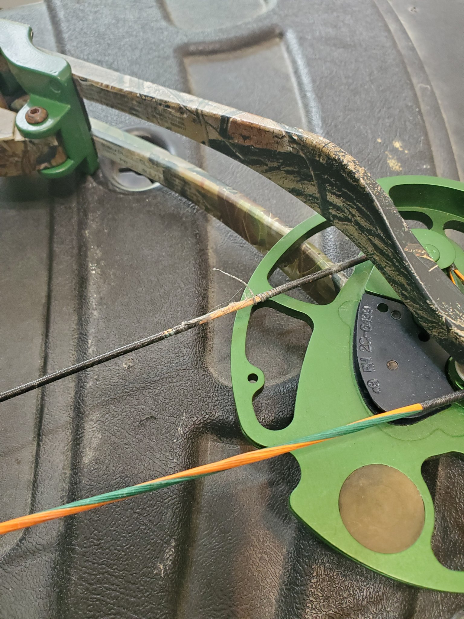

Does this need a new string?
Needs new serving for sure, but probably yes. I cant really tell if the orange/green is torn up or just the serving. If there is orange/green damage, id be replacing the cables and string. If its just the serving you can re-serve. Id also be looking as to why if you dont know what happened. Could be a burr in the channel on the cam from bumping it on shit.

Even if the string looks ok, I’d replace it and cables. At 14 years old, it’s worth the $100 a shop will charge to not be holding an inevitable explosive when that string pops and parts go flying.
If you continue not shooting a ton, and keep the string/cables waxed, it will easily last another 14 years without issue. Worth $7.14/year in my opinion.
It won’t take much time or effort to sight in. Just do it.

Yes replace it, if it snaps there is a good chance it will damage the cams and limbs, not to mention you, at that point you will have half the price of a new bow when you replace all the damage. If you have to re sight it in, remember you chase your arrow, if it shoots high move your sight up etc.....

You gotta just break down and get it re strung. Sighting it back in takes less than an hour. Now that archery season is over in CO you'll probably find that most archery shops are dead. If you walk in and nobody is there the guy is likely to string it for free if you buy strings there. Then he's likley to spend an hour with you dialing it in if he's bored. It all depends on his mood and workload when you walk in. If he sees you as a future customer, he's real likely to spend the time. If he does do you a solid, buy your shit there.

How hard is it to restring that bow? It’s like shoelaces. You know they’re gonna fail but you try to get just one more trip out of them and then you suffer.
It's easy. Press required, measure you axle to axle before you start Press down just far enough to get the string and cables off. New string and cables will be optimally twisted. So don't add or take out twists while your changing them.
Being the first time doing it, one at a time to make sure they are routed the same.
After they are swapped, I put it in a vise, get the riser straight up and down. Make sure the rest is at the correct height. Arrow should be center with the hole that the rest is mounted in. ( Berger hole).
Put an arrow in and level it, you can tie your dloop in there with the nock as your reference point.
Measure your axle to axle again with new string. If it's the same and what the manual states it should be in time. There are spots on the cam or cams that touch the bus cables at full draw. They need to touch at the same time at full draw.
If it's not in time the cables will need a twist added or taken out to get it in time.
Once it's in time, paper tune.
Get it sighted in
Crank 30-40 or so arrows through it. Check timing and axle to axle again.
Many say 100 arrows for strings to fully settle. The people I get strings from with Bloodline 99 string they are settled in within 20 shots.
