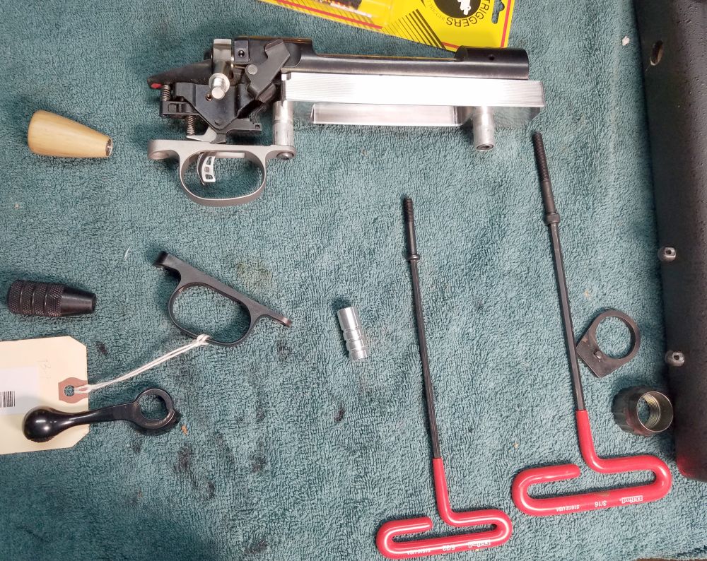

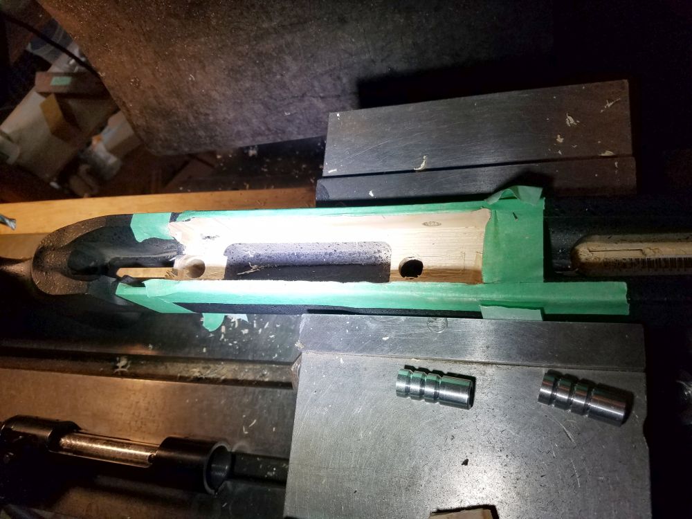

I just put a Whidden V block in a Boyd pro varmint.
I had to mill right through some crossbars in there.

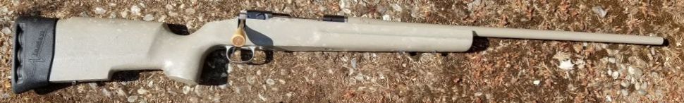

@Clark looks pretty good!
