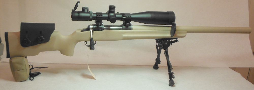

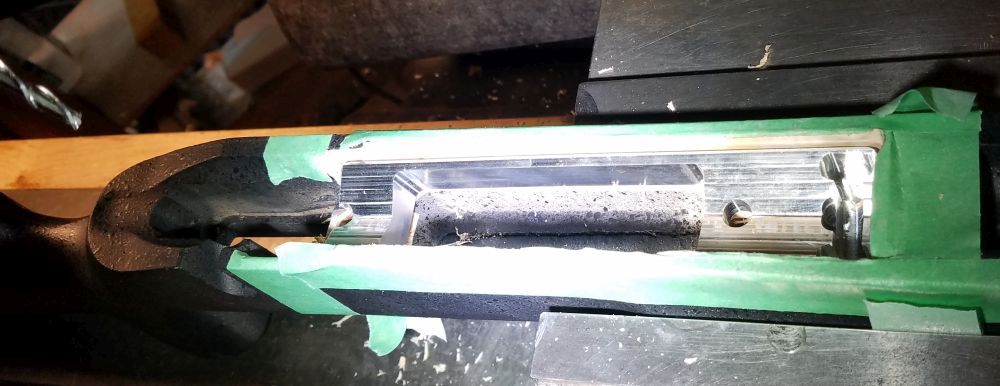

I have had great accuracy with Boyds tacticool stocks:
1) 223 in sav 110 with aluminum pillars I made
2) 7mmRM in Rem 700 with Whidden aluminum V block I bought.
3) 6.5-06 in DuMoulin Mauser with long Aluminum bedding block I made.
Smallest groups ever with 223.
Other 2 rifles killed deer beyond 600 yards.
