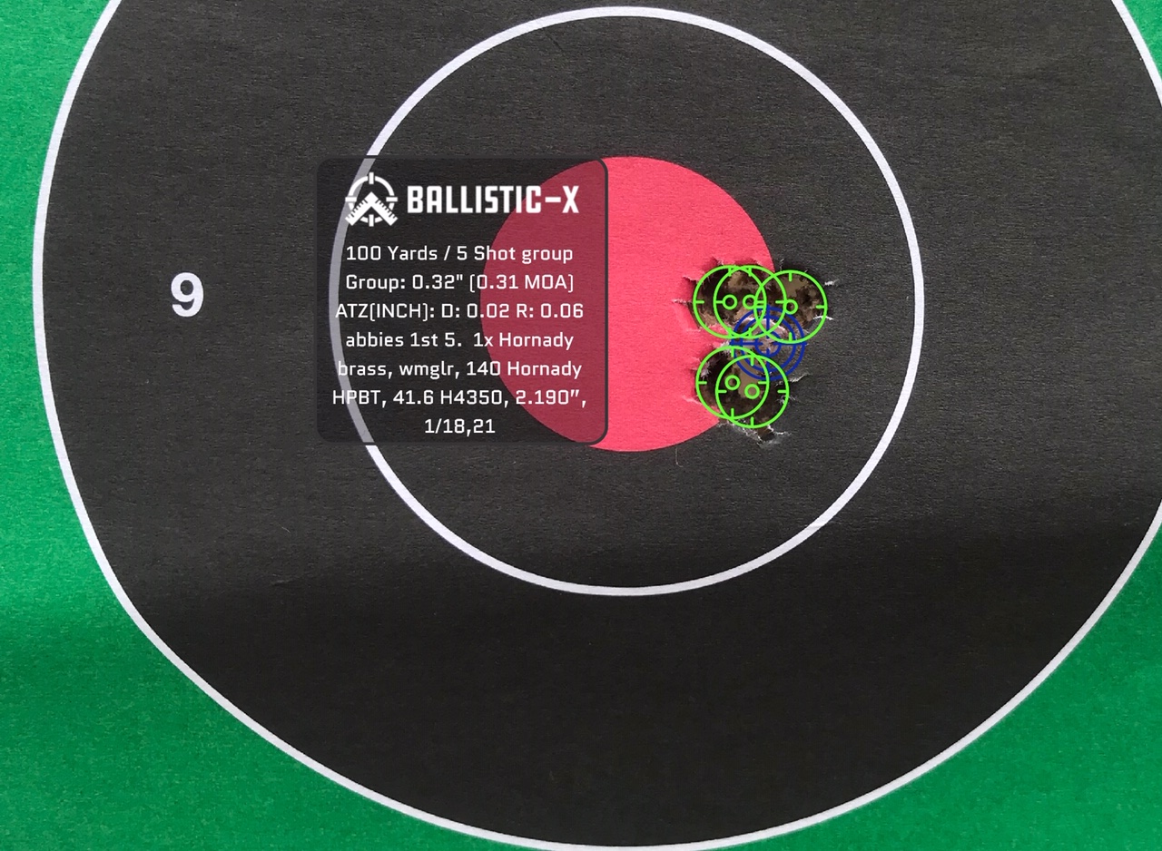

    Today was the 1st trip to the range with the fully completed rifle and she impressed me with her skill with such a low cost build. We were testing some new loads at 100y, doing some chrono testing and hit a great node despite being a touch on the slow side, 140's @2710. She managed a 5 shot group at .3 moa, followed up with 5 more to the same spot opening the group up to just a touch over .4 moa. So a 14yo girl with only 6 months of shooting experience managed a 10 shot .4 moa group with a slightly reworked OE Remington barrel. I don't think I have ever seen a factory Remmy barrel shoot this well and she was able to hold it there for a 10 shot string. I truly believe there are great things in her future! Unfortunately I did not get any target or rifle pics, phone battery died.

    Today was the 1st trip to the range with the fully completed rifle and she impressed me with her skill with such a low cost build. We were testing some new loads at 100y, doing some chrono testing and hit a great node despite being a touch on the slow side, 140's @2710. She managed a 5 shot group at .3 moa, followed up with 5 more to the same spot opening the group up to just a touch over .4 moa. So a 14yo girl with only 6 months of shooting experience managed a 10 shot .4 moa group with a slightly reworked OE Remington barrel. I don't think I have ever seen a factory Remmy barrel shoot this well and she was able to hold it there for a 10 shot string. I truly believe there are great things in her future! Unfortunately I did not get any target or rifle pics, phone was dead.

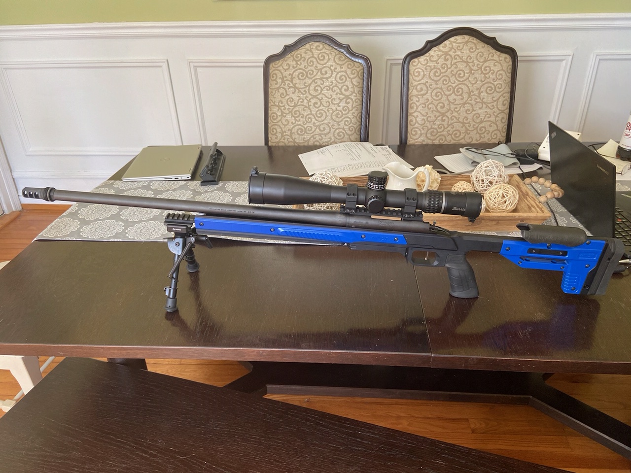

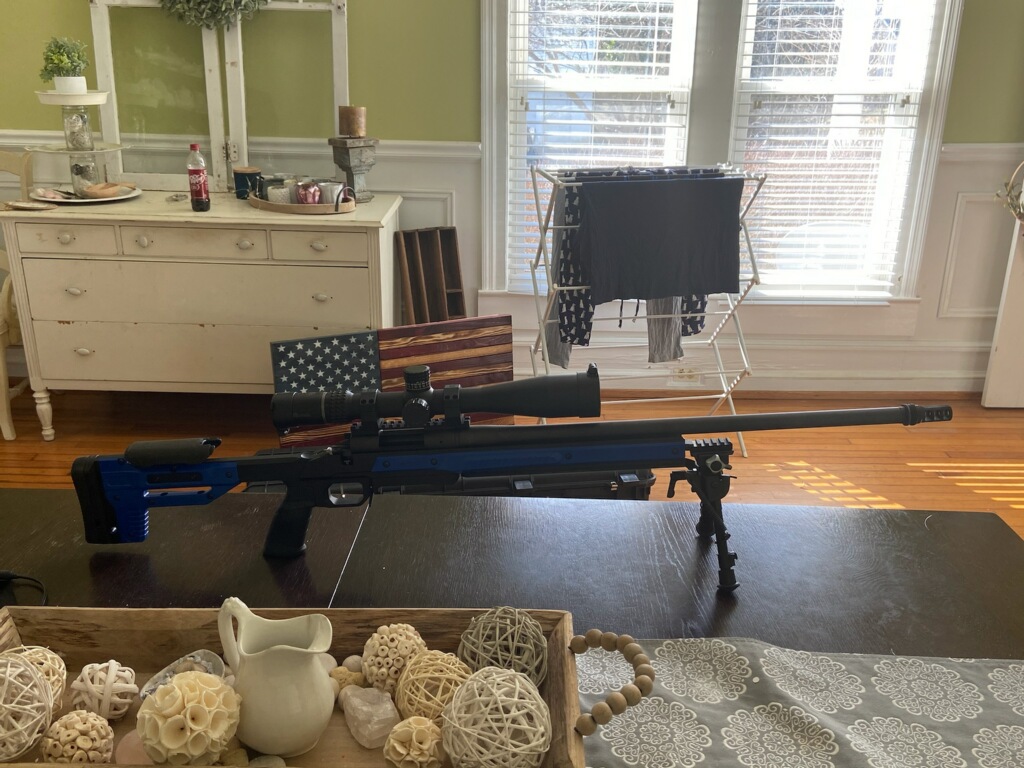

    Back out at the range with Abbie last Saturday testing out her new @Defiance Machine Badrock rifle. She has finally found her speed and runs this new rifle like a pro. Was able to go 10 for 10 at 500y from 7 different positions on our clubs practice course with 15 seconds left on the clock. I think she is ready to go. Hope she can stay cool on the clock when it counts!
