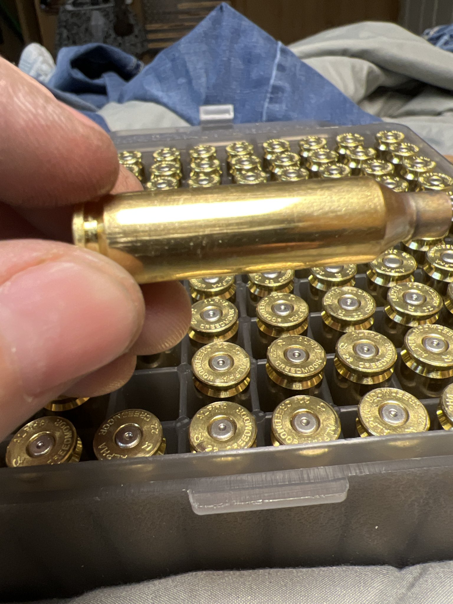

This is the brass primers r flat but not cratering at all this is wat the scratches look like

Only thing I can think of is maybe my chamber need to b roughed up a lil so the brass will grab because with fired brass a bullet will go straight in it withy fingers
Of course it would. It’s fired. It got bigger.

Too much headspace? I had similar issue where brass was slamming back into the bolt face and along with a burr around ejector looked like pressure signs. After cleaning up the burr and jamming on the first firing all false pressure signs went away.
73g eld 3376 22in barrel
Running your data through QL says that velocity is around 65kPSI. On paper you're loading well below max charge weight but your chronograph says you're at max. Combine new brass with .007" of shoulder movement and that's probably why you're seeing pressure signs with the Alpha, and not the necked 6CM Lapua. Your Lapua brass load is over max but probably more tolerant due to hardness and shorter headspace. Your Alpha brass would probably be happier if you went down to 36gr and jammed the lands for the first firing.

Ok so apparently this thing does not like h4350 but it loves varget for now witch is even better for me I can push it to pressure but I do not have to I am running 100fps faster with no pressure at all witch puts me right we’re I wanted to b in the first place same seating depth all is the same other than a diff powder and powder weight charge it will shoot virgin brass Aswell as 1st fired brass
No virgin brass wasn’t sized it came out to fit great in the gun other than being a.005 shoulder jump but in saying that I will try jamming and going to 36gr of 4350 just to c if it works but when I loaded some at 36gr I was getting some hang fires for some reason and yea I’m not good with Grammar and punctuation at all I’m to lazy for it anyway
