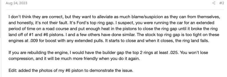

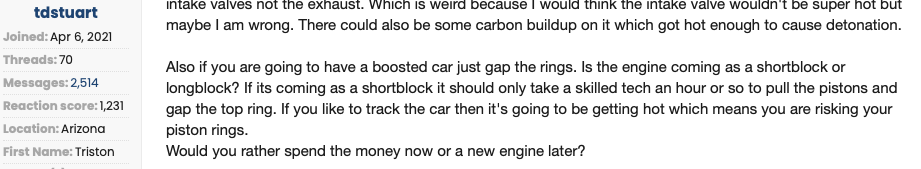

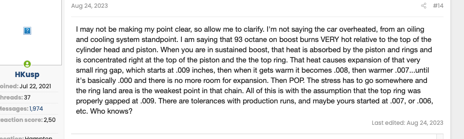

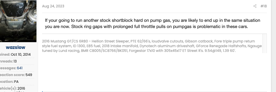

There are literally a ton of people who have proven that they last quite a while at that power level...
Again if he's going to go beating on the car constantly I dont disagree with you that a built motor is the better way to go, but for the occasional blast, it'll be fine and there are tons of examples out there of that.
And there are a ton of people with damaged engines after a few thousand miles, which is very likely to happen. Why chance it, just fucking do i right.
That piston is out of a F-150's 5.0 with a stage 1 Whipple on their tune, 7,000 miles on the engine 2,000 with the blower.
Lots of people have made good power with a blower anda stock bottem end safely with a GOOD tune. If I am going in deeper then slapping a blower on it, I am going fully built and twin turboskis.

Throwing a blower on a none prepped engine is not a wise move.
another example of what is will do.
2019 F150, Gen 4 2.9 Liter whipple stage 2.
bought truck new with dealer installed whipple
Running Standard stage 2 whipple tune with 91 octane.
Truck has 8,800 miles.
Truck failed while towing my f100 back from the dunes.
CEL lights:
P0300,302,306,316
just was informed by the dealer today they are replacing the short block and heads under warranty and that piston 6 rings failed.
I am pretty bummed about this. hope it was a fluke. bought this truck as a fun truck and a truck to tow my f100 from time to time but now that the engine failed, im skeptical about continued use as a tow rig.
is piston rings failure common? Im wondering if its a lack of enough ring gap like the boosted LS engines have problems with.

yes break things because its warrentied.
just brilliant. You sound like the 2020 protestors who think destroying property is okay because it's insured.
Or you could correct the issue on the front end and not worry about it.
Gapping the rings, changing the exhaust valves and better springs is not 15K.
Not even with rods and pistons, which you don't need but would be insurance.

I can buy the ring gap theory due to higher cylinder pressures and temps.
Coyote's have stainless exhaust valves from the factory... so what does changing exhaust valves gain you? I mean you could go to inconel to handle some more heat...
And why "better" valve springs? Coyote's will spin to 7k+ on factory valve springs just fine and do that for 100's of thousands of miles... Putting a heavier spring in "just because" is not really a fix for anything except increased cam, valve train and valve seat wear. If you dont need a higher rate spring in order to control valve train at higher RPM's, just putting them in for the sake of putting them in is pointless. So now you have a valve train that is pushing against a higher rate spring to open valves as well as trying to open valves against boost... I can "sort of" buy higher rate intake valve springs on an FI car to help keep the valve closed while the intake tract is pressurized... but again valve spring rate needs to be matched to RPM capabilities otherwise you are just wearing parts for the sake of wearing parts... The other part of valve springs getting changed is if you change cams and the springs you have will hit coil bind with a higher lift cam. Ive been through the gamut of spring selection when building my current road race motor... singles, doubles, bee-hive vs. conical, rates, installed height, coil bind, resonance frequencies, etc... There is so much more to valve spring selection than just "I want better springs"...

Yes ring gap and Inconel to deal with the heat. 100%.

I have never once argued against larger ring gaps for a boosted motor so not sure why you keep riding that big black horse cock... I will continue to argue against opening up a brand new factory motor to increase ring gap to put a blower on when Ford and Whipple will warranty that shit for 3/36k... Its just not necessary at the power levels the stage 1 setup puts out... but bump up to the stage 2 or 3 setup and you may have issues...hence no warranty... I also bet you will cook the damn cats if you go stage 2 or 3... and probably blow up some other stuff in the trans, rear end, etc... Ford has done enough validation to say "at this power level we feel things will last a good long while and are willing to put our money where our mouth is and give that 3/36k mile warranty, BUT if you go above that with a stage 2 or 3 setup, we dont think things will last and thus no warranty"... pretty easy to comprehend IMO... I mean FORD Performance built the fucking tune for it(the stage 1 that is).

I am talking about boosting an N/A engine known to have issue when you do it, and you decided to jump in the ring and defend it. Here we are.
One doesn't have to look far to find many of those "stage 1" factory warranted, factory tuned time bombs going off. I have even shown multiple examples of it happening. Even an example of ford actually honoring that warranty, because I have also heard many horror stories of them not. That route is asking for more problems down time and hassle.
I have cracked open a few brand new engines to swap in parts, do port work and other mods, sometimes its the way to go sometimes not. Another thing you could do is pull and sell the OG engine and buy an Aluminator.

Do not put a blower on a naturally aspirated engine without tearing into the engine you gotta open up the ring gap ,you need different exhaust valves, valve springs. Rods, and pistons probably wouldn’t be a bad idea on a coyote either. You can do it without some motor work, but it ain’t gonna last
You're fucking joking right?
Reactions: sloporsche
Why do you need better springs for just boost? You're not changing the lift so what exactly are springs accomplishing?
