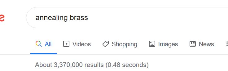

This place seems to become more Reddit-like every day.
It is incredibly easy to find this info here on the forum, or with exerting
almost no effort via a Google search.
