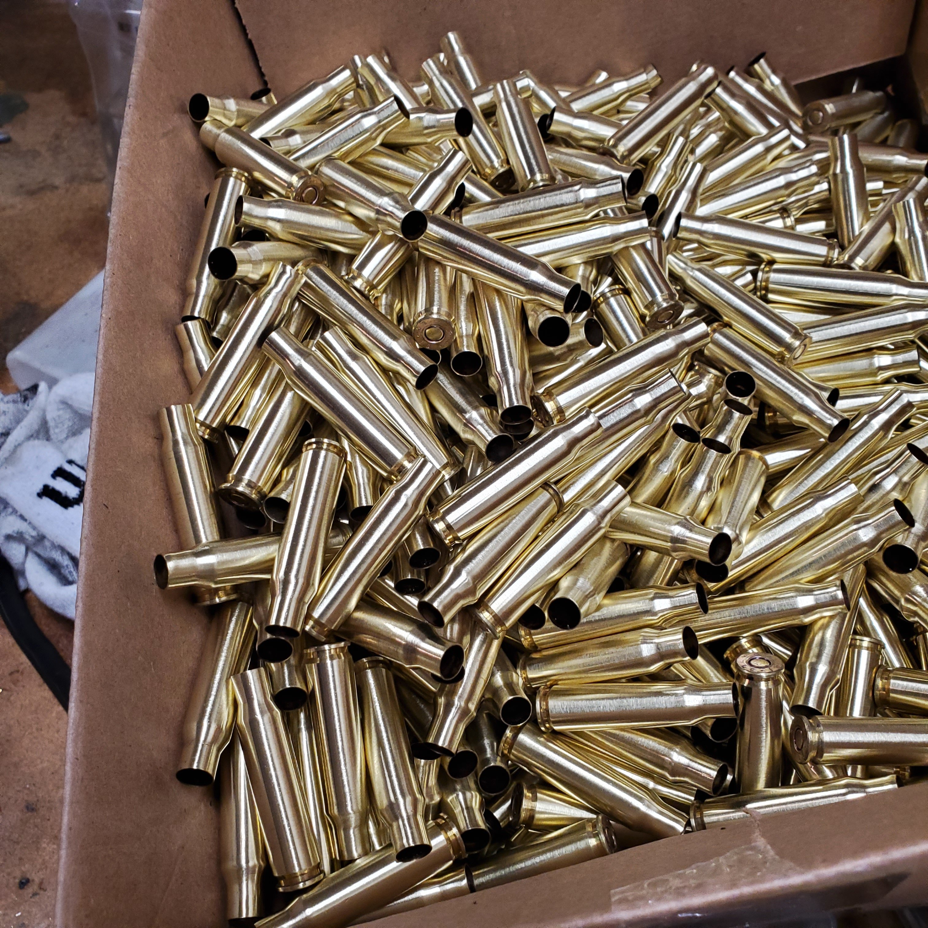

Good ol LC brass is great for 308 AR 10s.
Capable of fine accuracy, and cheap.
And ya don't care if ya lose some.
This box of 1000 has already been fired.
Fired LC and Lapua brass against each other with the same target bullet and same powder charge in a bolt action target rifle.
The Lapua only gained .1" in 5 shot groups over random no case prep LC brass in this small test.
A tenth inch ain't worth the price of admission for Lapua that most things an AR will be engaged in for most people, most of the time.
