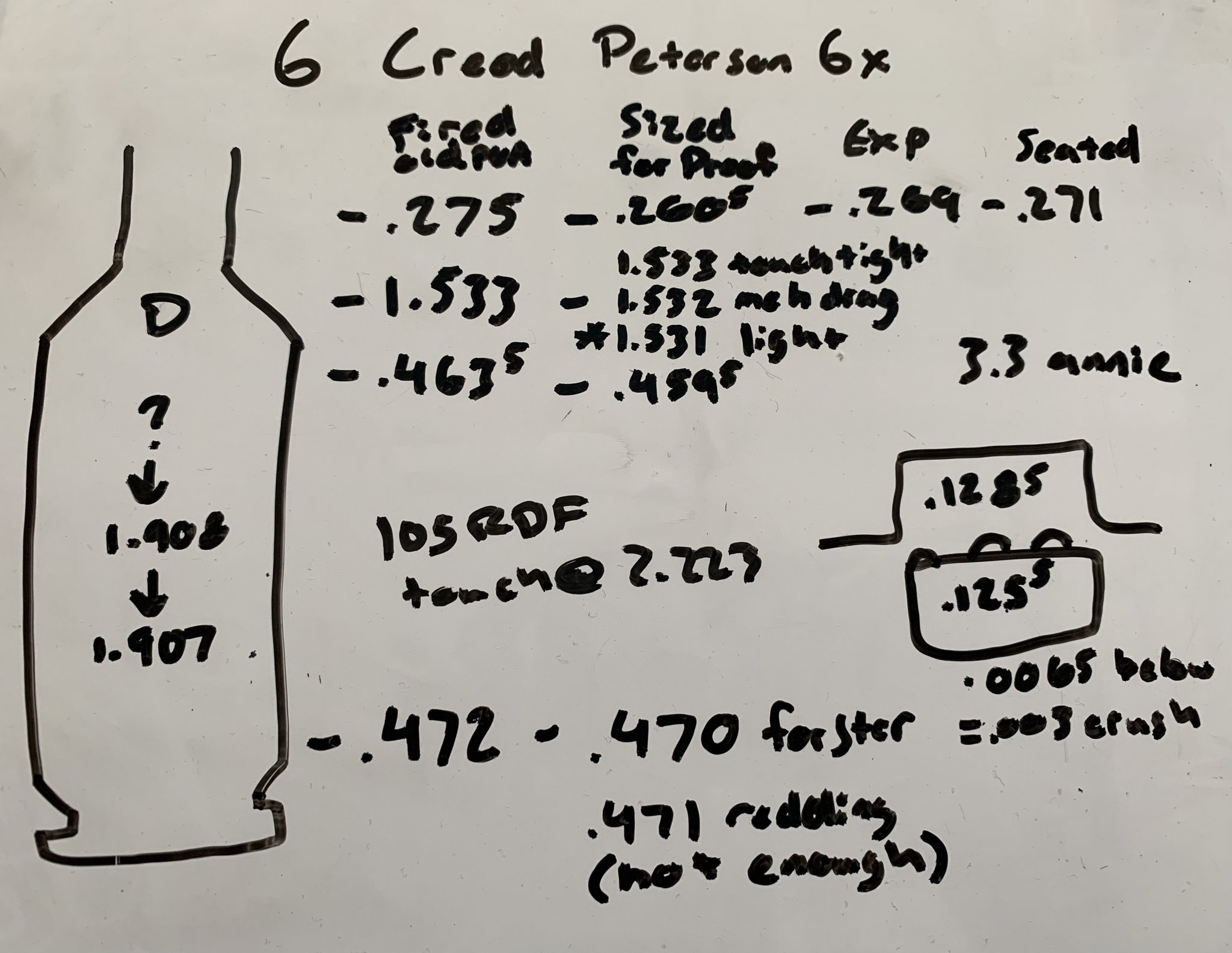

Ahh no problem, simple answer is if the chambers have different base sizes when you use brass from one chamber to another and the die doesn’t size the base of the brass .200 line enough the bolt clicks at the top when you go to extract the fired case. Here is a better explanation or example from Alex Wheeler.
Only way to know is to test it. If your loaded round goes into the chamber smoothly next step is go out and test fire a few rounds. If you have any issues post I here but it sounds like you should be fine FL size the brass and bump the shoulders .002.
He also has a video on headspace.
Measure the fired brass, measure it sized, see where it contacts and at what point you can chamber it.
In this case, the Redding did didn’t take the base small enough to fit the new barrel but the forster die did.
