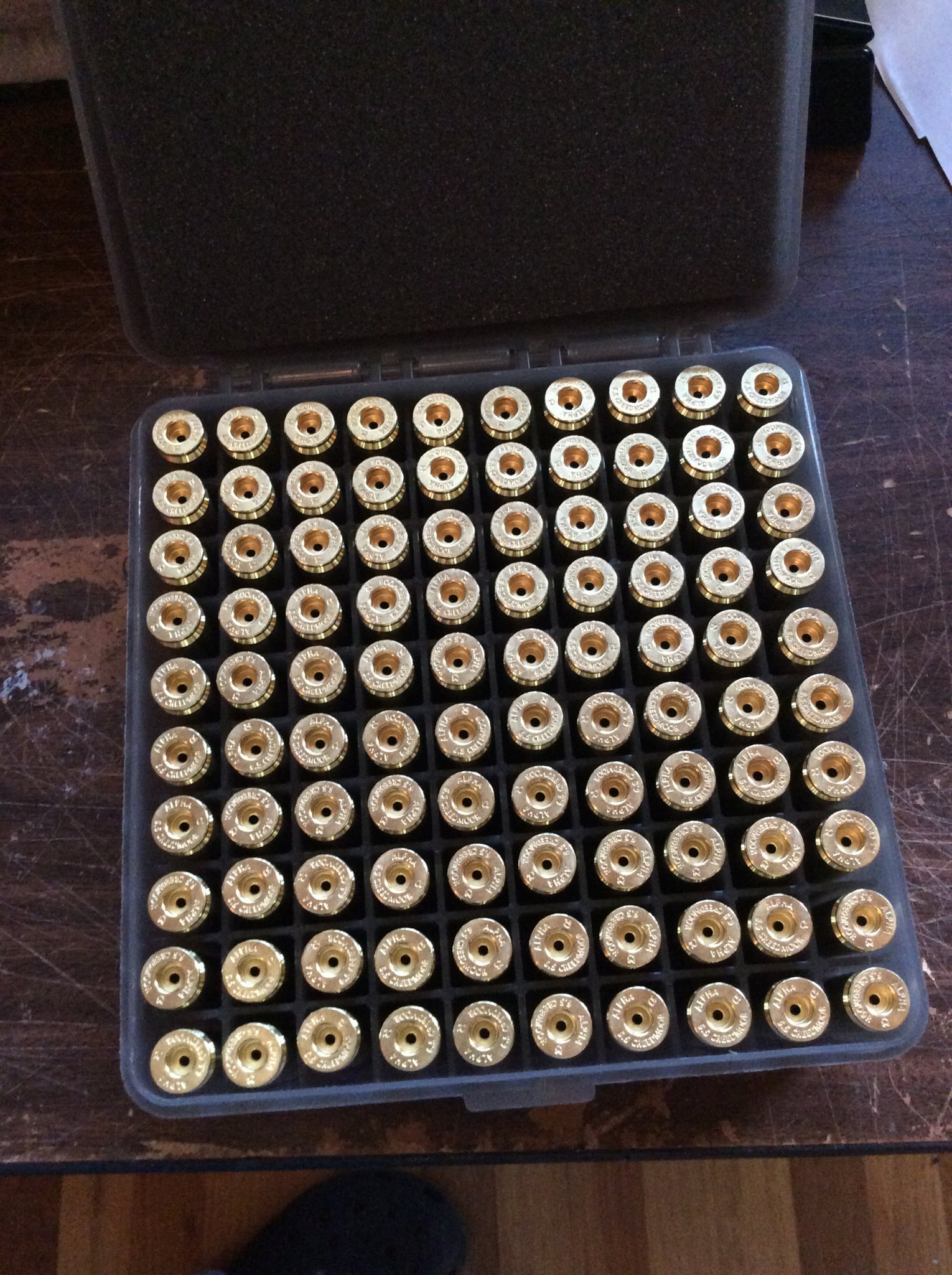

Yes, so far the alpha brass is the stuff of dreams. Shows up in a nice orderly case and is extremely consistent. I've not experience brass like this before.
