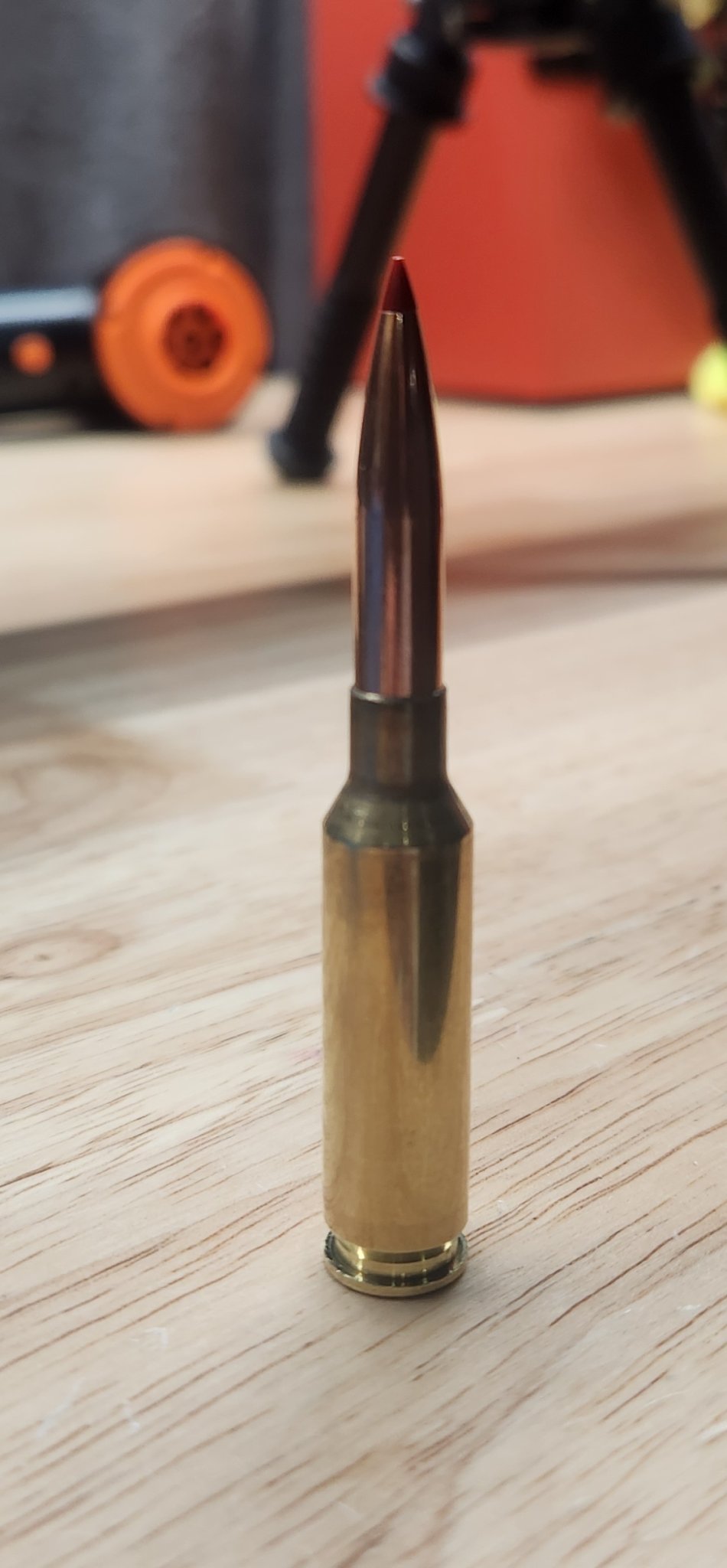

On a couple pieces of brass i shot today which have 2 firings i can get the bullet to slide in and out with a little bit of effort but it slid fairly free but on some others I couldn't force it into it unless I tried hard. It's not just from the shoulder either it's the whole neck being tight. Here's a pic of a hornady 140gr eld match sitting on top like its been resized.

Does the Orgin have spring powered or mechical ejector? Spring powered ejectors tend to run the mouth of the case down the inside of the action and make a flat spot. This also makes bullets not quite just drop into the case.

Is the case mouth visibly round / concentric? Any dents or dings, however slight? Like from ejecting out against a barricade, or onto a concrete bench at the range. Or ejecting onto a bench, and falling onto the concrete deck. Any or all of those can result in a case mouth that is out of round.
If they aren't visibly dented... on the cases that the bullet just sits on top of, can you see or feel any kind of lip or burr on the inside of the mouth
Nope completely round i cauught them in my hand so there no denting
