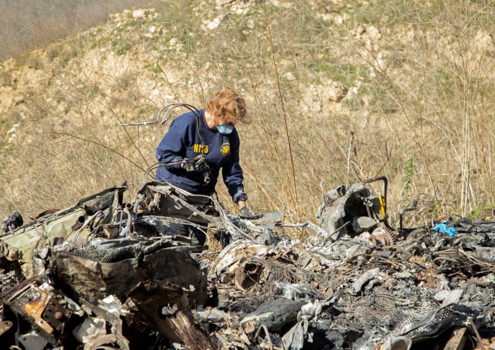

Kobe was a VFR flight, was not IFR flight plan, pt 135 cert prohibited it, aircraft was not certified for IFR. So NA.
So was the other flight. Neither of these flights were flying on instruments or authorized to do so. VFR pilots experiencing SD happen ALL THE TIME. I personally KNEW 2 victims. Fortunately, they were solo.
Reactions: UKDslayer
Was this SD? Yes. But this really is an edge case. An under-qualified inadequately monitored SIC being trained. The PIC should have responded to the emergency faster, but again the SIC did not alert in anyway there was an issue. And the time from the SIC incorrectly reacting to the situation *he created*, to creating the smoking hole, was 30 seconds.

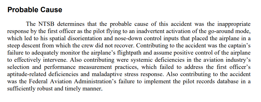

From above preliminary NTSB investigation:
  • Flight crew performance. The investigation examined the factors that influenced the FO’s incorrect response following the unexpected mode change and the captain’s delayed awareness of and ineffective response to the situation;
  • Atlas’ evaluation of the FO. The FO failed to disclose to Atlas some of the training difficulties he experienced at former employers, and Atlas’ records review did not identify the FO’s past training failure at one former employer, which may have affected how Atlas evaluated him during the hiring process and during training;
  • Industry pilot hiring process deficiencies. Limitations in the background records retrieval process places hiring operators (like Atlas when considering the FO’s application) at a disadvantage when trying to obtain a complete training history on a pilot applicant. Also, the circumstances of this accident highlighted a need for improved pilot selection and performance measurement methods

The NTSB seems to think so, based on their probable cause.
Yeah CPT appeared to be startled and sitting on his hands and the FO had a history of being weak, but somatogravic illusions are very real.
I read it. I was not disagreeing, simply noting the unique, unfortunate set of circumstances. The entire event was 30 seconds, but yes, the CPT was likely not providing adequate supervision. The jumpseater appeared more aware.
