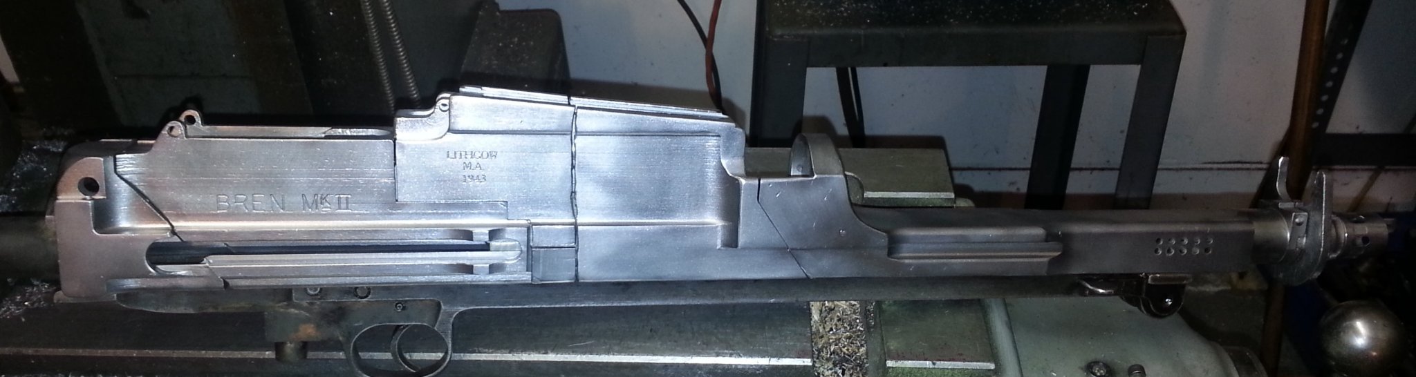

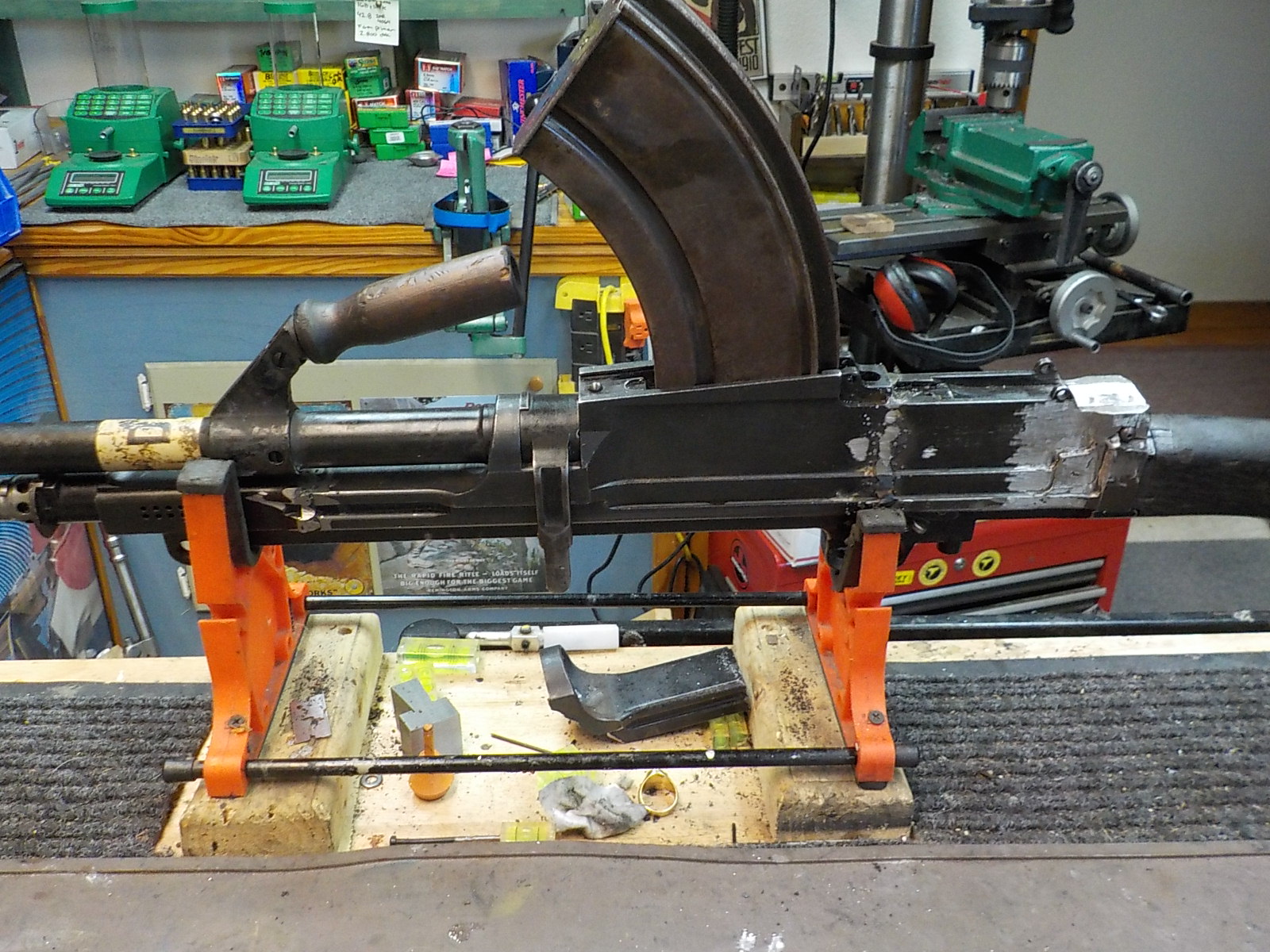

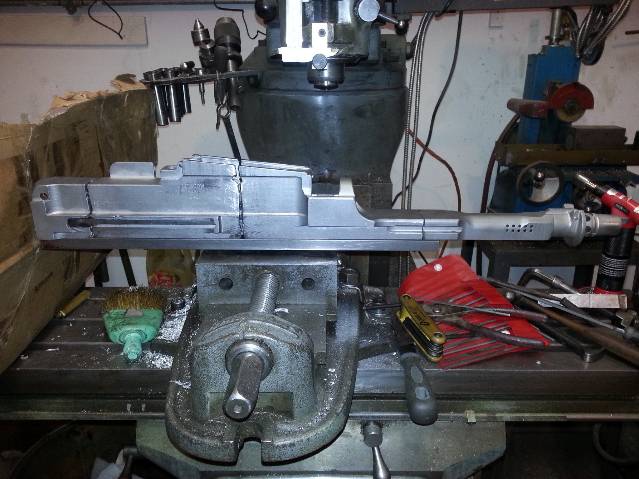

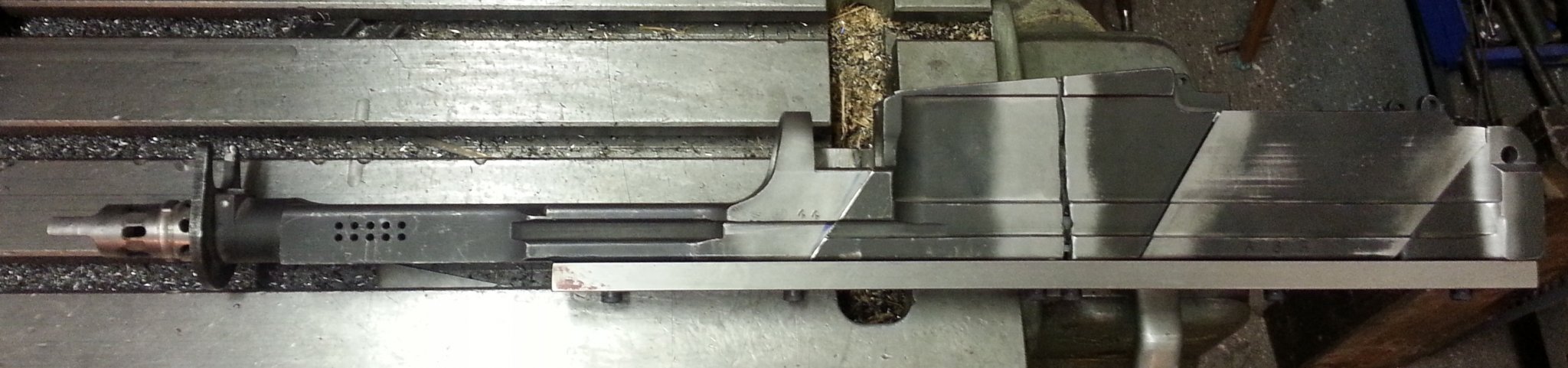

    I'm building a semi-auto BREN from a brutally torch cut parts kit.

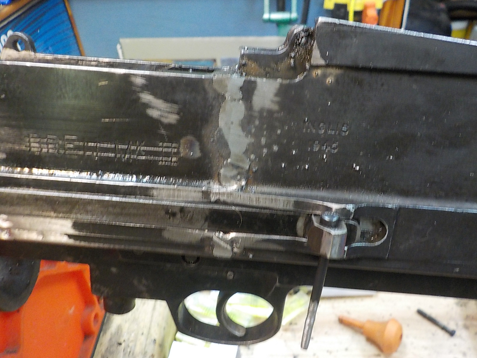

    There are no semi-auto conversion kits available anymore so I am using an old Shotgun News article on converting a BREN to semi-auto. This involves milling my own striker and fabricating a telescoping recoil and striker rod. Below is a portion of the rear receiver that I have re-welded and the fabricated striker. It all fits together and the semi-auto modified trigger works as it should. I'm waiting for my tubing to arrive to make the telescoping recoil/striker assembly. Amazingly, I was able to put the cut receiver onto the frame, hold a magazine in, and get the action to actually load and cycle a dummy round.
    Partially finished striker and welded rear receiver.

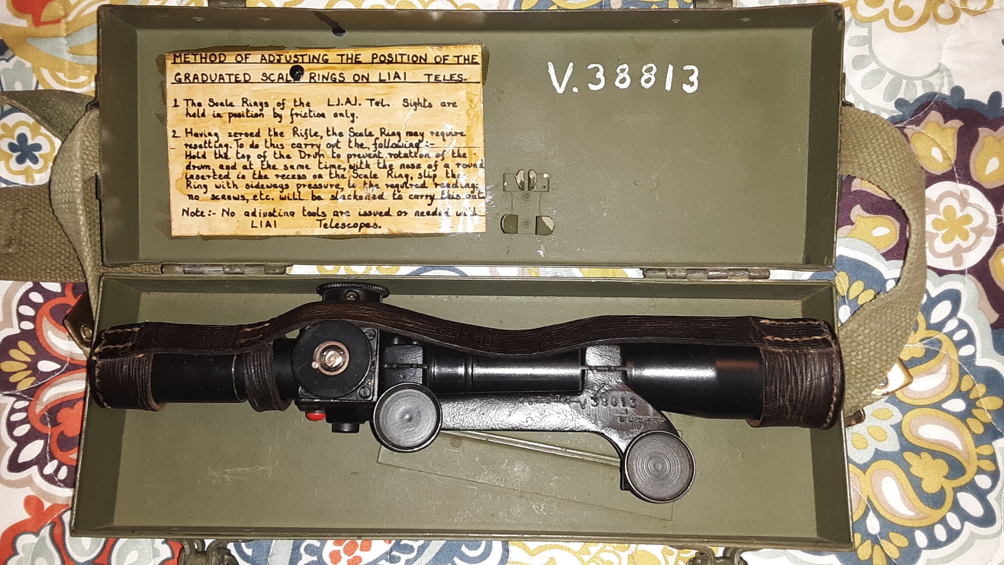

    A well established but not widely known fact : the original design for what became the No. 32 telescopic sight used on the WWII era No.4 Mk. 1 T sniper rifle was as a straight line optical sight intended for the Mk.1 Bren, albeit not for sniping purposes per se.
    Reactions: sandwarrior

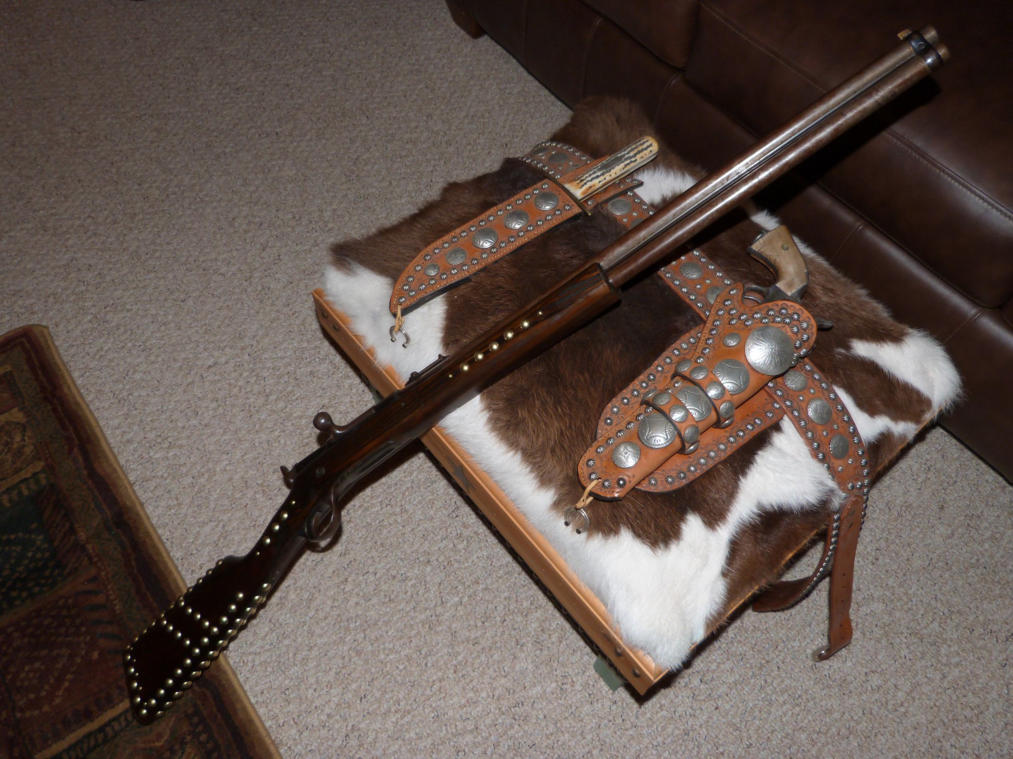

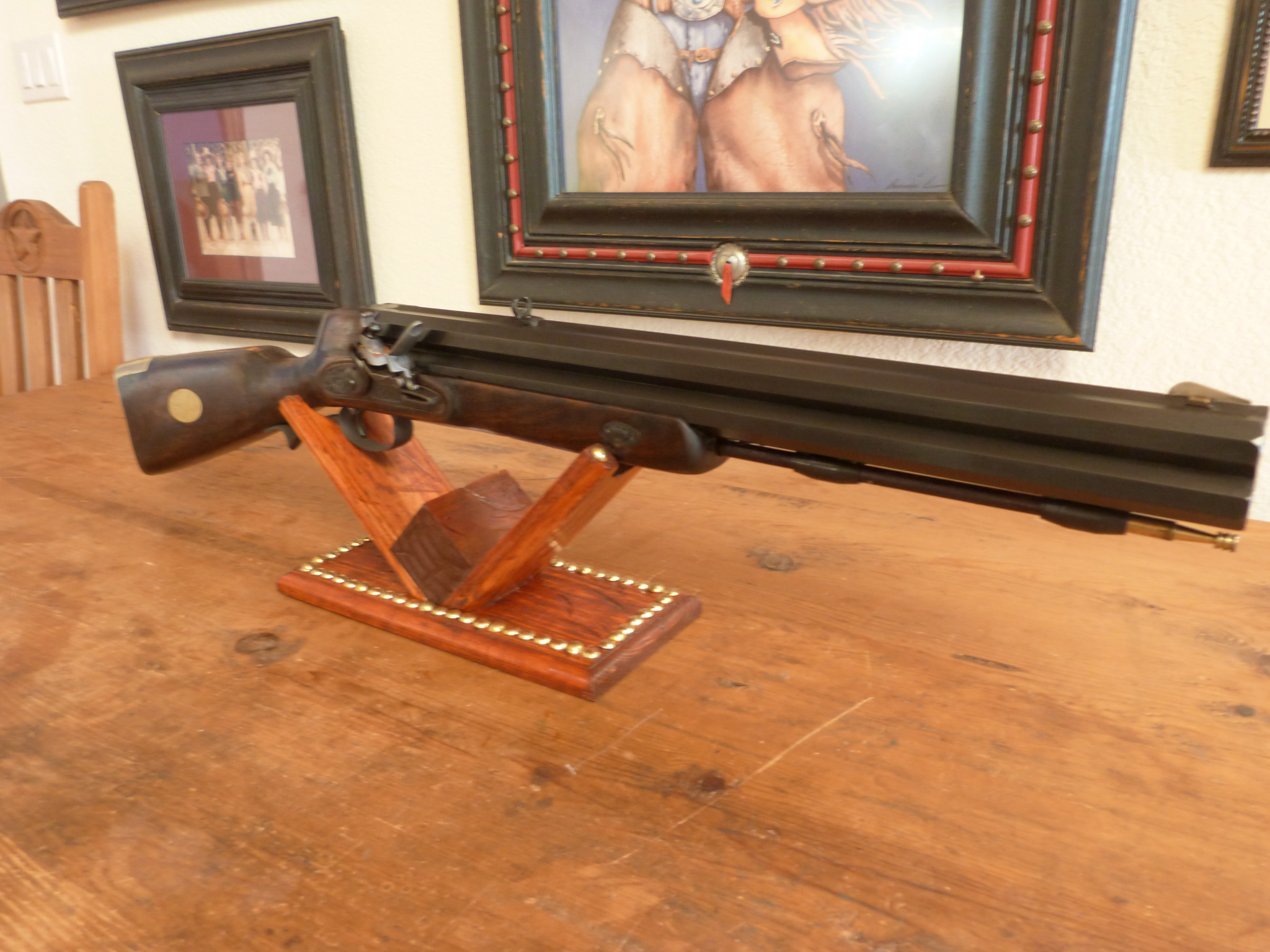

    Making a stock for a Remington Keene from scratch without an original stock or plans to go on...just old photo's of the gun itself.
    Almost finished gun (needed a metal forend cap) ...and I made the holster, knife sheath, and belt. It is a copy of the gun belt worn by Geronimo.

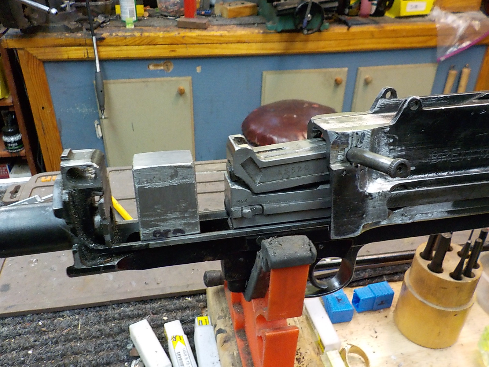

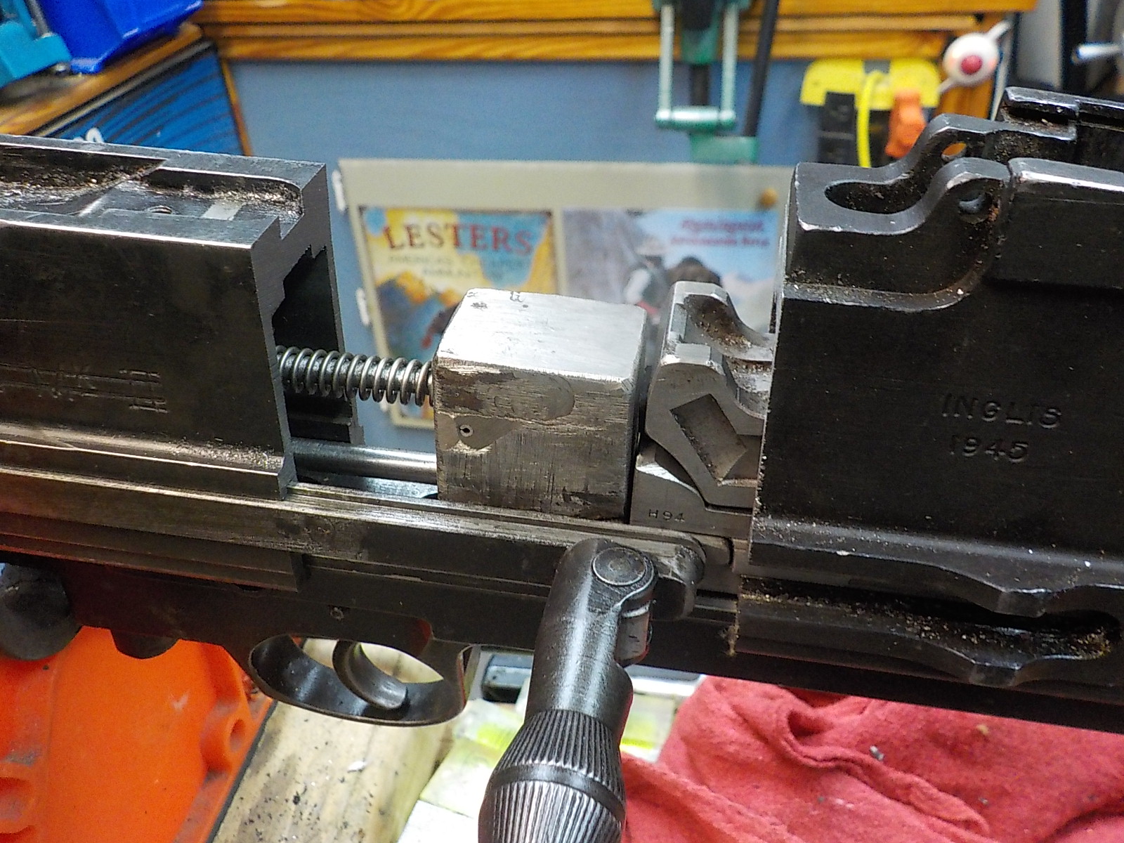

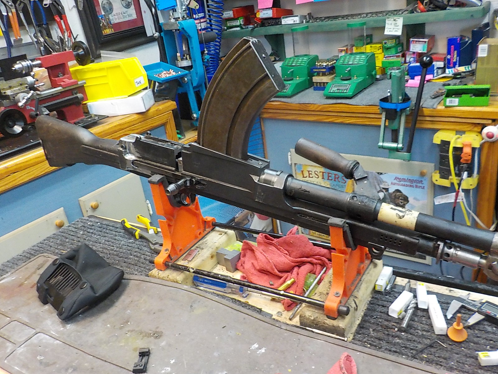

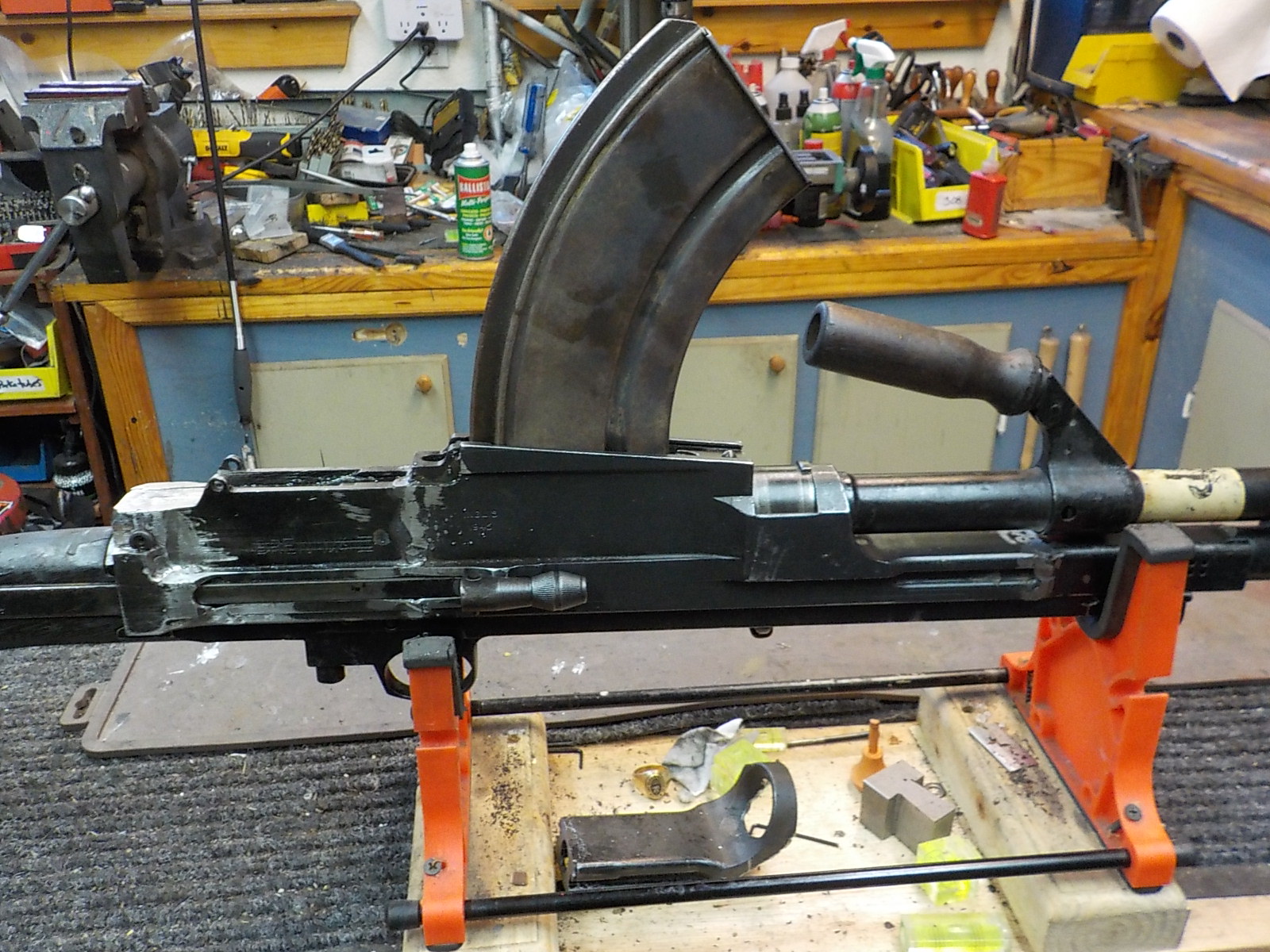

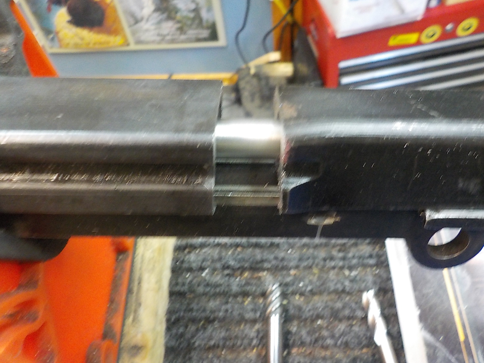

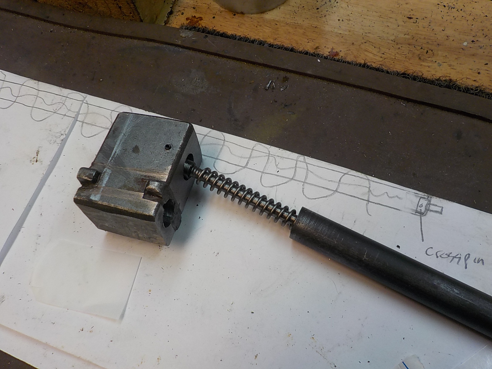

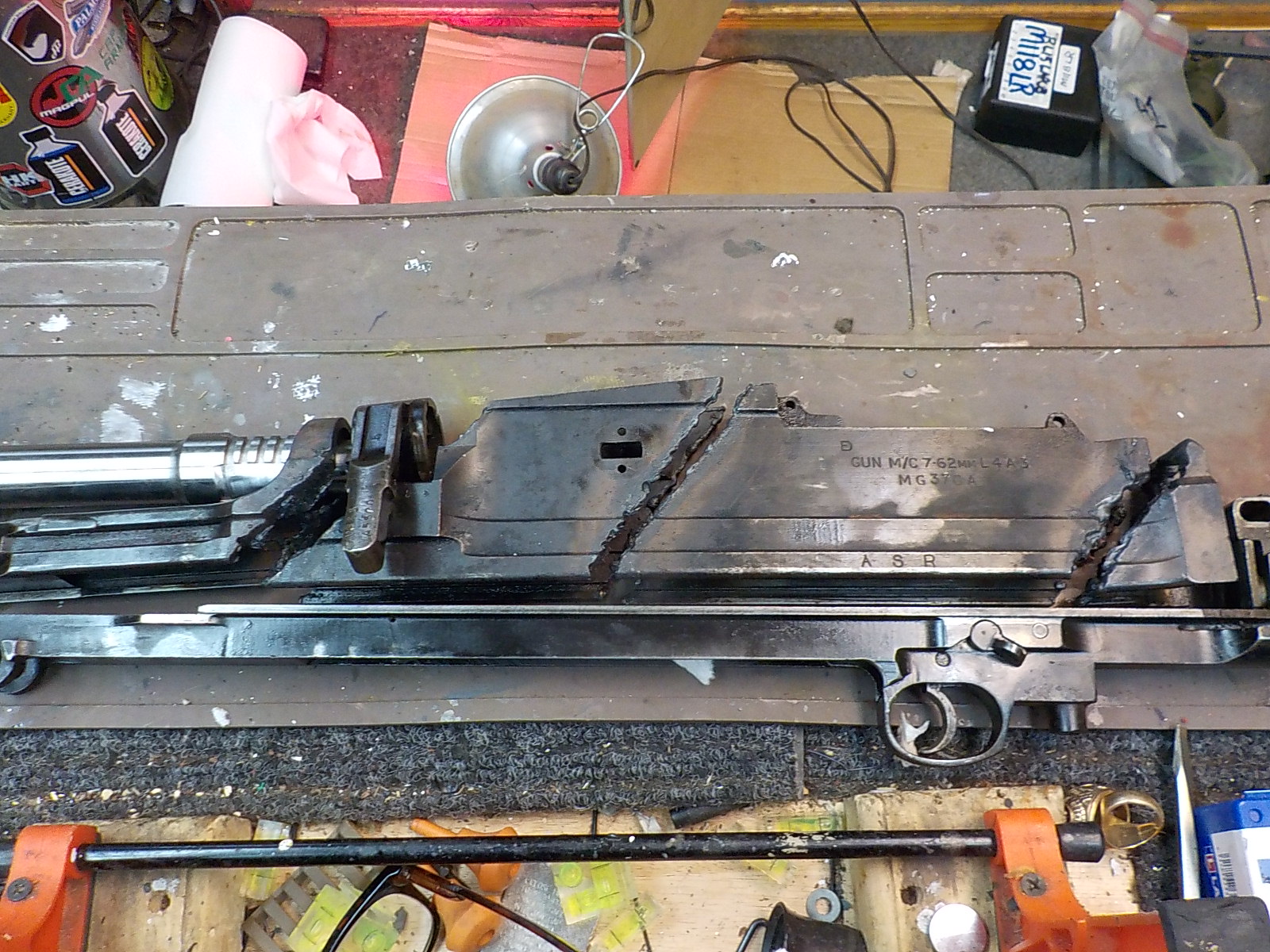

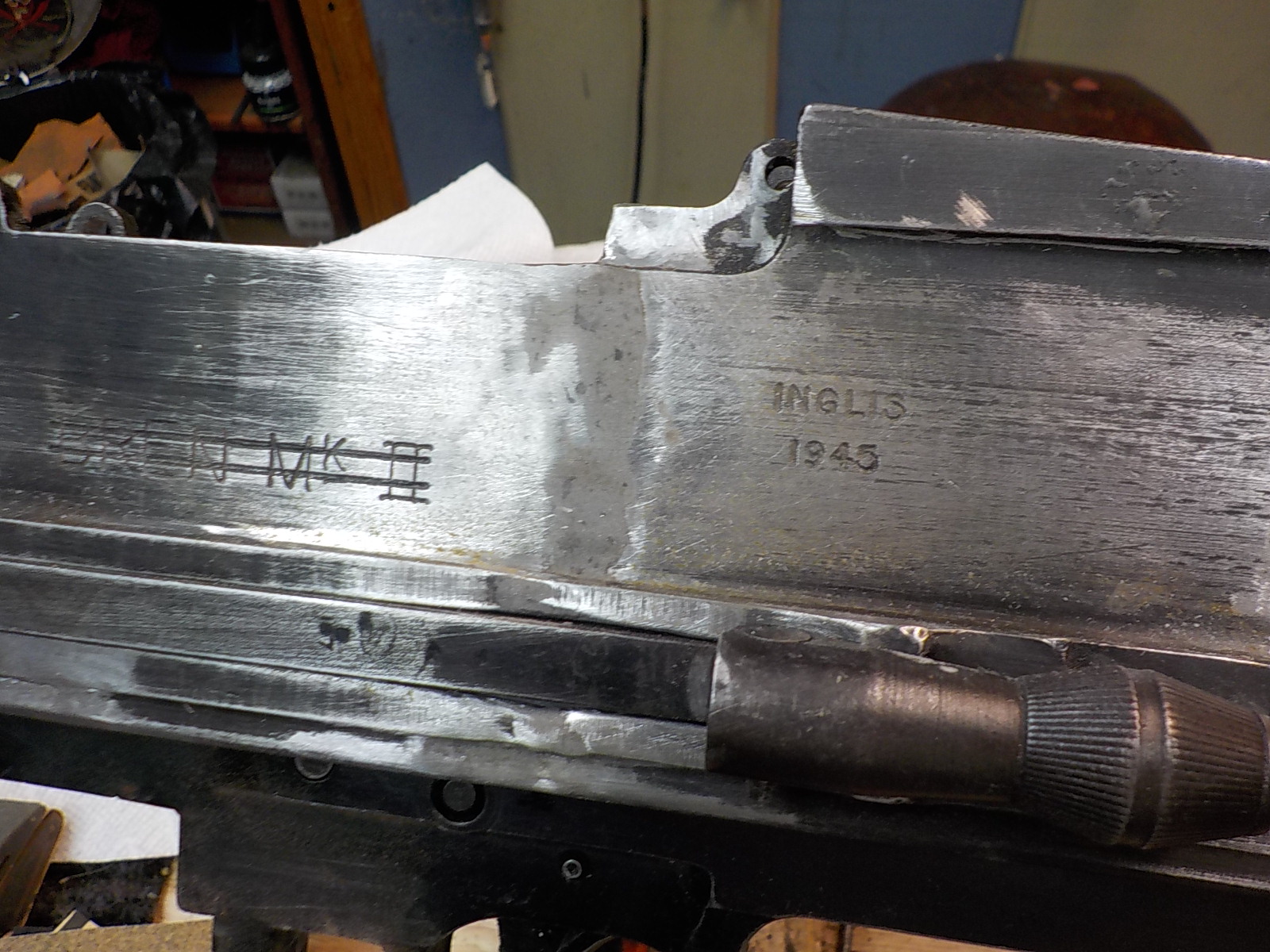

    Well, I have encountered problems at every turn. First, my original receiver was cut right across the bridge, melting away about an inch of the upper receiver. So I had to find a new upper piece...which I did...at not inconsiderable expense. The good news was, the new section was carefully torch cut in non-critical areas. The bad news ... it was a .303 MKII. So, now I am going to a .303 MKII vs, a .308 L4. Now I learned about which parts interchange and which don't. Magazines...nope...good news is .303 mags are $7 each. Mag release and extractor had to be replaced, along with the bolt body. .303 barrels are cheap and abundant and it good condition, so no problem there. I bought a MKII buttstock just so I don't have a horrible Brenkenstein MKII/L4. I have mocked up the gun using the old stock as a proof of concept, because...the telescoping recoil and striker assembly became a no go. I couldn't source the right size tubing, plus I became a little concerned of the striker binding or not having enough force due to the spring sitting at the base of the striker and the firing pin at the top of the striker. I decided to put in a separate spring for the striker that sits above the recoil spring. Not very much room there and the stock sits at an angle to the receiver. I had to have the spring move at angle. I solved this by making the striker with a floating guide rod, much like the FAL bolt has a floating recoil spring. So after a lot of milling, drilling, cutting, filing, sanding etc. I had something that I could half way mock up. With the receiver still in three pieces I slid it all together on the frame rails. I put a piece of .308 primed brass in the bolt face, pushed all the pieces together and held the cartridge against the bolt face with a dowel...pulled the trigger...and POP! Striker worked fine. Now to weld the two final sections together.
    Striker with floating guide rod
    Mocked up
    Striker and bolt. Striker spring on top, recoil guide rod running through a hole in the striker on the bottom.

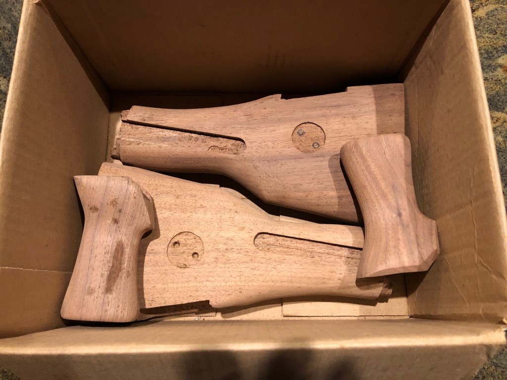

    Probably had a dozen or so Bren parts sets back when they were cheap/plentiful but sold them off thinking I was making a killing at $300-400 a pop. Like everything else, wish now I'd kept a couple. Ran across some new production (as in 20yrs ago new) walnut stocks/grips if anyone can use them. Don't remember any history. Just cover the cost of the ride.

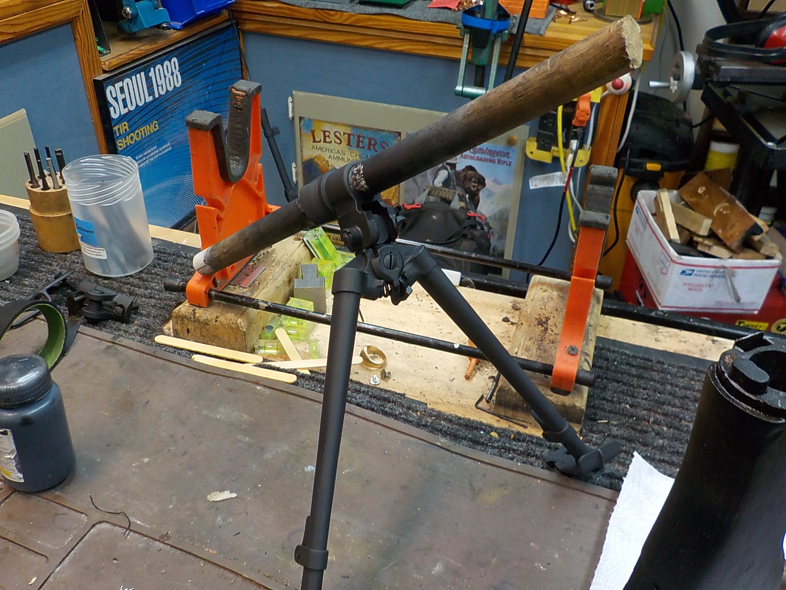

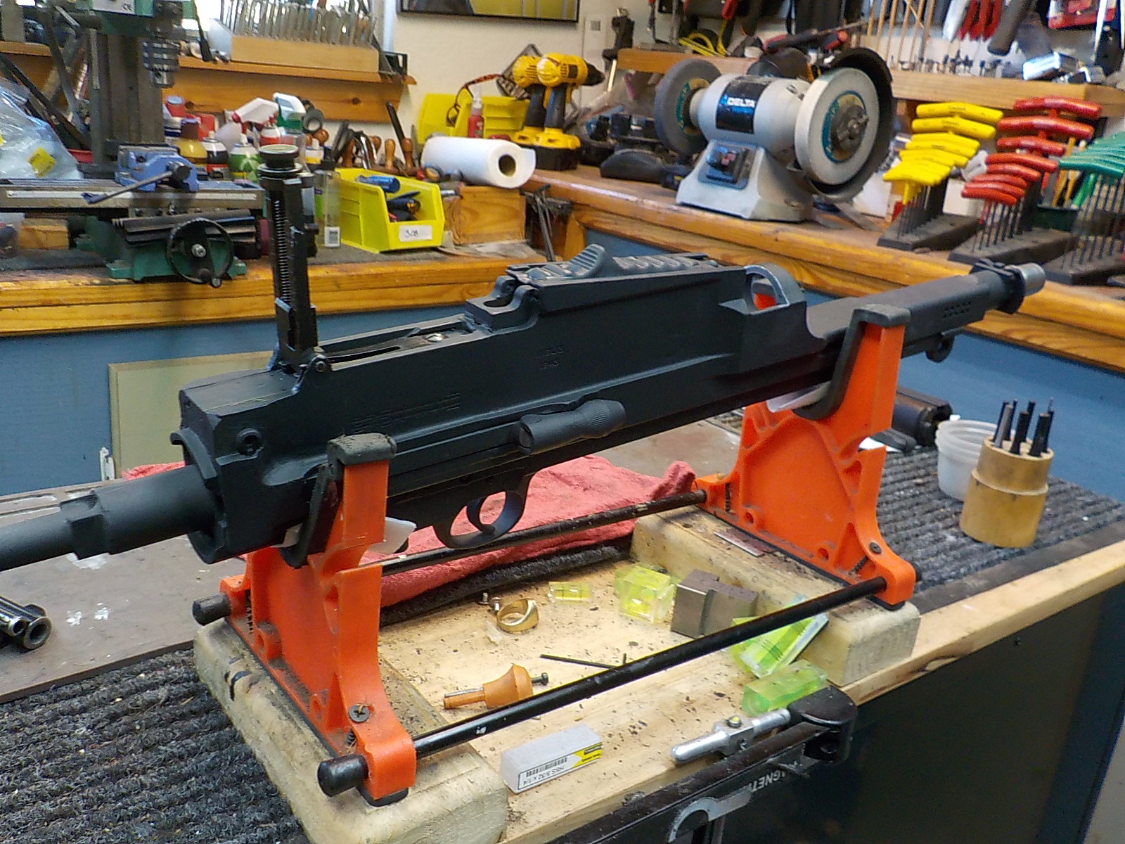

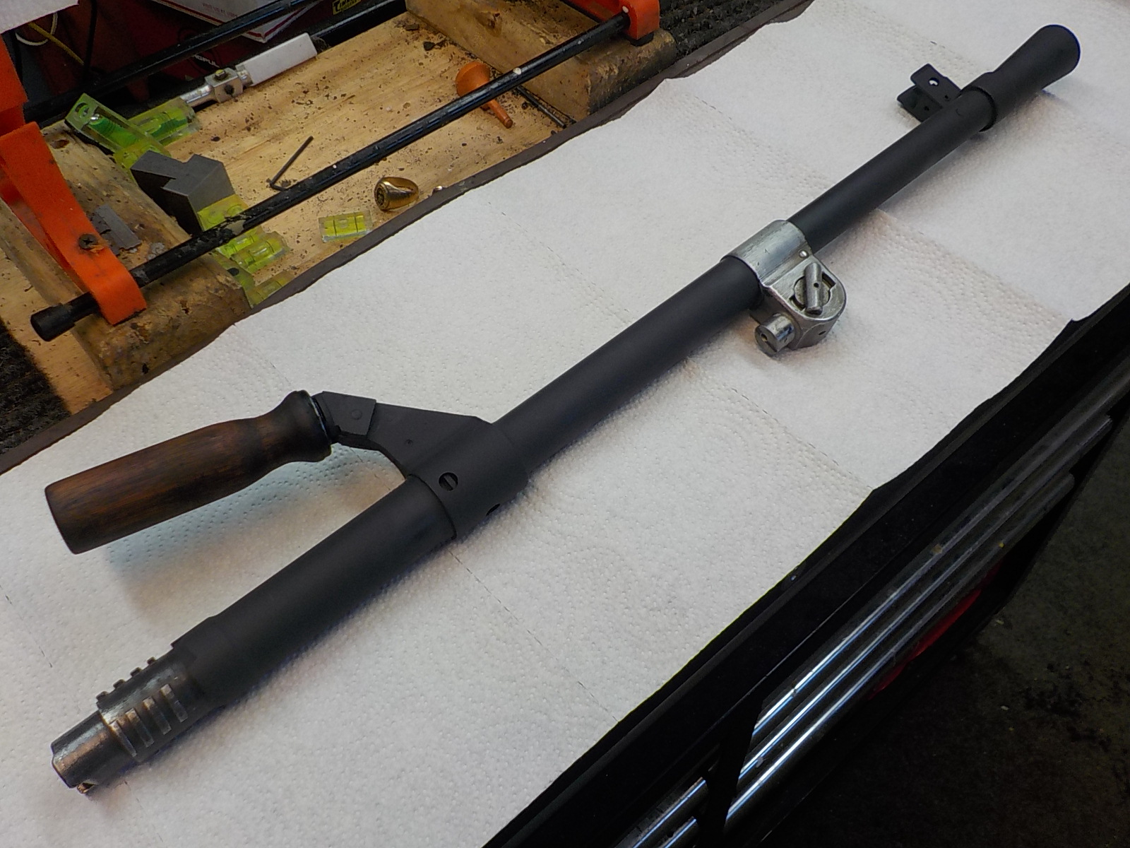

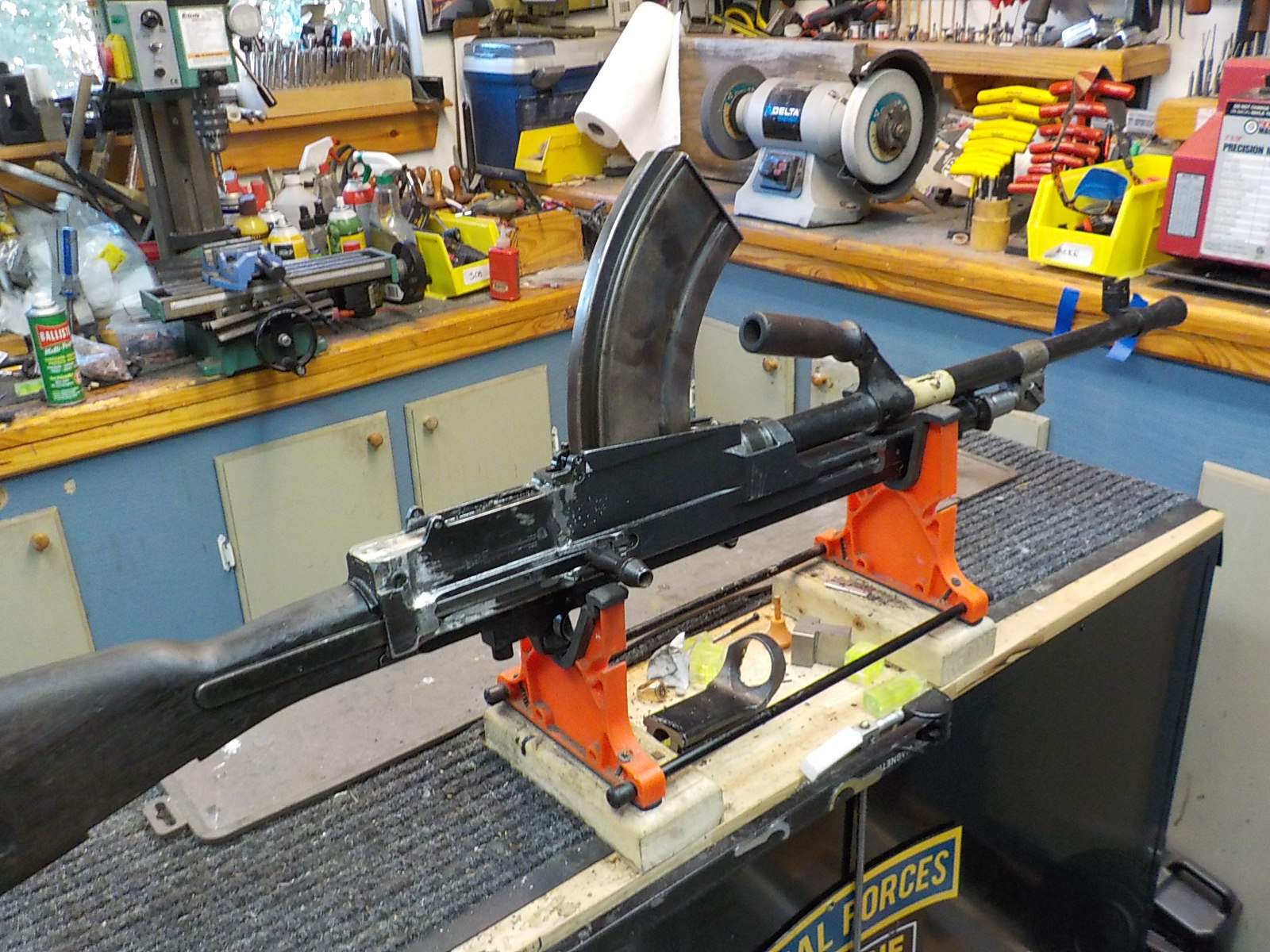

    Waiting on bolt and magazine/ejector latch. Refinishing the wood and Cerakoting barrel, bipod, butt plate, and small small parts in a mix of graphite Black and Stainless. The receiver and frame will be a lighter mixture of Gray/Black Cerakote.

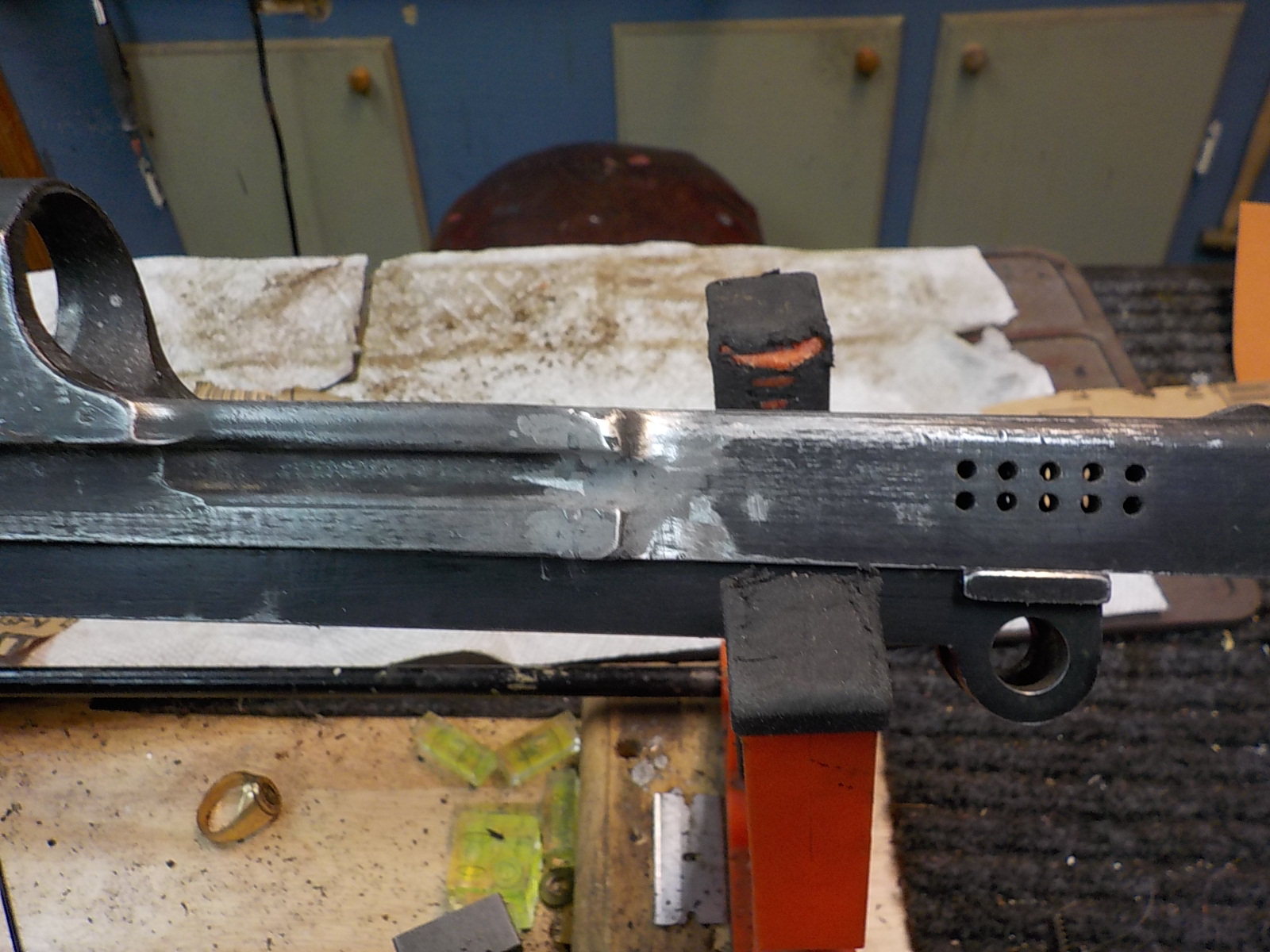

    Cleaning up the receiver welds and prepping for Cerakote. Also working on picking up ancillary items like a Transit Chest (actually found one, right after I bought an SMLE Chest to convert), Magazine Chest with 12 mags, mag pouches, spare barrel, and other stuff.
    Cleaning up receiver welds
    Oil finish for wood

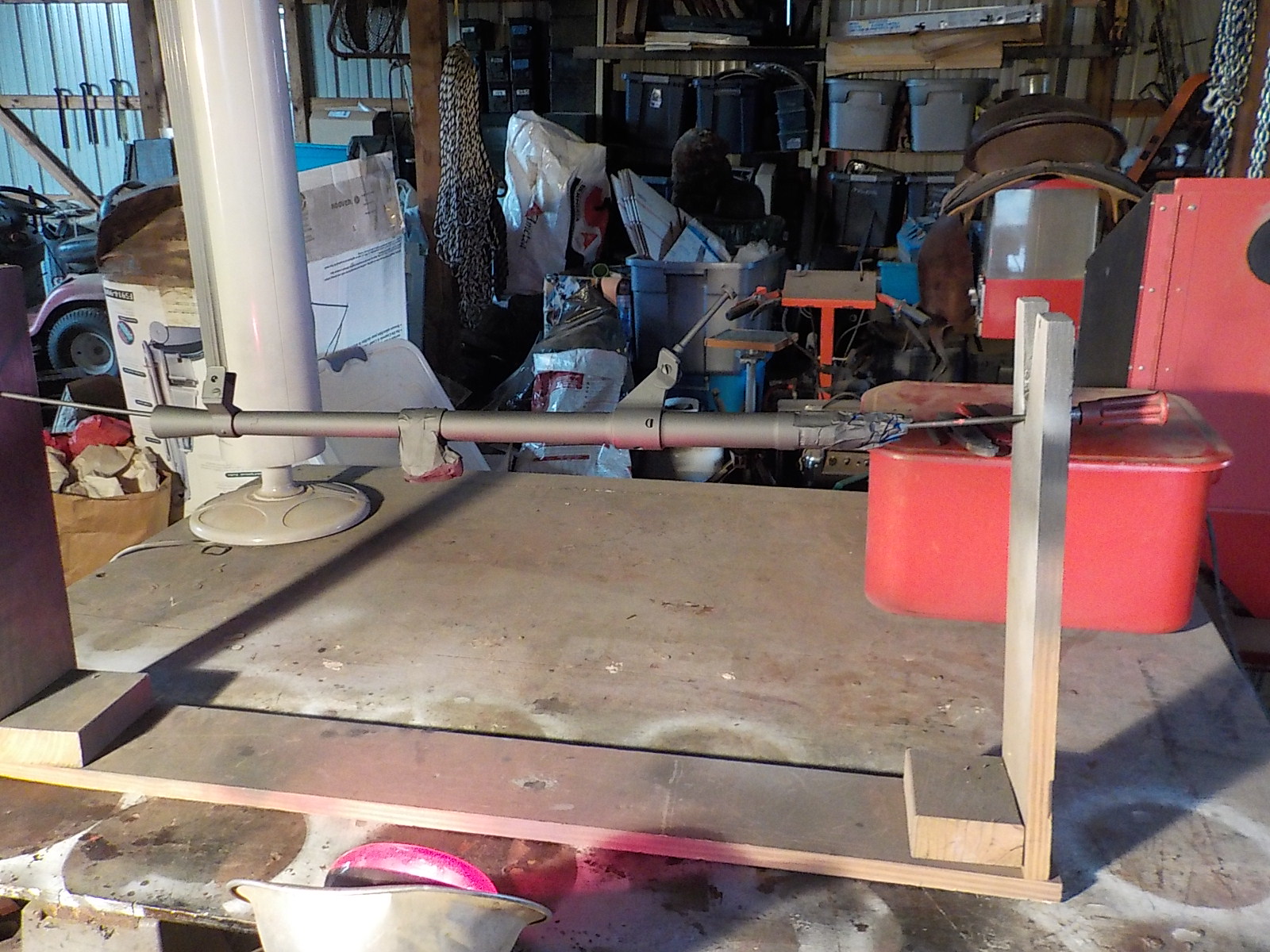

    Cerakoting barrel
    Bipod

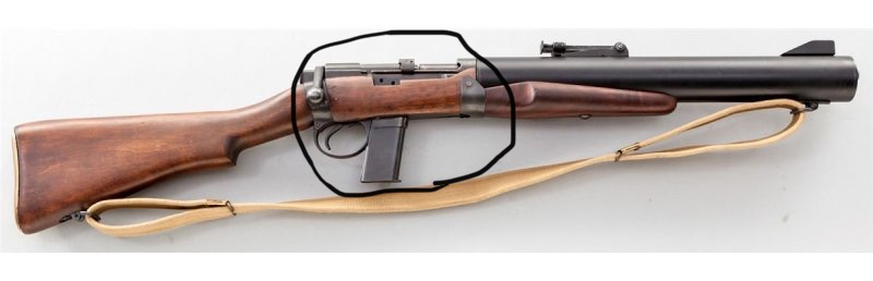

    I am looking for two SMLE forends... just the section from the stock band forward to where the barrel screws in. About 8" under the action. Building a couple of DeLisle carbines.
    Having real trouble finding stocks here that aren't butchered or sporterized. Or, apparently, made of solid gold.
    You can see the circled section is what I need. SMLE. x2. The front can be cut off, so two would fit in a small box.
    If used SMLE stocks are easy to come by over there... It's a need for sure!

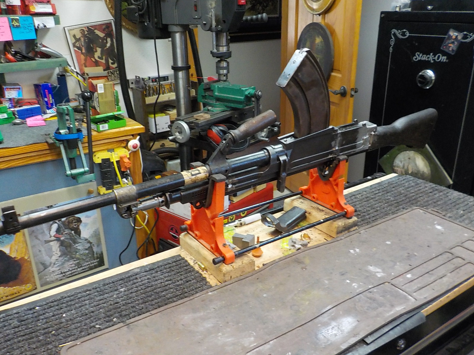

    Completed barrel

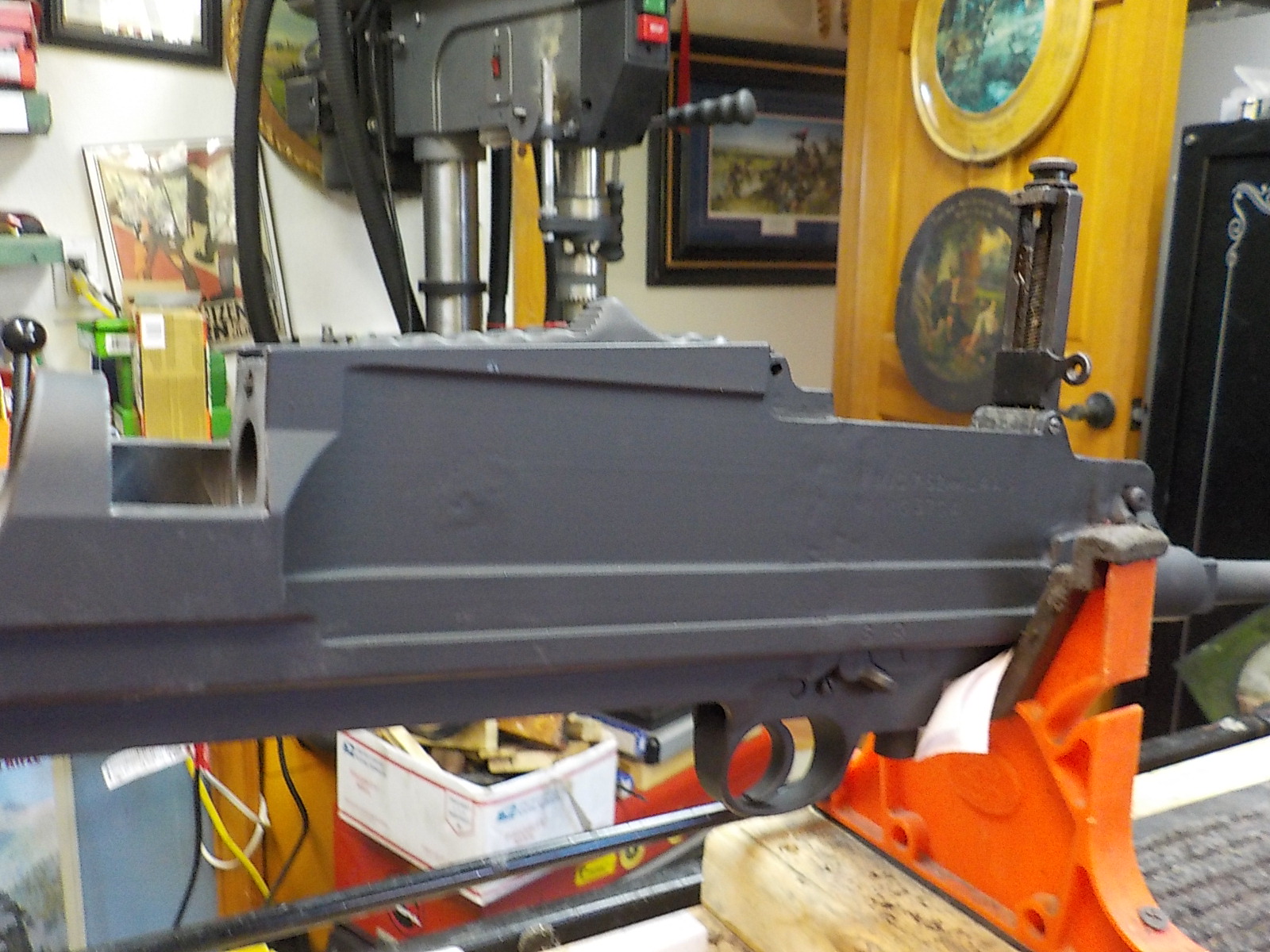

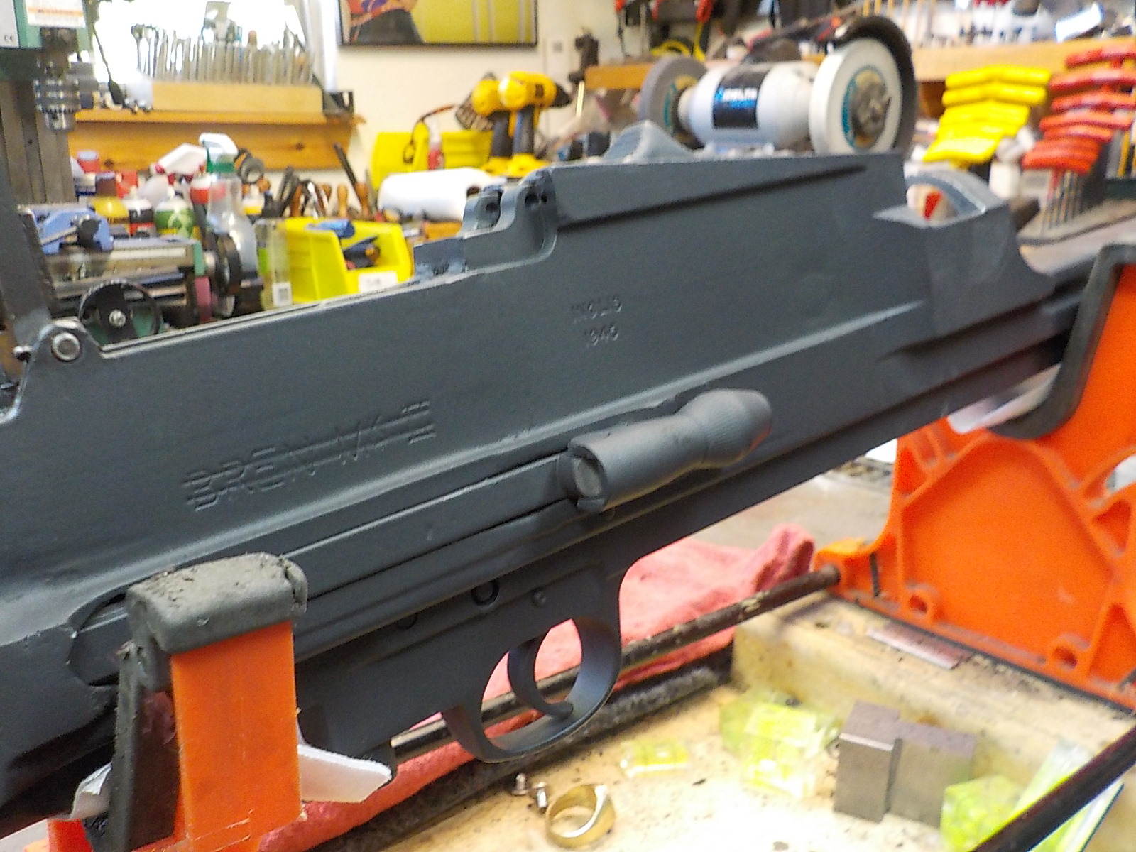

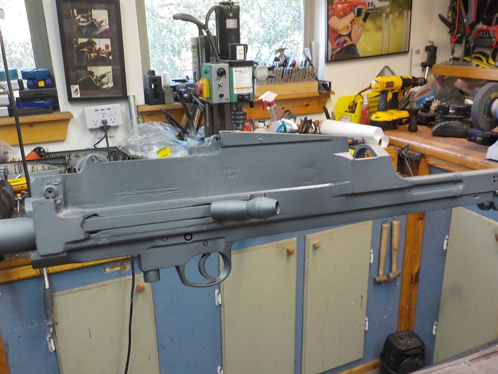

    Cerakoted receiver. The Cerakote really showed up some flaws. I'll have to do some more sanding/filing and spay it again. Not liking the color, think I'll just stick to graphite black with a little stainless.

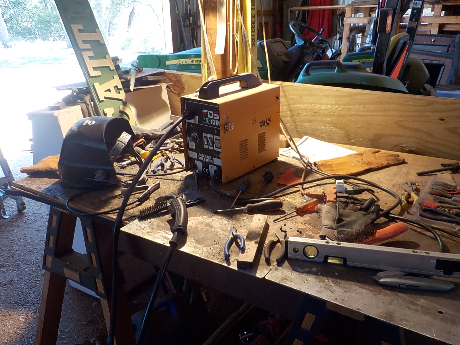

    My state of the art welding station and equipment.
