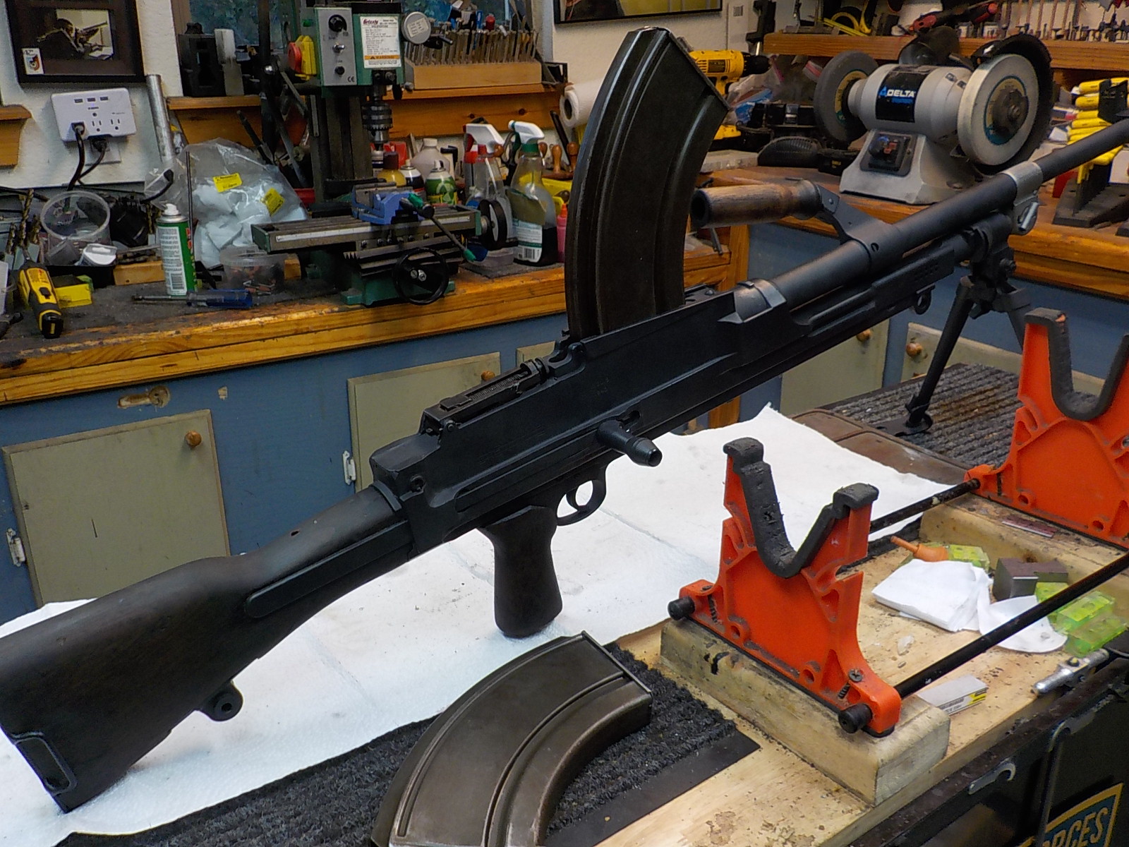

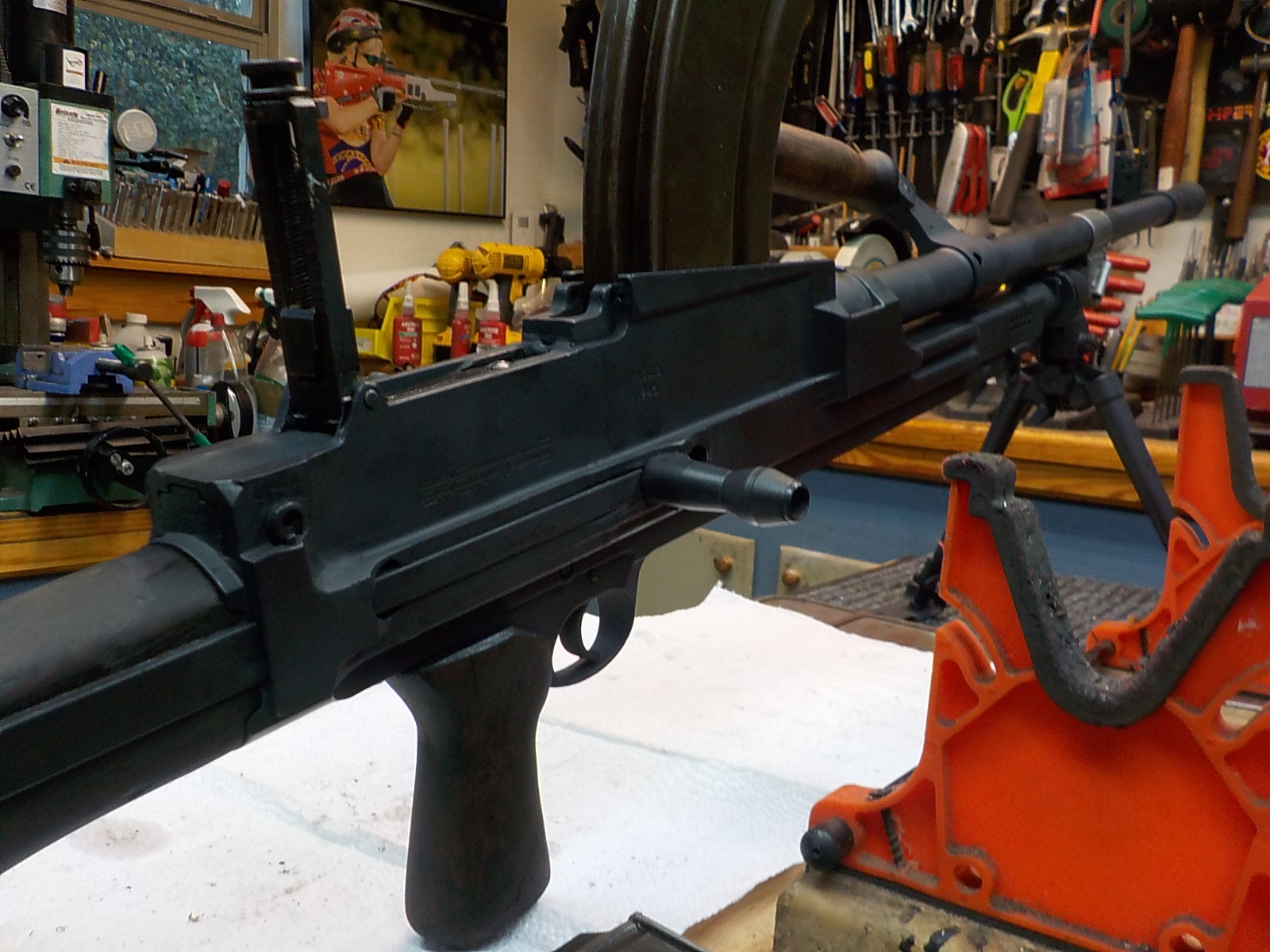

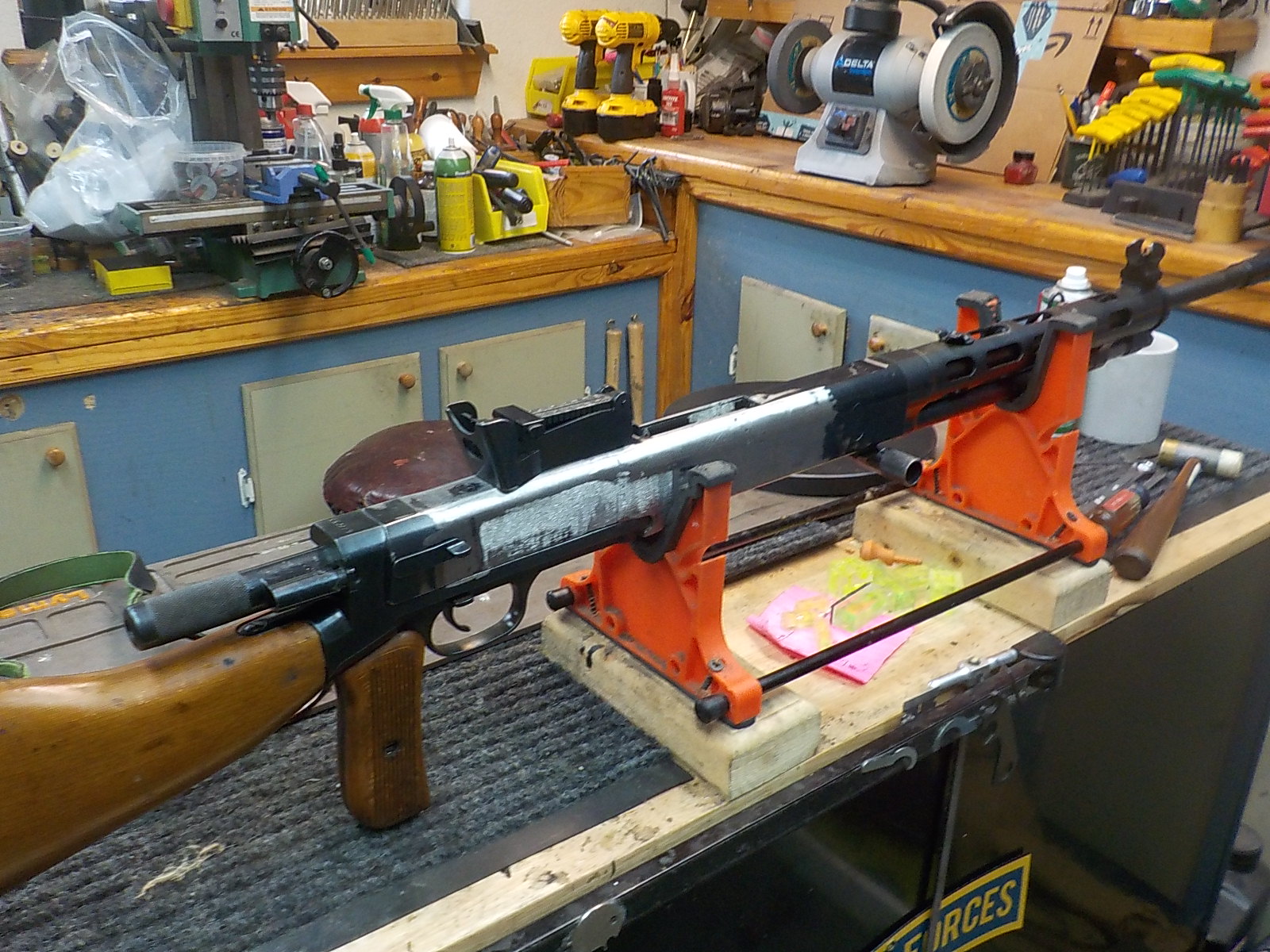

After two hours, Cerakote is hard enough for assembly...so I assembled. Function test went well. Chambered and fired a piece of primed brass. No mag catch yet so I held the mag in by hand and cycled...no problem. Tomorrow she gets tied to the lead sled and fired by lanyard.

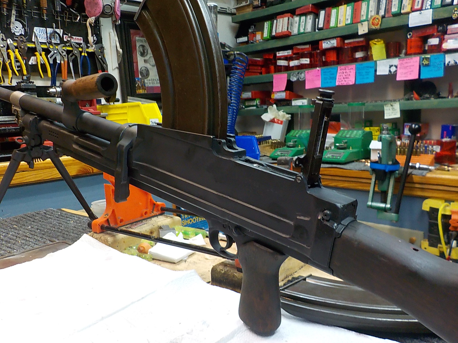

Before:
After:
Sarco just told me they shipped my mag latch/extractor...and I thought it might arrive today. So, anywhere from 4 to 10 days to receipt. Well, I can't wait that long so I just single loaded a bunch of rounds. .303, 40g N140 with 175 .311 SMK, Federal Lg rifle match primer. This is the ammo I use for my SMLE sniper. Very pleased with the results. First, the gun functioned great and the welds look good to go. Second, this a WWII surplus machine gun barrel. Third, the MG sights are huge. The rear aperture is as big as a pencil in diameter. The entire front sight fits in the sight picture. Excellent for MG use, terrible for sniping. So, sight alignment and sight picture are key, emphasis on sight alignment. I held the bottom of the aperture flush with the base of the front sight and a 6 o'clock hold with front post. These are the first shots fired at a target at 100yds...no sight correction. Amazing gunsmithing or just a fluke the gun was right on...smart money says fluke. To get an idea of the guns accuracy potential I would take the eight closest shots and say that is a typical group, throwing out the other eight as outliers due to my poor sight alignment/cataract blurred vision. I'll post a video rockin' a full mag at some steel when I get the mag latch. Gun is very pleasant to shoot, trigger is excellent. I may put a stronger striker spring in to improve on the 1 second "lock time".

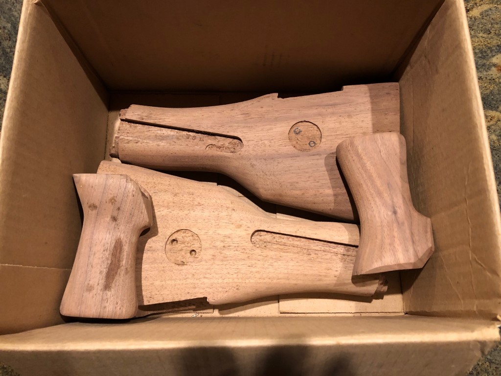

Probably had a dozen or so Bren parts sets back when they were cheap/plentiful but sold them off thinking I was making a killing at $300-400 a pop. Like everything else, wish now I'd kept a couple. Ran across some new production (as in 20yrs ago new) walnut stocks/grips if anyone can use them. Don't remember any history. Just cover the cost of the ride.
I'm currently have a Bren rewelded by M-13 Industries, would love to get a new wood set

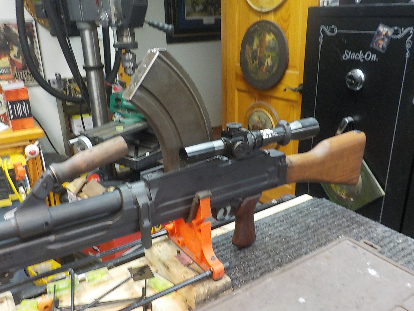

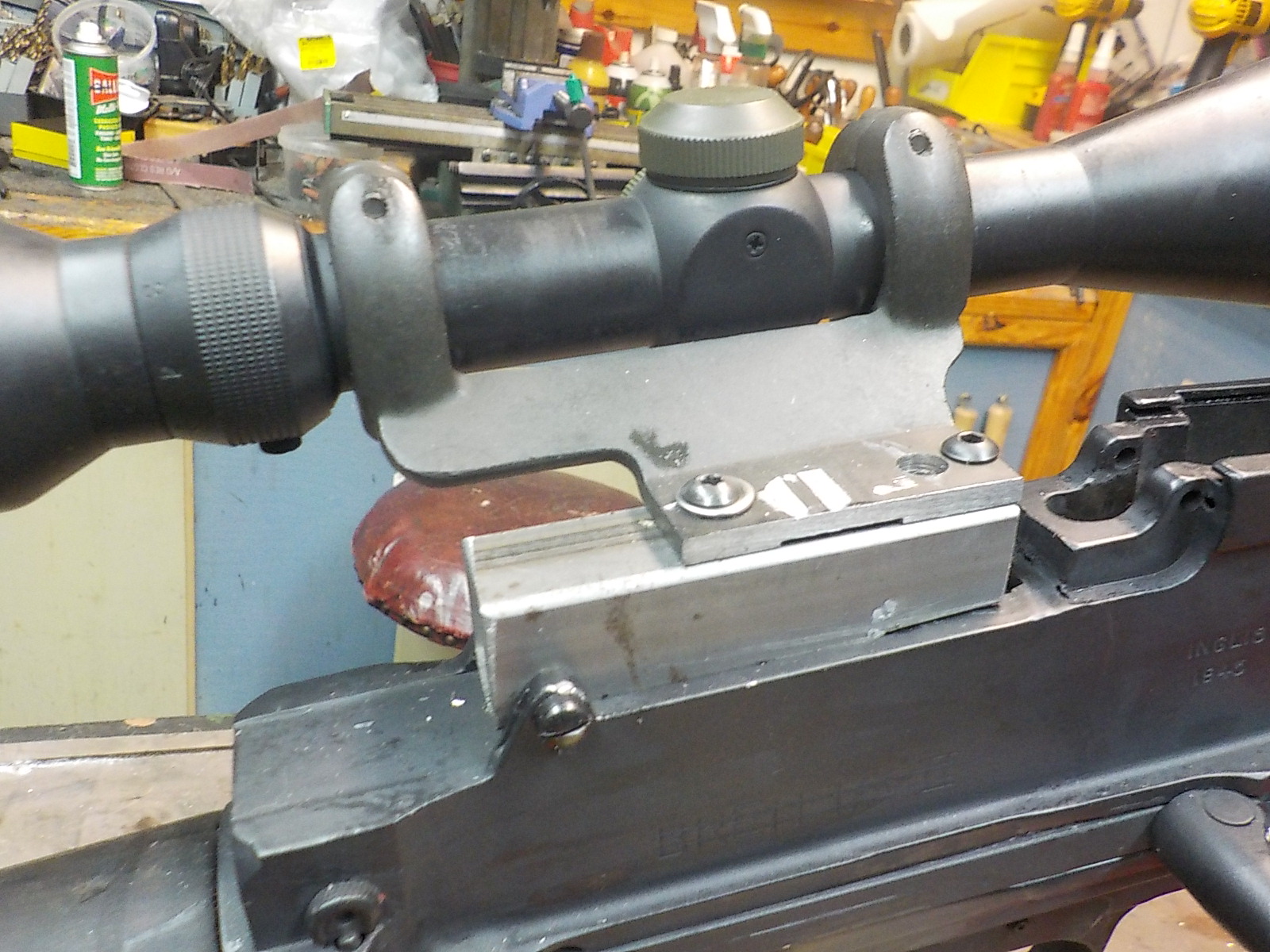

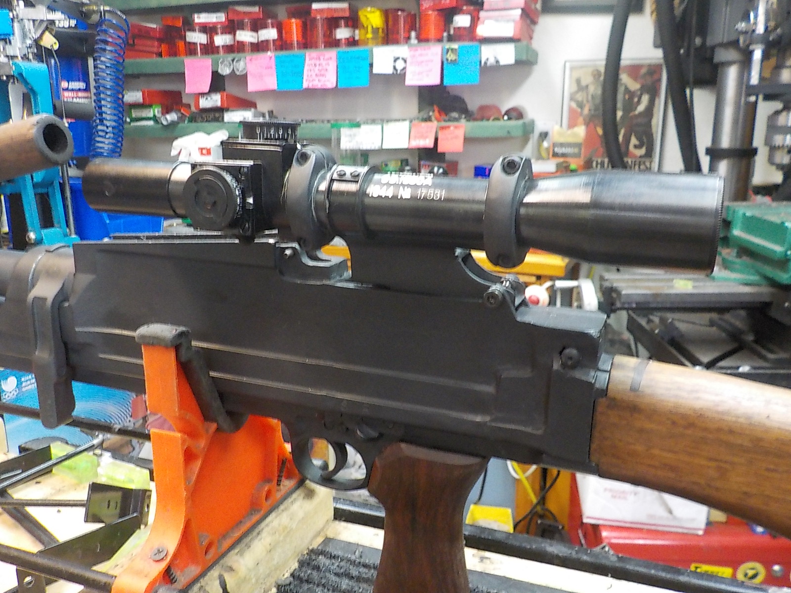

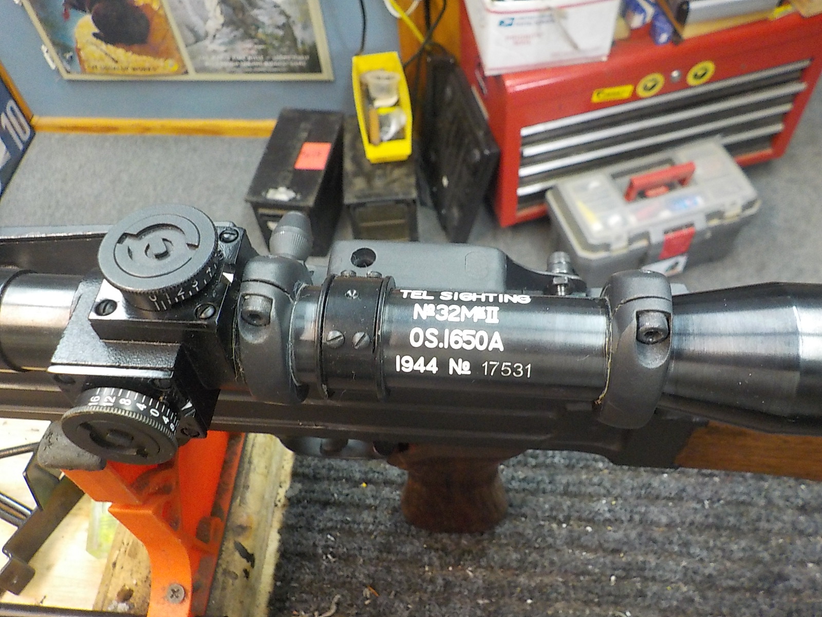

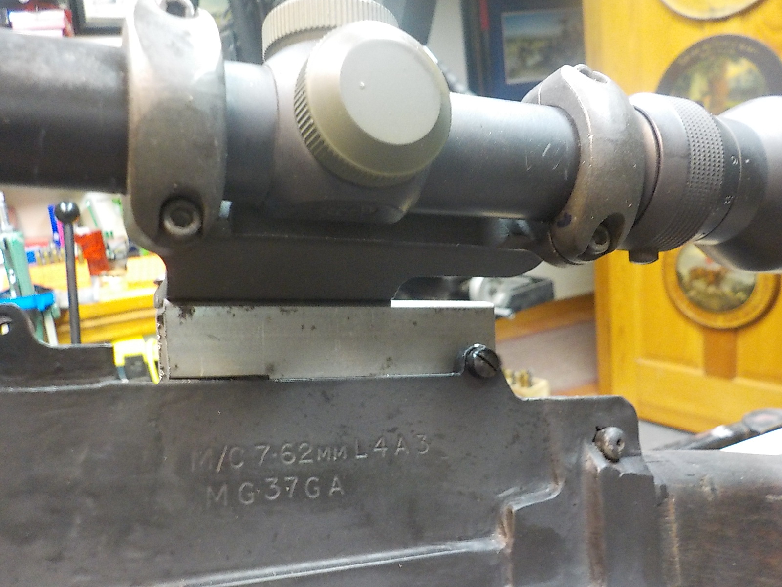

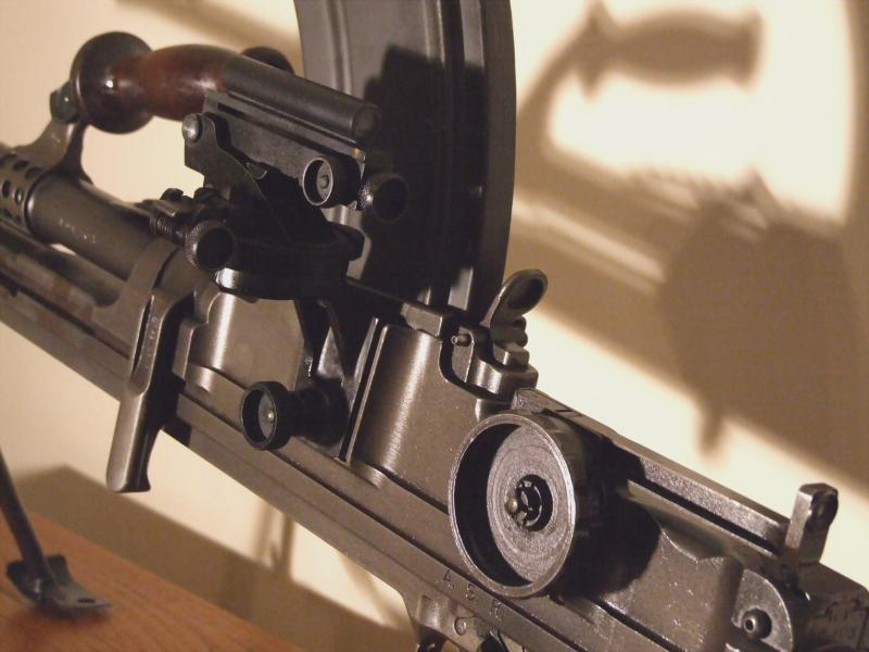

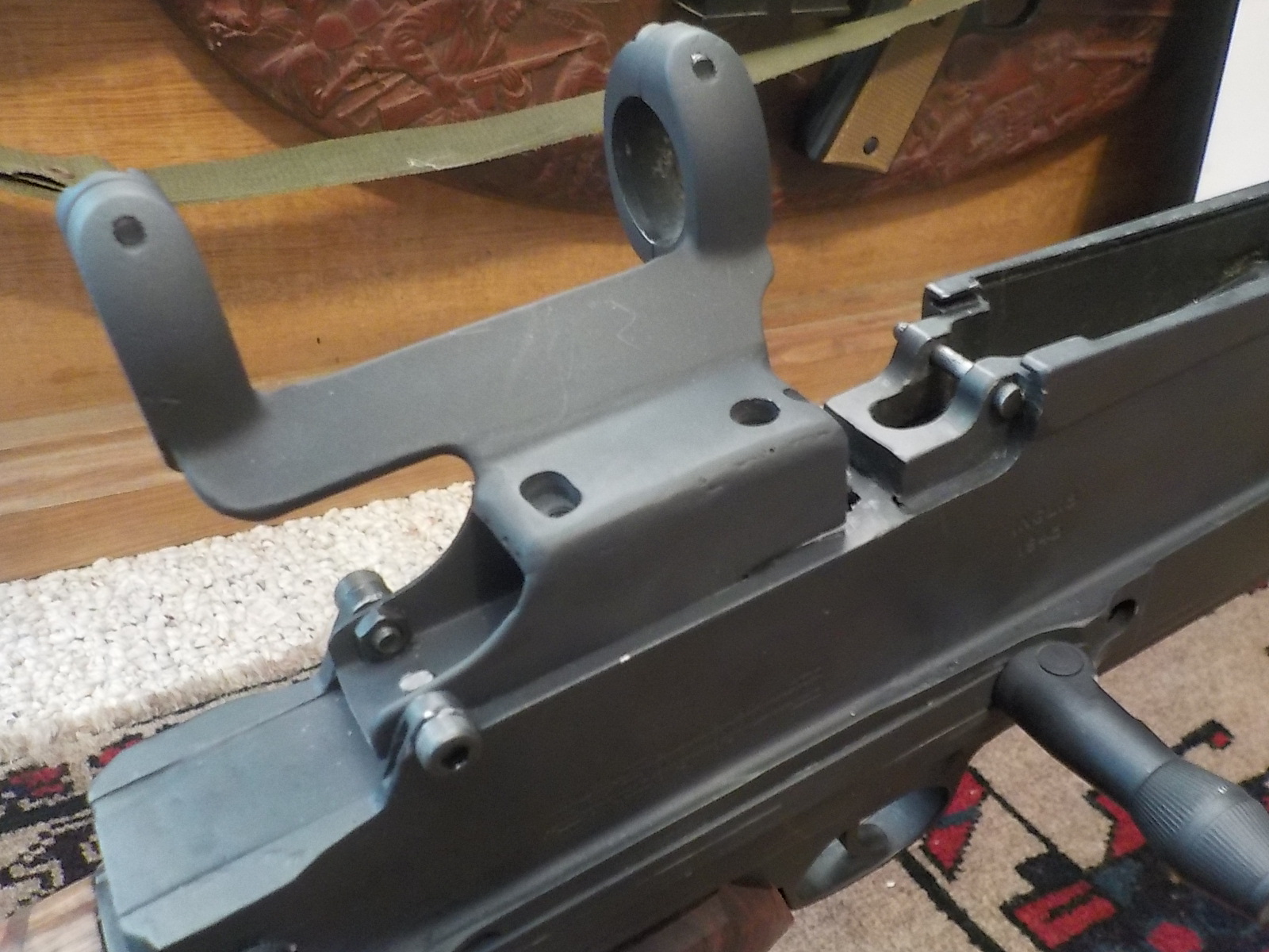

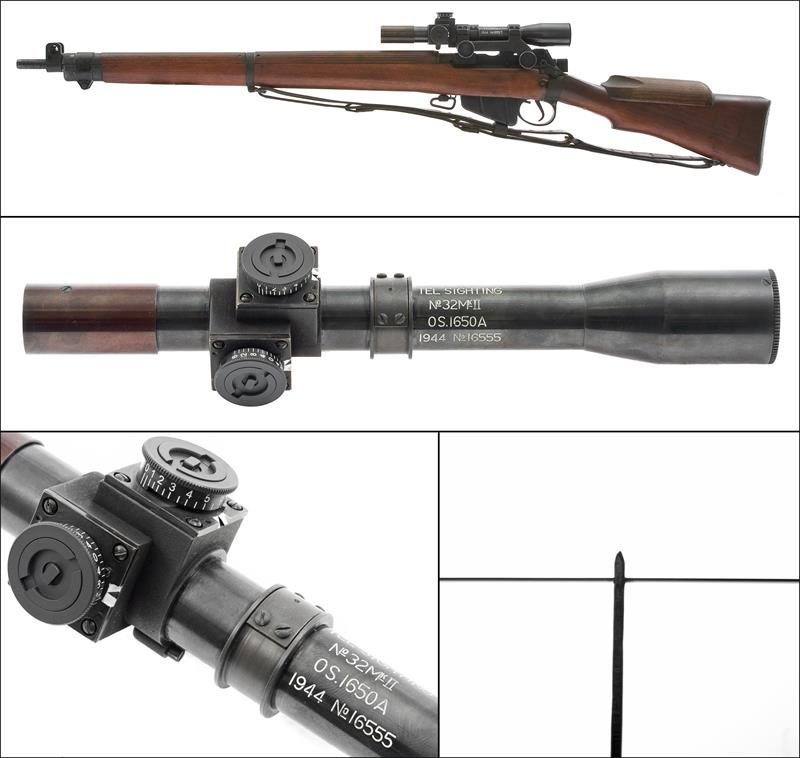

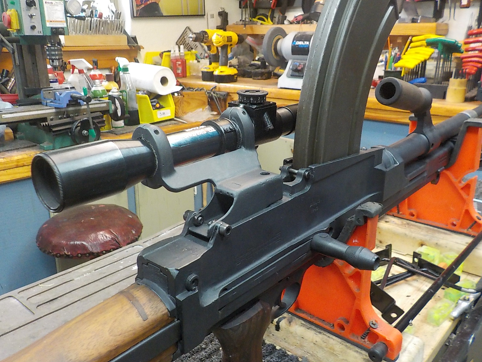

OK, really want to see what this BREN gun will do, so I'm going to make a scope mount for it. I'm going to put an Enfield No. 32 scope on it as used on the Enfield sniper rifle. The no. 32 was originally designed for the Bren. Got a pretty good pic in my mind for the mount, it will require no alteration to the gun. There is a nice recessed slot for the Vernier sight on the Bren. I will use the tapped hole for the sight spring and the cross slot on the rear to secure the mount. A regular pair of scope rings will secure the scope to the mount.
Bren Gun MK I with Plessey line sight

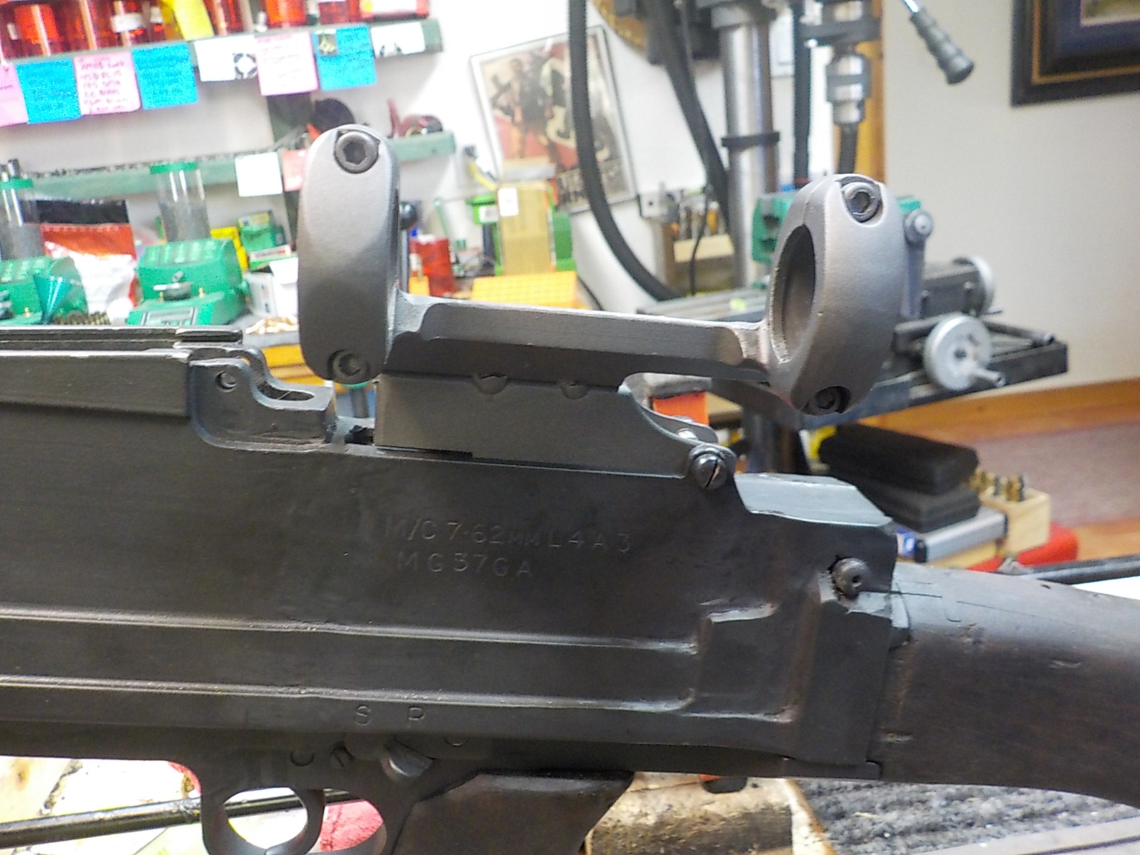

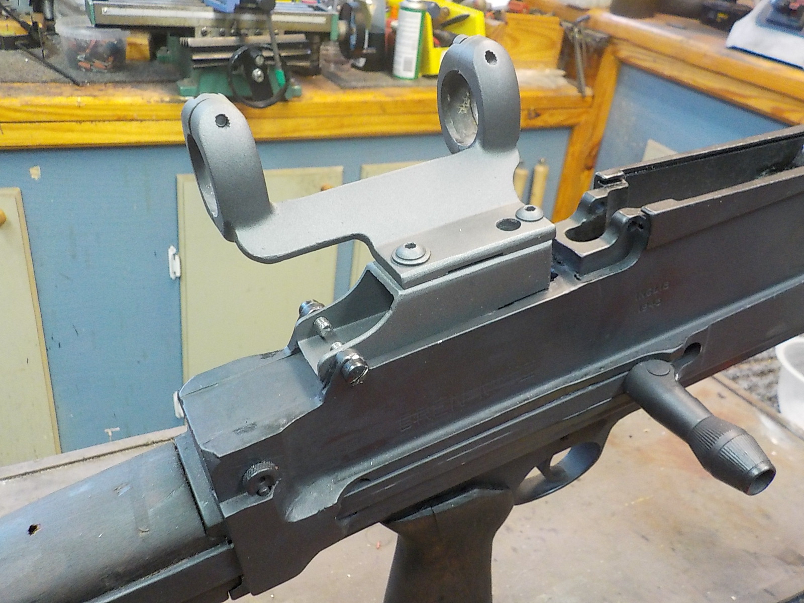

Finished the scope mount. It's windage adjustable. Pretty solid. Just have to finish cosmetic work and Cerakote. Going to cut the unused portion of the square tube in a smooth curve and the round all the edges to blend smoothly where they meet. Should be pretty cool with the No. 32 scope.

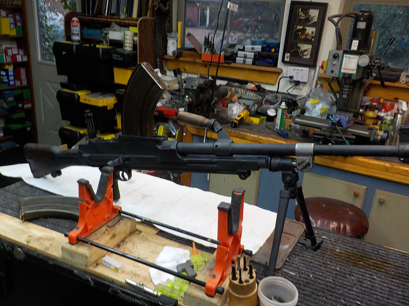

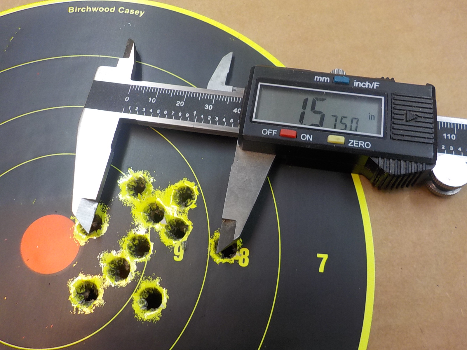

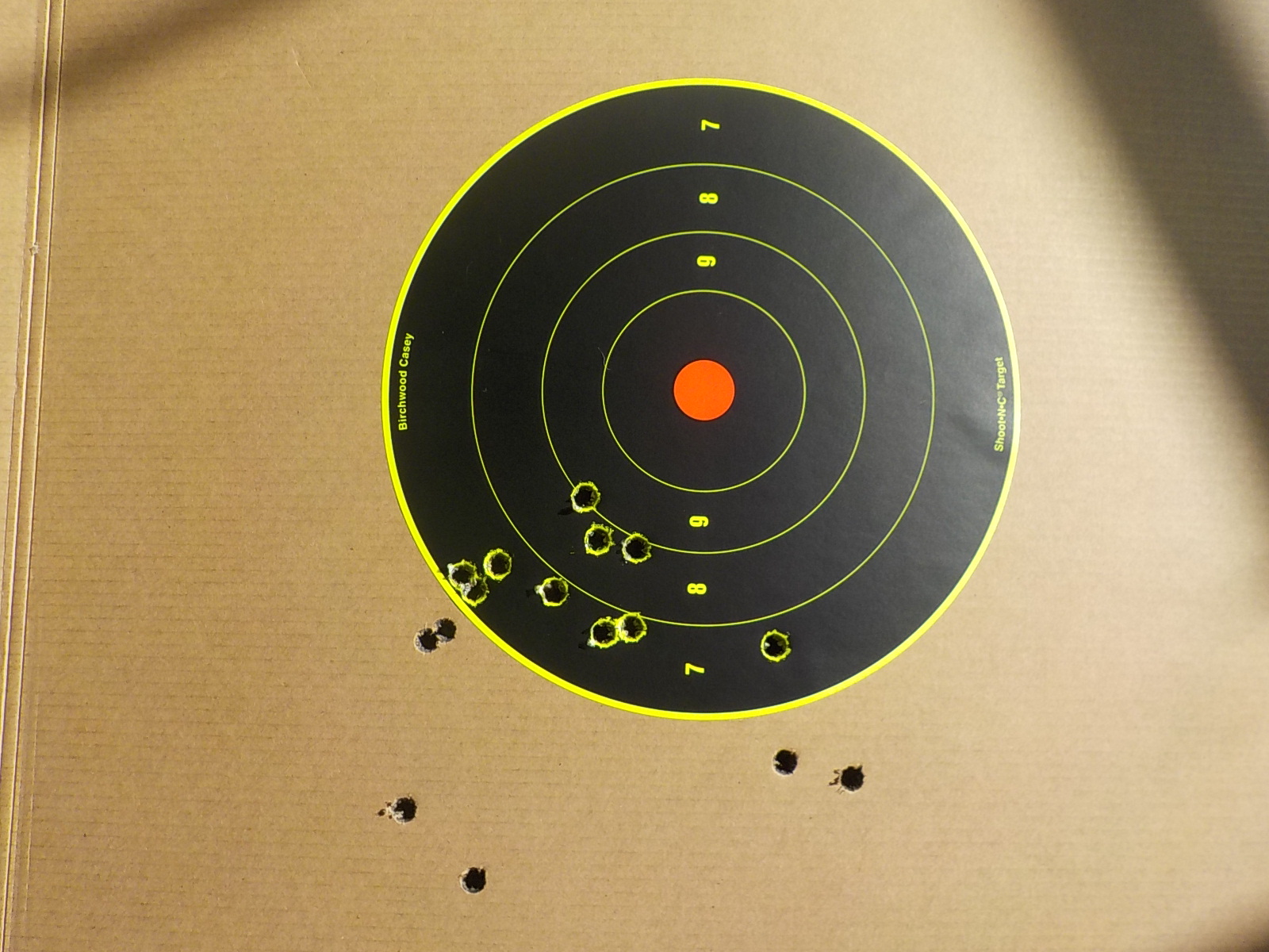

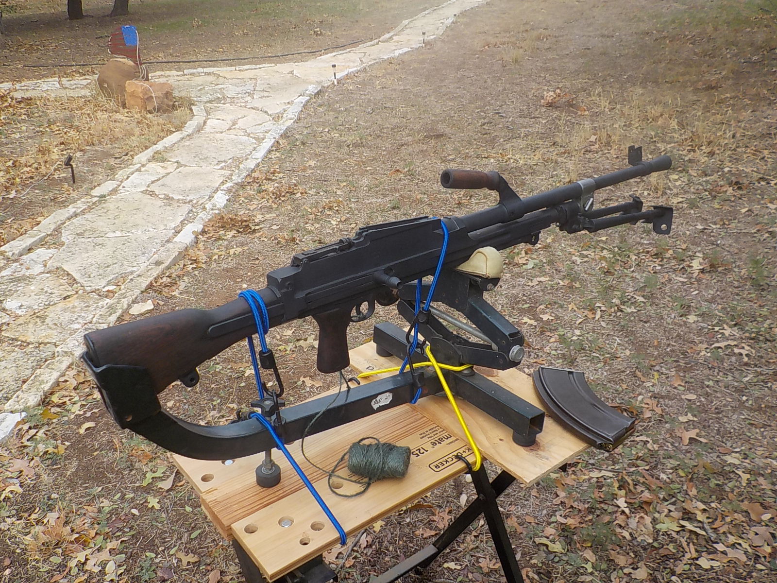

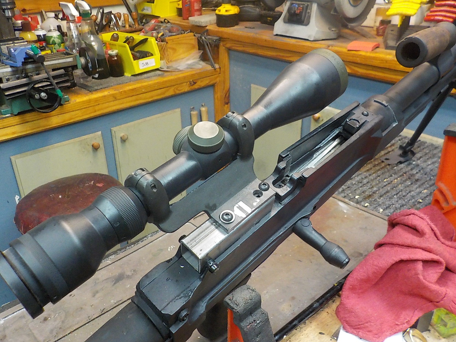

I put my trusty Nikon beater test scope on and went out to see what kind of group I could get. Only shot one 10 shot test group as I had to manually load because I am still waiting on my mag catch/ejector. Took the gas block out so it wouldn't cycle and ram the brass back into the chamber. Not too shabby. Right about 1.5 MOA. Surplus WWII barrel. Keep in mind, the US Army requirement for the M110 SASS is 1.3 MOA.

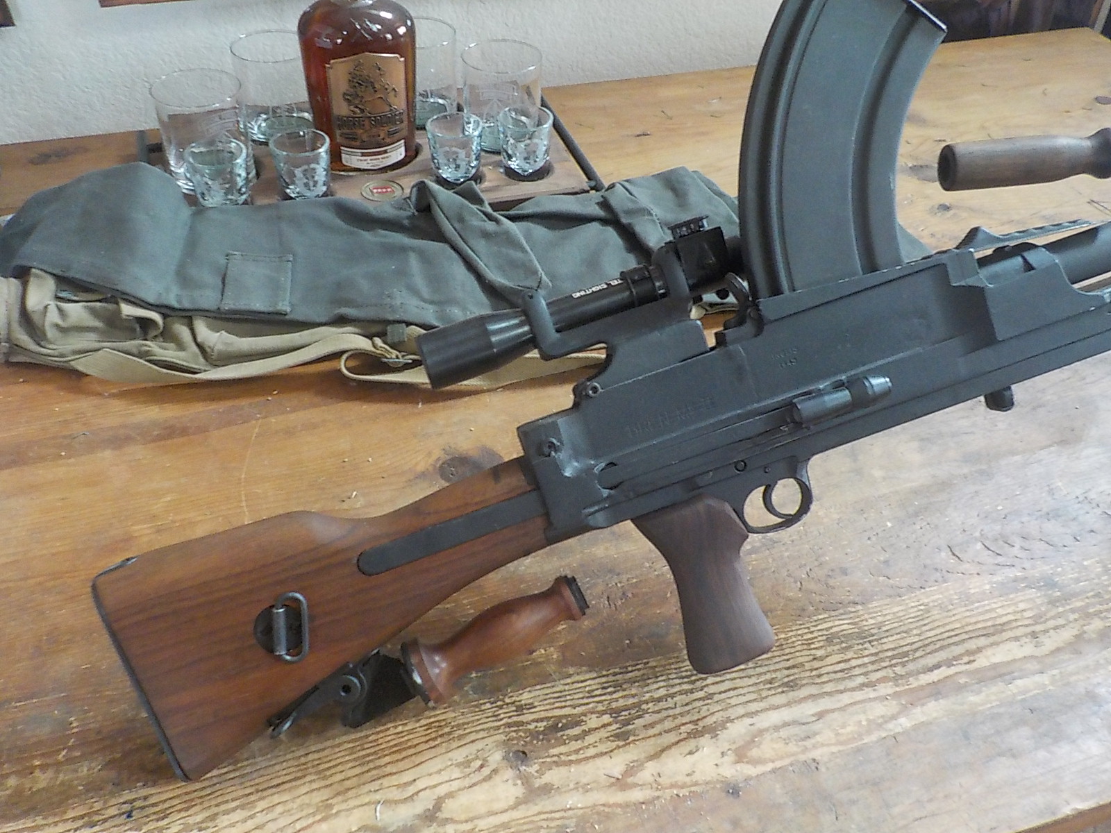

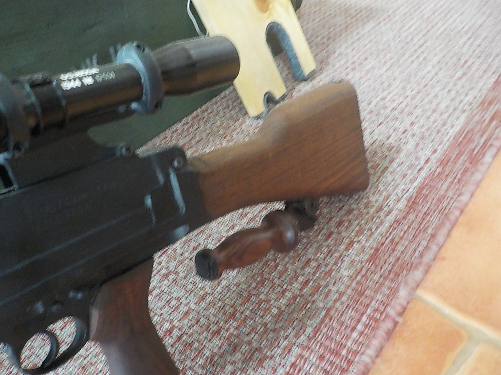

Installed a nice condition MKII stock and a new pistol grip from Waorani. Now I'm going to weld up the joints on the scope mount and give it its' final finish. Bren Gun chest arrived and I need to do some clean-up on that. Got an extra barrel, gas block, barrel case, parts wallet, screw driver, part box, oiler etc. If anyone needs a brand new stainless .308 Bren barrel with gas block and L4 flash hider let me know and I'll cut you a good deal.
Scope mount finished

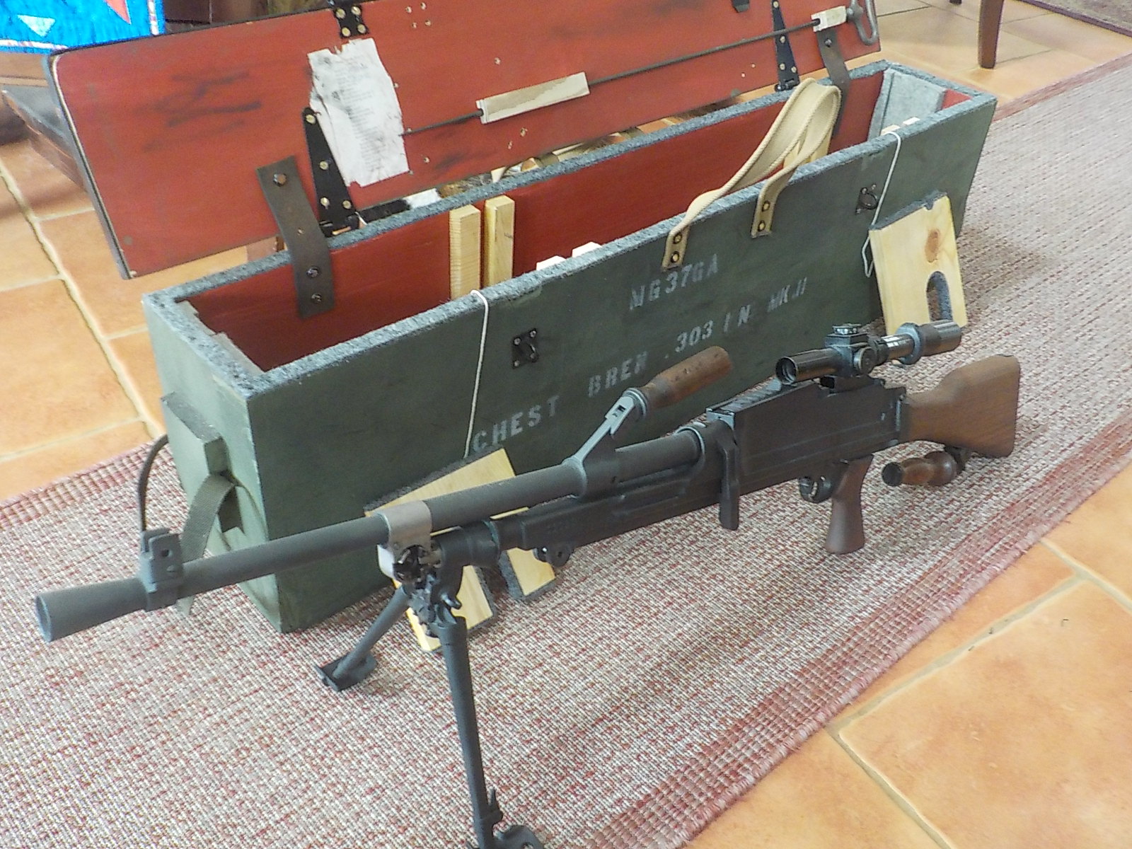

MkII stock, waiting on original butt handle. Also, for the hell of it, I bought a fore-end grip that attaches to the tripod lugs so you can shoot the gun standing. Evidently, a real thing, currently being used in the Sudan.

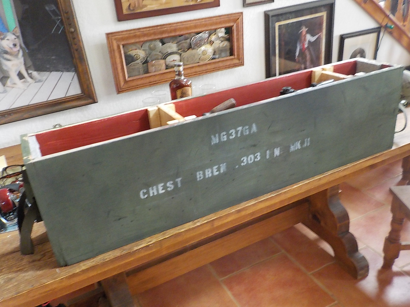

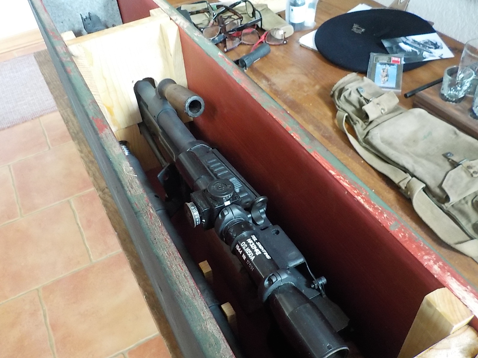

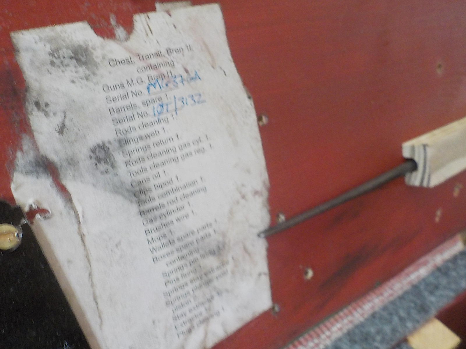

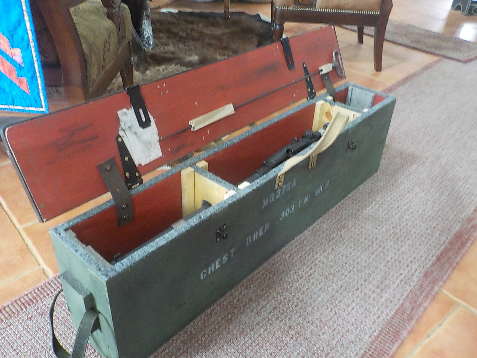

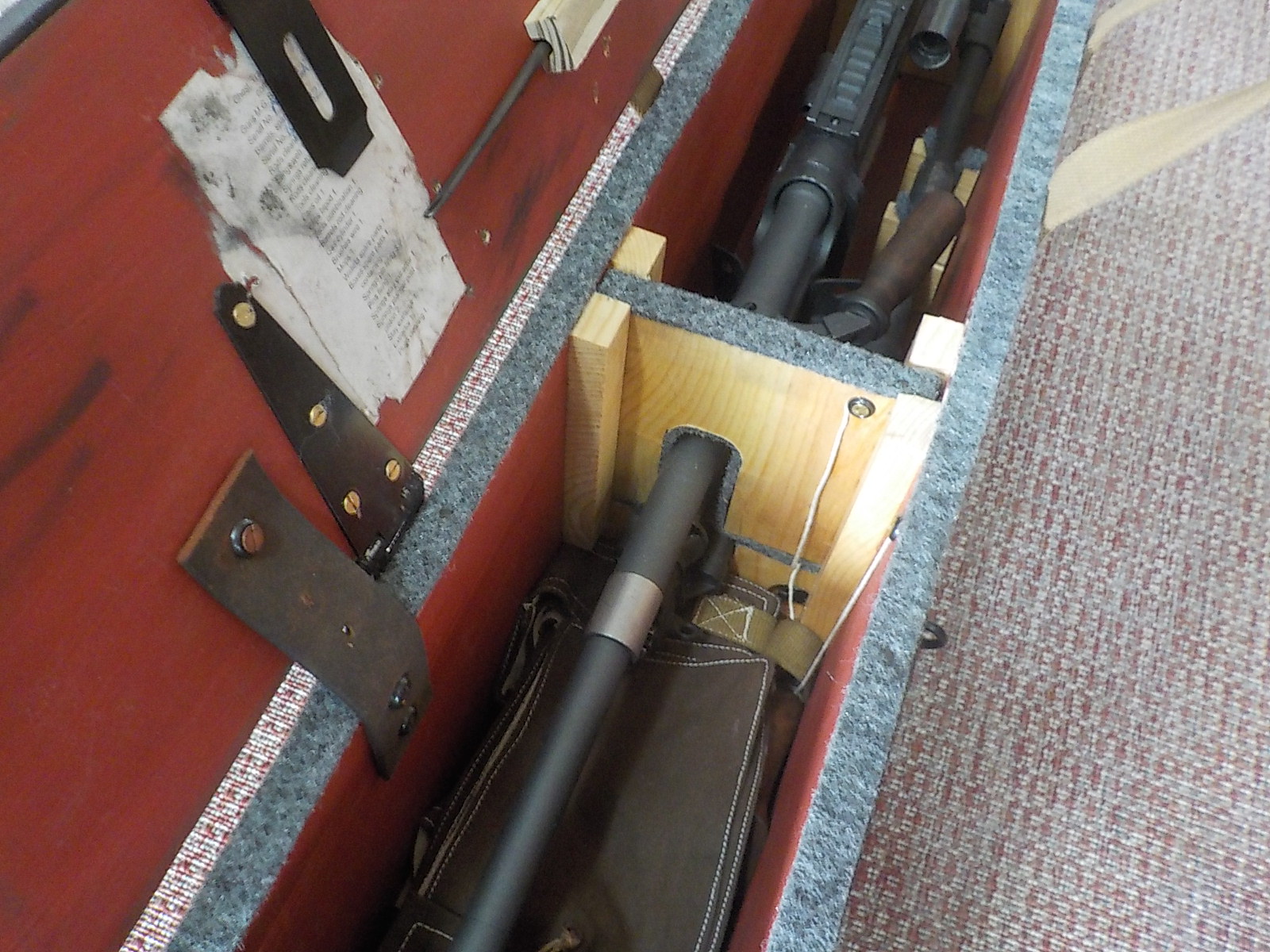

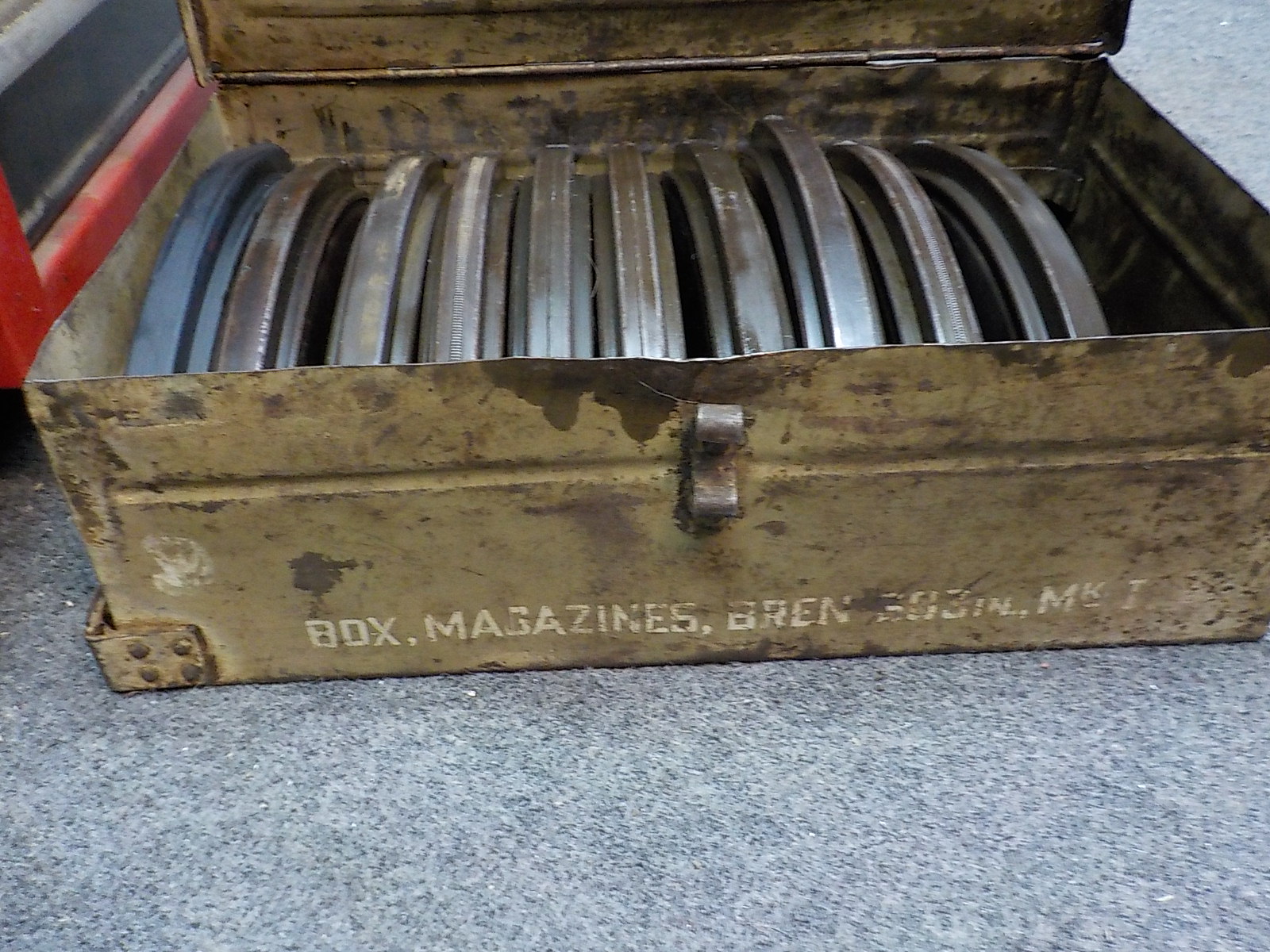

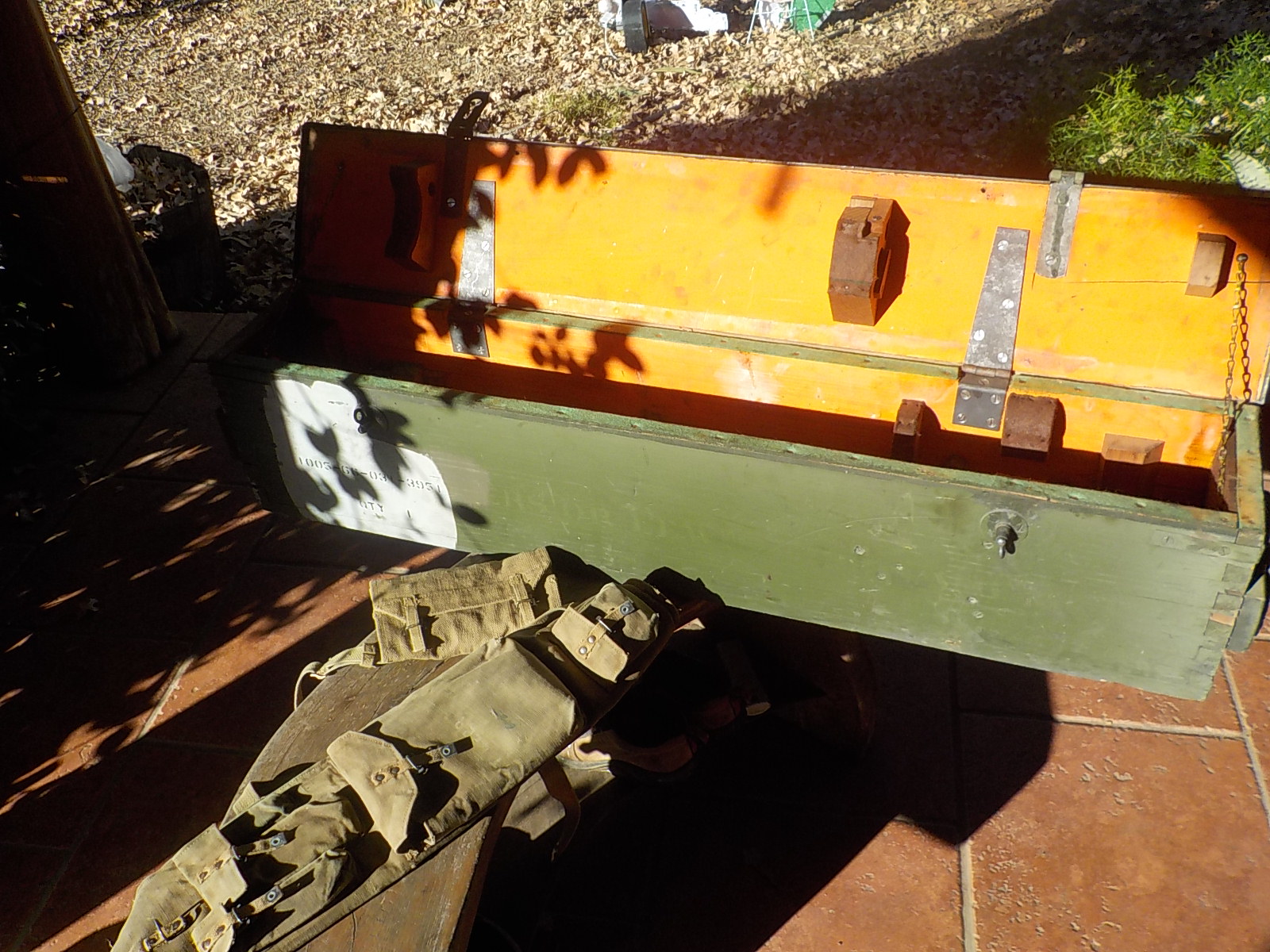

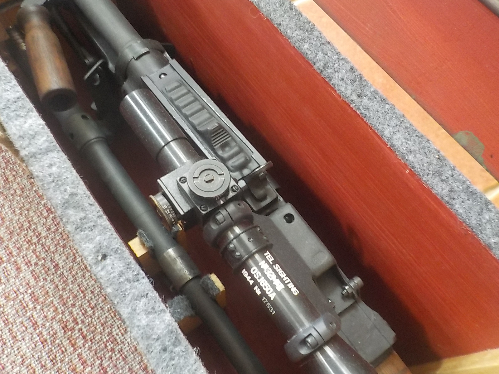

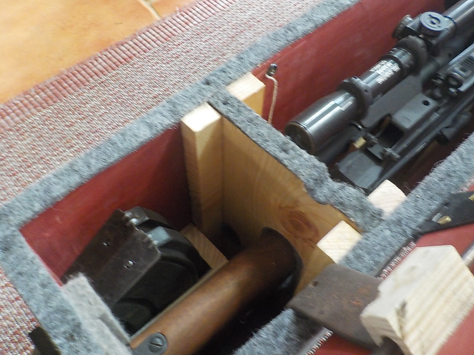

Original Bren transit chest, tool wallet, and spare barrel case. This chest had a warehouse inventory slip from Australia dated 1951. Interior is painted hunter orange.
Bren chest, inside
Vickers chests and Bren chests Jim and I got from Aus and Greece were also bright Orange inside.
Not sure the reason for that... maybe some kind of primer/paint? Visibility at night?
We can’t figure out why... there was a thing called orange creosote finish back in the war. But it looks more like paint.
Read that the transit chests were made in the same factory as the Horsa Gliders. Maybe some kind of aircraft dope?
It is a good mystery worth solving...

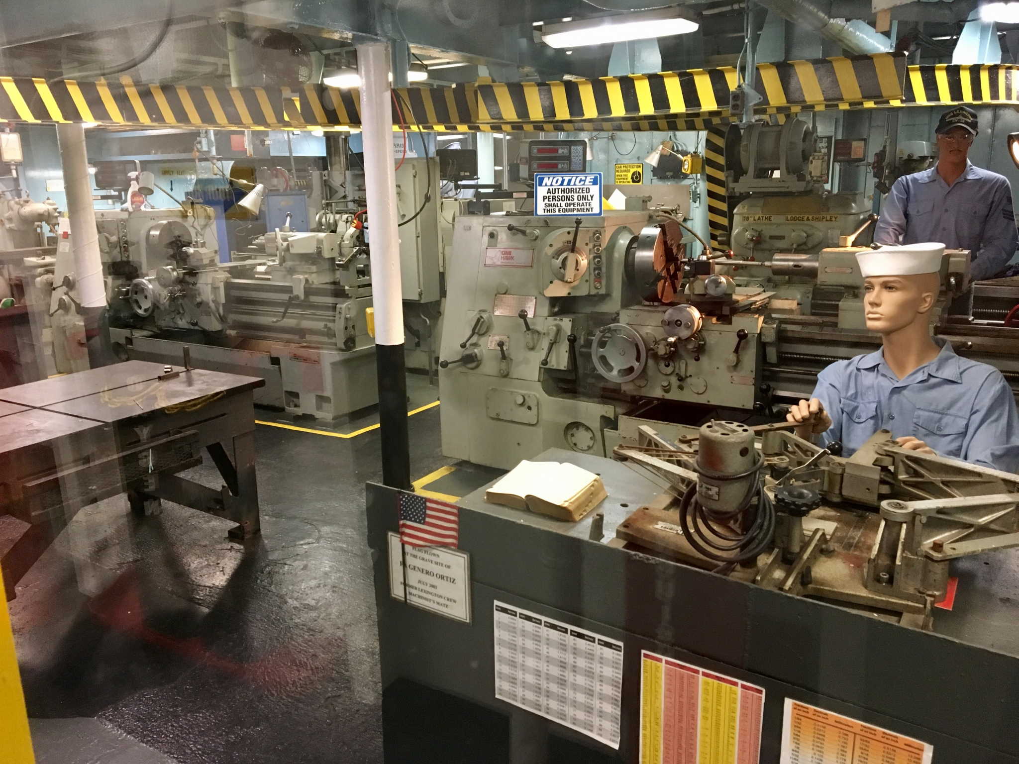

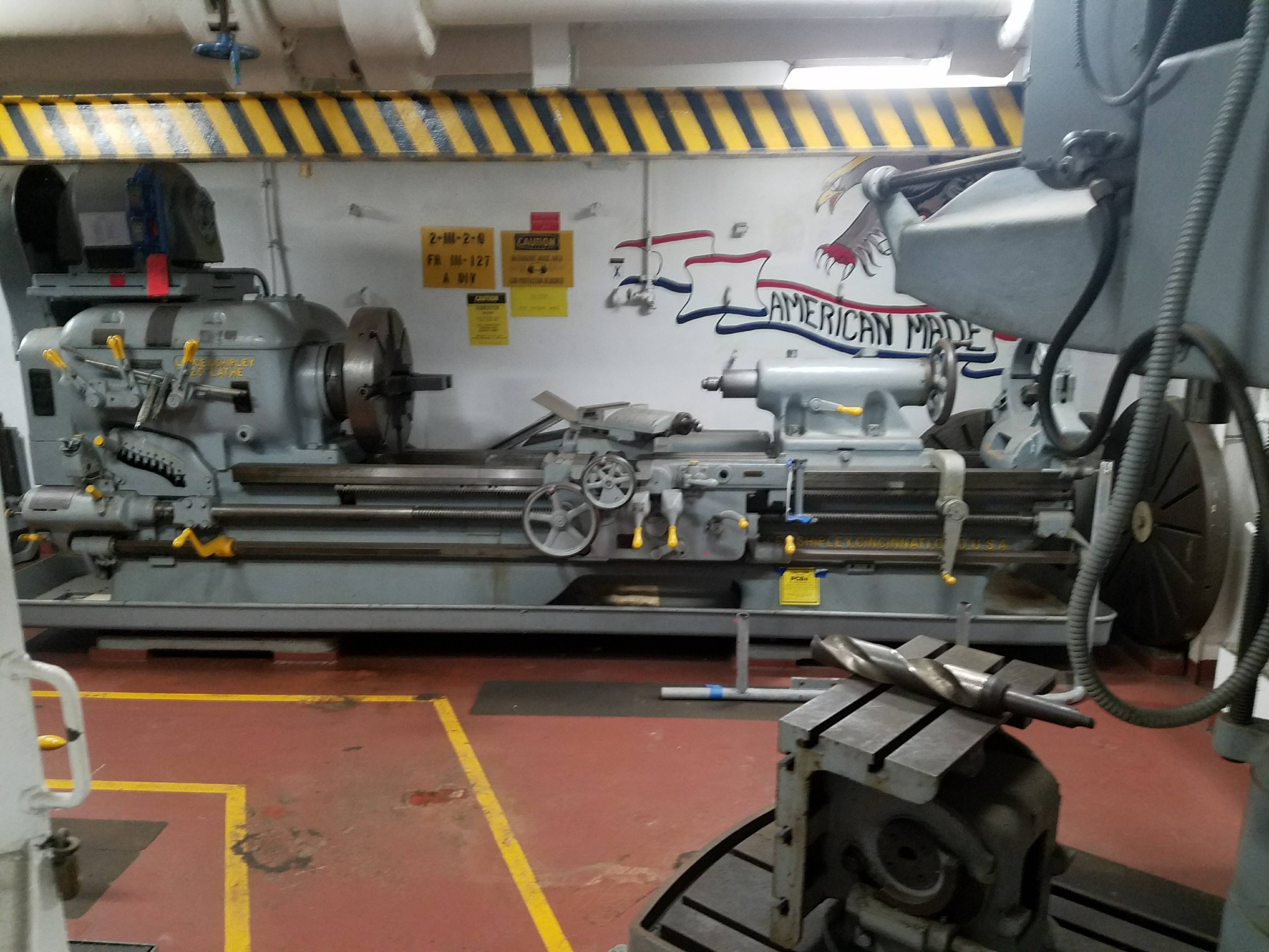

If you are ever down in Corpus Christi, make sure to stop by the Lexington museum.
part of the tour passes by one of the machinery repair rooms, they have a couple of old lathes etc...
Unfortunately, you can't get into the room itself to get a close look at the equipment.
This is one form the USS Missouri:

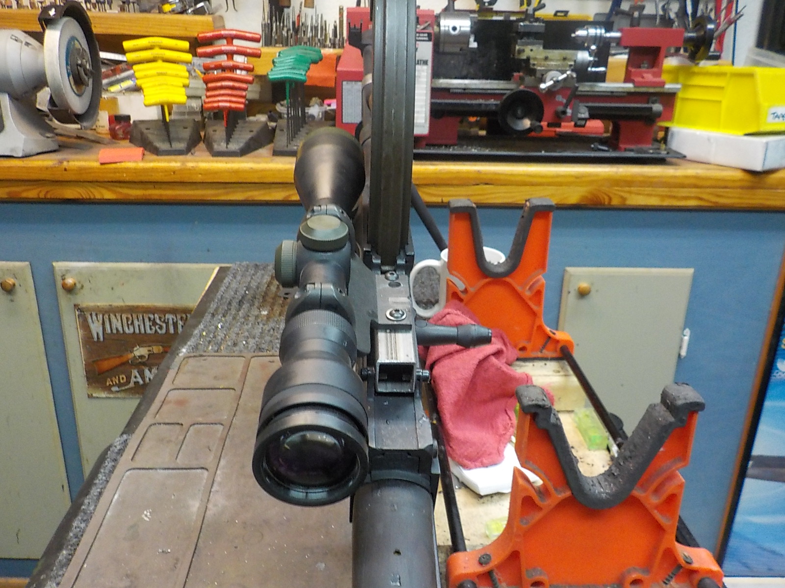

Nothing's easy. Went to mount the No.32 scope and it would not fit between the rings. So I had to shave the outside of the rings and bevel the inside. Then I bedded the rings with steel putty. Excess putty cleaned up after the pic's were taken. And, of course, re-Cerakote. But, I got it done, and it looks good. Very happy with the outcome.
USS Massachusetts and USS Quincy same thing.
Absolutely beautiful machine shops.
Serious US iron.
Nothing's easy. Went to mount the No.32 scope and it would not fit between the rings. So I had to shave the outside of the rings and bevel the inside. Then I bedded the rings with steel putty. Excess putty cleaned up after the pic's were taken. And, of course, re-Cerakote. But, I got it done, and it looks good. Very happy with the outcome.View attachment 7509070View attachment 7509071View attachment 7509072View attachment 7509073
Measure twice cut once Sir........always twice and once.

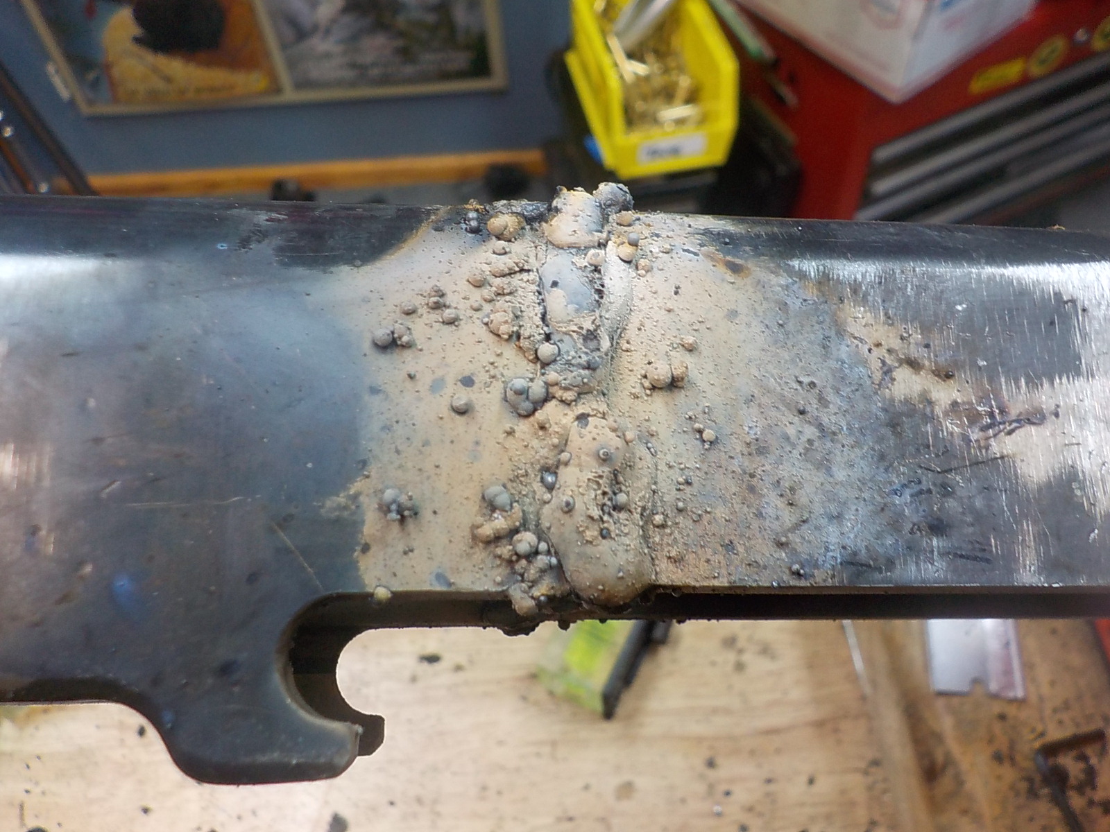

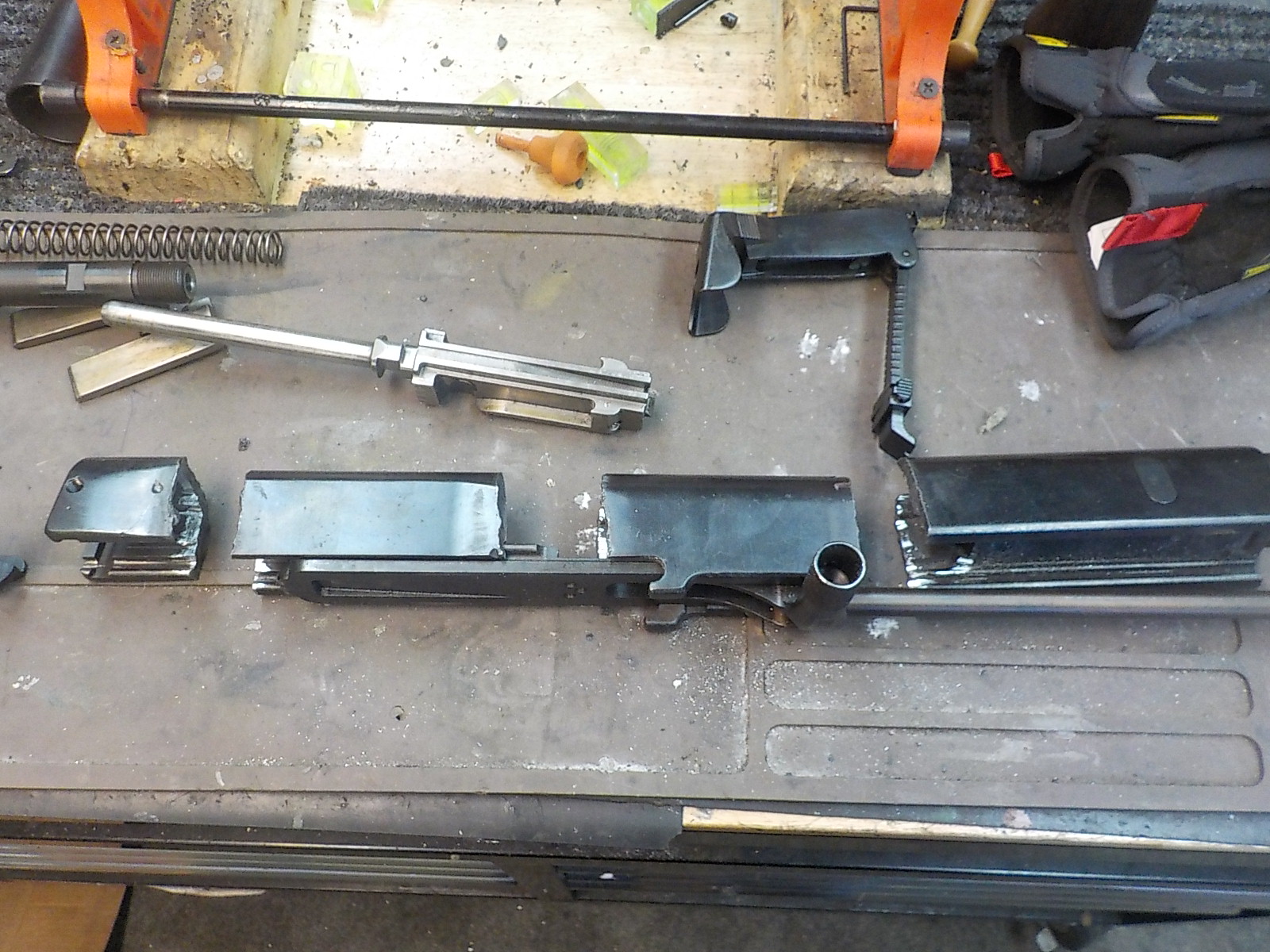

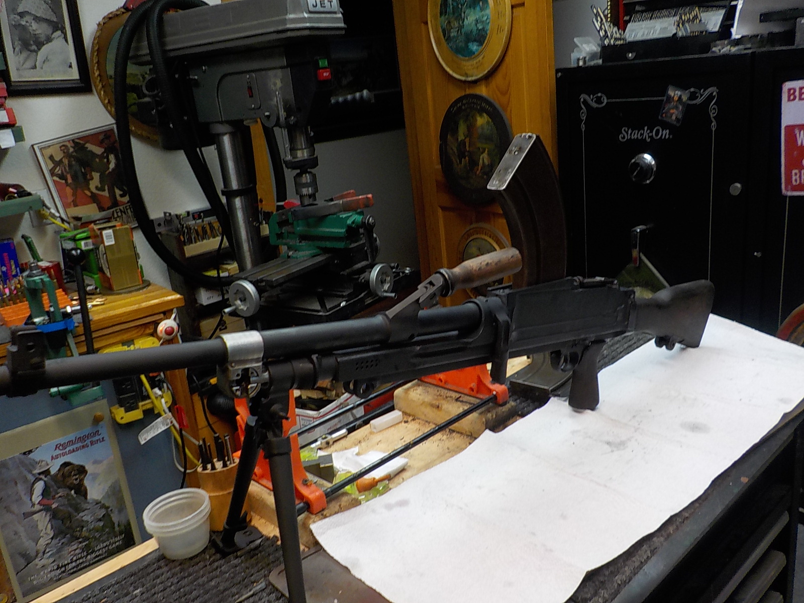

OK, last two days nothing but problems and headaches...but I got it all sorted out and everything works. First, the above mentioned problem with the scope not fitting in the rings. Fixed. My mag catch came yesterday. Slipped right in, fit perfect, done in five seconds. Now to go out and sight in the scope. Wasn't looking forward to it. I knew the rings were mounted in the correct position as I test fired using a Nikon scope, no problem. The No.32 has an arcane zeroing procedure. It involves special tools. I've done this before for my No. 4T Enfield sniper. Basically, you adjust the crosshairs by removing the knobs (turrets) and adjusting a "lead" screw. Once that is done, you install the turrets at the zero. The turrets have minimal adjustment once you re-install them. Anyway, the scope wasn't too far off so it should be no problem making the adjust. However, I was having problems getting the gun to shoot semi-auto. There were a miscellany of problems...gun wouldn't cycle enough to extract and eject the empty, gun would cycle, but the striker wouldn't catch the sear for the next shot, gun would cycle, but would double and then stop. So the scope goes on the back burner...it was only shooting a foot high and 6 inches to the left so it would be no problem making the correction and I could deal with it for now by just holding low and to the right.
So my first reaction is that the springs just need some fine tuning. Shortening the recoil spring should help the gun cycle. Shortening the striker spring should make it easier for the striker to move far enough back to catch the sear. These springs work together and it is a trick getting the right balance. Fortunately, I had quite a bit of spring on hand and could cut and re-cut with abandon. Well, after about 50 rounds I still basically had a single shot rifle. So, I quit for the day and started again this morning. I now moved my theory from springs to just not enough gas pressure. I tried opening up the gas block, and a myriad of other things but I still had a single shot rifle that would feed, fire, extract, eject, but the striker would not catch. Then it dawned on me...a blinding glimpse of the obvious. I had exactly the same problem when I built my semi-auto Sten gun. And I went thru exactly the same frustrating process...until I realized the disconnector was too low. Same problem here. I had taken too much off the disconnector when I radiused it so the striker could move over it smoothly. So, out to the barn and welded a glob of metal on top of the disconnector...literally a blob of metal. Took it inside and cleaned it up a little so the striker could ride over it, took it outside and...Bam, Bam Bam. Fixed. I ordered a new disconnector for $10. The blob disconnector will do for now. I also milled a new striker and need to heat treat that. Shooting video to follow in a couple of days
A couple of odds and ends

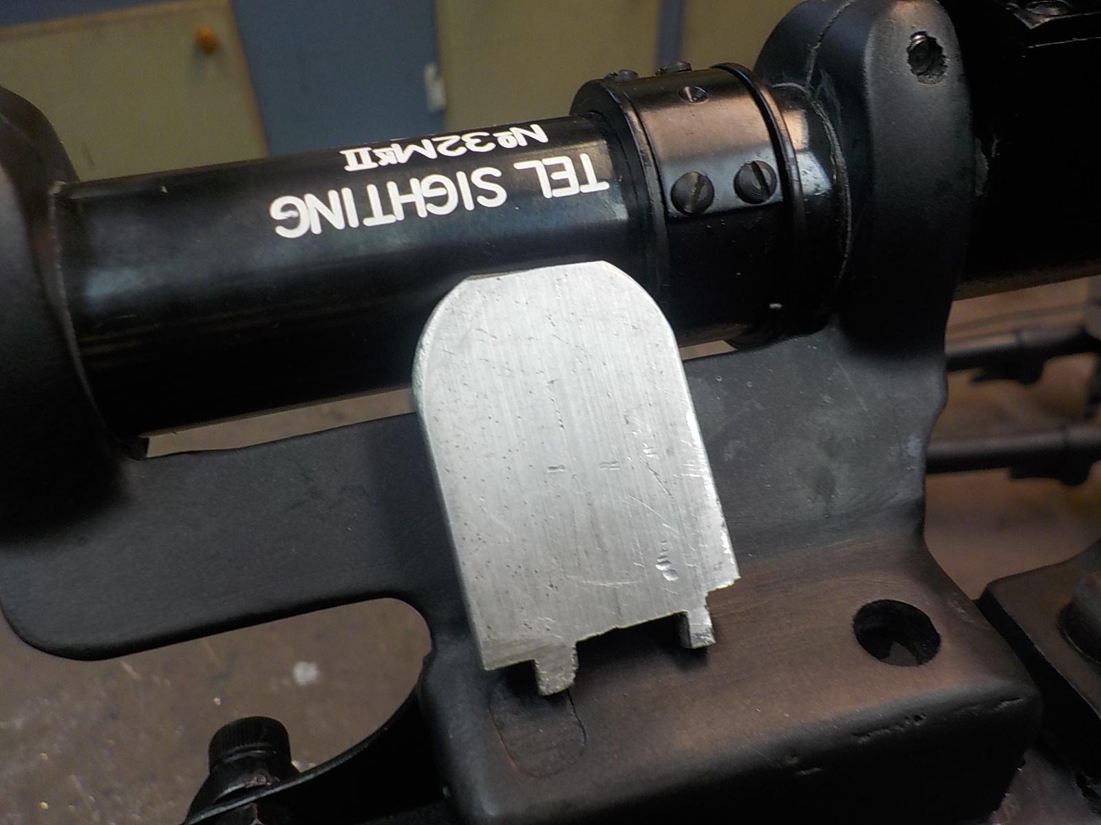

Here's the little tool I made to unlock the No.32 scope turrets.

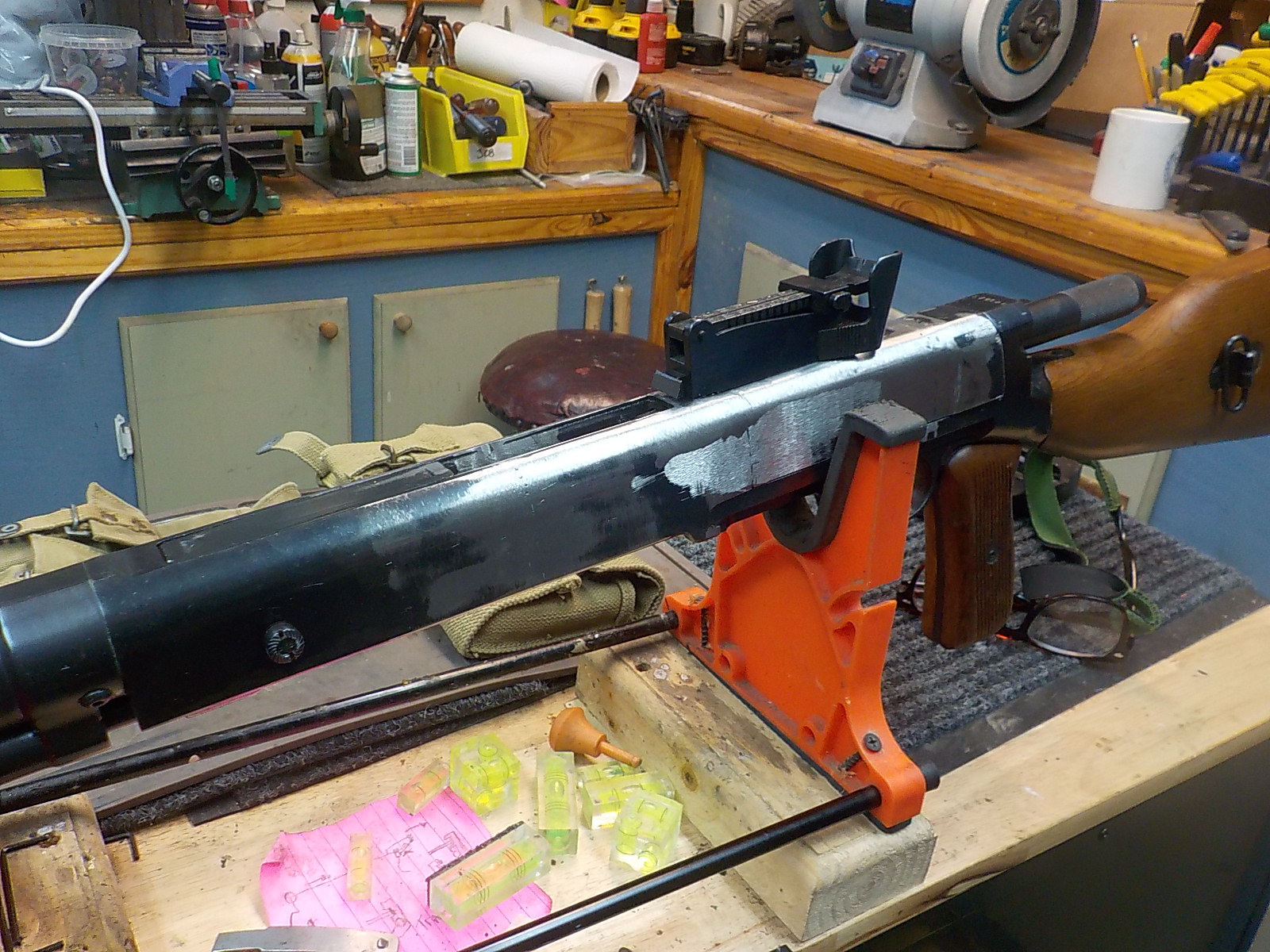

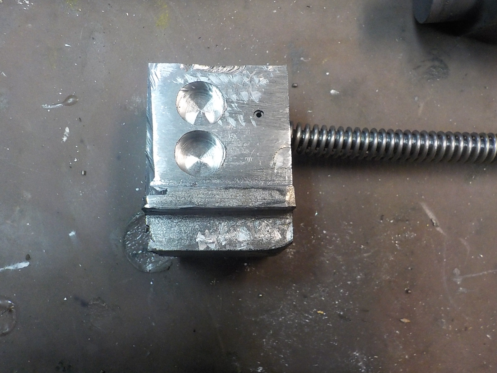

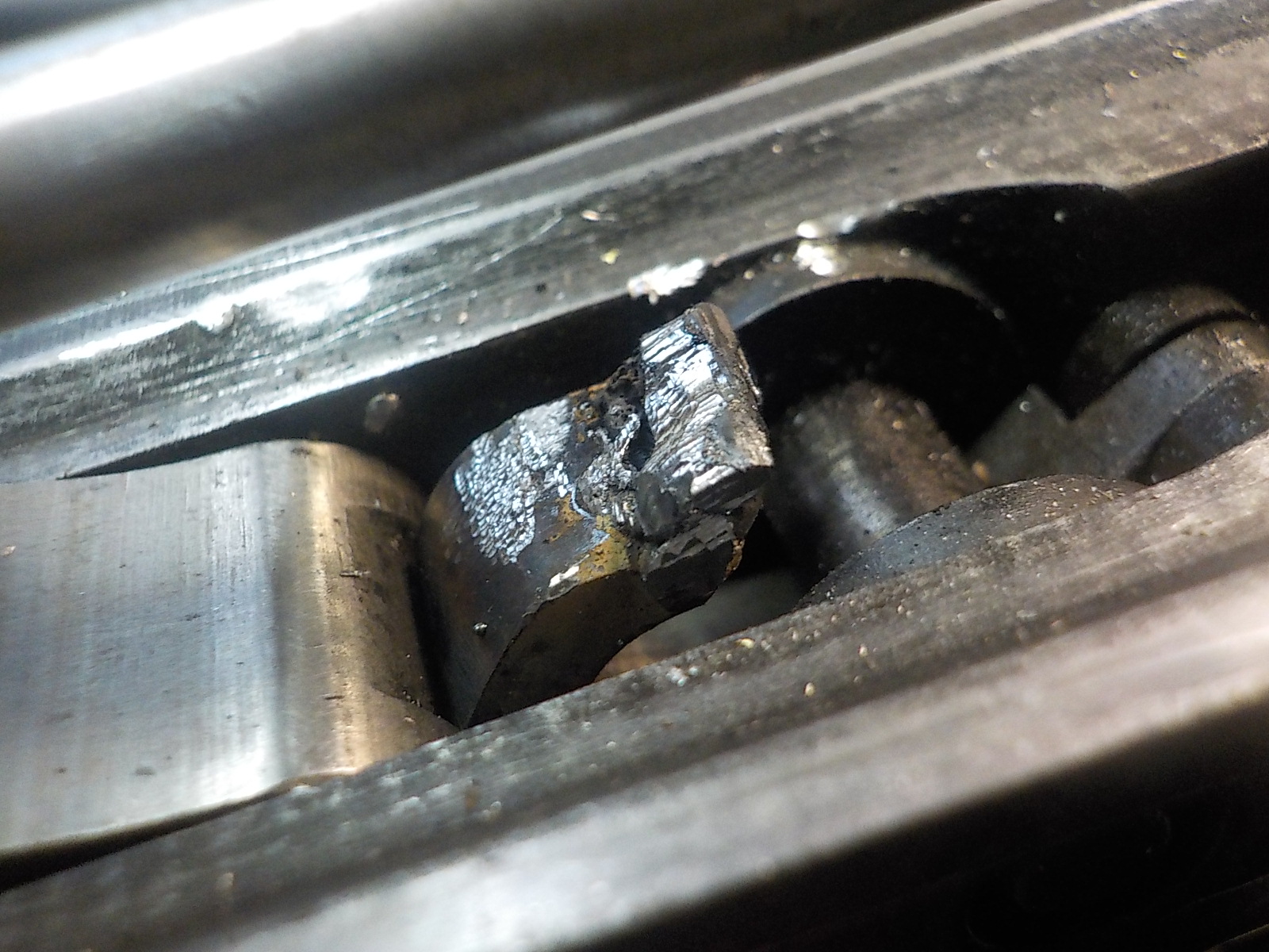

The blob of metal I welded onto the disconnector that got the gun shooting semi-auto. A new disconnector is only $10, otherwise I'd just weld this up better and finish it to factory spec.
New milled striker block, still needs to be heat treated. My first one was more of a "test of concept" and wasn't made to last.

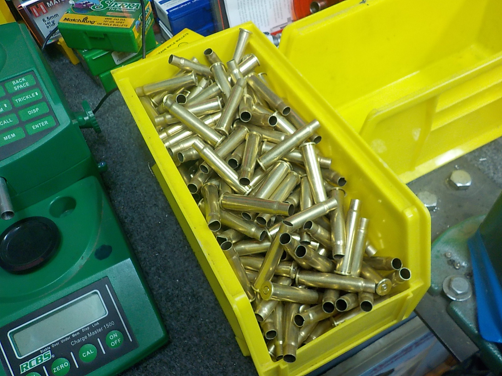

This is how many rounds it took to make this gun work. Around 300 .303 handloads.
Please let me send you my TIG rig when you have a project like this. It will ensure complete fusion and make a lot less cleanup for you.
What filler are you using? When I had my M1A double lugged by one of the guys at Crane, he said 309 was filler of choice for receiver steel (8620, I believe) I don't know what steel the Soviets used, but would guess the Brits used similar.

Thank you for the offer of your TIG welder. I don't know how to TIG weld and since I live on a remote cattle ranch there is no place within 100 miles to learn. Yes, my welds are hideous...but they are solid. There is normally no filler needed. The parts to be welded are contoured with a 45 degree angle inside and out. Then the parts to be welded are butted together on the intact lower rails. This is my welding "jig". I don't want to end up with a factory spec receiver anyway...causes problems with the BATFE guidelines. You have to weld up part of the rails and add restrictor plates/bolts so no part will interchange with a full-auto weapon. After it is all welded together, I make adjustments as needed. Yes there is a lot of clean-up involved. The joints are welded on the outside of the receiver and then the inside of the receiver. The internal rails are then re-cut. When I've made mistakes, and had to cut my welds, they were harder than the surrounding steel. I can weld, clean-up and re-cut a receiver in about 3 hours. It seems to work for me, I've built STEN's, a Suomi, Swedish K, Bren gun, DP 28, and others. I'm currently building a German last ditch VG3008...for that one I'll have to cut the bolt in half, rotate it 180 degrees, and reweld it.
