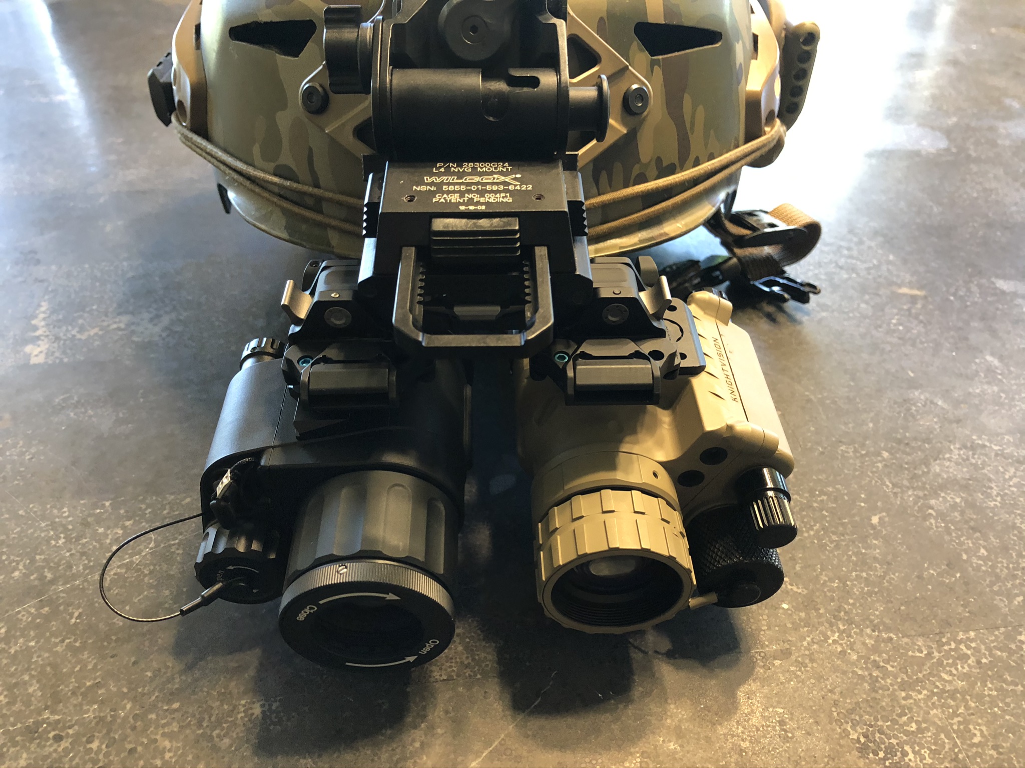

    I run a PVS 14 on a norotos dual dovetail adapter.
    What is the best way for me to bridge the thermal and the 14? Will the wilcox duel dovetail interface with a norotos dovetail?
    So with the wilcox, I can slam the patrol right into it via the onboard dovetail and then stick the dual dovetialed pvs14 onto it and I'll be good to go, or will the difference in size mean one is stuck in my eye socket or something?
    You can slide the patrol into the bridge
    I use IC bridge, it has adjustments for fore and aft.
    If the wilcox does not, you might get cozy with the patrol eyepiece.
    Reactions: WhereNow&How
    Is that the Integrated Components D-14?
    It looks like to run the wilcox I would also need a wilcox j-arm to allow me the eye relief needed for the patrol.
    Can the IC bridge integrate directly with the patrol and my norotos INVG mount + norotos dovetail?
    Would love to not spend $200 on an additional doo-dad with a wilcox engraving👾
    If the wilcox will slide forward, you should be able to achieve the same result with the wilcox.

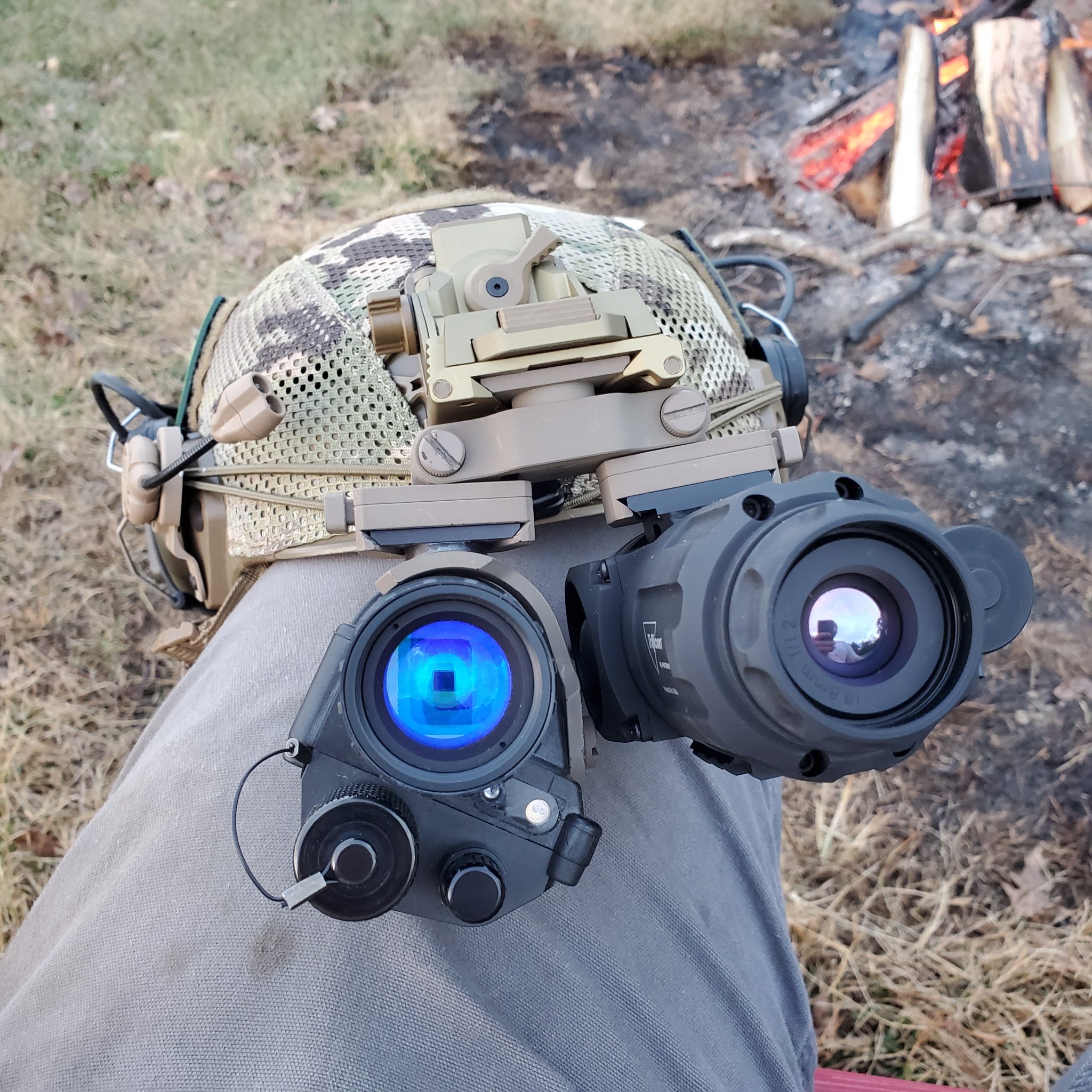

    This probably doesn't show what you need to see ... but here is 14 attached to IC bridge, using ic bridge provided "interfaces" for the 14 ... and the patrol is slide in to the oc bridge dove tail.
    No "mounting components" required other than the interface piece for the 14 which comes with the bridge.

    I saw a post regarding flipping a portion of the wilcox bridge to create appropriate offset.
