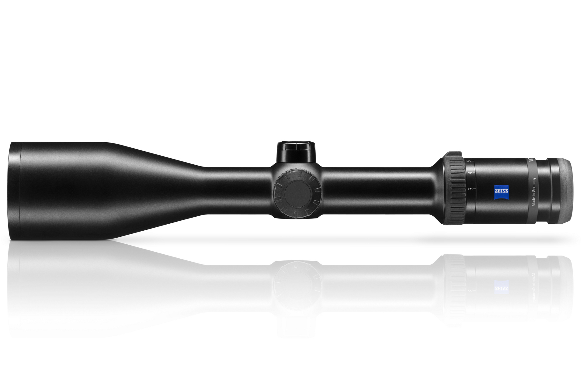

I know that this Zeiss is the best when it come to low light hunting.
And it has been the overall king on test in Finland, many times.
Schott glass.
