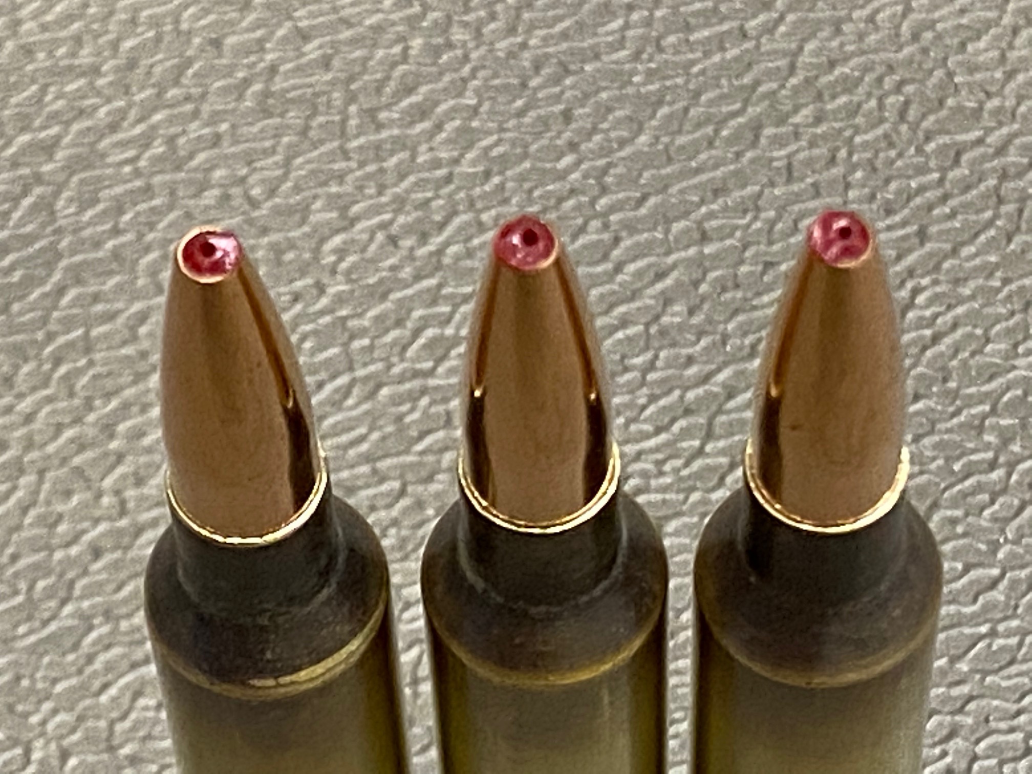

Anybody else see this issue? I've shot almost 5000 Hornady 140 ELDMs since 2017 and until this month have never seen this before. A couple of weeks ago I was shooting a match and had a round go way low at 600 yds that was not due to me making a bad shot. This picture is of three broken bullet tips out of 500 reloads that I just did. I loaded the rounds on my Dillon 550 and then cleaned in a Dillon Vibratory case cleaner for 10 minutes to remove the case lube, so the broken tips happened in the case cleaner. I'm guessing a broken tip like this could affect bullet BC enough to cause a miss at 600
that must be a hell of a case cleaner.
I've dropped some loaded rounds on concrete, but have never had the tips break like that. Maybe just a little bend.

I shoot the Hornady ELD-M 140 rounds and I have never seen this “malfunction”. As a matter of fact I have never seen this issue with any load or manufacture. It sounds like you haven’t experienced this issue either. Is that case cleaner particularly corrosive? I’m sure that Hornady would like to see the damage, and maybe offer their take on why it happened. Please keep us updated with what you discover.

It's a run of the mill Dillon Vibratory case cleaner with ground walnut media so it isn't very rough on the brass or loaded rounds. The week after the match, I also had a bullet tip break when I was chambering the round in a Nucleus. Near as I can tell, the tip broke when it hit the feed ramp. All these bullets came from a 2000 bulk bullet case bought from Brownells. The first 3000 ELDM's that I bought didn't have any issues. I'm about halfway through this case of bullets and the only thing different is I'm shooting in 90-100 degree temps instead of winter temps.
I'm not sure I would completely trust any tipped bullet that was shipped in bulk and traveled through several conveyor belt sorting systems before being thrown on a truck for delivery. The trip from Hornady to the supplier was on a pallet.

FWIW I've seen it before, brittle material from whoever made the tips, air bubbles in the tip, or swaging the ogive too hard. If you contact Hornady tech support they should help you.
