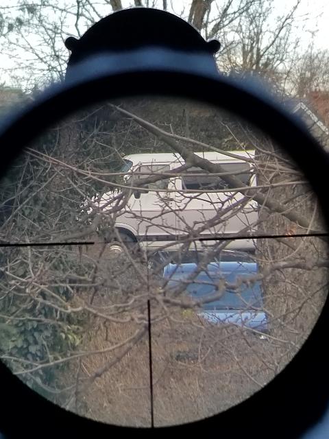

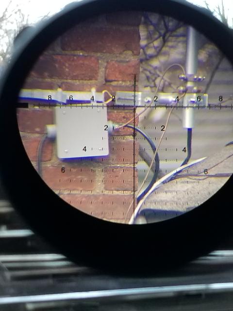

I just received mine 2 days ago, and I have none of the issues mentioned. In fact, the turrets are one of the best features of the scope. The glass is VERY clear, and the rericle design is very innovative. It is quite heavy, but it seems to be built like a tank. Here are two shots. One at 5x and the
other at 16x.
I assumed that I had not been able to get the focusing perfect yet, so I considered the reticle issue to be a minor issue. Anyway I do not move my head around when shooting.
I made a pair of plastic rings to mount the scope on a heavy stand so that I could check the tracking when the daylight returns [I live at almost 70 degrees northern latitude so still rather dark] but when I discovered the wobble In the windage turret I got so disheartened that I desided to return the scope and ask for a refund.
Maybe that was a stupid thing to do. Maybe this scope was just a bad sample. I really liked the double line reticle.
Have anyone else tried to push on the windage knob as I do in the video?

You may have received a defective one. No wobble on my 5-25x56.
Thanks for the reply. I found it rater strange that this scope had sloppy threading. My Nikon scopes are tight despite costing far less.
Hell even the Athlon BTR 4-14x44 I had was not this sloppy fitted. And I know for sure how poorly the threads on the Athlon turrets was as I took the scope apart after ruining it by dropping the rifle on a concrete floor.
Hopefully more people can do the wobble test and confirm that I just got a scope that slipped through QC.
I got a really good introduction prize on the scope [25% off] so I really wanted this to be my new scope.
Apparently I got what I paid for......?
Please consider that I am talking about the Norwegian price. I still paid slightly more than you have to do in the US.
I suspect you got a fluke. I am sure Brownells will take care of you. Several people bought the MPO based on my recommendation and none are experiencing the same issues as you are.

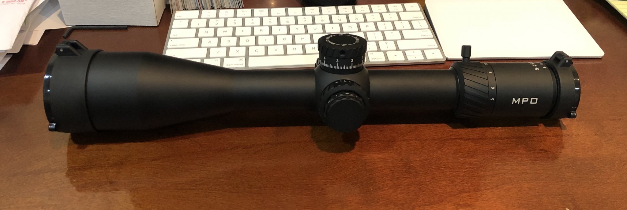

I found out that I live only 11 miles from Kenzie's Optics in Acworth, Ga, so I paid them a visit this morning. I really wanted to see an Optika 6 but they were out of stock... I did however get to see a Crimson Trace 5-25x56 which is supposed to be very similar to the MPO.
The first thing that I noticed was that it is a tank. It felt a lot more solid than the PST 2's I've played with(although it's been a while...). I personally like the weight for my intended use. I have my match gun in an MDT LSS gen 1 that I got for free so I have had to do some crazy stuff to add weight. I did not like the turrets very much though. The clicks were not very distinct. About like my SWFA fixed 20x but further apart. There was also less resistance than I think there should be. They were almost too easy to turn. The illumination knob was very very stiff so I don't think you would accidentally move that while adjusting parallax. All in all it seemed quite nice. I cannot comment on the glass.
The reason I gave this information is if the MPO is really just a better spec'd CT with improved turrets then it will definitely be well worth the money. I wish more people were posting comparisons.....

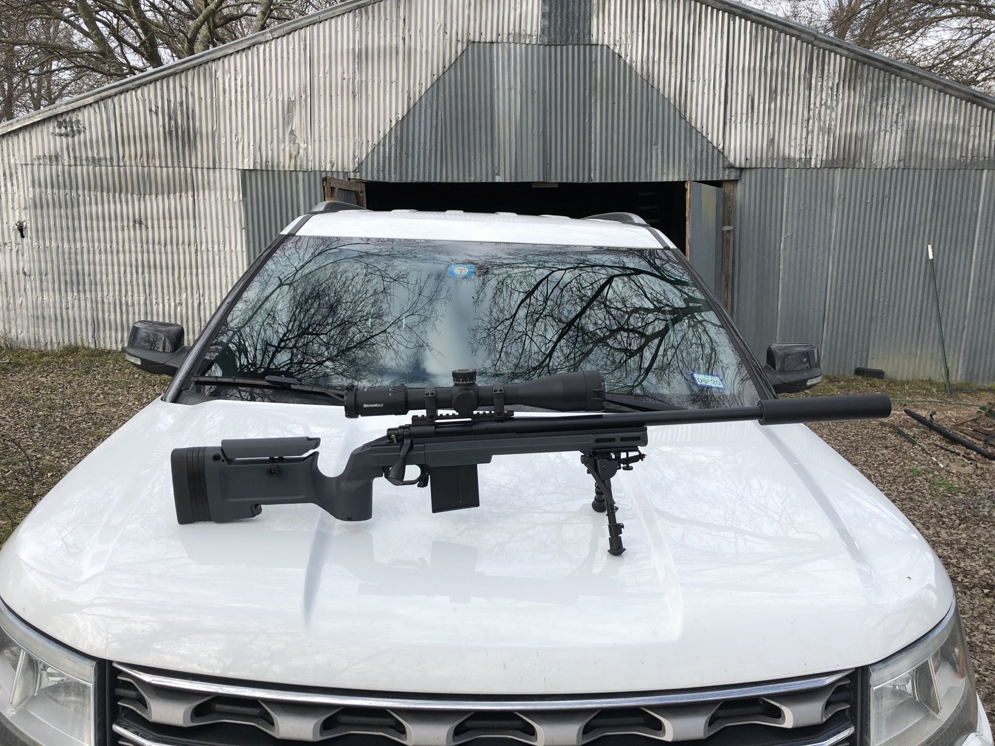

Well I just got my MPO today and I am happy so far. I need to take it out and put it through a box test. Also, shoot some with it. However, my first impressions are it's better that the PST Gen II. It comes with end caps similar to BC caps and has an integrated throw lever. The illuminated reticle has 6 adjustments and is very bright on #6. Also, since it comes with illumination and the Arken EP4 6-24 doesn't I would have to say if you want illumination it's a better deal than the Arken scope. I like the elevation an windage turret feel better than both the Arken and the PST. It's a little early to say, but if I like it I may just sell my PST Gen II and my Razor Gen II. Need to spend sometime with it before I get ahead of myself.
