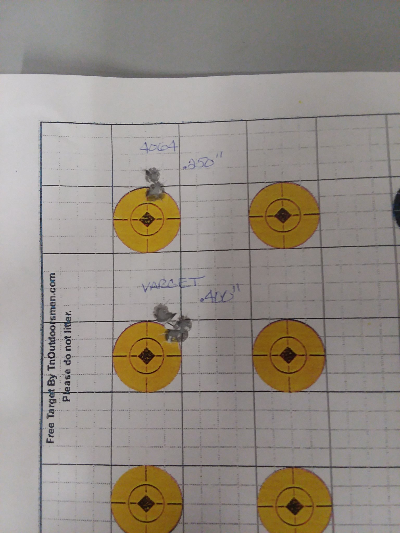

I got one, the 6.5 CM 24" barrel. I have not shot it enough yet or play with loadings. After 5 rounds for sight it, top group is my first group with 37.3 IMR4064, 139 Lapua, second group is 37.0 Varget, 139 Lapuas. These two loads shoot great in all my 6.5's. This was the first time I ever fired a RPR, first round in each group is the single bullet strike ever so slightly out of the group causing the spread. So far, I am liking it.
