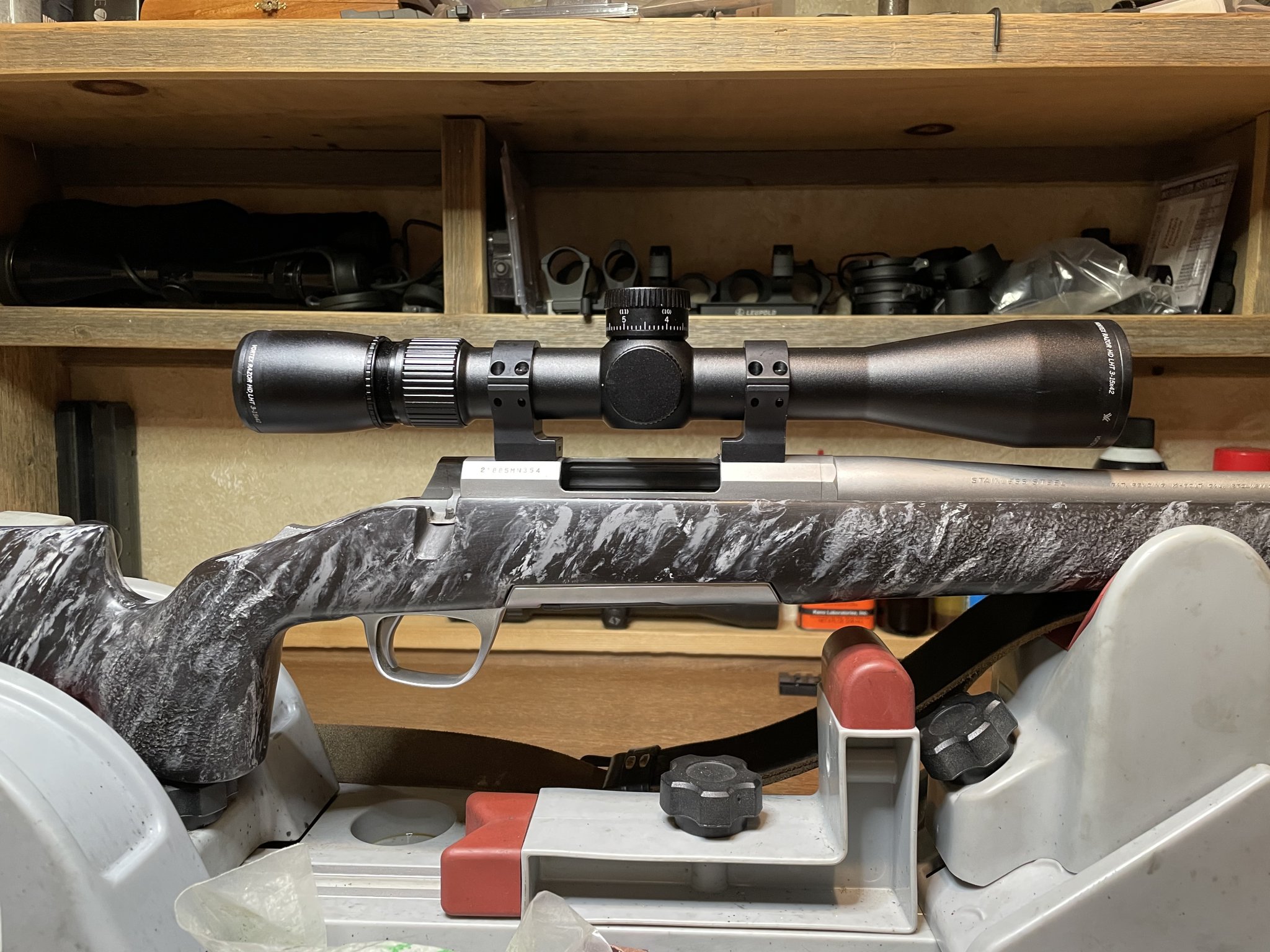

I got a Vortex Razor LHT 3-15x42 for my son’s .270wsm xbolt. First try was a Warne Mountainlight rail with NF Ultralite low rings. However we thought this resulted in the scope being just a bit too high (non-adjustable McMillan stock). So plan B was the Talley Lightweight 2piece rings, medium height. The Talley lows might have worked but wouldn’t have had enough clearance for the Vortex scope caps. Here’s a pic of clearance with the Talley mid’s.
