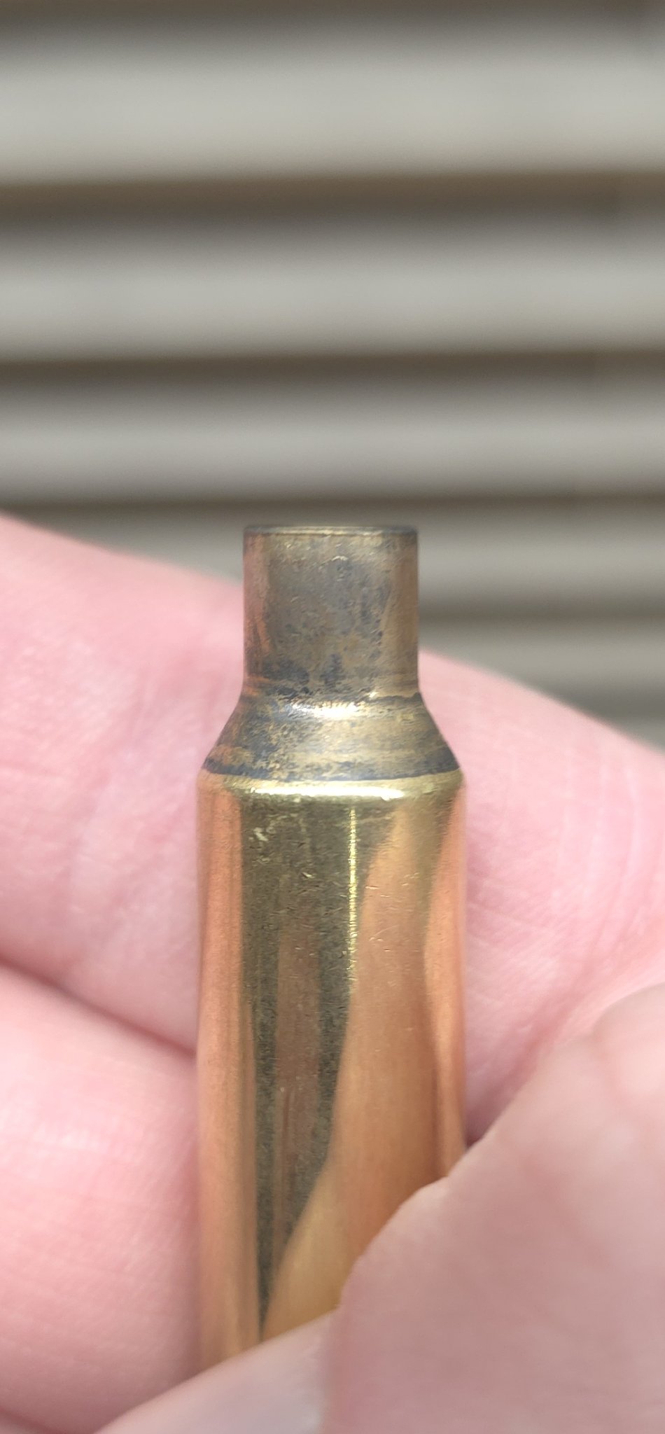

Good to know thanks. By chance do you know what causes your brass to have carbon fowling that goes below the neck and onto the shoulder and if there's a solution or if it even matters? I was thinking maybe it's from a carbon ring building up allowing fowling to prevent the neck to sealing off before the fowling sneaks by?
I'm running a suppressor so idk if that makes it's more dirty or not. I'm new to bolt guns. Only ever owned semis so idk whats up helf the time with bolt guns lol
