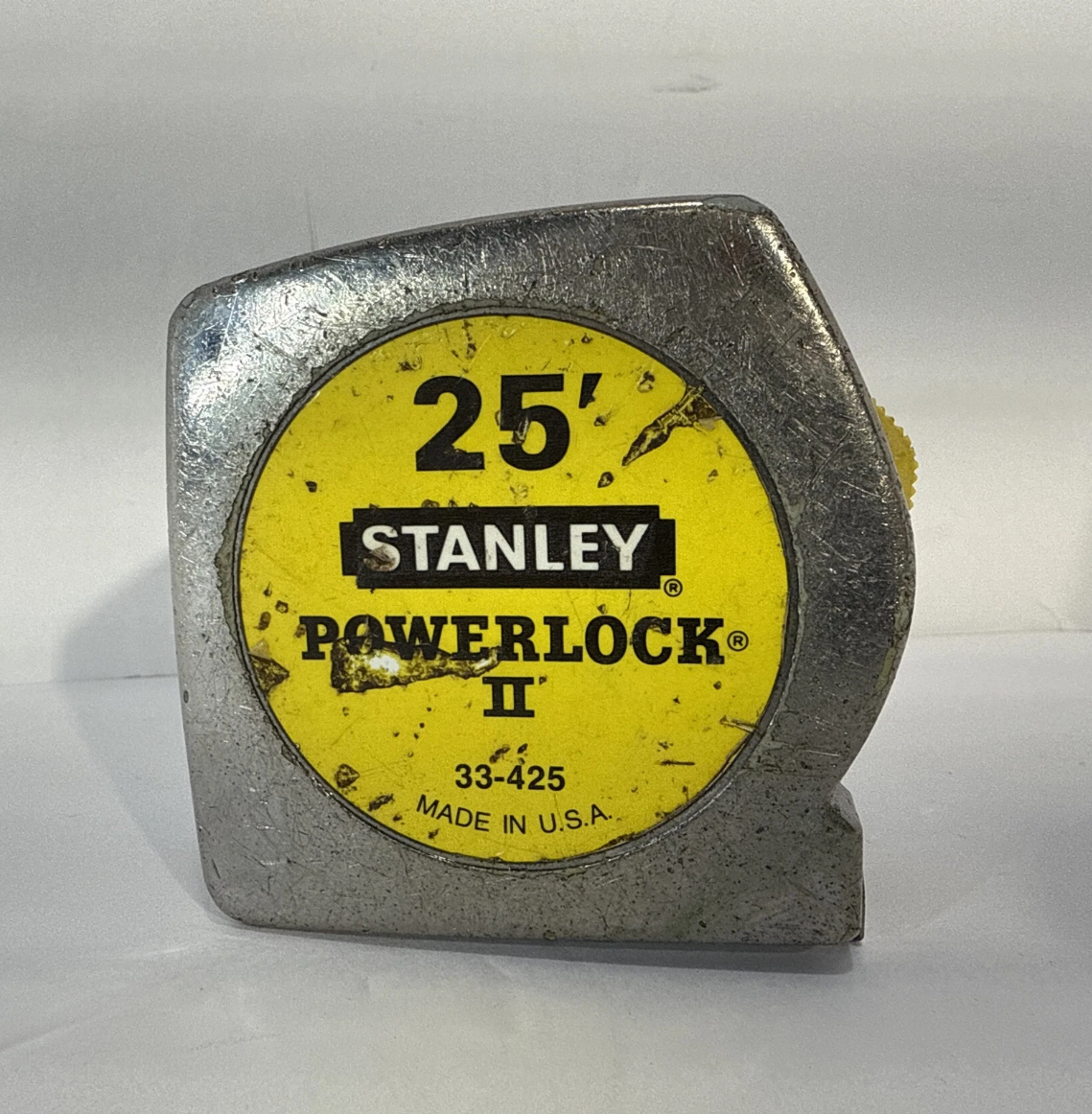

I found when reloading that I had misread my calipers once so I threw them in the trash and went back to using my trusty Stanley 25’ rule.
