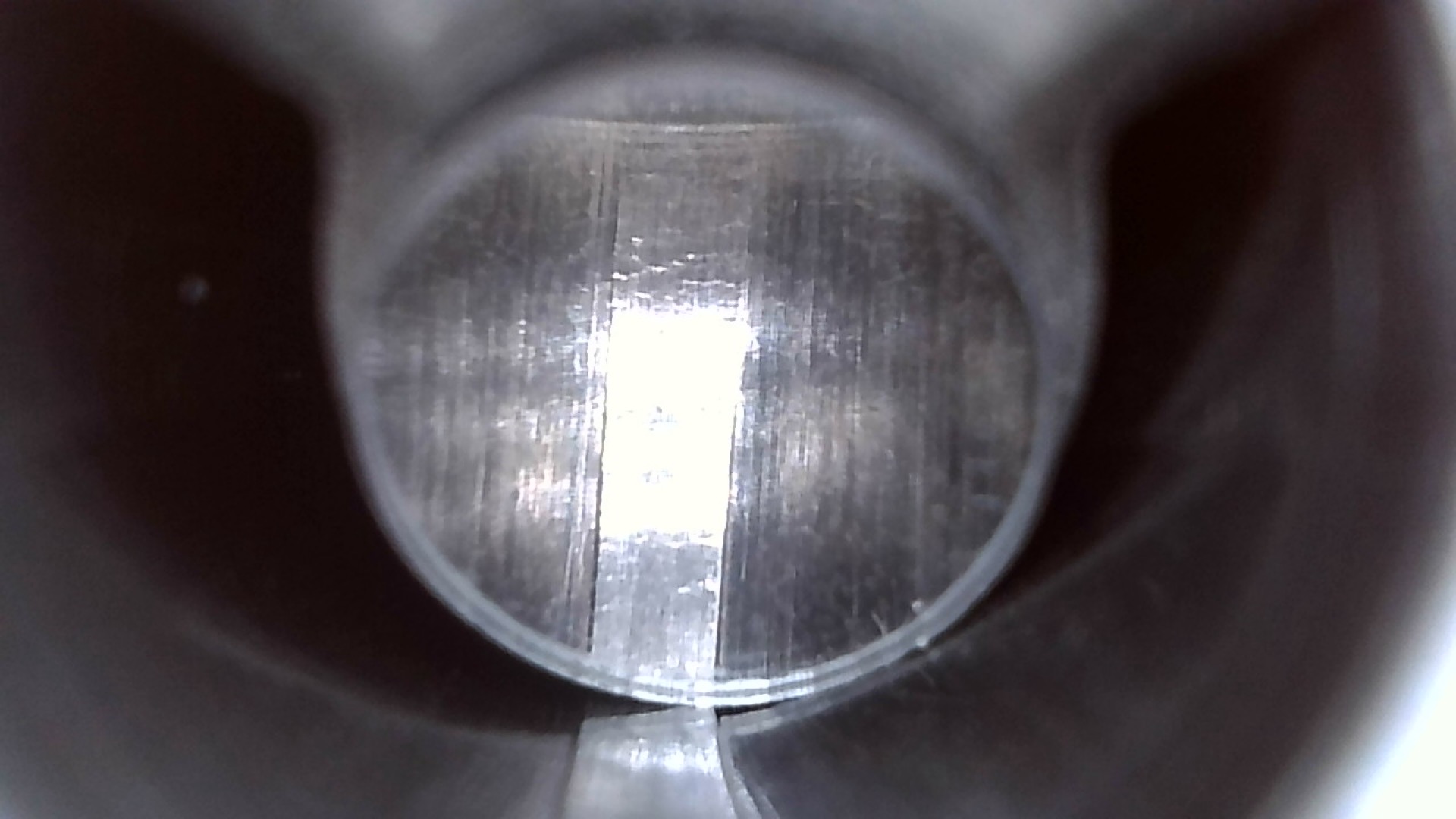

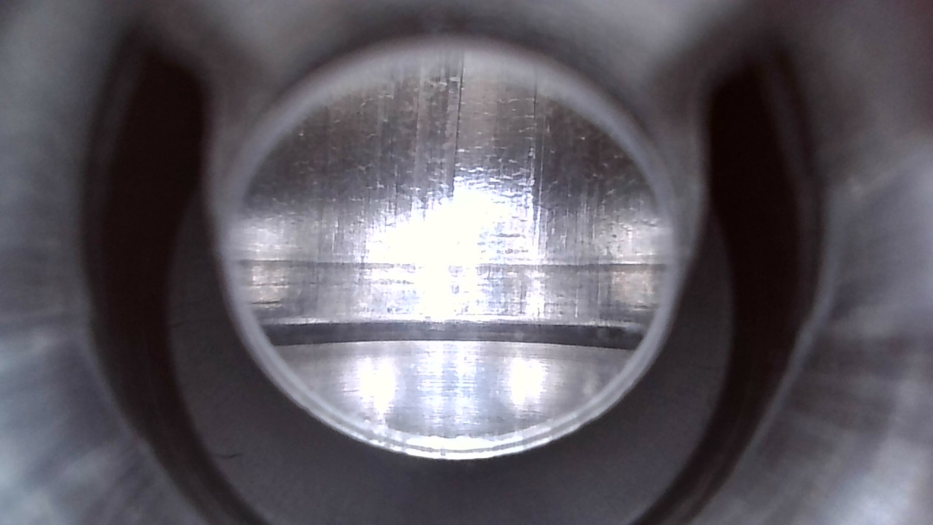

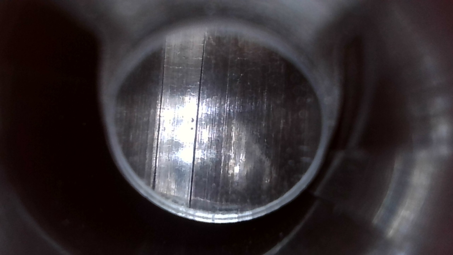

All pictures are on the same groove just in front of the end of the chamber. Barrel is a 6 PPC Bartlein with 8-900 shots.
Barrel after a thorough cleaning with solvents and Rem 40 X before putting up for winter.
After 28 shots recently, couple wet patches of H/FA, then 25 passes with a bronze brush immediately after firing the last shot at the range, then a 24hr soak.

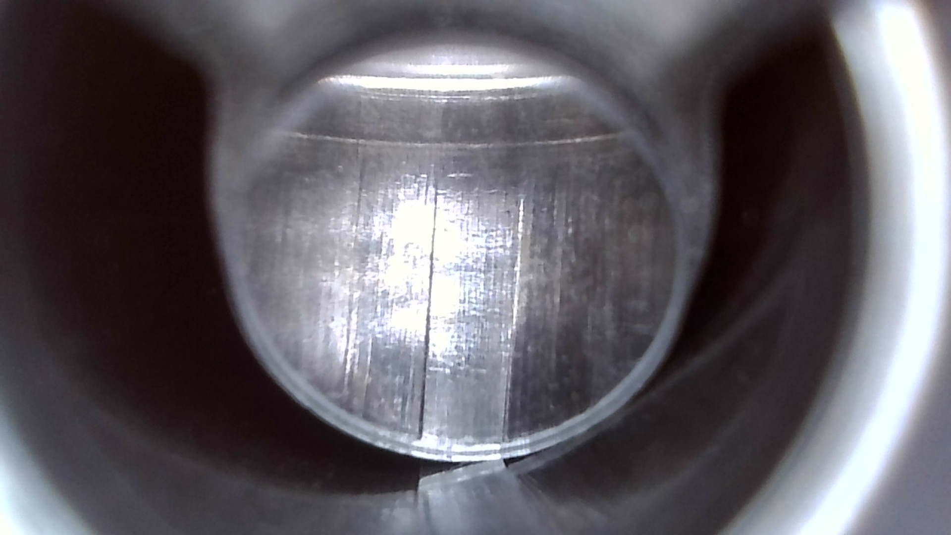

Wet patches of Montana Extreme Copper Killer followed by 25 brush strokes and a 15 minute soak.

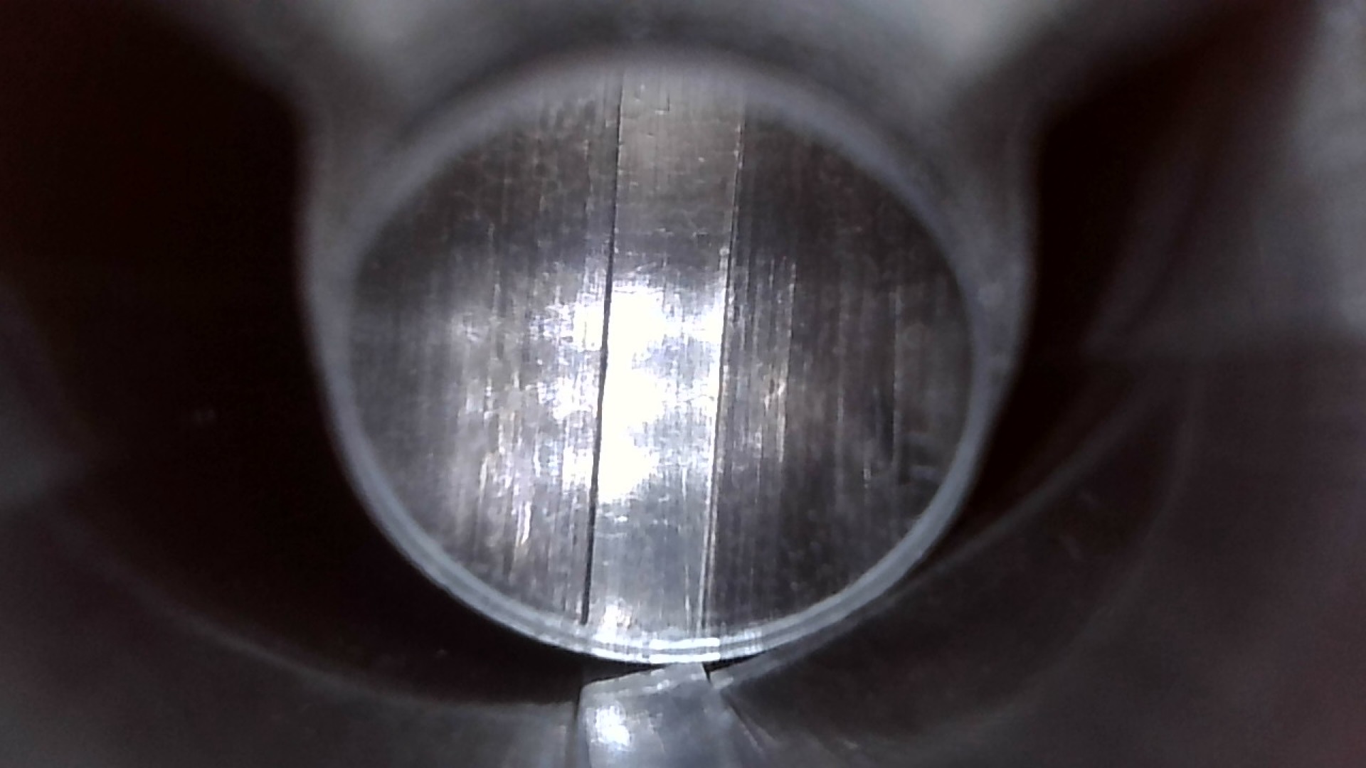

Decided to try a 24hr soak with the Copper Killer after brushing, same regimen as before but 24hr soak.
Finally did another Hoppes/Free All brush and 24hr soak.
The last session didn’t pull much more carbon but the first patch was definitely dirty. Going to try this routine for this upcoming season. The Copper Killer seems to do a better job than BT Eliminator but the Eliminator is old. Montana Extreme Copper Killer will knock your socks off when you open it!

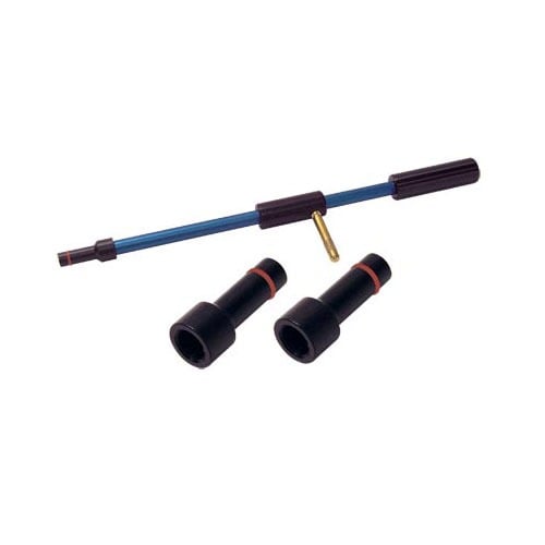

AR Rifles: Do you use a bore guide for non precision/government type AR rifles? Any problems using hoppes in chrome lined barrels?
Other Firearms: Specifically ones that can't be cleaned from the back (revolvers, m1 garand, etc), do you use a muzzle guide on the rod?

For AR’s in a pinch you can use a bolt carrier as a bore guide.
@Frank Green Id like to expand on this a bit and get your opinion on cleaning firearms other than precision rifles.
Milsurp rifles: I have some older mausers, 1903a3 springfield etc. Do you try to find bore guides for these, or just clean from the back and do your best?
Nope I use a bore/rod guide for my AR rifles as well. Same with a 1917 enfield or Springfield or Mauser etc...
Use something. Something is better than nothing. If the barrel is in good shape... why take a chance on wrecking it?
The Sinclair rod guide is pretty universal. Only thing I've done to those is put a chamfer on the backside of the guide handle so it's easier to pull out as the ejector isn't locked against that flat surface.
or get a straight one piece one like this.....than it keeps the ejector pushed back the whole time and doesn't get hung up.

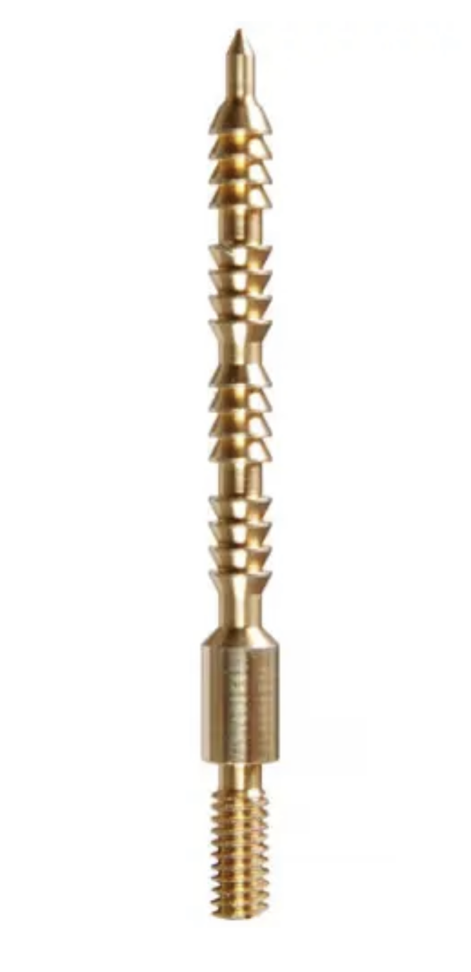

@Frank Green
Wanted your opinion on ParkerHale jags from Dewey. I started using them and like them but the little voice in my head is telling me I am fucking up… Am I?
Why do you think you are fucking up....Frank has said many times he uses them...particularly when discussing use of mild abrasives like 40X and JB blue label.
Based on that I bought some of these jags and do indeed use them on the infrequent cleaning with abrasives that I do. No problem at all. I do use what would be considered an "oversized" patch if used with a pointed tip jag when using the Parker Hale type jags....e.g. 30 cal patch in 6.5 bore.
Cheers
@Frank Green
Obviously you cover up the entirety of the Parker Hale jag so the ridges don’t touch the bore. Just stating the obvious; I have been known to miss the obvious lol.
I take a large square patch and cut it to length so there’s a bit of overhang on the front so the patch can’t fold back when first inserting. You’ll have to experiment on how much overlap (the width) is needed to get a decent fit. I write it down so I don’t have to futz each time.
@Frank Green
That's pretty much all I use... the PH jags. I use the female threaded jags to thread directly on to the male threaded end of the rod. That way you don't need an adapter. I'll use the adapter if I have to but prefer not to.
Wrap the patch around the PH jab like you roll a cigarette. For 30cal I use a 2.25" square patch. For a 6.5mm about a 1.75" square is perfect.
Cut your patches to a proper size so they don't fit really tight and don't fit to loose. Cover the diamond pattern of the jag... you don't want the patch going onto the smooth surface where it threads onto the rod... that will create a tight/binding spot.

Pro Shot makes what they call a Brass Wrap & Spear Tip Jag, which is their version of the Parker Hale. It has male 8-32 threads.
Hey, by the way I’ve been looking with no luck for a long time for a Parker Hale type jag for 20 and 17 cals.
Well well well I think I might’ve found something suitable, if not exact. Montana Xtreme makes these for 17/20cals (and more, of course):
Now I have to see if I need to buy a new rod, or if the diameter is the same as the pro shot jags.
Reactions: lash
Here’s the dimensions of the 17/20 cal jags. MX uses the same rod for both caliber, so the rod/jag transition diameter for both is 0.158”.
For Pro Shot, the 17cal rod is 0.155”, and the 20cal is 0.186”/0.187” -ish, so I guess I’d be using the 17 cal PS rod for both calibers with that MX jag.
Since I wouldn’t be pushing it out the bore, having a smooth transition isn’t as important (I think), so I’ll order some jags. If need be, I can sand the jag transition bit down or order their rod for this infrequent task.
Nope many of us use them ,using them properly is another matter altogether .

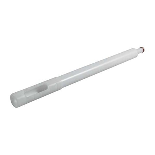

Bore guide , Dewey Rods Chamber too Muzzle . Nylon brush with solvent ,when it pops out the end remove brush . I also use jags later and remove Jag and patch ,I also have several soft Uxcell / Sherwood hi temp silicone tube caps in assorted diameters . I then slip one on the end of the Rod thread as a protector . I then pull the Rod back and repeat . I even made various brass thread adapters to fit male Dewey thread M/F 8-36 / 5-40 and 8-32 and a larger 27 Cal. Rod with 12-28 I believe .
Anyway crap goes one direction OUT and drawing rod back protects bore from rod thread .
IF You don't want to bother removing Jag , you can purchase plastic thread screw inserts ,things you drill a hole in your wall tap in plastic insert and put a screw into . Just buy the un-flanged and those come in a few sizes also . Screw your Jag into one end ,pull the Rod back ,does same thing .
My brain has never liked the idea of the parker hale type jags in that since the patch does not wrap evenly around it that it could over-pressure an area with less patch, but I've heard they are more picky about patch material/size too so that might be part of my experience. Same for the montana xtreme version where you puncture at a corner, usually if I do that, I can't use enough patch to cover the whole jag or it's too tight and seems like risking as the patch leaves the barrel pushing exposed jag into the crown. Ridiculous I'm sure, but even Montana's own video on how to use their jags shows an example where they only cover about 1/2 the jag with a patch and the rest of the exposed jag ridges side over the crown edge.
I tend to like the bore tech proof positive jags the patch evenly covers all of the jag that can touch the barrel. I really like the o-ring versions for a squeaky final clean, but they can be hard to find the right size patch/jag. You can run 2-3 patches with a normal snug jag/patch that are clean, but run a snug o-ring version after them and it will always pull out more stuff. I assume because it does a much better job getting into the corners where the lands/grooves meet.
Great ideas on the plastic anchors and/or end caps as well.
