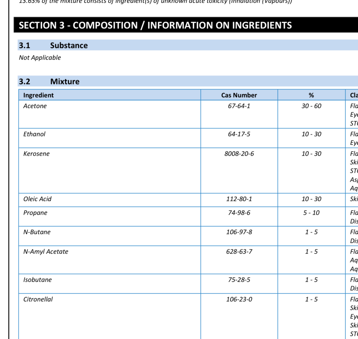

After reading through the thread and brushing up on some organic chemistry heres a quick summary re: cleaning with water-based solvents like Bore Tech:
When done make sure to always thoroughly dry patch it out then follow that with 2 to 3 wet patches of isopropyl alcohol (IPA). The IPA is highly hydrophilic & will draw any water that’s remaining in the bore from the bore tech solvent towards itself as it gets patched out as long as it’s stronger than 65% (pure IPA will rapidly absorb moisture until it reaches an equilibrium ratio of 65% IPA 35% water). It also evaporates very quickly (which is why it’s so volatile). Run a few dry patches the you can run a lightly coated patch of USP mineral oil as a protectant or a CLP like lucas extreme or clenzoil.
If you are using a nonpolar (hydrophobic) non-diluted oil based solvent (derived from petroleum distillates/citrus/pine) like mineral spirits (note that odorless MS are diluted with water), kerosene, d-limonene, turpentine, etc. it contains zero water so there’s no real need to patch afterwards with iso alcohol. When done cleaning you can just skip right to applying usp mineral oil or CLP as a rust protectant.
For the record hoppes #9 solvent is mainly a mix of nonpolar (kerosene, oleic acid, propane) and polar solvents (ethyl alcohol, acetone) in unknown proportions.
2016 ingredients list:

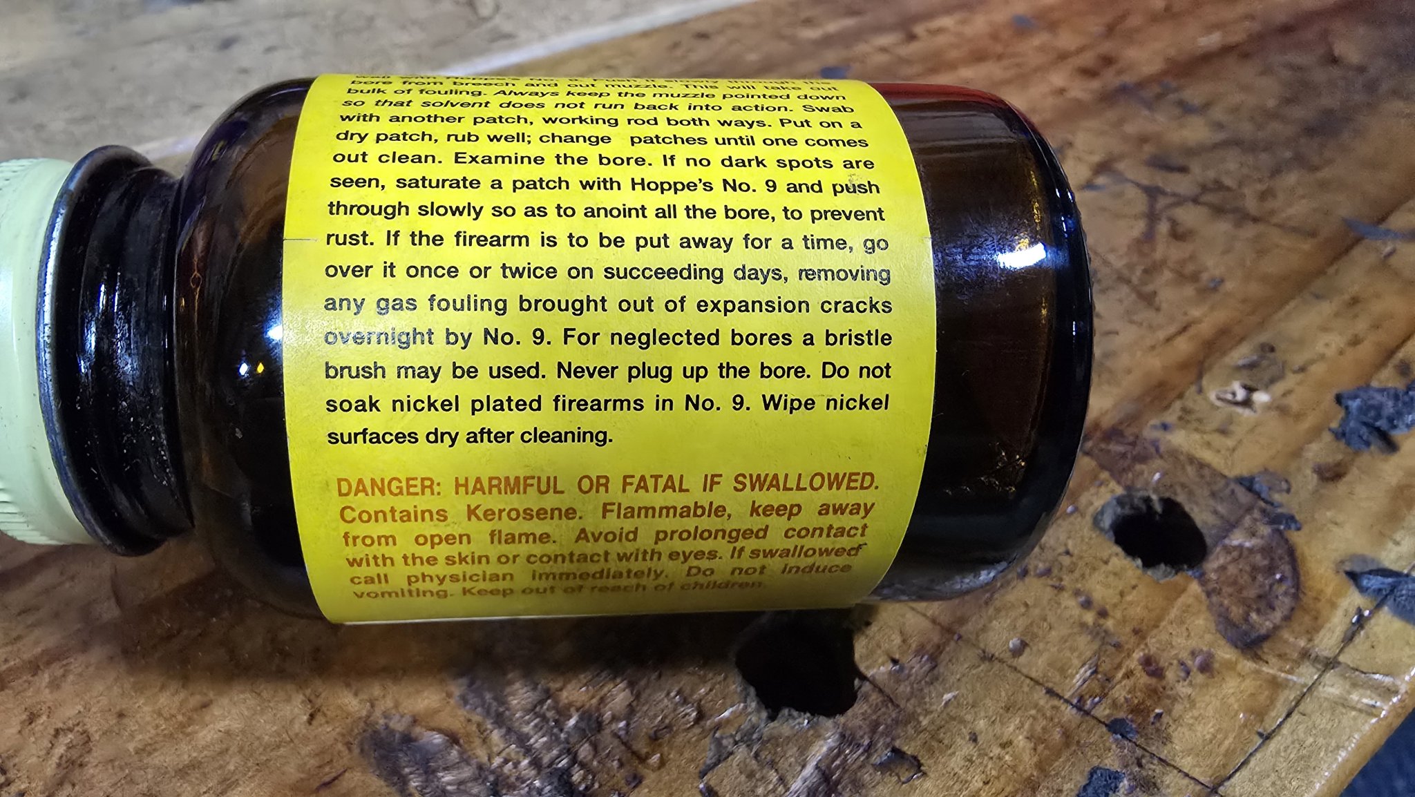

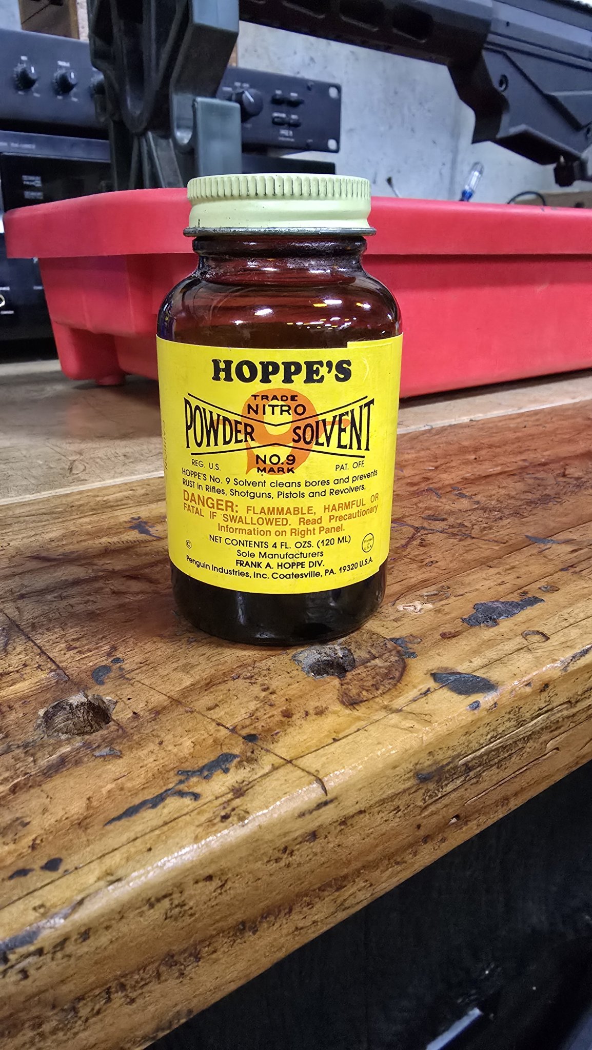

I actually prefer the older Hoppes #9. When I find it I buy it. It will say Nitro on the label. It had nitrobenzene in it if I recall correctly. I feel it does a better job than current Hoppes. If I remember correctly it was removed because of cancer causing concerns or something like that. I want to say they removed the nitro from it around 1990 or early 90's.
Hoppes is the old standby but what I really like about it is it will protect as good as any oil and will keep cleaning if left in the bore. So it doesn't wreck anything. LOL!
Oh.... if you read the old label on the Nitro #9 it says don't soak nickel plated parts or if you do to remove/dry the parts right away.
Some solvents are mostly water based.... I feel if left in the bore it will cause issues with pitting etc...so use them and get it out and oil the bore.
Solvents with ammonia in them... use them and get them out and oil the bore afterwards as well.
Pay attention to what your doing and how your doing it. Never mix solvents as well... unless your a chemist and you know what's all going on... don't do it. An old No No was mixing Sweets and Shooters Choice.
Later, Frank
I think this is correct. They changed the formula and took the nitrobenzene out.
Still loved the smell! Prolly what's wrong with me now. . .
When they changed the formula, I stopped using Hoppes because I was butthurt and moved to Shooters Choice, the plain SC7 stuff.
I have been using the SC rather than the new Hoppes for about 20yrs now because it isn't too aggressive and seems to do fine with carbon when used regularly.

No I think we are on the same page.
Kind of like comparing the SC and even guys saying Butch's Bore Shine is better than Hoppe's etc...Even the formula for Butch's changed from when it came out originally. I've tried them and I don't see much of a difference in how they perform... so I've just stuck with the Hoppe's during my slow cleaning method.
I did just pick up another bottle of #9 Nitro still brand new in the package. LOL! I also know a guy that's got like a 5 gallon container of the old Hoppe's but he won't share! :(
Maybe the smell has me hooked also? Just kidding on that!
Terry if the SC is working for you.... bud run with it. Like I said... more than one way to skin this cat.
Later, Frank

Your post made me want to dig into this a little more (plus I clearly have nothing better to do with my time ;)) and you're dead on.
Hoppe's #9 formulation has changed quite a bit even between 2016 and 2019 and not just re: Nitro. They took out a major component used as a SS protectant (oleic acid) sometime between 2016 and 2019. Not clear on what they replaced it with.
2016 (still had 9 total ingredients) in order of %: acetone (polar), ethanol (slightly polar), kerosene (nonpolar), oleic acid (nonpolar, protectant/emulsifier), propane (nonpolar), N-butane (nonpolar), N-Amyl Acetate (nonpolar, banana smell), isobutane (nonpolar), and citronellal (polar, lemon smell)
2019 (now has 16 total ingredients), in order of %: Kerosene (nonpolar), ethanol (slightly polar, used as emulsifier), propan-2-ol (isopropyl alcohol) (highly polar), amyl acetate (nonpolar), 2-methylbutyl acetate (polar), methyl alcohol (slightly polar, used as emulsifier), <1% of ammonium hydroxide, <1% various other things.
I like the look of the 2016 formulation way better than the 2019 b/c in the 2019 version I'm not sure off hand what they are using as a protectant (the 2016 version uses oleic acid for this).
It's a great point on how these cleaners etc. change over time and probably something to pay more attention to. The Hoppe's is a great example, I've used it for decades as a final step in cleaning, especially if it will be awhile before I hit the range with that gun again, and just patch it out before the range. However, if the formulation has changed and no longer includes a protectant, it might be time to find something else to fill that roll. They do still claim it has a strong rust inhibitor.
That said I also wonder for decades people have considered #9 as pretty much harmless, and MSDS sheets are always a little scary to read, a bit like those medication commercials where all the side effects sound worse than the thing you have they are treating. However, it's interesting that the Hoppe's #9 current MSDS sheet now specifically calls out multiple ingredients as known IARC Group 1 cancer risks for both inhalation and skin exposure. IARC Group 1 are those having human evidence of causing cancer. A quick look at other options like Shooters Choice or Boretech Eliminator MSDS sheets mention nothing about cancer risk ingredients. Even the older 2016 MSDS for #9 does not really mention cancer causing risks aside for the CA Prop 65 stuff that no one seems to pay attention to.....good or bad. I've resisted in the past, and used to work with a lot of rad stuff so gun cleaning fluid is probably the least of my life spans worries, but it might be time to give in and start wearing gloves when gun cleaning.
So it's of course possible that reporting requirements, or making a more "scary" report is required these days, or the usual legal CYA but if not it sure seems like #9 has become more risky to work with.
Aside: the Lucas oil bore cleaner MSDS is amusing to read, it basically contains zero information on what's in it, aside "petrolium distillates" and every risk/health category just says "There is no data available" or "No known significant effects or critical hazards"
