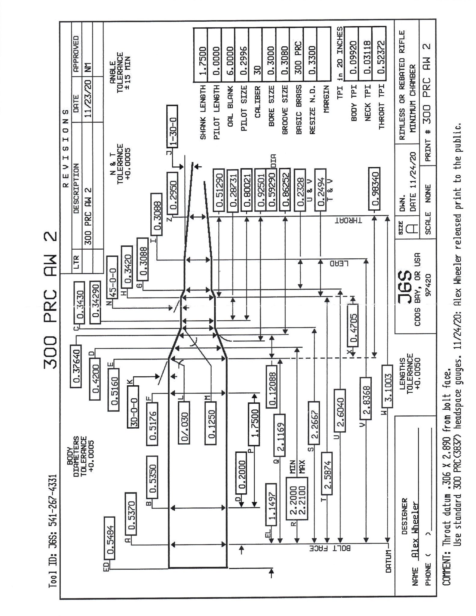

On the 300prc…. Is it a standard spec reamer for the chamber?
Your load seems hot for a 28” barrel and the velocity for that load seems low as well. We would also need to know the exact bore and groove dimensions of the barrel as well.

Thanks for the response Sir.
My reamer is 300 PRC AW reamer. I will attach the print.
-the barrel is a standard spec Bartlein 5r HV I purchased from bugholes

Let me look at my print when I get home later tomorrow on the 300PRC
Your load for the 7mm seems spot on. I updated the thread on 7 6.5prc load data like a month ago with all the loads tested. What barrel length you running on the 7mm?
