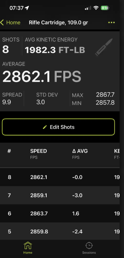

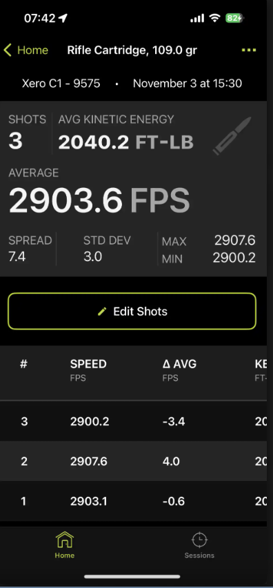

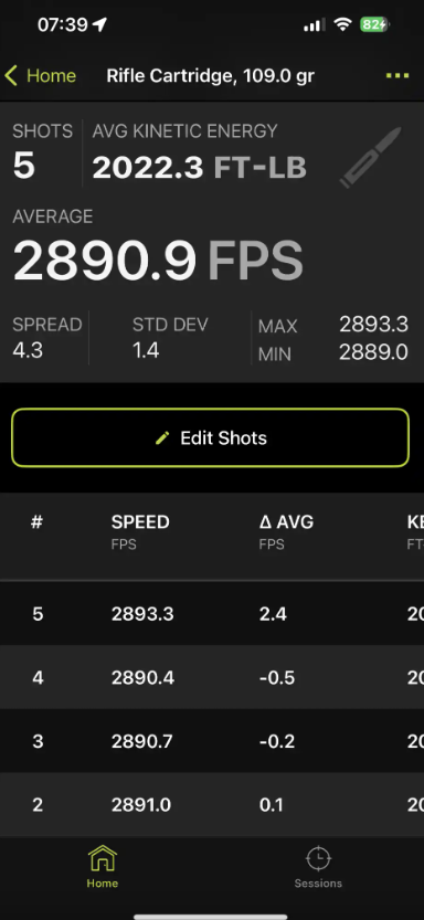

To illustrate this barrel speed up after using abrasives, here are some screen shots from THS in July of last year through day 1 and 2. While this speed up doesn't take as many rounds that initial "barrel break-in" does, its still present and repeatable with abrasive use. Since quitting the use of abrasives this had not repeated itself.
Start of day one
Middle of day 1
Start of day 2

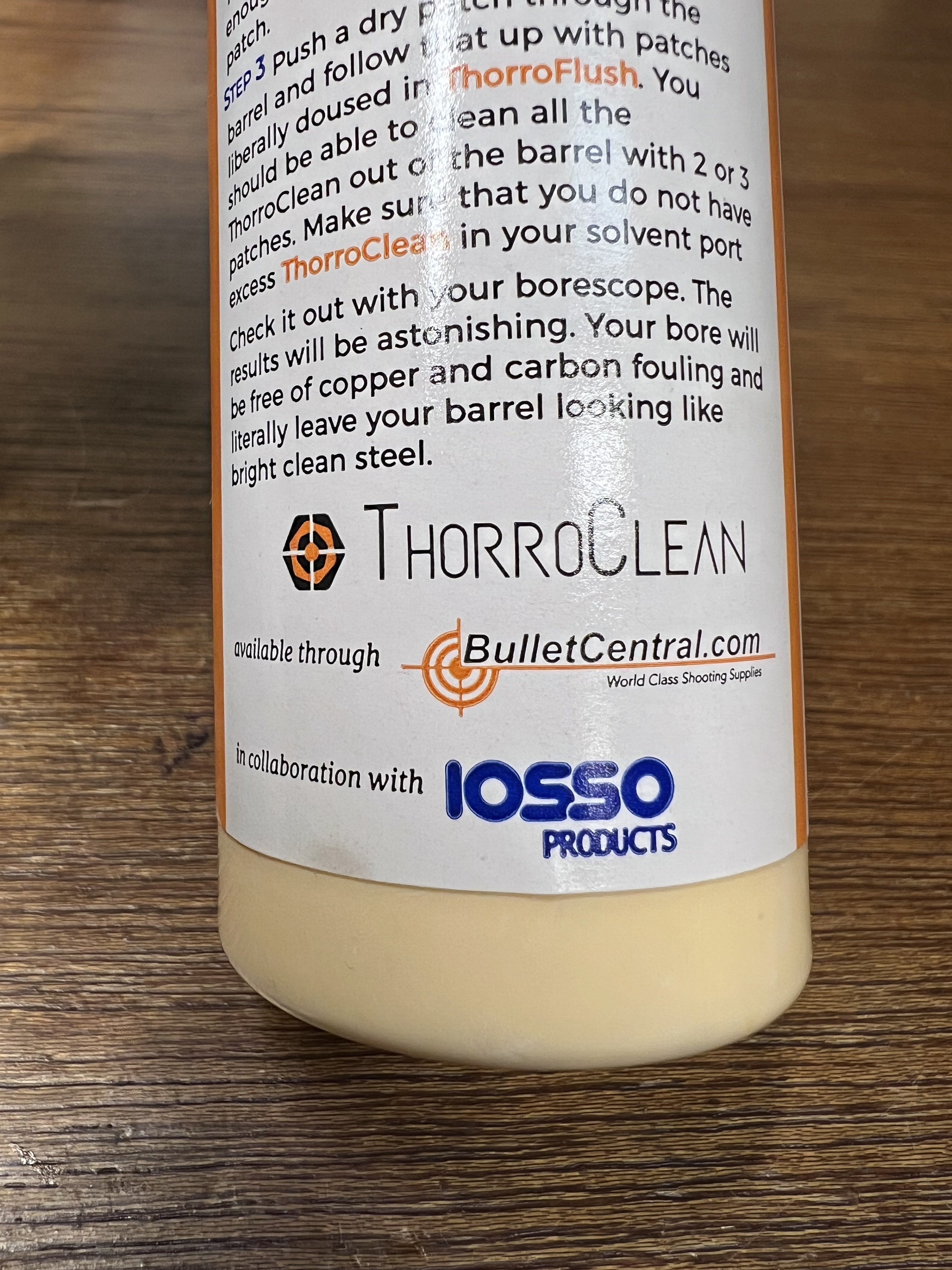

Thorroclean is Iosso in a suspension (liquid/oil) If you look at the bottom of the bottle, there be an "Iosso Products" stamp. Previously Iosso recommended the paste be suspended in Kroil oil, or their "Triple Action" oil.

Ok, so, my understanding is that Thorroclean is basically Iosso in a solution. If that’s true, how does that make it safer than regular Iosso? What should lead me to conclude, as apparently you have, that Thorroclean is “ safer “ ( less abrasive ? ) than JB bore cleaning compound ( blue container )? It’s been my impression that JB bore cleaning compound has been long recognized as a mild abrasive .
Pretty daggum true:
