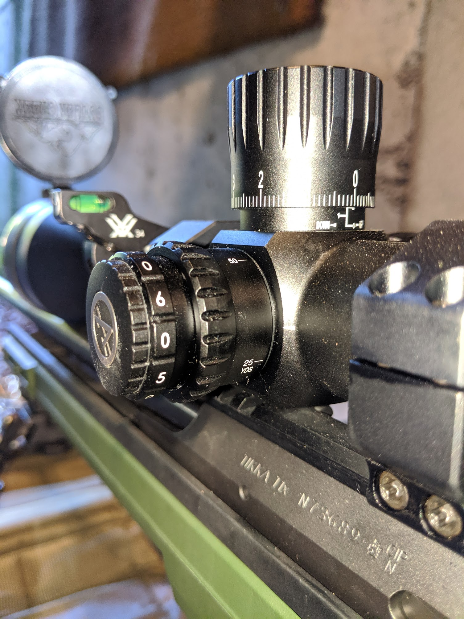

    Photo of my 25yard parallax-free setting, but can see where I have it positioned where I can see down my reticle and see the bubble level w/ both eyes open.
    I agree with @Dthomas3523 that putting a level on your training rifle allows you to understand what you're looking at when the reticle is level. I really like the integrated bubble level in my chassis.

    I have one on all my rifles, and use it as a training and verification tool. I don't know if I really actually took the time to look at it during a match, but it takes less than a second for me to shift focus to my left eye and see it. I shoot both eyes open so it's really quick to check and continue shooting w/o losing any time.
